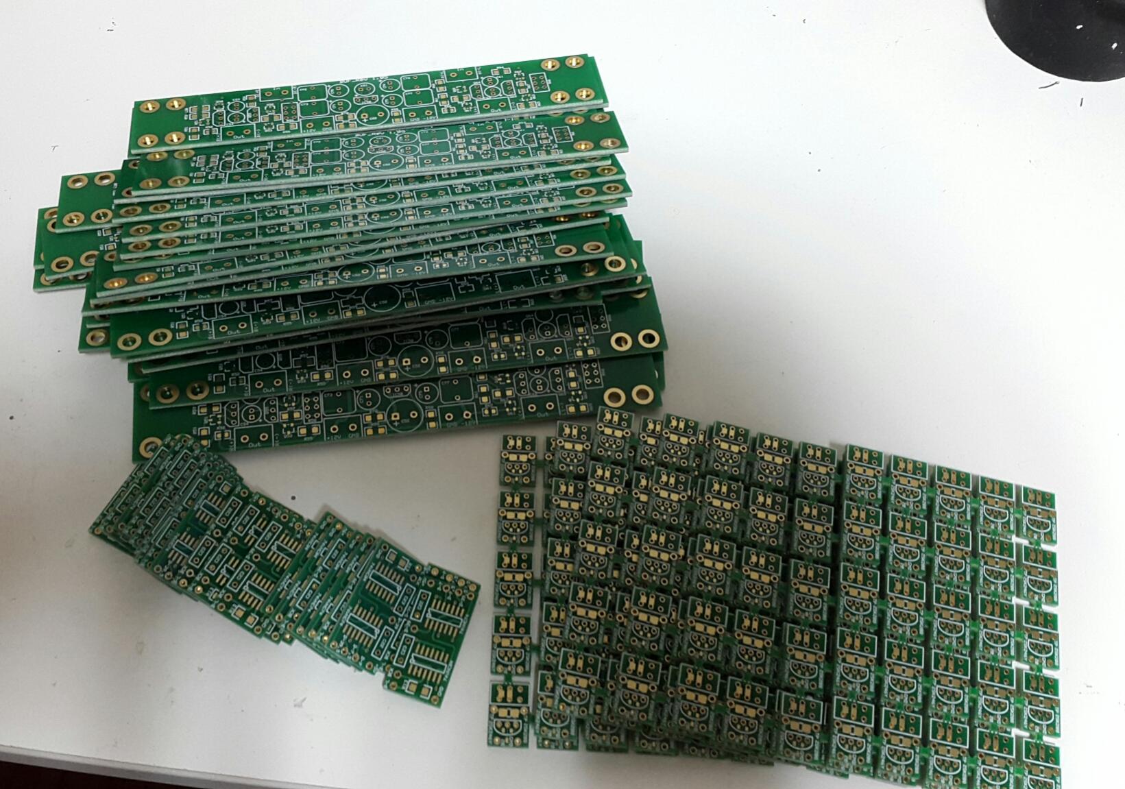

GB for bare PCBs - Status Update
Dear All,
As promised I get the boards today
Tomorrow I will start to prepare all the envelopes and Monday morning I will send your boards with the exception of the following people that requested the Buffer SMD parts to be soldered by me:
- Myint67
- Brumjam
- pdb
- tods
I hope that you already ask to carlsors to send me your parts
I will advise again when the shipment is done.
Best Regards,
Enrico

Hi Enrico,
I asked you to solder the SMP parts too (real name David Coe) so I should be added to your list. Carlsor is sending my bits to you.
David
