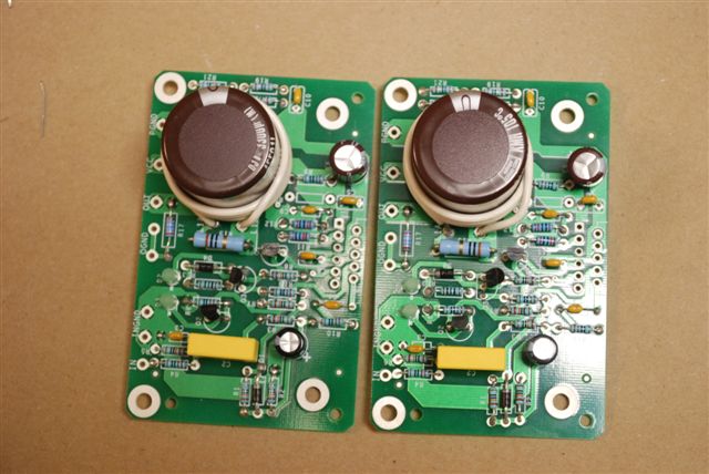

I took an old Dynaco Stereo 120 Power amp, and made some PCB's to retrofit LM3886s. I've attached a picture of the first completed version. I haven't listened to it yet, but the quick measurements so far:
*a bit more than 60 Watts into 8 Ohms before it clips
*harmonics of 1 kHz better than 80 dB below the fundamental below clipping
*3 dB frequencies of 10 Hz and 100 kHz
*about 1.1 Vrms input for full power output
The insides look a bit nicer than they used to, I think...Hopefully I can set it up for some listening in the near future. (picture is just a quick snap from my cell phone camera).
I would use a "real" heat-sink for those LM's. I do not think what you are using as a heat-sink will be enough to cool down those chips ( unless you do not push them) The LM3886 can get really hot if they do not have an adequate heat-sink. Just my thoughts!!!😉

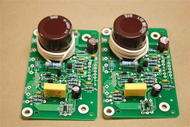

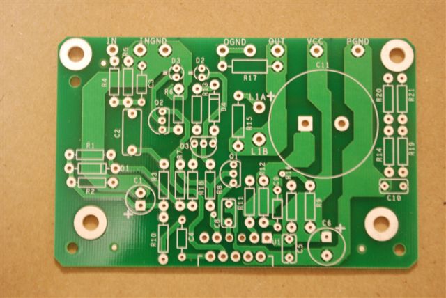

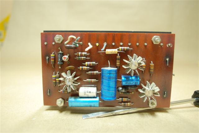

Close up of the bare PCB
Here's a close up of the bare PCB that I used to make "modern" amplifier modules to replace the original ones in the Stereo 120.
For reference, the other picture is the PCB side of one of the original modules.
I'll try to upload a stuffed board picture in a day or so.
OK...I added a third and a fourth picture...the old zobel networks and the output caps with the wound 'round inductors...just because it almost looks like art!

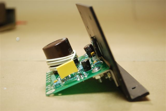

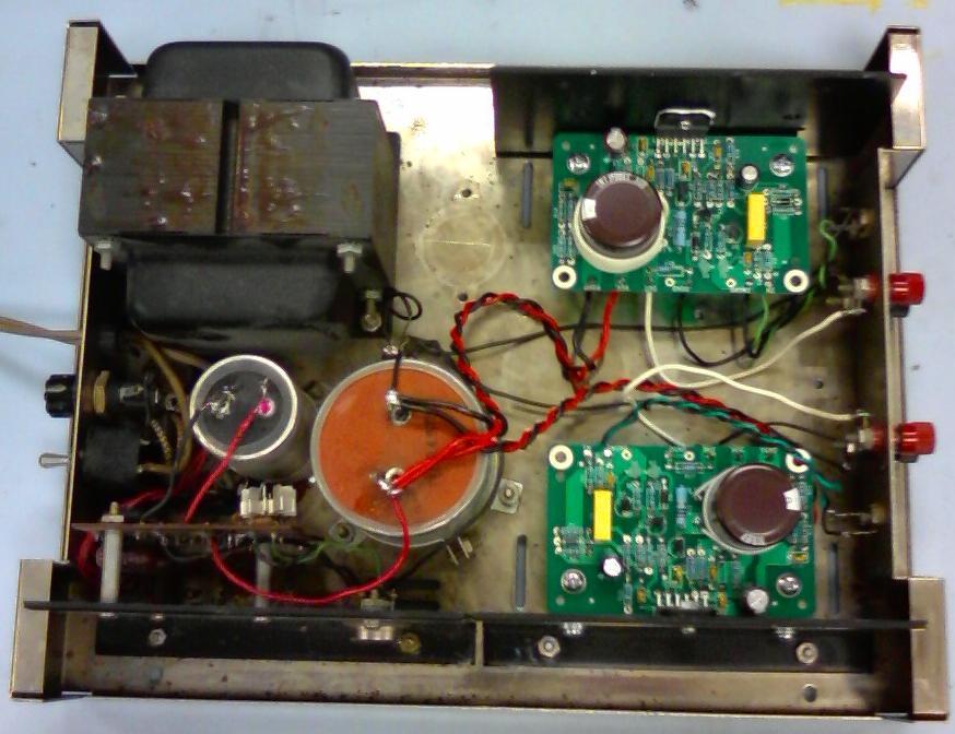

Some More Pictures
just starting to load the board.
all but the power op amp.
side view
mechanical detail
finished assembly (one channel)

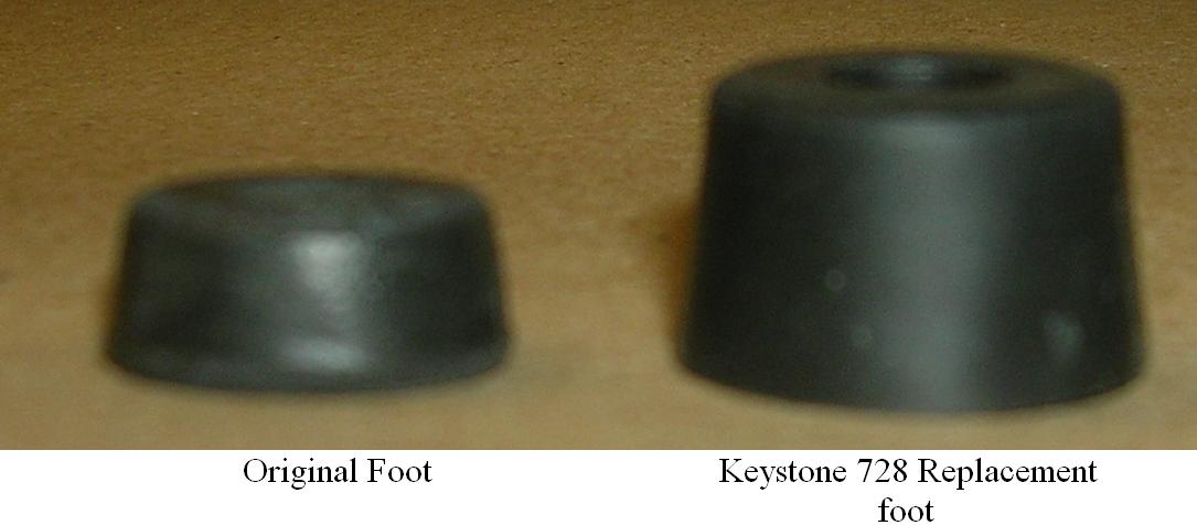

Found the Feet
The rubber (plastic?) feet on the Stereo 120 degrade after 40 years or so.
I found that Keystone part number 728 (available from Mouser as Mouser's part number 534-728) is a pretty nice replacement. It's a bit taller, but the same hardware still fits. Enclosed picture shows the comparison, with the two original feet on the outside, and the new Keystone foot in the middle. (focus isn't great because I got a bit closer than I should have).
