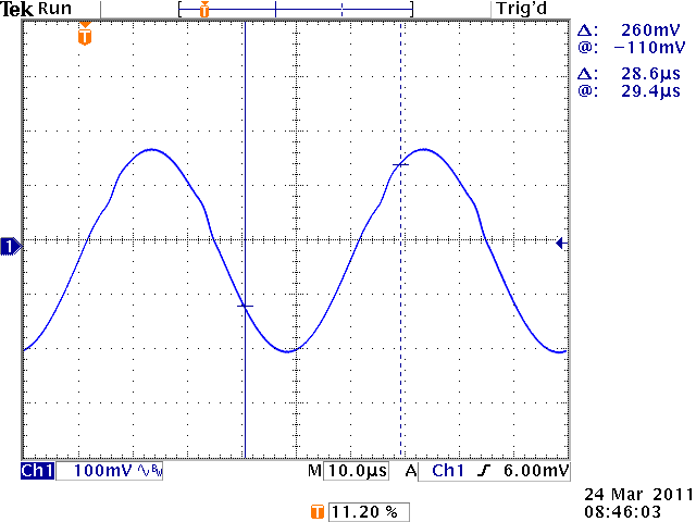

I'll also post here an interesting waveform from the stock unit, a 20 kHz "sine wave" at the output, about 350 mV peak-peak into 8 Ohms. See the visible crossover notch.
