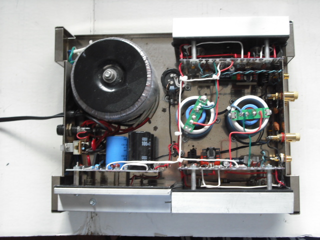

I agreed with indianajo about the Dynaco 120. Attached it is a picture of my Dynaco rebuilt. Once you replaced those cheap components with today quality the sound it is super excellent. My Dynaco 120 sound as good as the best tube amplifier. I called the "Beast" and it is completed new with the exception of the switch and the chassis. Everything it is new.

Yes and No Update sound is reasonably good, not frontline use suitable but wayyy better than stock .
BUT the Transformer sound is Loud and overpowering.
Rendering MY 'updated' st120 to Garage uses.
Unless I can remove and distance the crap transformer, via a Loong cable to live behind the garage.
