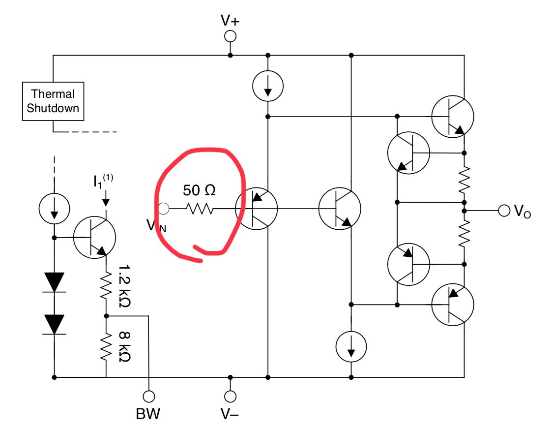

1. Buf634A datasheet doesn't contain THD for the buffer itself. I suppose figures were ugly, so omitted. TI offers a way better buffer LMH6321, from the THD perspective they differs in an input stabilisation resistance - 50 Ohm. Assuming litography process this is not resistance, but really diode.
Could you clarify - why add unneeded highly nonlinear part in the design while it can be replaced by much more linear external component Rs?

Where did you see that 50R input resistor?

I'm not sure why you believe there are no pure resistances on a lithography process? We have had VERY good thin-film resistors on semiconductor processes for decades. The input resistor on the BUF634A is indeed a resistor, not a diode.
Nice to know, thank you.
I have no doubt about hybride techprocesses, but they demand for more different processing stages and of course will be more priced than lito-only.

Is this from the data sheet?
Clearly, be sure, straight from there.
It’s well known source resistance for resolving worst-case oscillation with 2EF or mainly 3EF output opamps.
While it’s really thin-film as posted above than it slightly reduces bandwidth without dramatically THD rise.

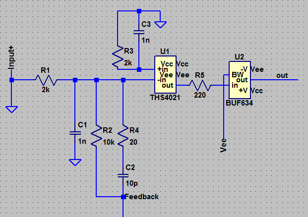

But, really, for most headphones i’ll prefer simple follower with KSC2690 loaded at 200 mA constant-current source.
Is the 220 Ohm res needed?
Yes, it flattens OLG curve at ~200 MHz region removing some knee and allowing to elegantly close response.
Cherry on the cake.
There is already an internal one.
Too small for such a high-GBW uncompensated beast like THS4021. Being realistically it could deliver without buffer, but namely this resistance disclose a whole page about stabilizing multistage followers.
Just look at simplified sch. Pairing them like a trick with stabilizing four stage emitter follower. Not so much could properly design even low-freq’ed EF3, so speaking about some dozens MHz EF4 are pure joke.
How you can live with drawing amplifiers as boxes in the schematic I'll never know :). Makes me twitch.
What makes you use THS4021? Seems like there are other op-amps that are lower noise and distortion in the audio band that would be easier to use with the BUF634.
