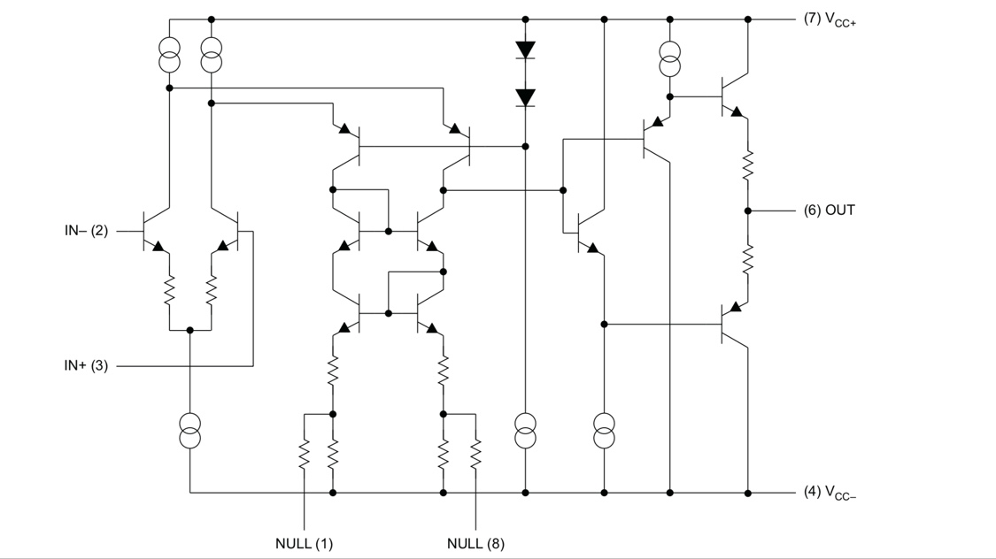

Draw a folded cascode loaded at a full-Wilson current mirror and followed by a parallel follower:
Bufferize it with additional parallel follower, say more powerful:

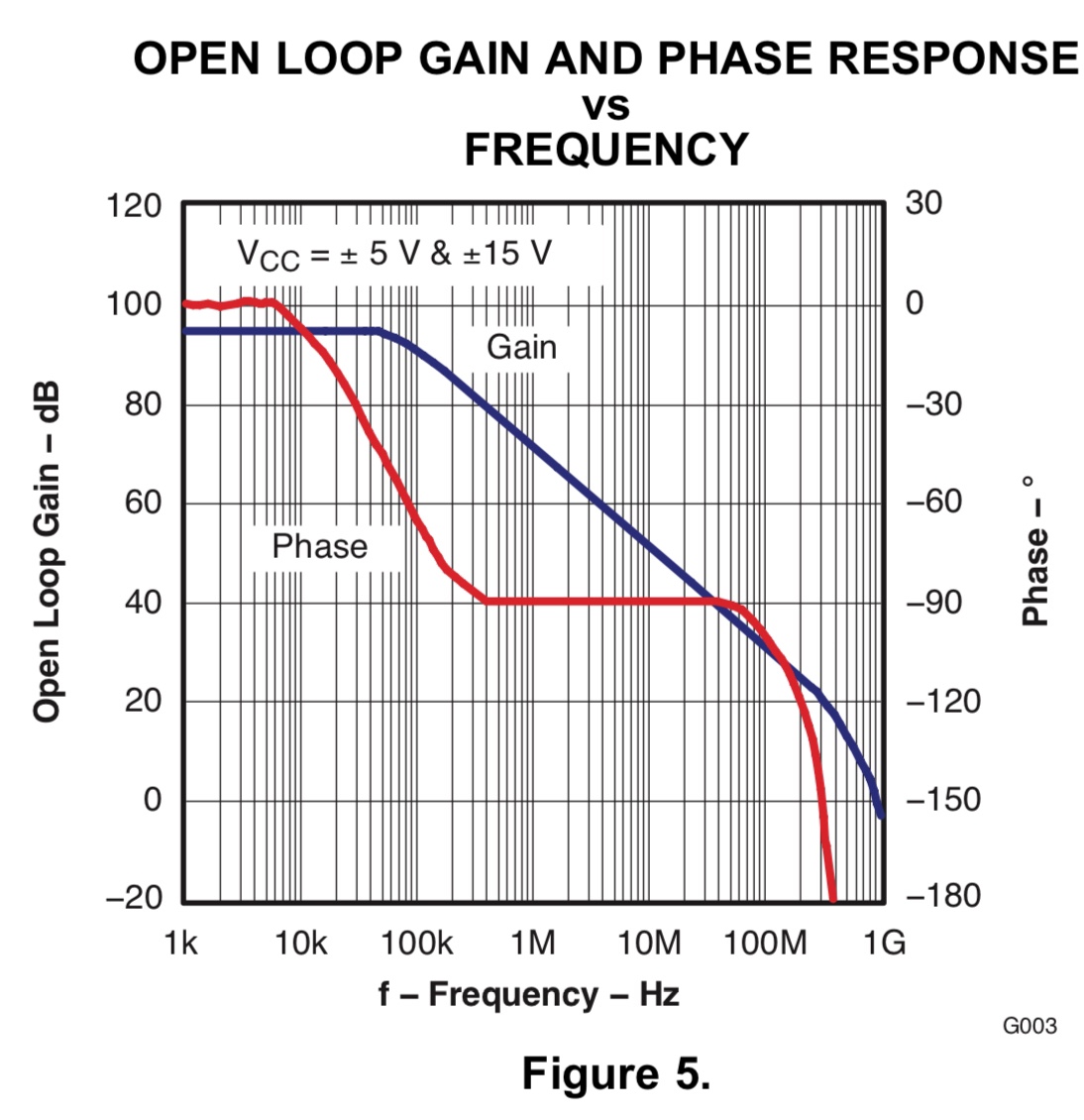

What makes you use THS4021?
Say your OPS (now - BUF634) provides -40 dB THD of 10 kHz tone. Wrapping a 80 dB depth feedback loop around that BUF634 provides you with something around -120 dB THD.
But at the same time that 80 dB loop wil demand some margins for stable operation. First of - really high bandpass of that BUF/OPS, so there are a classical tradeoff.
Seems like there are other op-amps that are lower noise and distortion in the audio band that would be easier to use with the BUF634.
AFAIK, no.
Typically 4021 provides you with at least 85 dB gain at 10 kHz. There are no comparative compensated opamp. You can swap it with only something like AD8067, LM7171, LT1222. Each of will be at least 20 dB better than common well-known “audio” opamps.
AFAIK, no.

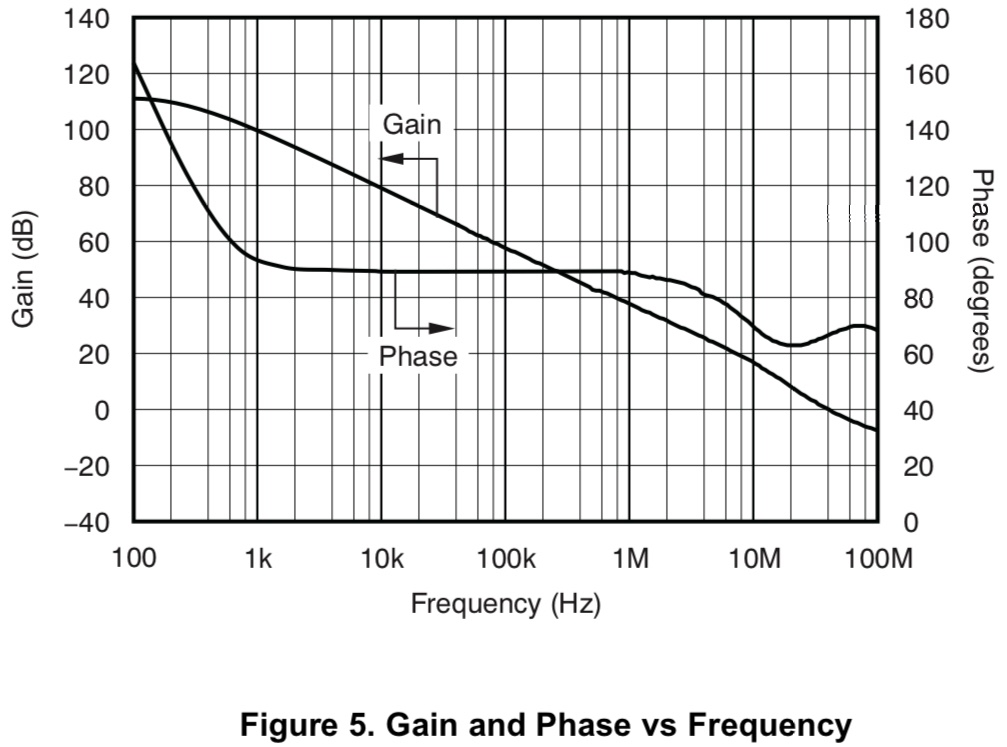

Yeah, it's decompensated. Is the standard result not good enough? I mean, you can get extremely good results with LME49xxx or OPA1611. I'd have to dig for some 10 kHz measurements with the BUF, but OPA1611 has almost 80 dB of gain at 10 kHz too, except it's unity gain stable without having to increase the noise gain.
Intrinsic gain - yes, but subtract external gain... Be sure, you’ll find that 15-20 dB handicap.

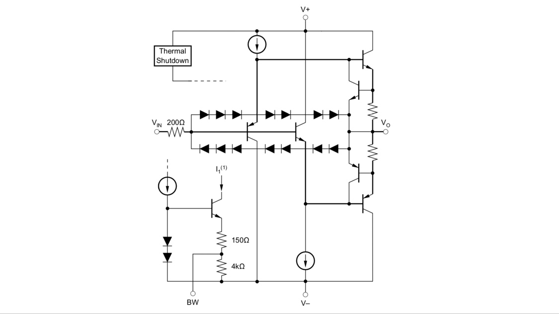

1.Some years ago I was seeking spice model for BUF634 in Low-Quiescent Current Mode. I failed. How about 634A?
2.Is there anywhere a more adequate schematic of 634(A) than in datasheet? Like, say, in http://images.100y.com.tw/pdf_file/33-ELANTEC-EL2009C.pdf

We are working on spice models which show the full range of bias options, I'm hoping we'll have those online soon after the BUF634A RTMs (VERY soon).
Regarding the schematic, we got clever with the architecture of the BUF634A, and there is some IP that we would like to protect. The simplified schematic will have to do.
