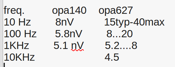

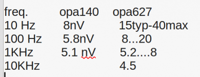

Please stop building straw men from things I have never said.
And your armchair speculations about chip sizes:
OPA140 is 1.272 mm**2, opa2140is 2.36mm**2 and OPA627 is 6.039mm**2.
and the results:
freq. opa140 opa627
10 Hz 8nV 15typ-40max
100 Hz 5.8nV 8...20
1KHz 5.1 nV 5.2....8
10KHz 4.5
the OPA627 with 6 mm**2 still fits in SOIC-8.
In that space, 5 OP140 would fit, with the space for 20 bonding pads
still available. And that SOT-23/soic8 stuff is probably pad bound or close.
If you have no better ideas than to simply parallel them, much as I did
in my 20xADA4898 amplifier that you seem to hate so much, then that
would improve the OP140 by sqrt(5) noise-wise. So don't try to tell me
it can't be done. The only question is if there are enough design-ins.
And I don't need an education on w/l. I learned that on Hewlett-Packard's
dynamic n-mos process and AEG's bipolar, back when a CDC Cyber 176
was the Spice working horse and our new VAX really allowed graphic entry
of those full custom transistors.
I feel the love in the air 😀. Anyways, you are not the only reading my posts, others may find them instructive.
Because you mentioned it, 5 x OPA140 (or a scaled version of it's JFET input stage, for a single op amp, that would likely fit in a SO8) will still have some 2nV/rtHz. You would still need 4 such monsters to make it to 1nV/rtHz, or the equivalent of 20 x OPA140 (or 50mm^2 of silicon, which definitely won't fit in a SOIC-8). Not to mention other issues (offset, drift, etc...) that also scale with the area and could make a simply scaled product not feasible.
I'll let you find how much would cost a 50mm^2 op OPA140 scaled op amp, if 1 x OPA140 2.5mm^2 costs $2.5 in thousands quantity.
If you have any ideas on how to integrate a lower noise JFET in an existing BIFET process, while keeping the silicon area within reasonable limits, then I am sure TI and AD would be all ears 😀
