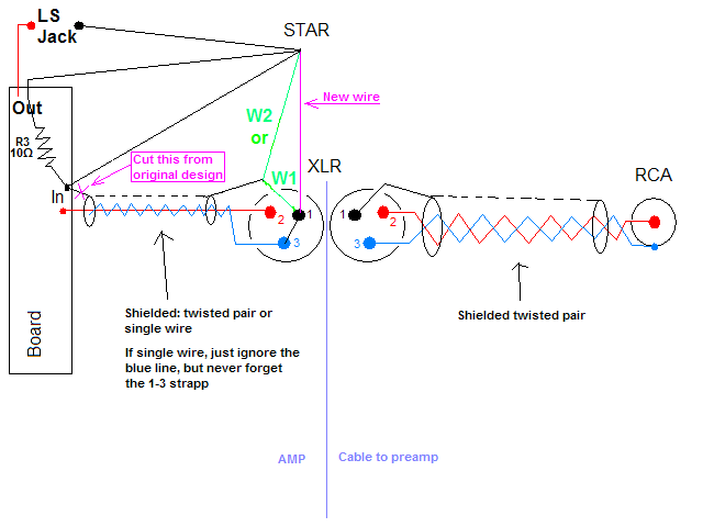

Esperado, is the drawing below a good understanding of your last advises ? And what is better: W1 like in original, or W2.
PS: whatever the changes, R3 remains a complete mystery to me.

Not complicated. In the source (preamp) ground and cold wire connected to the ground output plug. On power amp, shield not connected, and cold used as ground.
Just a question, if you short cut your inputs, with no preamp connected, did-you still have hum ?
R3 is just to allow ground reference of the input stage to be connected directly to the star ground reference, without creating loop (current across the 10 Ohm will be near null) while allowing a good enough reference when nothing is connected.
Is is because the ground connection to the power parts are high current, so, even a low z of cabling can create a voltage in it. Spécially at HF, where wires present an inductance.

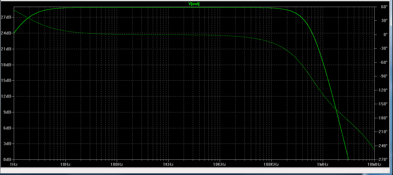

My amp, before modified to CFB was flat, with no overshoots on 20Khz sqare waves after derating. Sure, decreasing the cascode pole cutoff will solve any oscillation problem, but don't you find it is sad to use a cascode to avoid capacitive load on the previous stage and increase bandwitch, then add a cap to decrease bandwitch and add a capacitive charge to the input ? With some expected TIM increase ?
Too, i REALY wonder why you have so different sim results than mine.
Attached my sim for your 22pf. (with no input filter)
Dont know , perhaps the fets spice models.
-1 °K 😀 hum with inputs shortened, this for each channel. When just both or only one unplugged, very very light hum and shuffle, but heavy hum when both-plugged-both-side (no matter the preamp is on/off/powercord removed). With no ground, earthquake 😱 but this is normal 😛 with such a powerfull amp isn't it?

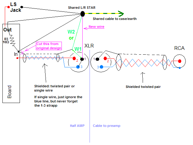

Not sure I really understand as there is already a big gauge wire between ground board input and the star with nearly zero current inside. Do you mean this wire is say shortened by R3 at HF?

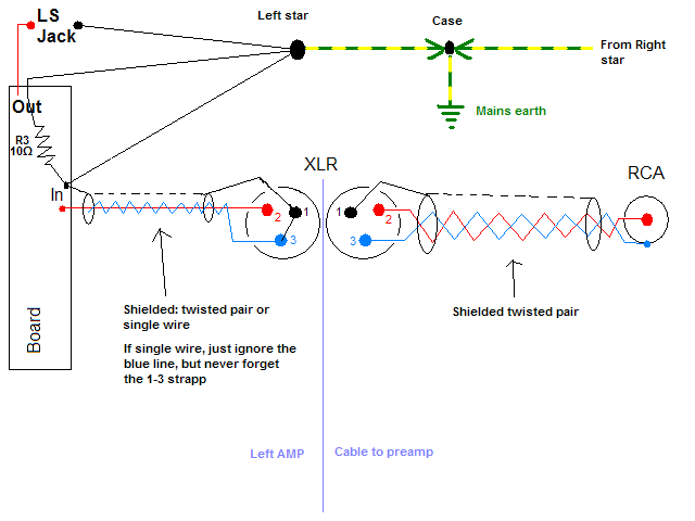

Added the earth link below.

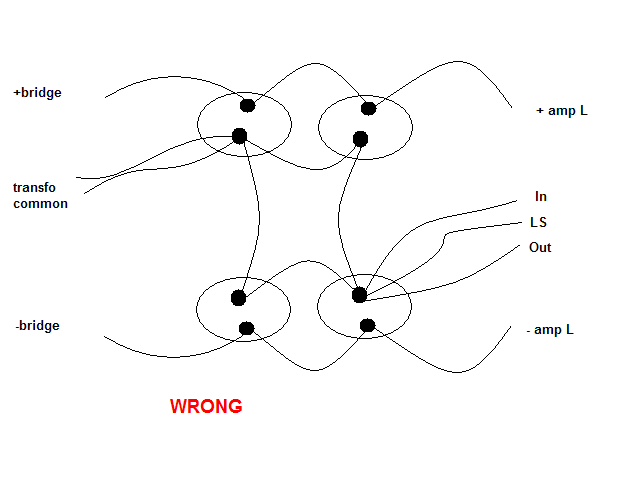

We killed the hum 🙂. Thank you for your help. Two no-concession stars did the job.
