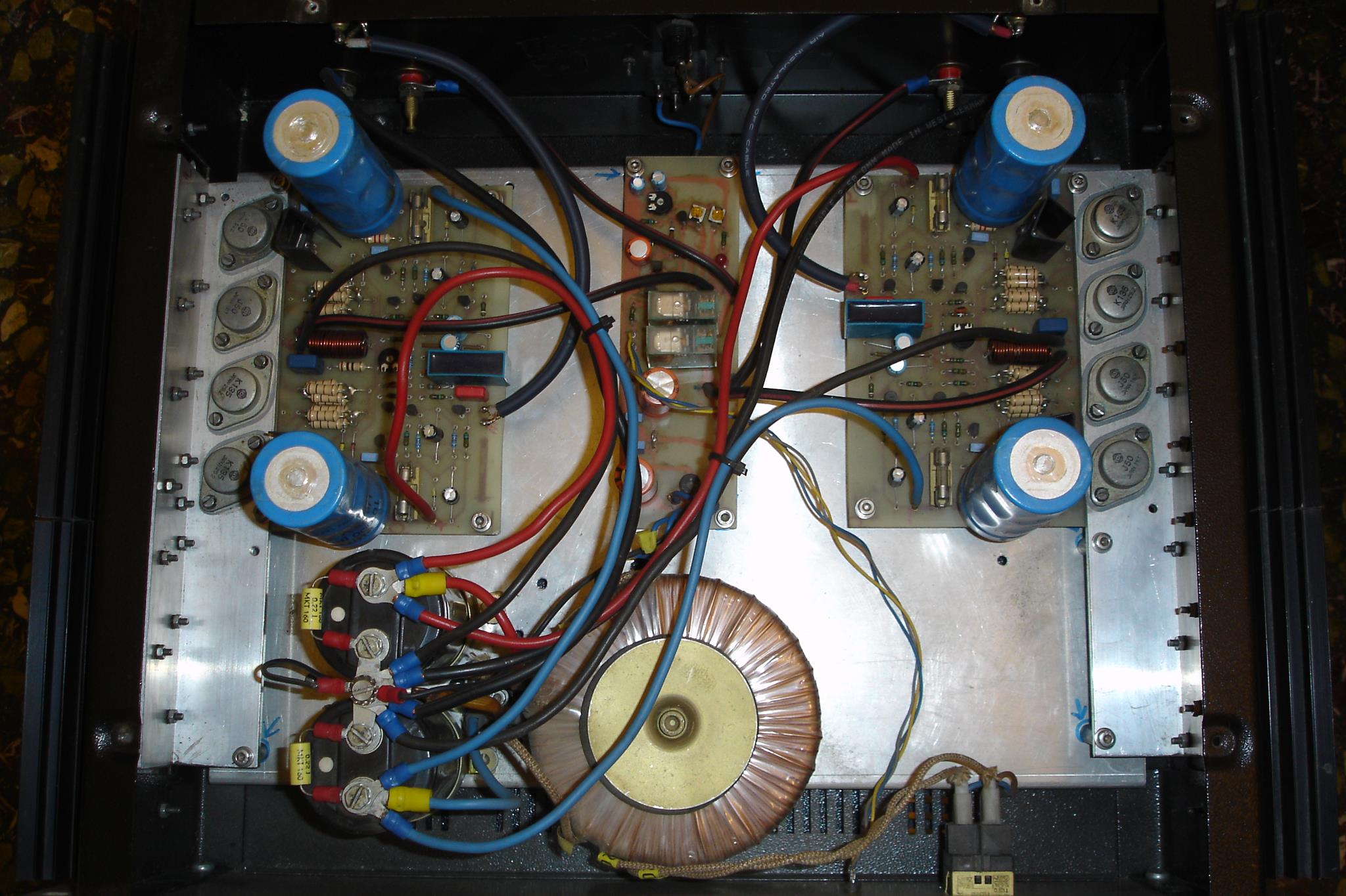

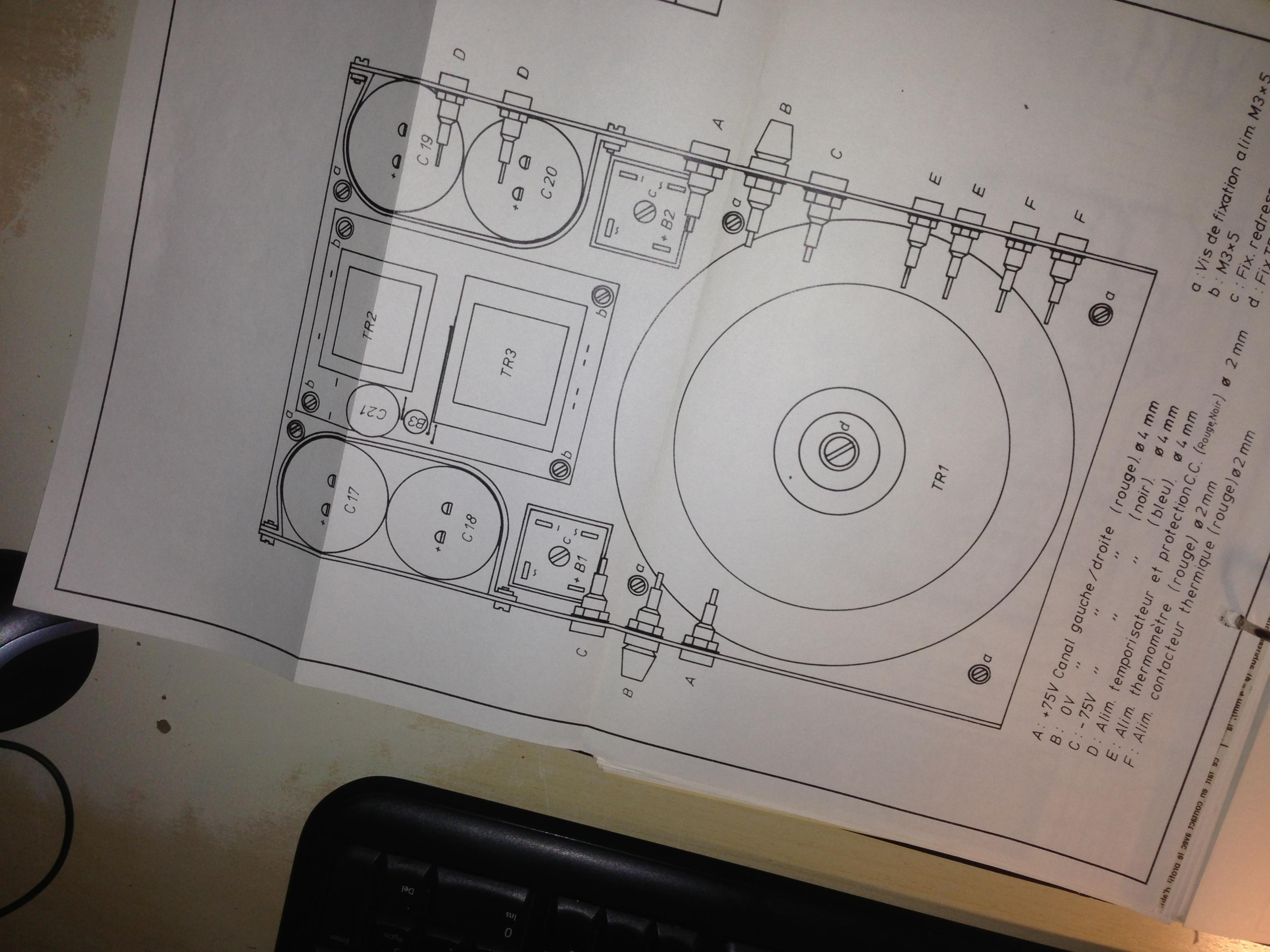

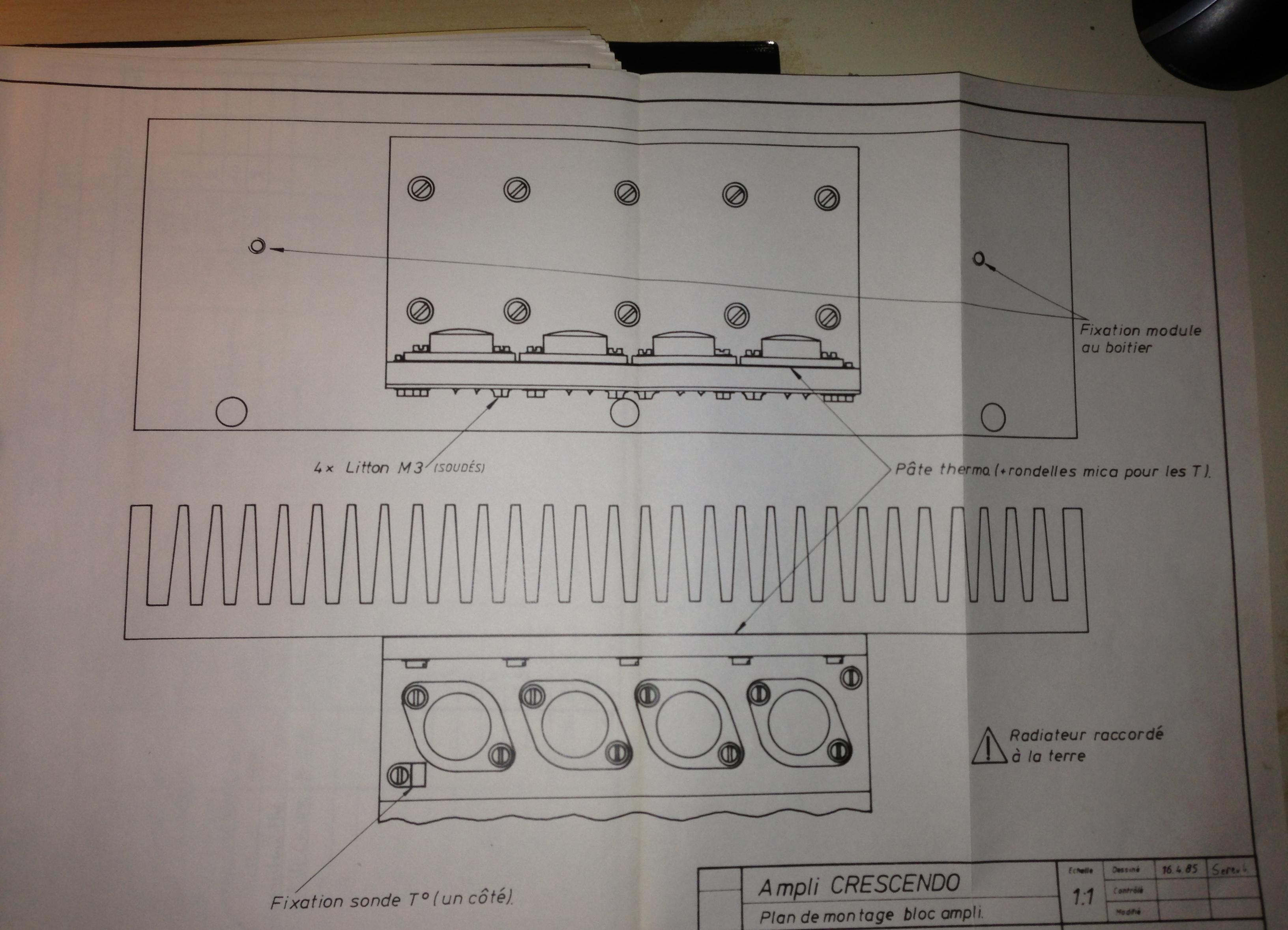

I am an electronics engineer and built the original (also created a whole made by hand plans and drawings, no computers for me in 85!) as a school project when I was studying, the job which was part digital electronics & part mechanical construction.
This amplifier is very good but very unstable as many of you have noticed/said.
I also still got the original Elektor mag. featuring the Crescendo, in French, as you will see also on the pics.
I subsequently worked as a PCB designer ranging from PSU to RF devices in Switzerland and then the UK where I currently live.
I am planning to redo a brand new PCB based on the original with Esperado's mods and re-use some of the original parts I still have (Huge toric transformer output 2x 75V and heat sinks with "L's" attached to it) all dressed into a very modern hand crafted case.

I measured an RMS output of 138W on one channel whereas the other threw 217W before clipping.
It also had a nasty bout of oscillation in the MHz's and this was more or less sorted by shielding/shorting the P fetmos TO3's cases with a piece of aluminium(!). But it fried a few T's in my time.

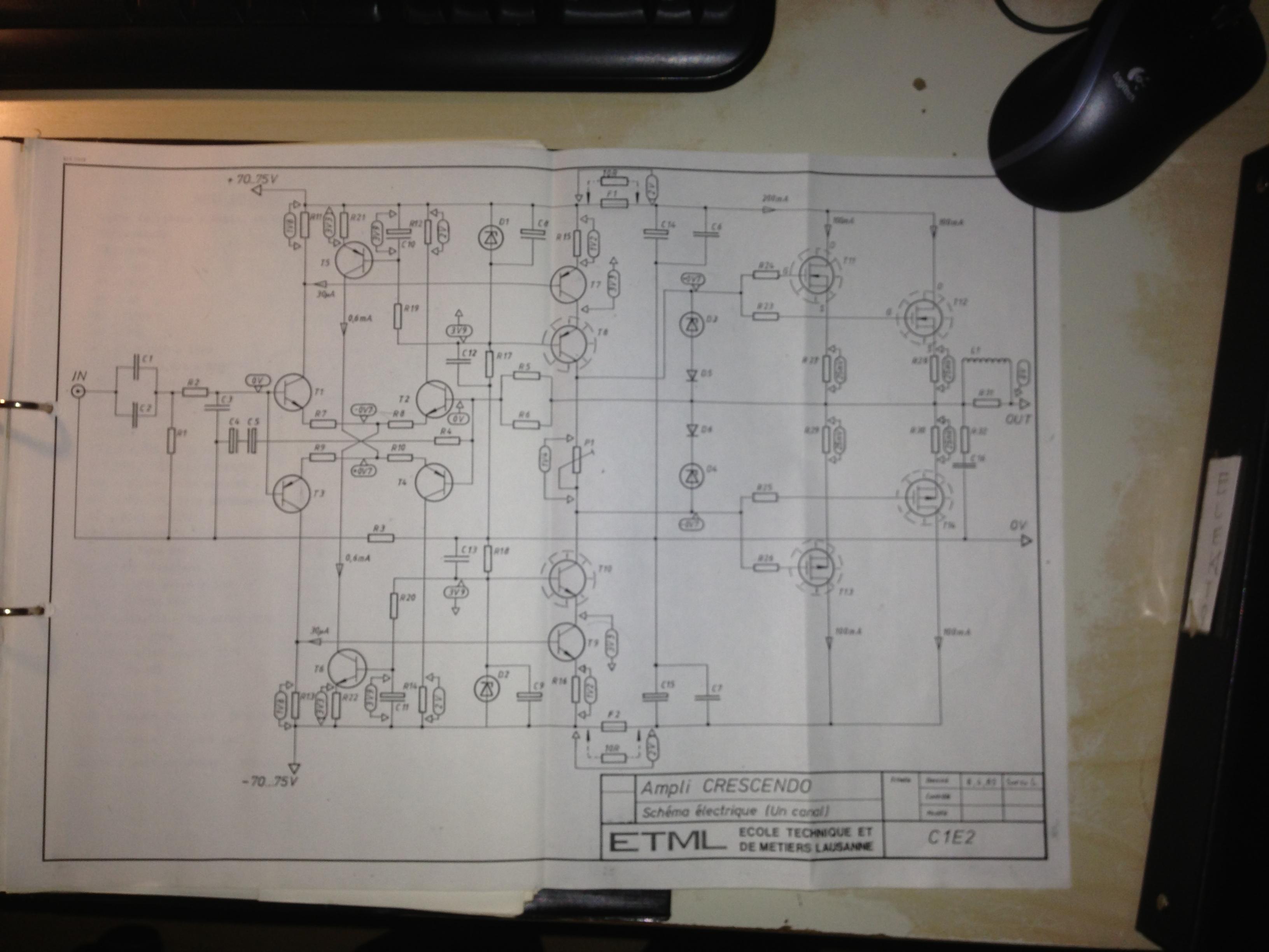

My question to you was about the image on your page which links to this image, I reckon your latter schematic is the right one, right?
Kay Pirinha
Sorry you don't read French :( it could be useful sometimes. Frankly I haven't really though about the ins and outs of Esperado's schematics, apart that any improvements is a good idea, removing the counter reaction circuit made of the BC546 and BC556 chain is definitely a good idea as they tended to go up in smoke in a wink whenever there were interferences. :D
I also did add some safety barriers in the original design at the time, like head butted Zeners between the input/ground to clip any massive glitches one can introduce when plugging or unplugging the audio cables. As one knows the Crescendo being such a sensitive and gigantic OP AMP was quite happy spewing whatever you fed it. Limiting the input is recommended.

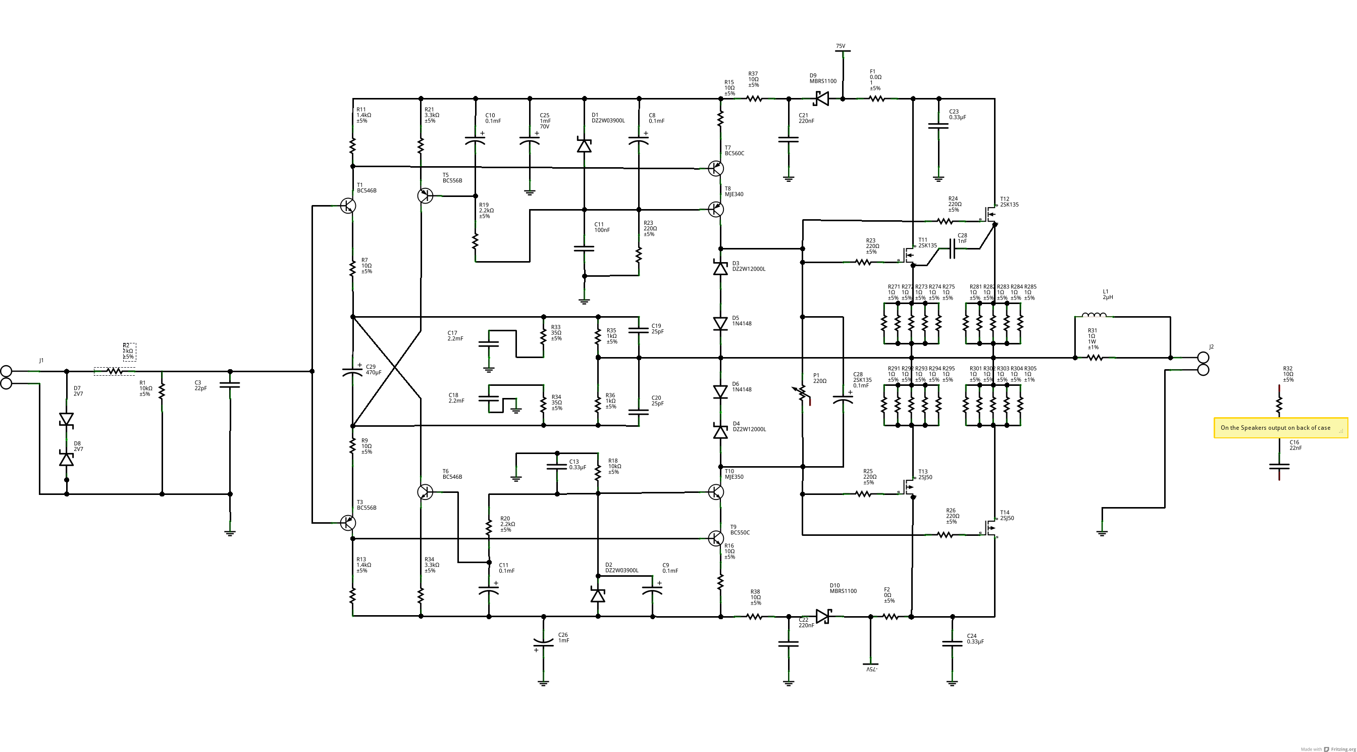

Okay, just finished comparing the old design with the new one; little has changed, and Esperado, I am sorry to let you know that your PCB rewiring is incorrect :D Your PCB view connects the C19 and C20 capacitors (see schema below) on the other side of the R17 and R18.
Anyway the only unaccounted for elements that aren't on the original design are the ones circled in red below.
These two comps aren't present on the positive side.
Are these necessary just for the negative stage? or is that an error as I fail to understand what it does brings to this otherwise totally symmetrical schema :confused:
Thanks.

R17 and R18 was just a quick'n dirty little mod to adjust the DC offset 'on my amp'.
Positive OR negative side, depending the sens of the offset.
We could do better adjusting the current sources via R6 or r29. Forget R39/C21.
