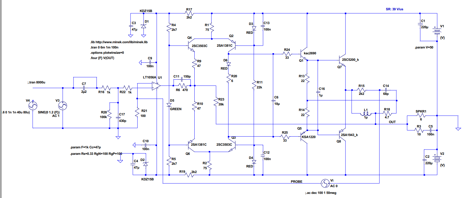

LV's amp
LV made it work by using a lot of positive feedback, and just a bit more negative feedback. This also floats the inputs so there is no common mode range problem. But the I.H. circuit +in is grounded so if it worked at all, it would clamp at +-4V when the floating rails hit zero VDC. It would probably latch up. The +-inputs must stay within the rail voltages. But some spice models do not model the rails properly, so a simulation gives false results.
Driving the LT1166 outputs may work, but not well, as others have described.
I see, you are talking about post #5 and #6 - Ian H. simulations.
It looks like the op-amp is floating, like Elvee's current dump amp.
I built the 1st current dump amp (the 'active' one), but I couldn't make the 2nd one ('passive' version) stable...
Oops!
I missed something: The I.H. circuit drives ground and swings the supply voltages like a QSC amp, so I take it all back. The LT1166 outputs do not swing anywhere (much). But I have to play with I.H. simulation to be more definitive. Something is still not right.

Ian circuit
So, it seems Ian's LT1166 model has problems, which I am unlikely to resolve. BUT, LTSpice (now?) comes with a working LT1166 model in "special functions". Using that model, Ian's circuit works quite well. Except, he is mostly driving the LT1166 outputs. Vin is slightly driven out of phase?? With a 2.5V input, I get about 0.002%THD @ 1KHz.

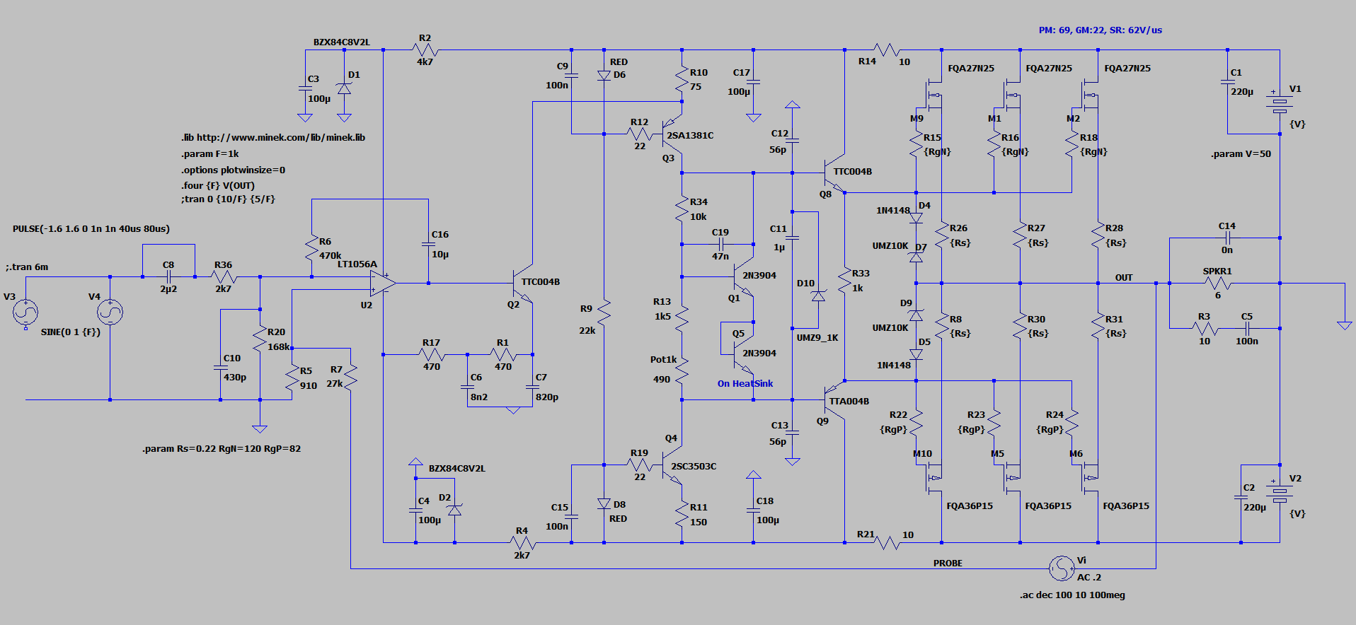

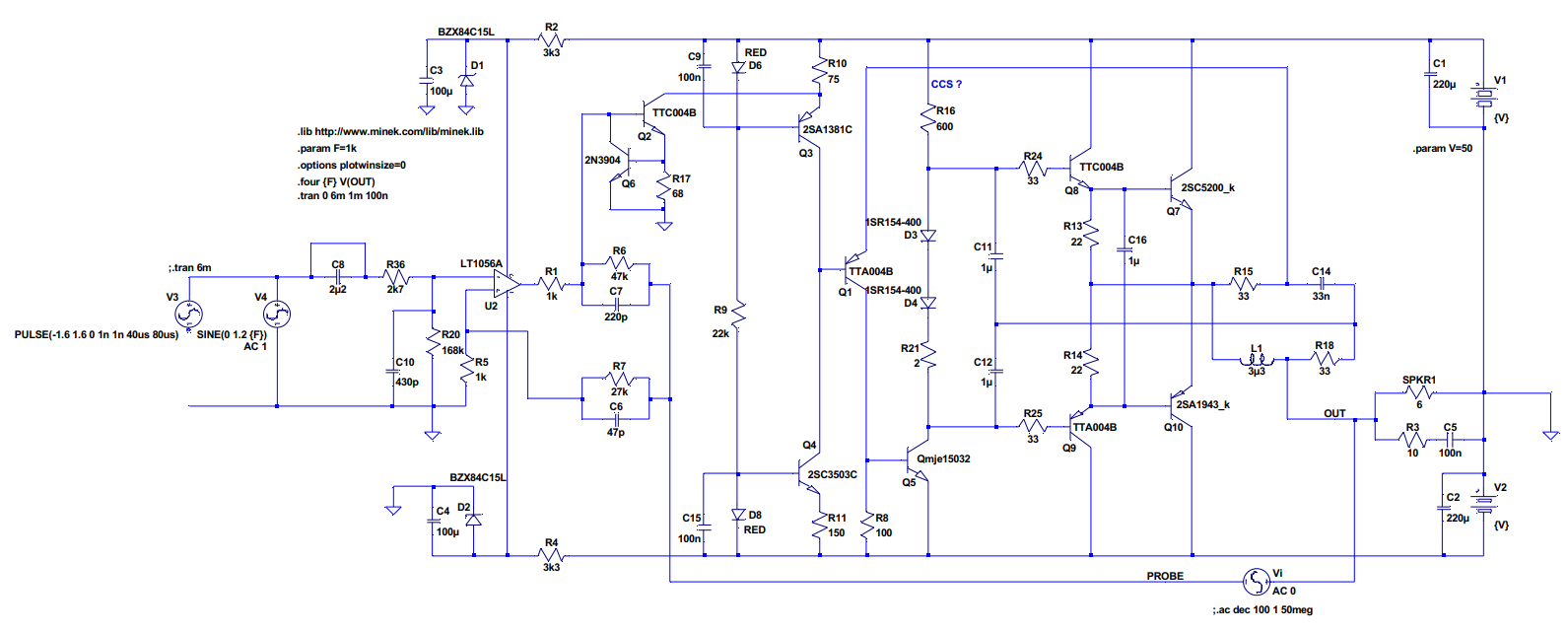

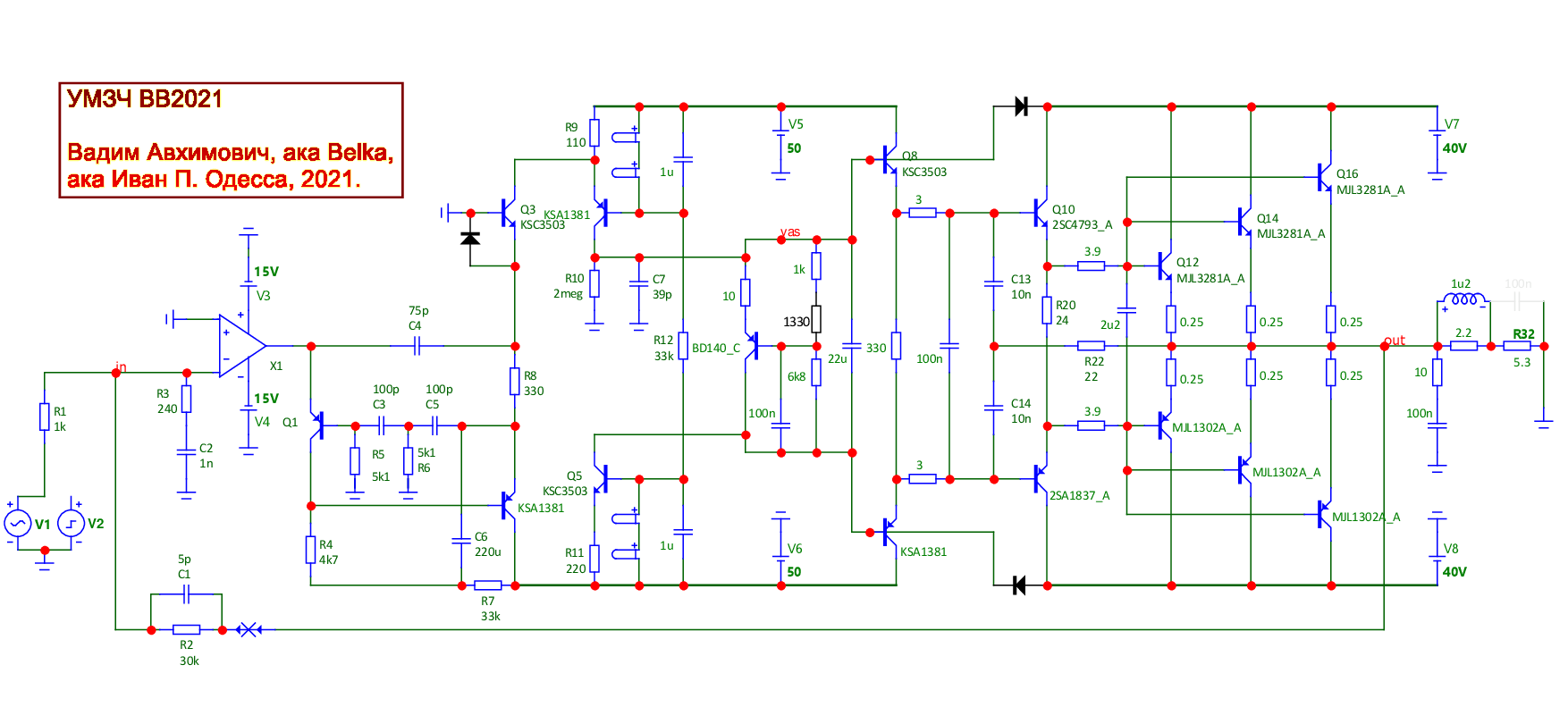

Apparently I had nothing better to do, so inspired by recent renewed interest in current dumping amps, it was only natural, to come up with LMK-style current dump amp. What's more 'unusual' than that?
I have two schematics, one better and one, as we can guess - worse.
The better (in a relative way) one is based on the OS from current-dumping-class-performance-idle-current thread
designed by jxdking.
It has a local feedback within the OS, and global feedback to the op-amp.
Wonder if there is a way to improve on it?

Lots of interesting ideas! I actually like the bjt version better, mostly because the other VAS is running so hot. A P-P VAS could run half as much current. But maybe you could run ~C14 back to Q2 and Q3? You have me investigating the whole issue of nested feedback loops and I like to put the inner loop around the op-amp instead of around the discrete stages. It seems to fix a phase margin issue at lower frequencies. Years ago, I fought with Phase Linear amps that used an op-amp and were notoriously unstable. At the time my best solution was to add local feedback around the op-amp. I'm sure this compromises THD but stability was more important to me. I also don't like lead caps in the global feedback, since that creates a RFI vulnerability, RF on the speaker cables getting to the (fast) front end. I found that you don't need them if you put a ~1nF cap on the emitter of the first transistor and a larger resistor to -8V*, which also limits the current, no need for clamping.
Some of this is illustrated in the attached files. *You will also note that I reduced the op-amp supply to ~+-8V since more just exacerbates rail sticking.

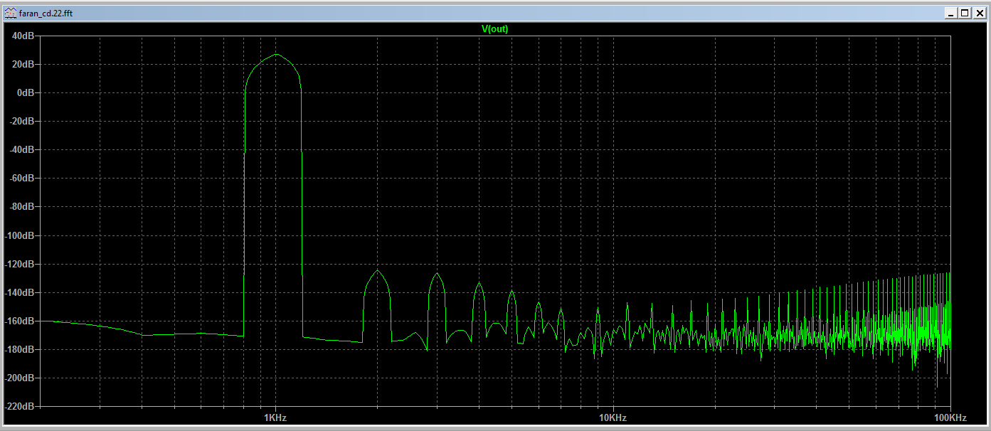

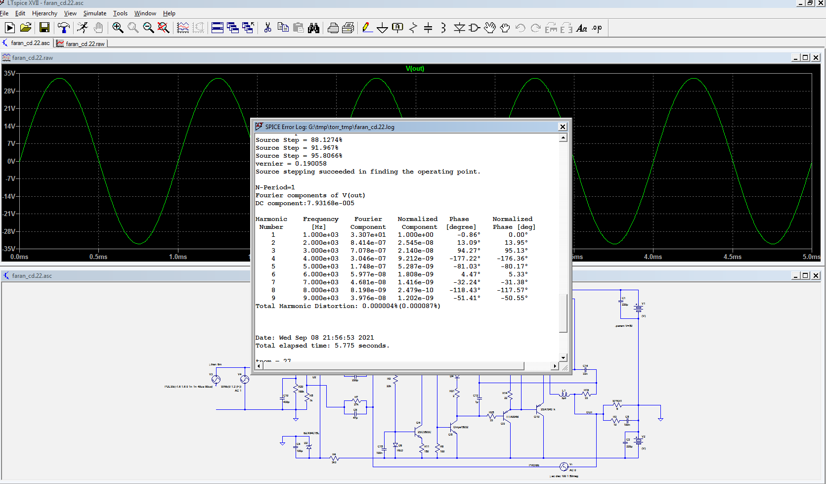

Steve, I tried to sim your latest file from #1635, and the THD is way up.
FFT profile also doesn't look too good.
This amp that you were trying to improve is very stable, both in sim and in actual world. Phase Margin is 69 degrees...

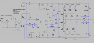

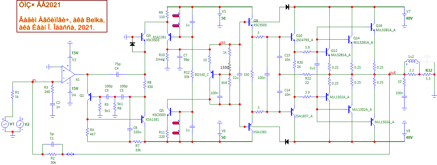

Russian web site
Some times my browser offers to translate and some times it doesn't.
So I grabbed the Micro-Cap *.cir file. Microcap is now free and I use it to view *.cir files. But you get an error that is just the Russian file name. So I renamed it using "yM BB 34.cir" instead of the Cyrillic characters and now Micro-Cap will load it.
I note that this amp also has the huge S-curve phase response. This worries me and seems like there is almost no phase margin at lower (~50KHz) frequencies. I think the standard stability criteria assumes that the phase response at 0dB loop gain is the worst case but that is not true in this case.
BTW, the op-amp is AD8065.
I tried to sim these amps in ltspice, including the same amp Steve tried.
Phase plot is crossing 180 degrees TWICE (or more), which definitely is not acceptable.
These amps are unstable. I built one if them, ignoring S shaped PM, but it was impossible to make it stable. So no more of this for me..
Actually MOST of lmk style amps from that forum is like this, no one seems to mind this kind of Phase plot..
I managed to tweak this amp, so the Phase doesn't cross 180 degrees twice, but it was difficult to lift it ABOVE 180 degrees.
See attached sim in ltspice. THD is very low, FFT profile looks nice,
but Phase plot is still strange, and PM is positive, not negative - Phase crosses 180 degrees way before Gain crosses 0 dB.
And of course once Phase is more or less improved, it's impossible to get square waves in order...
