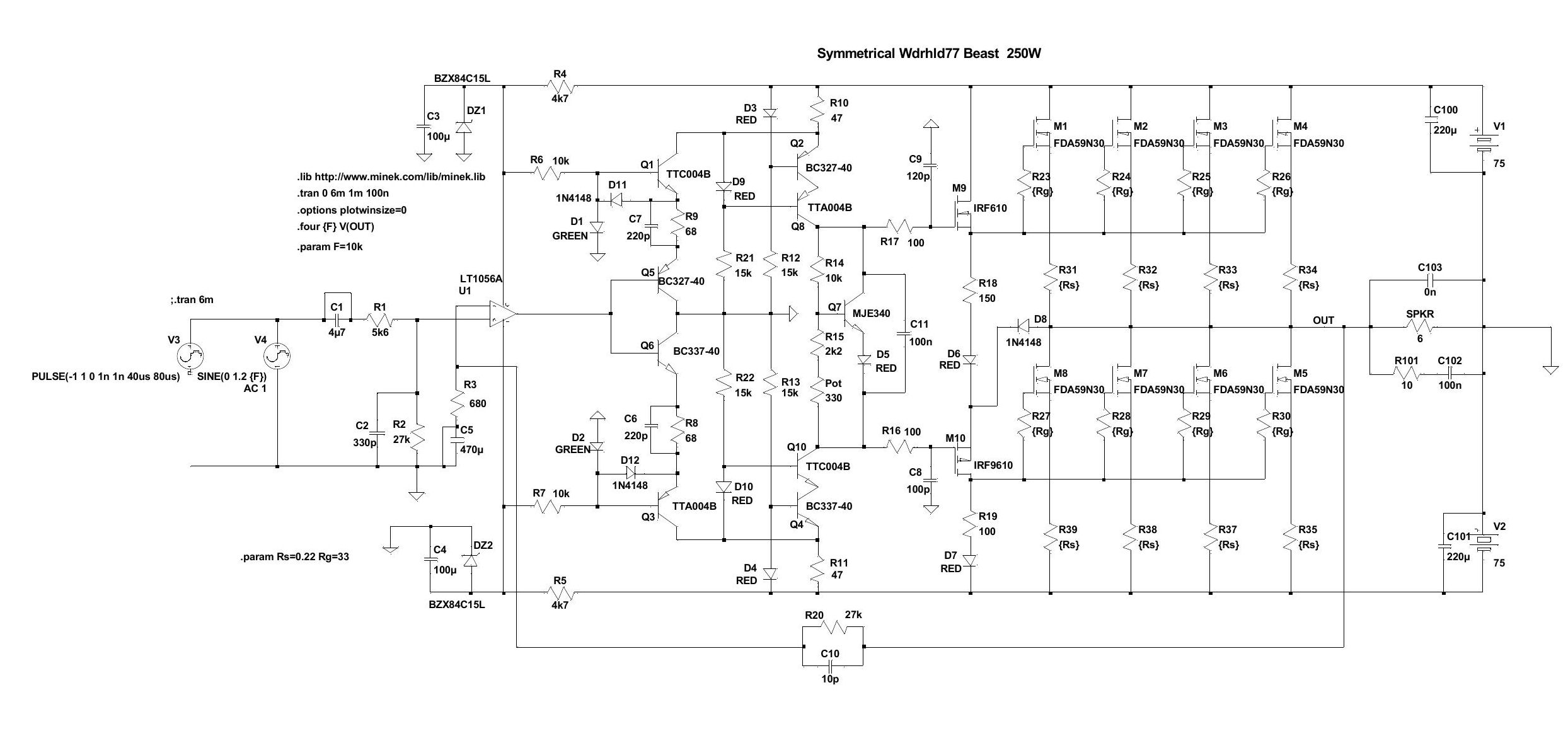

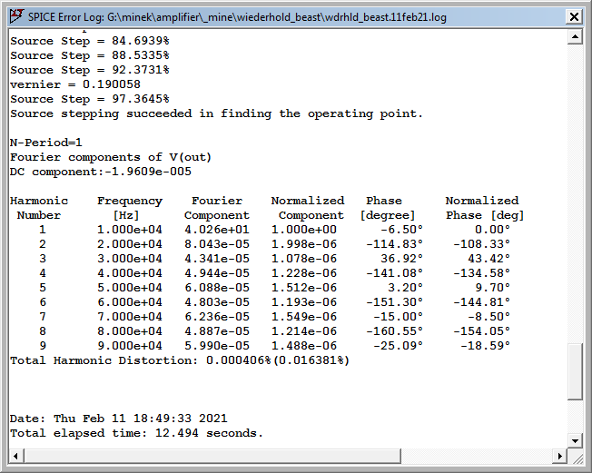

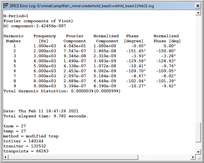

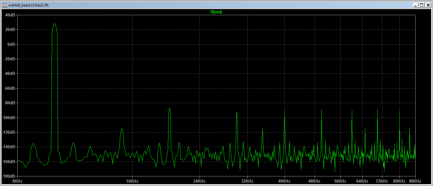

New Quasi Project
Here is what I'm going to build next. Should be good for honest 250W (rms).
Slowly starting to work on PCB now.
Taking advantage that I can work remotely from home now.
Once we are back at the office, there will be no time to play around 🙂
Commute will take all my time I can dedicate to amps..

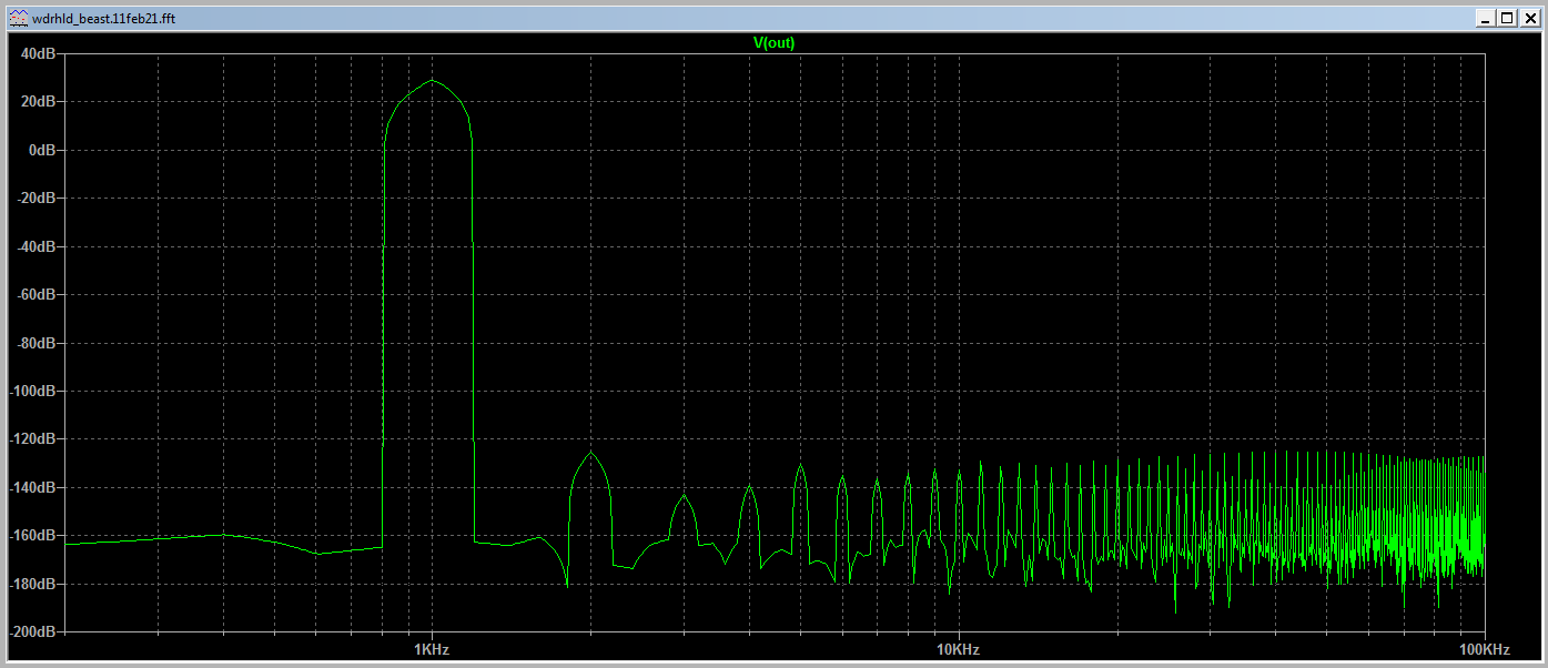

Symmetrical HexFet Quasi, using Baxandall diode placement suggested by SteveU earlier in this thread.
Fet drivers seem to improve everything a little bit.
10kHz FFT could have been more linear..
See the sim, any suggestions for improvements?
Thd and FFT numbers shown at full power.
TTA/TTC transistors used (Q1/Q2), because I have too many of them, have to use them up. KSC/KSA can be used instead (idle current will need to be re-adjusted).
There is so many LEDs here, it will look like Christmas tree..

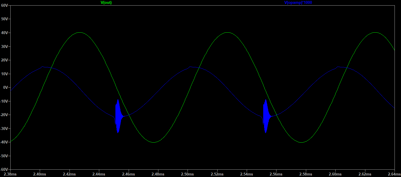

Cross coupling a Baxandal diode is not vey useful driving FETs because the FET vto is a lot more then the diode forward voltage. Looking at the op-amp output shows a burst of oscillation at the falling crossover and removing/shorting the Baxandal diode cleans it up somewhat.
Some suggestions are:
1. The total of two FET vto plus the VAS voltage drop is a lot of lost positive voltage swing. My favorite solution is a partial bootstrap for the driver and VAS.
2. The VAS transistors can be completely shut during clipping, which aggravates rail sticking... So I would reduce the current in Q1,Q3 so that Q2,Q4 never completely shut off.
~3. Stabilizing a quasi is always a compromise. Increasing C8 helps but not a great solution. I have altered the P channel driver load which seems to work but may be hard on the driver.

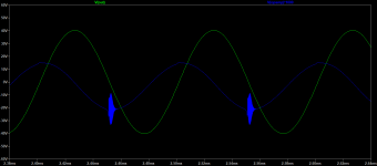

Thanks Steve, I didn't notice this opamp oscillations at 10kHz...
BTW, in one of the quasi hexfet amps I built earlier in this thread, I did not use Baxandall diode,
and in the sim everything was looking good, but in real build I had to add it,
because of visible crossover distortion on the oscilloscope.. The diode fixed it very well..

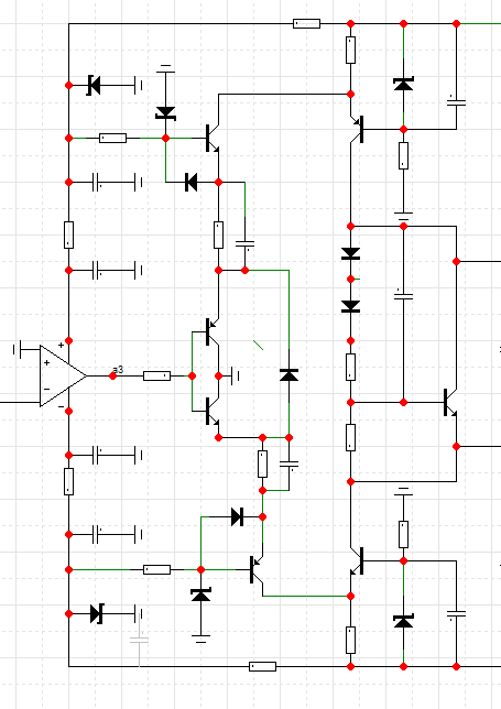

>You will not enter diodes from the clip in the VAS ?
Can you point me to the specific schematic?
Something like this
If there is no overload protection , then you can do without them

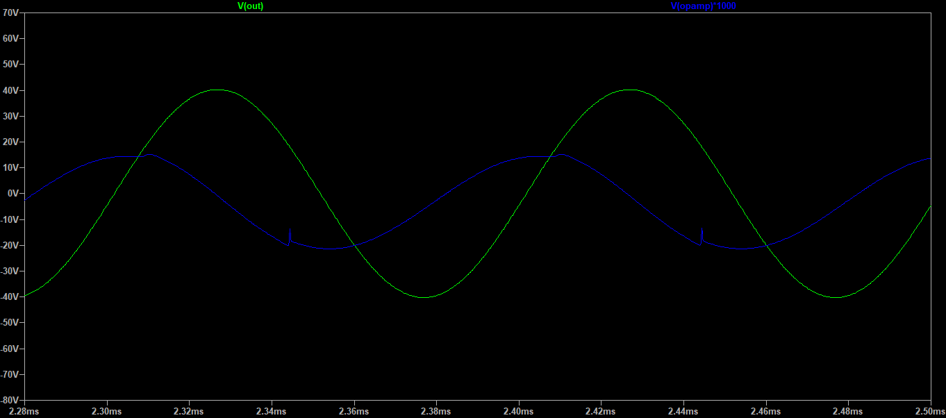

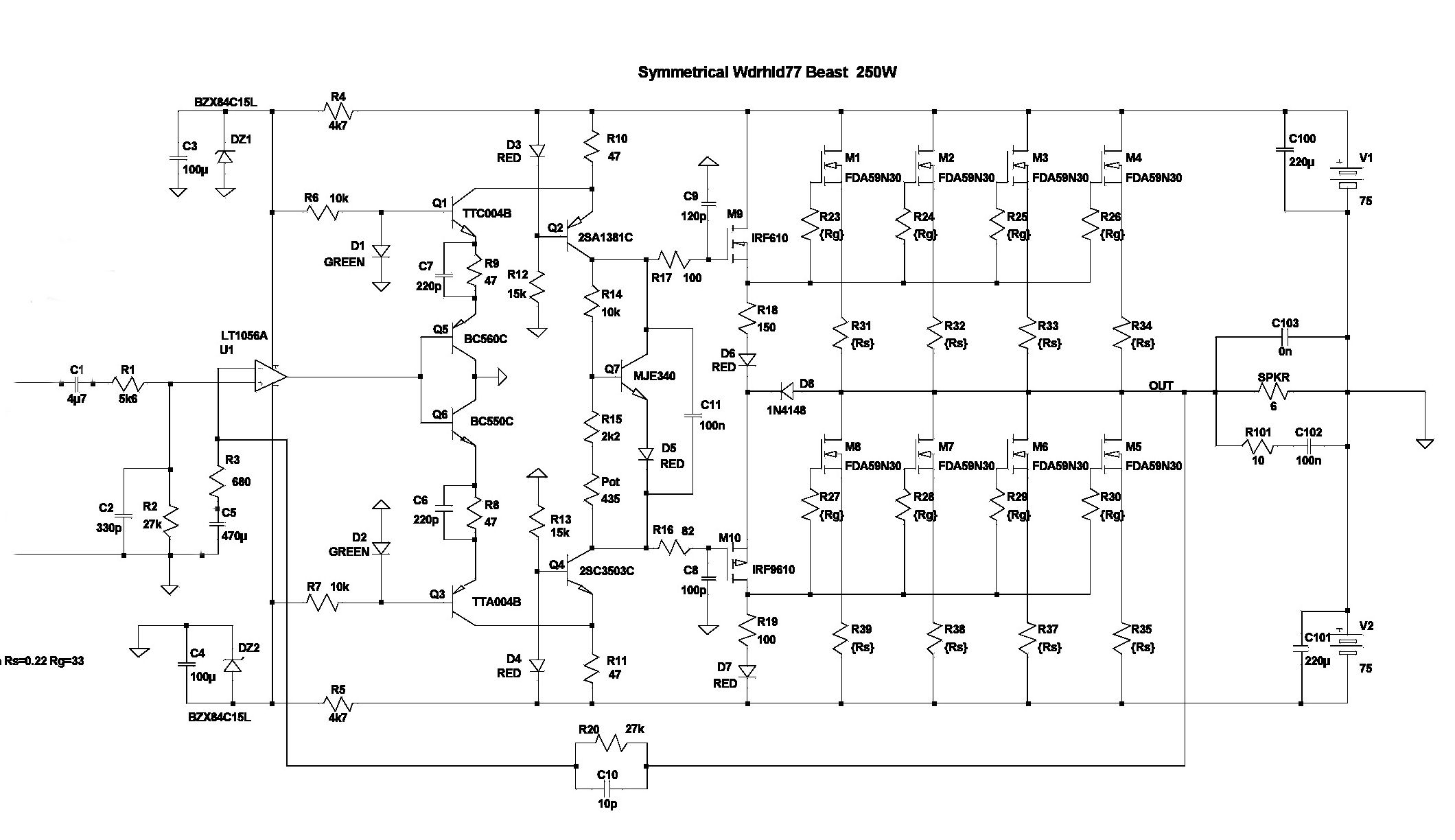

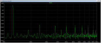

Here is quick update:
a) Hawksford cascode added
b) Maxim's clipping diodes added
c) current in Q1,Q3 decreased so that Q2,Q4 never completely shut off
I'm still playing with drivers and bootstrap, as suggested by Steve..
The oscillation at opamp out is now just a little kink, like in Steve's sim from last night.
So the only reason to add bootstrap, is to make amp more efficient due to lost swing in the VAS/drivers?
I tend to never worry about thing like this (I know, my bad), because I have 2 (external) PSUs I'm using for my amps:
50V rails, and 80V rails.
So all my amps are designed for these two approx. voltages, regardless of their expected power 🙂
I don't mind lost voltage and less efficient amp. BUT - if we can't make it more efficient at low cost, and without sacrificing quality, why not.
