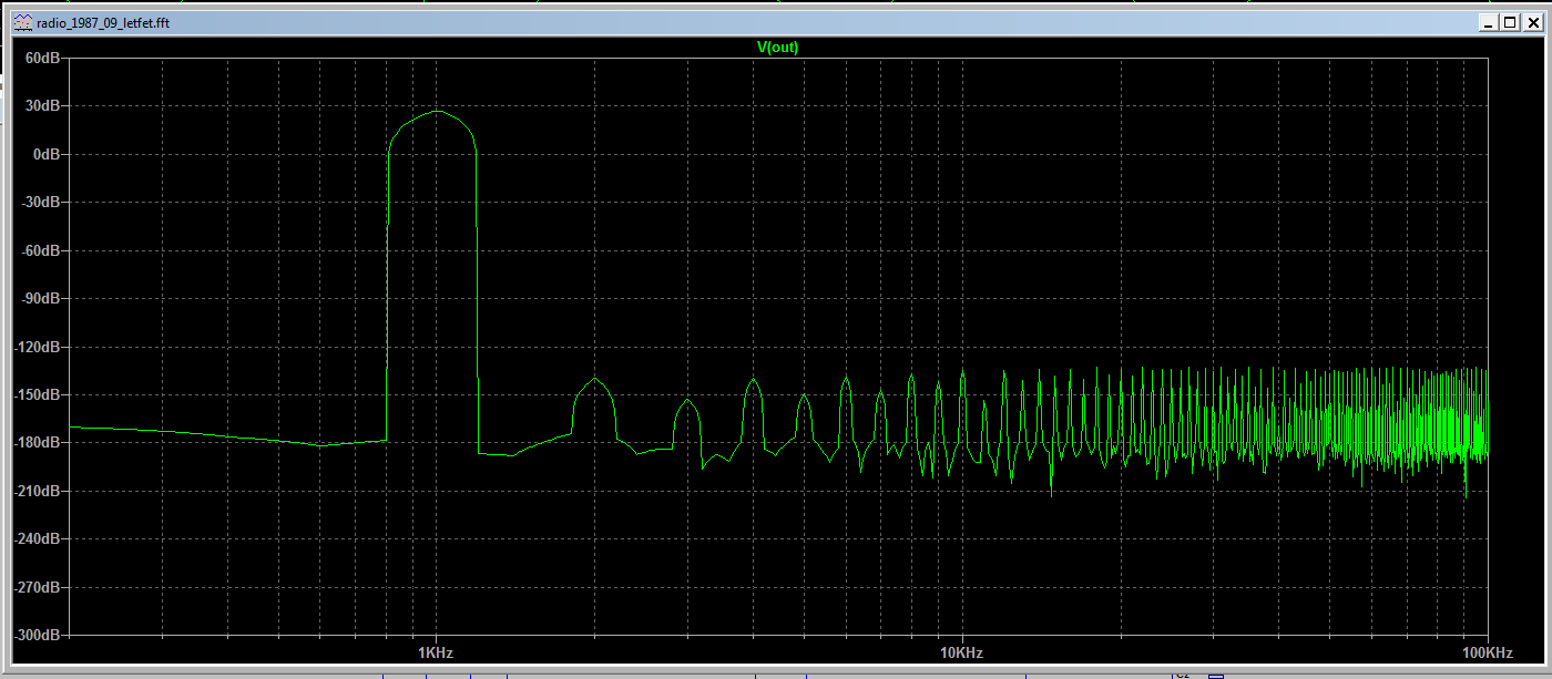

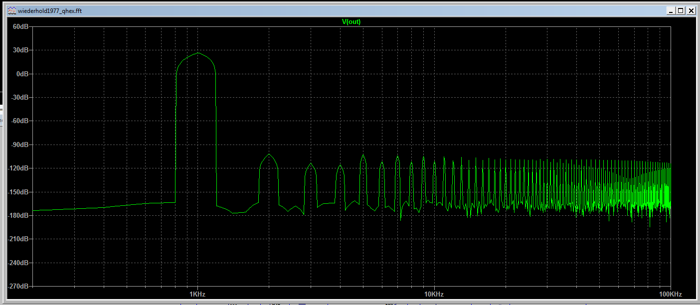

35 / 150 mA (per device), conditions of post #341

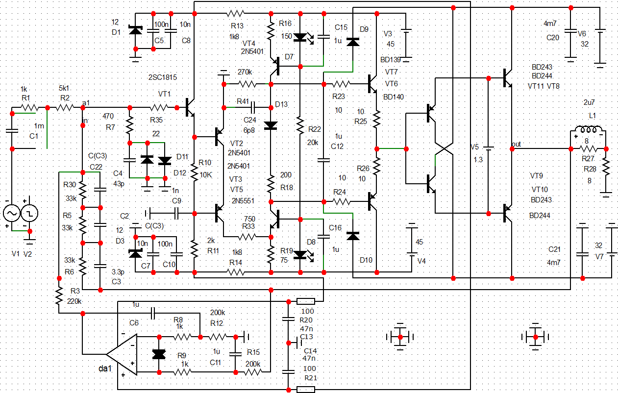

This is the simplest version of Wiederhold amplifier. The opamp reduced practically to a single transistor. This is Valery's "vSingle" IPS. Result a current feedback singleton input, current drive VAS: fast and linear.
"Open loop 1KHz THD is less than 0.05%, with 40db NFB it comes down to 0.0005%, showing around 0.001% in combination with VHex+ OPS (50W @ 8 ohm, +/-50V rails). 2-nd and 3-rd harmonics are dominant, all the rest are significantly lower. Simple light compensation, good stability margins."
Neophyte.Неофит. Discrete amplifier
Joined 2014
How you gonna feed LM78xx from over 40V rails?
Too much voltage...
As for servo - this topology has very stable DC offset.
2mV, and doesn't seem to change...
I'm reffering to the op-amp version, not the single transistor input...
It doesn't make much sense to use single transistor input (why? to save 50 cents over op-amp?),
and then put op-amp as a servo...

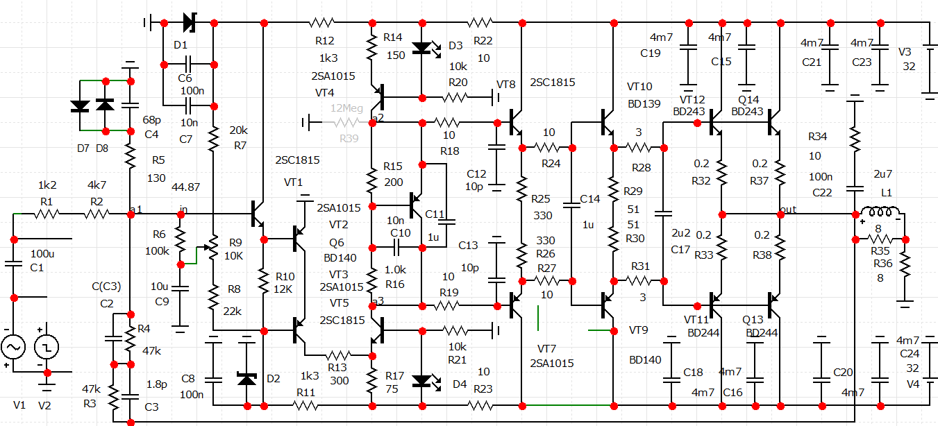

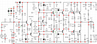

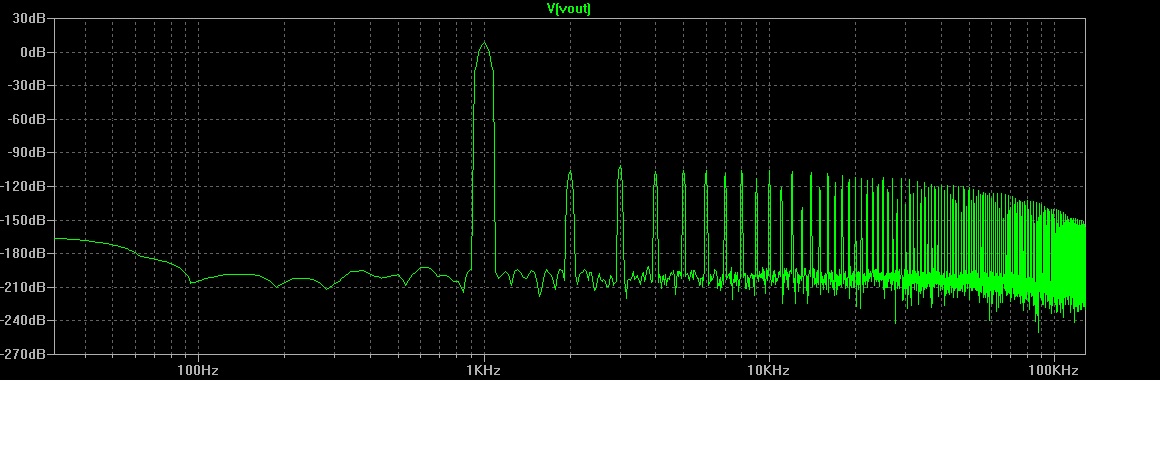

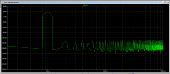

Lomakin Parshin + LatFets
Does this profile look ok?
Lomakin Parshin + LatFets : simplier, smaller, and sims better.
Judging from the BJT version built previously, this will work perfectly..

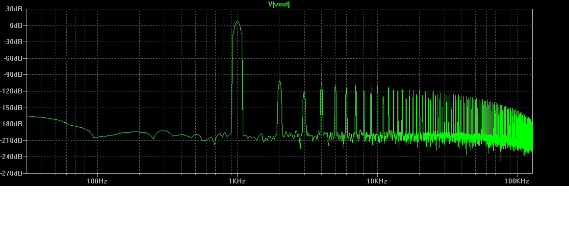

Thd at 44kHz: 0.0025%
I think the best way for high quality and simple amp, is to go with LatFets, even if it's more costly..
No drivers, no heatsinks for them, no temperature sensor, no source resistors, and great results.
LatFet version of Wiederhold amp performs beautifully for the last 5 days, playing non-stop..

minek,
Yesterday I was already playing with the sim and sent you the asc file with D5 added to the schematic and also D8 changed to a RED LED to see how distortion profile has changed.
Today, I replaced Q2 for 2SA1381C, distortion profile is much better indeed.
I've been using MJE transistors, because I have lots of them.
Not because I particularly like them in VAS.. :)
Try TTA/TTC devices, perhaps they will be very good too...
Update: I tried them, not as good in sim as 2SA/2SC pair.
