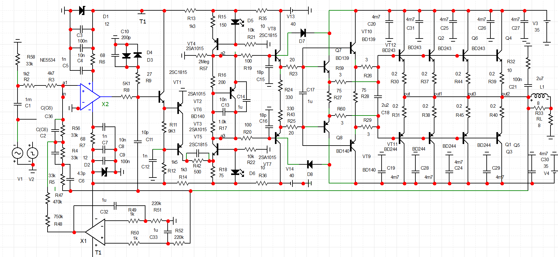

Maxim, in your vast library of these amplifiers you presented so far, do you have one with triple output, but with HexFets? For exmaple LMK with triple output with HexFets? Or can you propose modified output either for LMK or Wiederhold with a triplets/hexfet? I have too many HexFets, have to use them for something...
I only have bipolar transistors.Maxim, in your vast library of these amplifiers you presented so far, do you have one with triple output, but with HexFets? For exmaple LMK with triple output with HexFets? Or can you propose modified output either for LMK or Wiederhold with a triplets/hexfet? I have too many HexFets, have to use them for something...
Specify the type of transistors and the name
> ...triple output with HexFets - Has no practical sense?

3EF
The only reason you need a driver for FETs is speed. At low frequencies a FET gate is VERY hi-impedance and can be driven with almost zero current. FET gates are capacitors about 1nF so if you have enough VAS current to achieve the slew rate that you want then you don't need a drive at all, much less two stages. Typically, you can get a clean 20KHz sine wave (no slew limiting) with no driver at all and you can get to 500Kz with just one driver stage, so there is no point in two driver stages.
By contrast, the base current of BJT outputs peaks around 500mA. A 2EF amp assumes good gain and no less than 8 Ohm load. So if you want to drive 2 or 4 Ohms, you need 3EF or a real high VAS current.

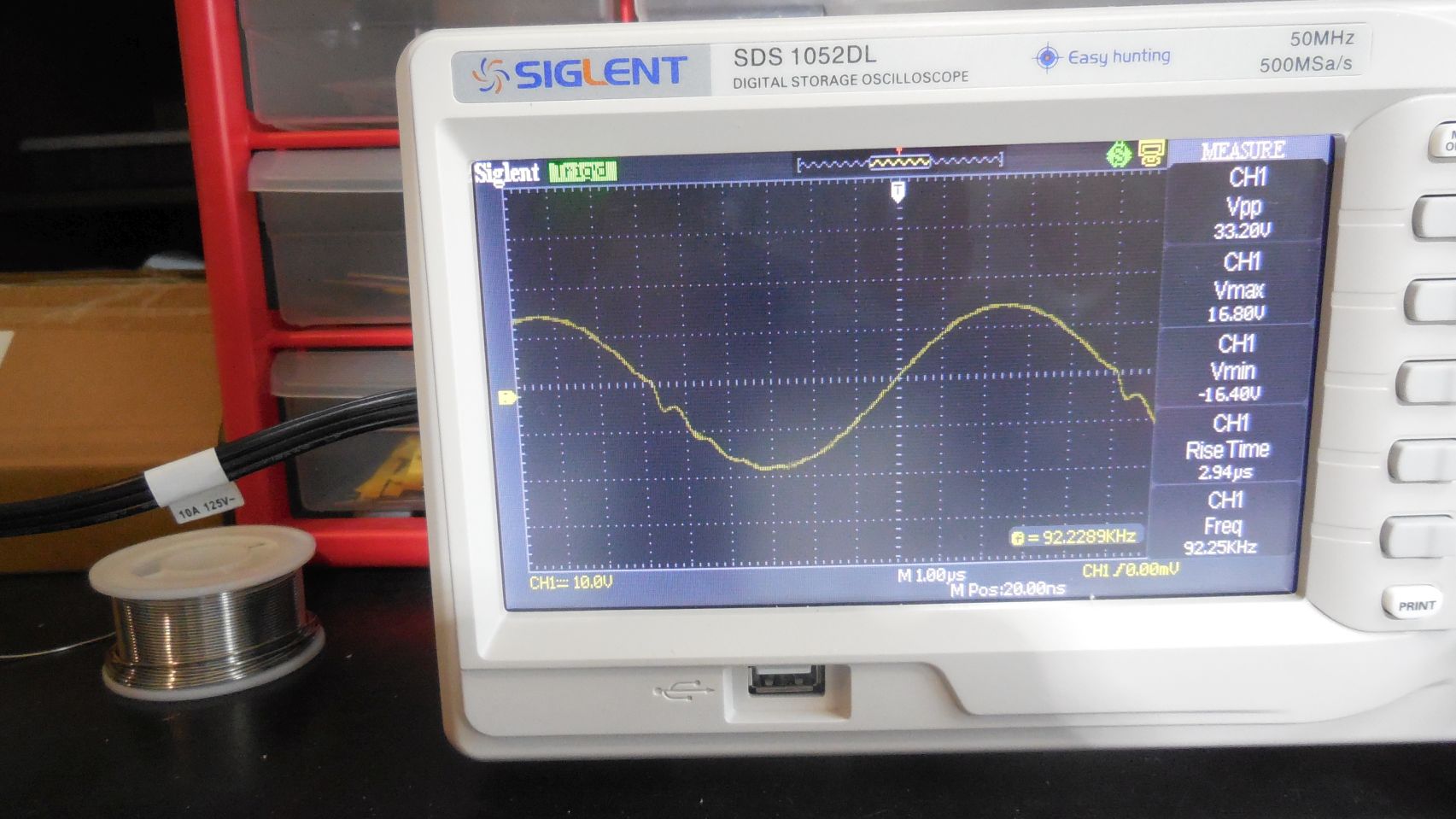

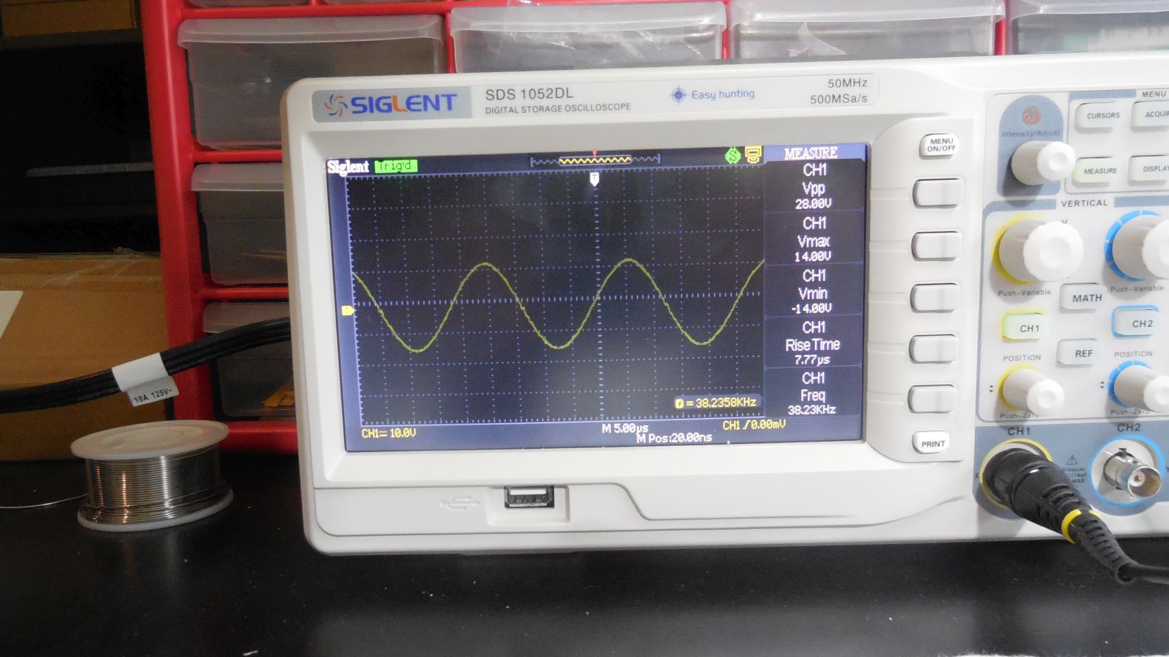

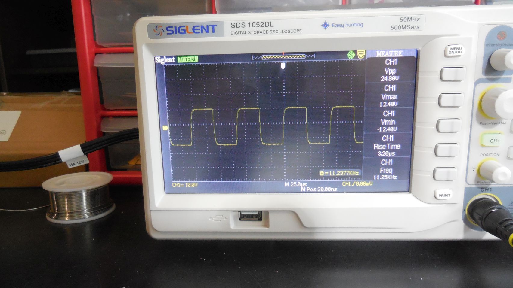

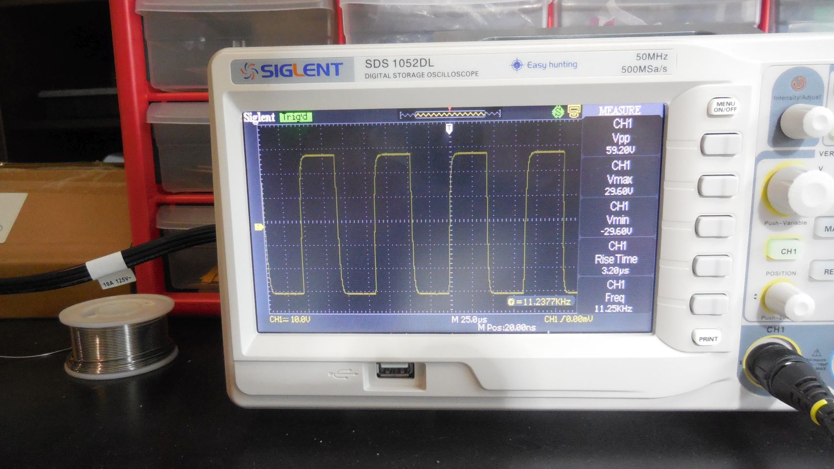

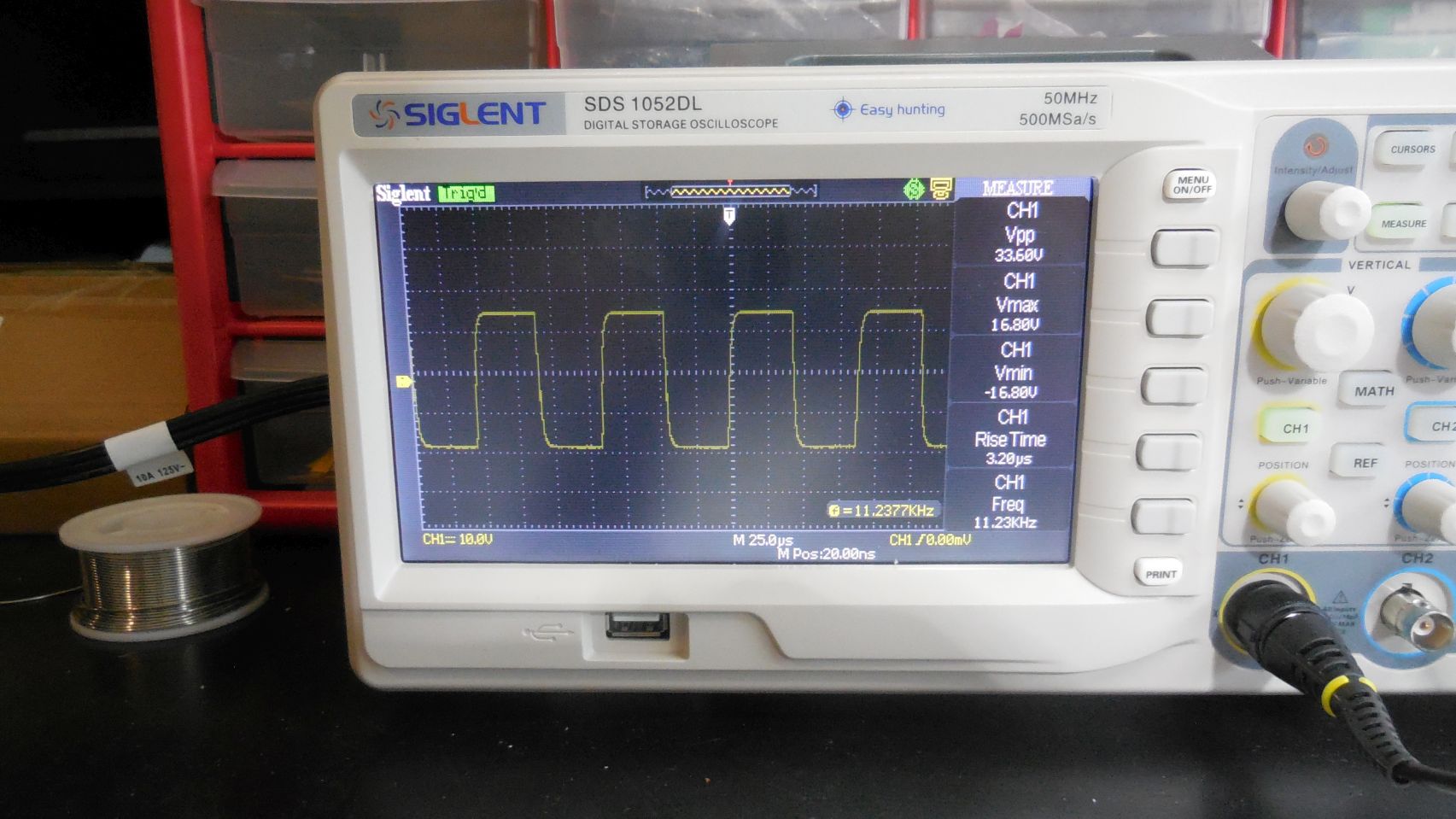

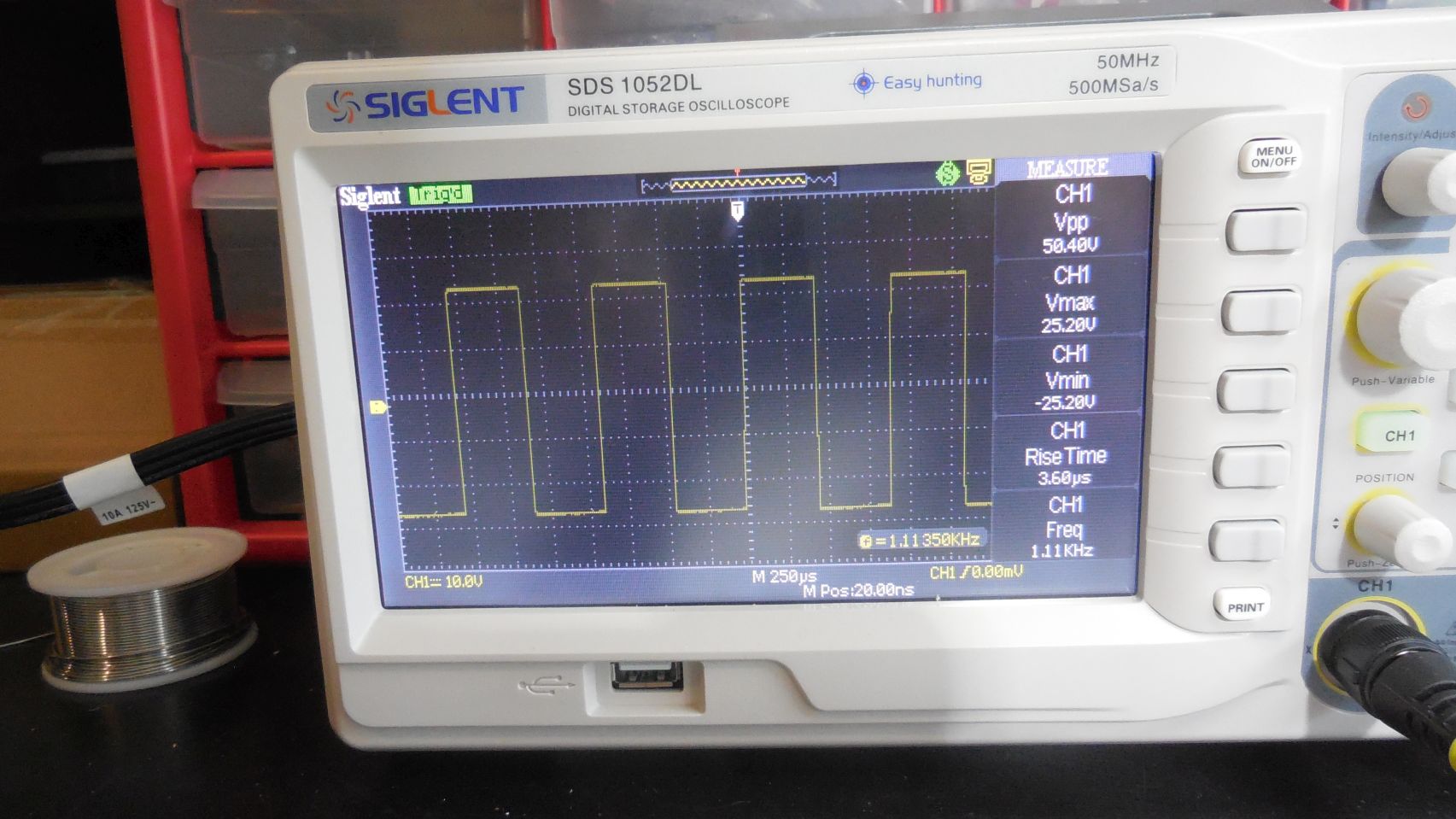

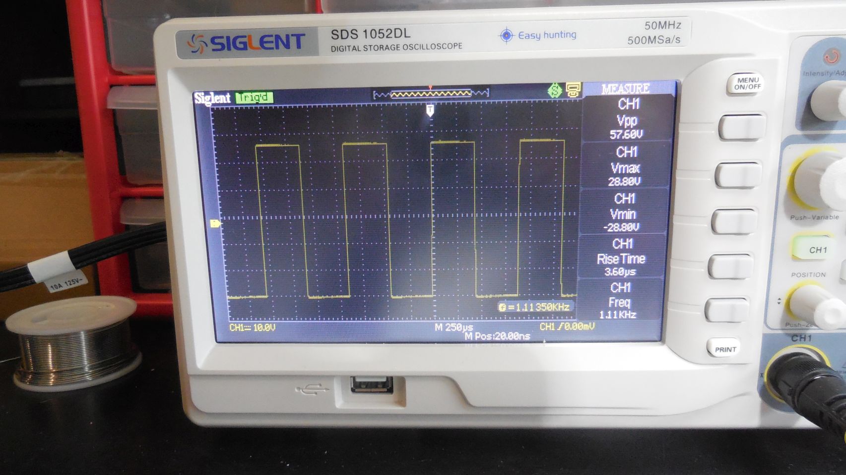

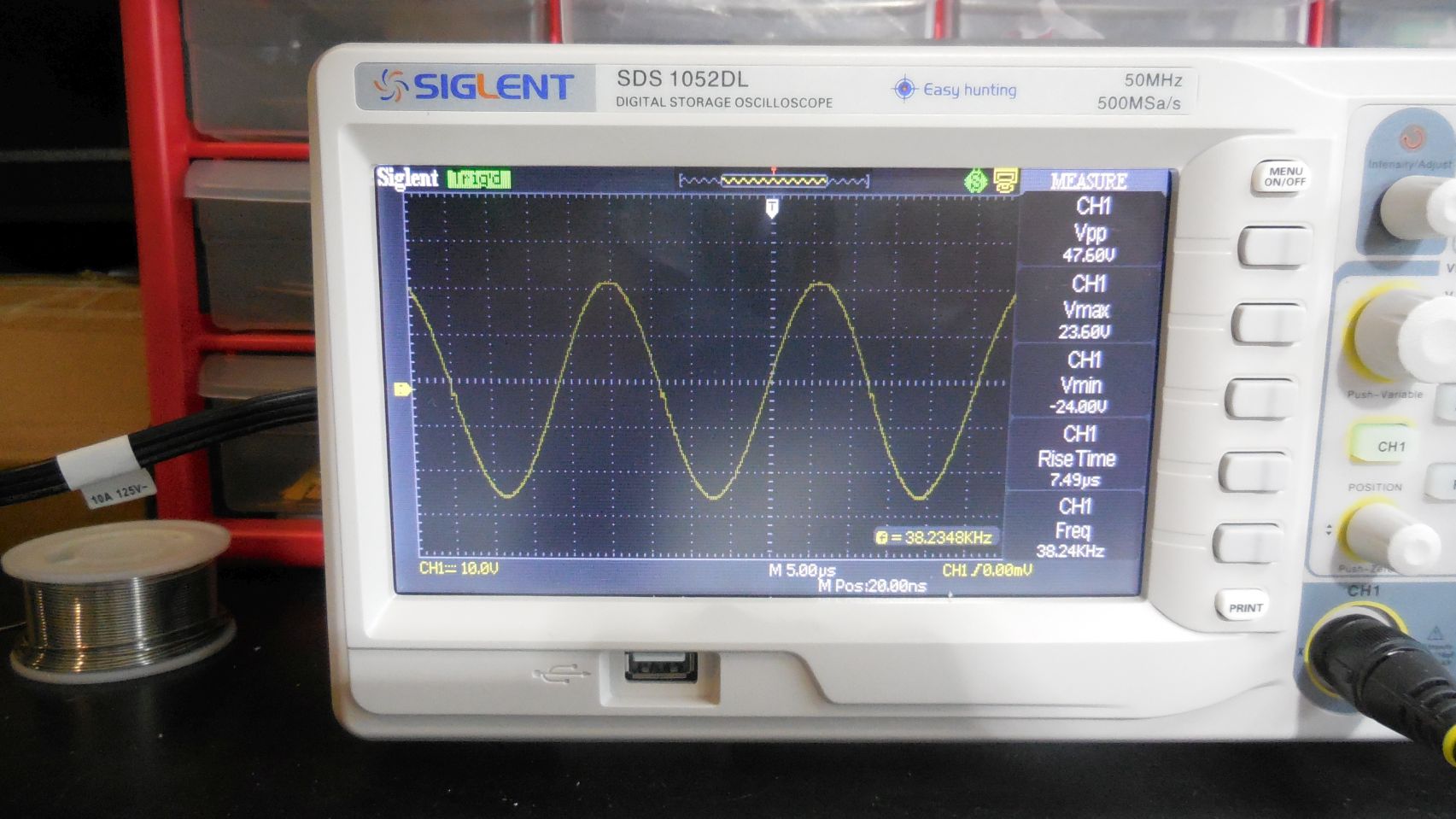

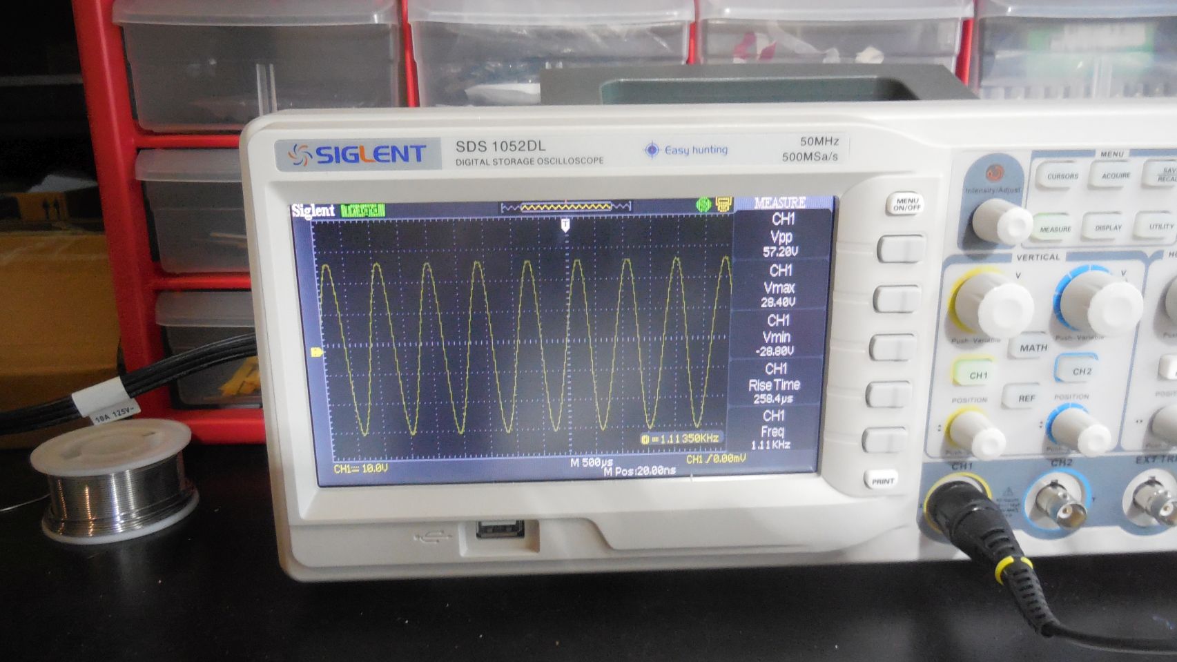

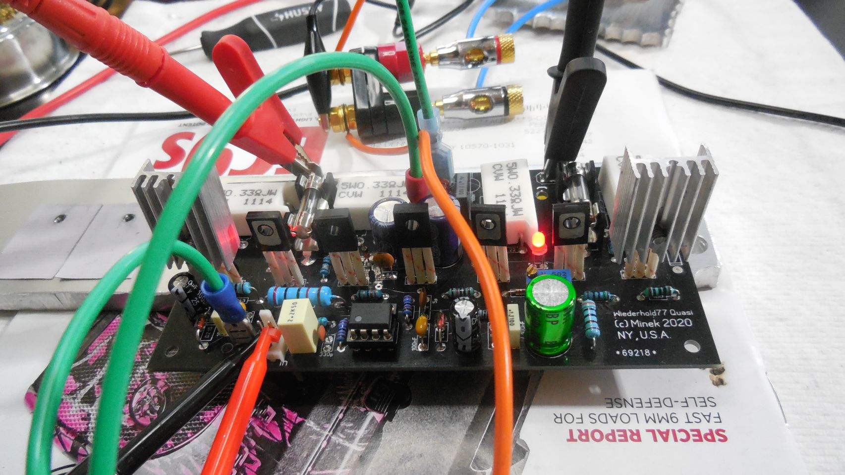

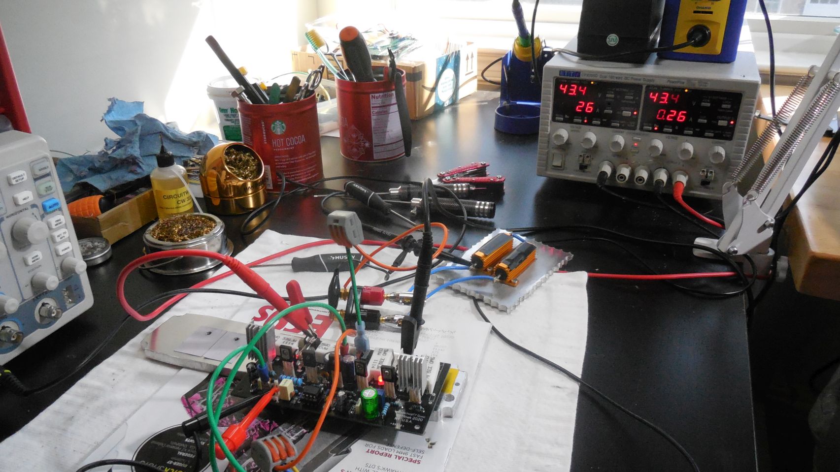

In the meantime - here is Quasi HexFet version running.
All looks good (no music tried yet) on the oscilloscope - with the exception
of small crossover distortion showing up on higher frequencies and higher amplitudes. See screenshots.
Tried to analyze it in the LTSpice; one way to minimize it would be to increase value of R1, but it's a trade of - it makes Thd on lower frequencies worse.
So, since it only shows up at very high frequencies,
perhaps it's something to live with... Should not affect regular music listening, I guess..
Well, it's a quasi...
Any suggestions?
BTW - the idle current pot really needs to be less sensitive 🙂
I just put 5k trimpot without extra resistors...
The heatsinks on small transistors are temporary, in the chassis , it's gonna be one big heatsink for all of them.

And models with quasi have these communication distortions. Can it be necessary to increase the quiescent current ?In the meantime - here is Quasi HexFet version running.
Any suggestions?
I tried to increase idle current, makes no difference.
Each transistor is running at 35mA idle.
Tried up to 100mA, but it's the same behavior at higher frequencies.
