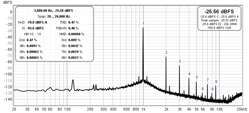

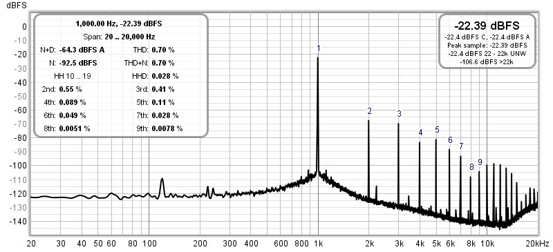

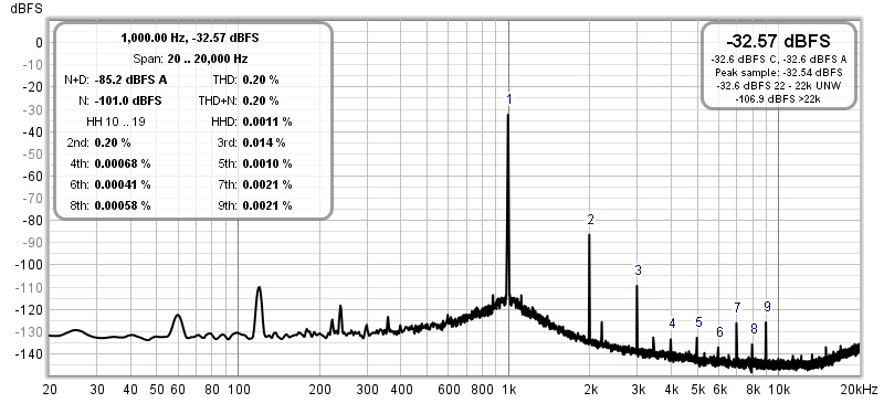

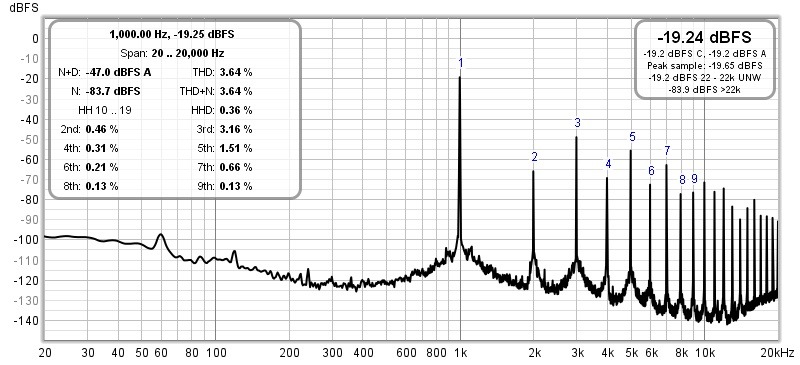

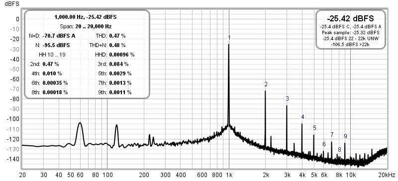

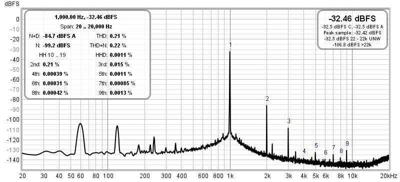

Spent a little time this weekend getting some FFT graphs of the current setup with 26HU5s running at 105mA, 420V B+ measured at C2.
1 Watt
5 Watts
10 Watts

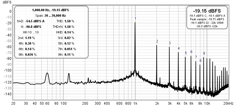

18.5 Watts - This is the point where H3 just starts to become dominant
20 Watts - Starting to fall apart here. Using an inexpensive USB scope I can see the amp begin to clip and with a DMM I can see the screen voltage start to drop quickly.

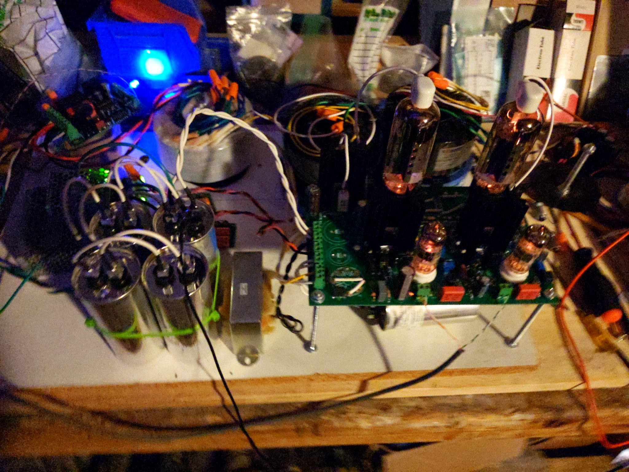

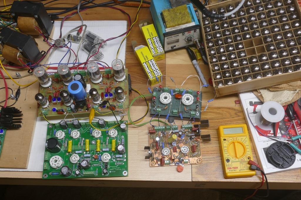

The first use of UNSET / CSD technology was in a push pull amp. That little amp is shown next to a Tubelab board for size comparison. The SPP makes 15 to 20 WPC. The push pull CED based amp makes 70 to 80 WPC!
The original breadboard for the CED is the green perf board seen to the right of the completed and operational push pull amp. It is being driven by a hacked up driver board that I never released. You can see the flying feedback resistors in the spring wire connectors around the perimeter of the perf board. The grid to ground resistors look like 100 ohm resistors in the picture, but they are really 20K. The orange bands are brownish due to some abuse, but theparts are still good.
I have not had the time to go back to this breadboard for more testing.

I got a little silly today and now have 4 100uF motor run caps in place for C2 and a 50uF motor run cap in place of C1. Along with this I hooked up a Pass B1 buffer to see how that works to drive the UNSET since I am still deciding if I want to use a preamp or go integrated. Just complicating my life at this point since it is sounding very good.

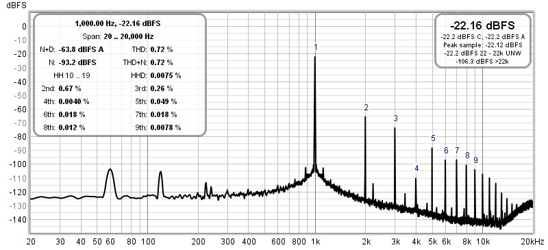

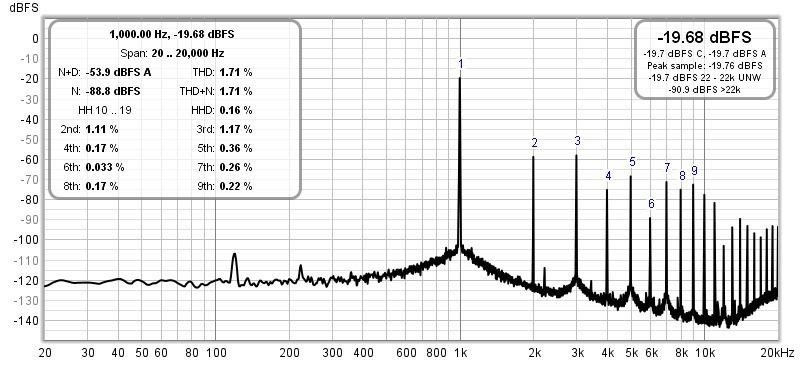

As a test I ran the amp for a couple hours and checked the Triad C-14x choke, it was very hot. This choke is definitely not up to the task with 250mA passing through it. I ended up finding a Hammond 193L to try, bigger and heavier than I wanted but it was available for just a little more than a 159L and the seller could get it to me quickly so I went for it. After hooking it up I re-ran the FFT tests.
1 Watt - Much the same as before
5 Watts - Again much the same as with the C-14x in place
10 Watts - Now I am seeing differences. H2 is more dominant with the 193L choke than with the C-14x. 10 watts is the point I have been focusing on as a measure of overall THD behavior so I like this result.
20 Watts - I skipped right past 18 watts where I measured previously because there was no point. 20 watts using the 193L choke looks better than 18 watts did with the C-14x choke. H2 is still dominant and distortion is at 1.5% THD. Before the amp was falling apart at 20 watts now I think you can easily call this a 20 watt amp.
After I ran the tests and let the voltage come down I put my hand on the 193L choke and it was not even warm.
