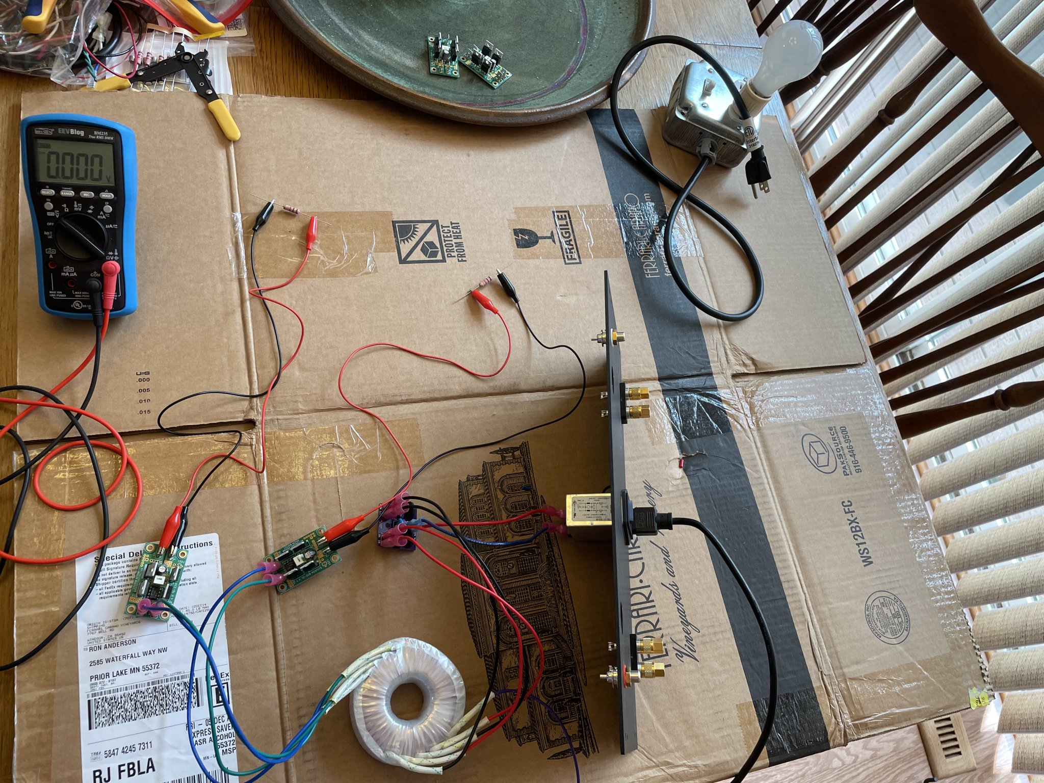

Alrighty - Everyone's fed, I'm re-caffeinated ... and the rectifiers are re-tested / re-verified.
It surprised me that with a 1k load and with no dim bulb limiting current... I set the variac to get almost exactly 18VAC across each secondary, and I was only getting a bit over 22VDC...
I didn't scope it or anything, and I don't think I should have a concern, or should I? I think maybe because it's not smooth DC perhaps... the DMM doesn't show the full amount... I expected to see >25 ... I didn't take notes when I tested them before with all the filtering etc.
Pics or it didn't happen... not pretty, but effective...
Edited to add - Shoot! I should have just hooked up a filter board to test my theory. Oh well, I already gave the table back. :rofl:

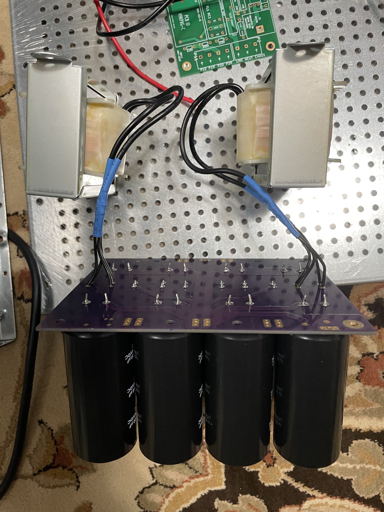

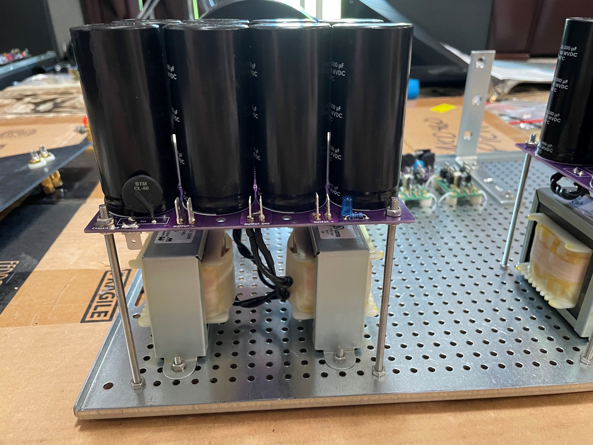

Didn't have too much time to work further on the PSU. I got the major chunks of the filter boards stuffed and made the (HUGE) mistake of connecting the chokes. The only reason I'm posting about it is to share a cautionary tale in case in case some other person has the same (not so) bright idea...
I listened to the advice re: putting the chokes under the filter boards. The filter boards aren't necessarily intended to pair with ~14AWG choke wires. I was too much of a fraidy cat to drill out the resistor holes. Since the boards have resistors in parallel for each spot. I thought, why not do it 'properly' and divide the choke wiring into two segments and solder each segment properly to some 18AWG solid core wire. 18AWG solid core happens to fit absolutely perfectly into the PCB resistor spots... so that must be the best way to do it... right?
Many of you are probably sighing to yourselves...
Solid core wire (and/or my technique) is absolutely horrible for this type of connection to the PCB. Any right angle stress on the wire... snap... grrrr.... :cuss: :headbash:
So, I've stress-relieved it to the best of my ability ... and I have them sitting patiently still until they are ready for final installation. I doubt I'll be able to get much twist in the choke wires w/o putting too much stress on the connection, but I'll do what I can.
A pic to show what not to do... It may have worked much better with multi-strand. If I had to do it over again, I'd have made a small wire loop from the board and soldered the choke wire directly to the loop. Sometimes KISS isn't lazy... it's better too. 🙂
Live and learn...

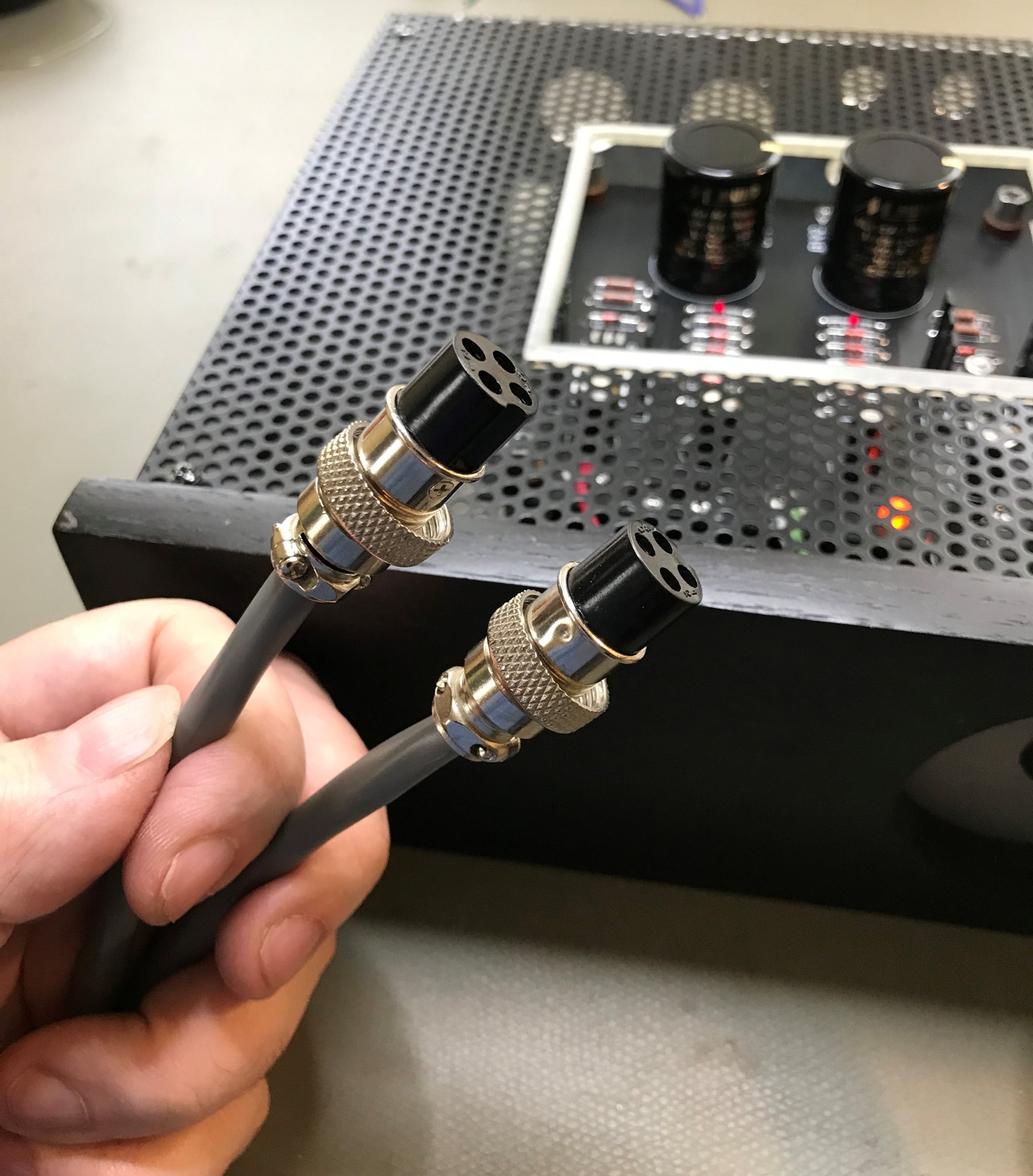

When I was building my transformer coupled 2SK182ES amps, I was also looking for power connectors as I had the power supplies in a separate case. I needed high voltage (200V) at low current and low voltage at high current capabilities.
I found connectors that were suitable, but in practice, they were not easily available in complete sets. I would find chassis parts or cable parts, but not both together. At least, that was the case at Mouser and Digikey.
In the end, I purchased some aircraft connectors because they were available.

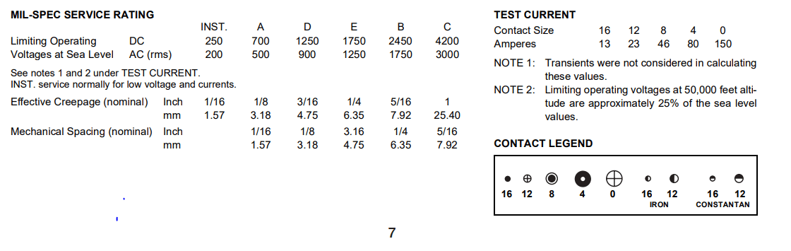

disclaimer "trust but verify".. always wise advise in life.. but here are a couple of Amphenol #'s as a possibility
Amplifier chassis receptacle: 97-3102A-16-10P
Cable mount plug: 97-3106A-16-10S
These aerospace style connectors are not cheap but I personally would not cheap out on an application like this. It's DIY, people can and will do as they wish of course. For a cheap option for low current stuff like the power supply I just finished, I'm trying out these "GX16-4 Aviation Plugs" from the big auction site. They were like $8 for 5 pairs. My plan is to power the front end (not built yet) living inside my amp from an outboard ±45Vdc supply. Current draw will be about 30mA.

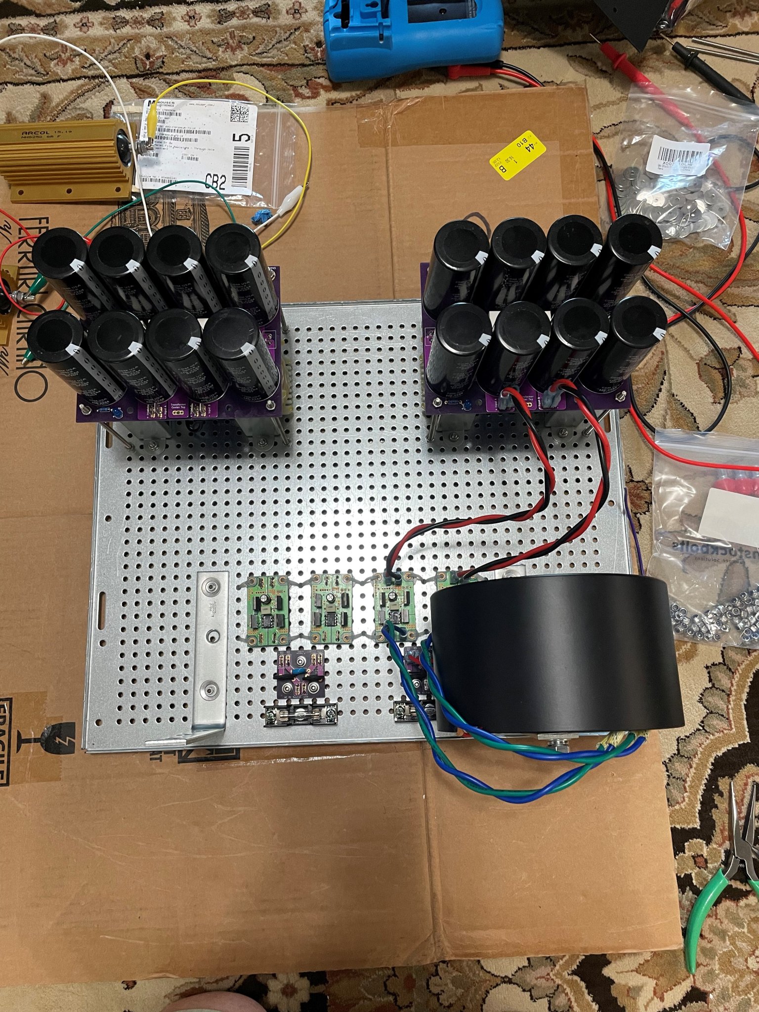

It's coming along slowly. Got a few parts for mechanical mounting. It's starting it to look more like a proper PSU.
Of note ... and trying to listen and implement suggestions.
AC will enter from the back in the middle of the filter boards. It will immediately go under the baseplate. I'm trying to keep AC short (with the exception of the run of the mains from back to front) twisted and away from DC. I'm one of those people that can't bear to cut the primary or secondary wiring for transformers b/c they move between projects so often. However, they're twisted and out of the way.
The DC lines from the rectifiers to the filter boards are twisted to shorten them up a bit. I have them a bit long in case I change the layout. I also twisted the lines for the chokes and mounted them under the filter boards to keep the leads short. The DC output will be an extremely short run to the back plate from the filter boards.
Still working on a decision for connectors... jacks... etc...
Again, thanks to all for the help and suggestions. If anyone sees anything to call out that I should change, please let me know. I've tried to implement all the suggestions and read up on their impact / importance.
Cheers!
Edited to add - I've got some new covered fuse holders on order... even though finger pokin' is verboten... it's better to be safe.

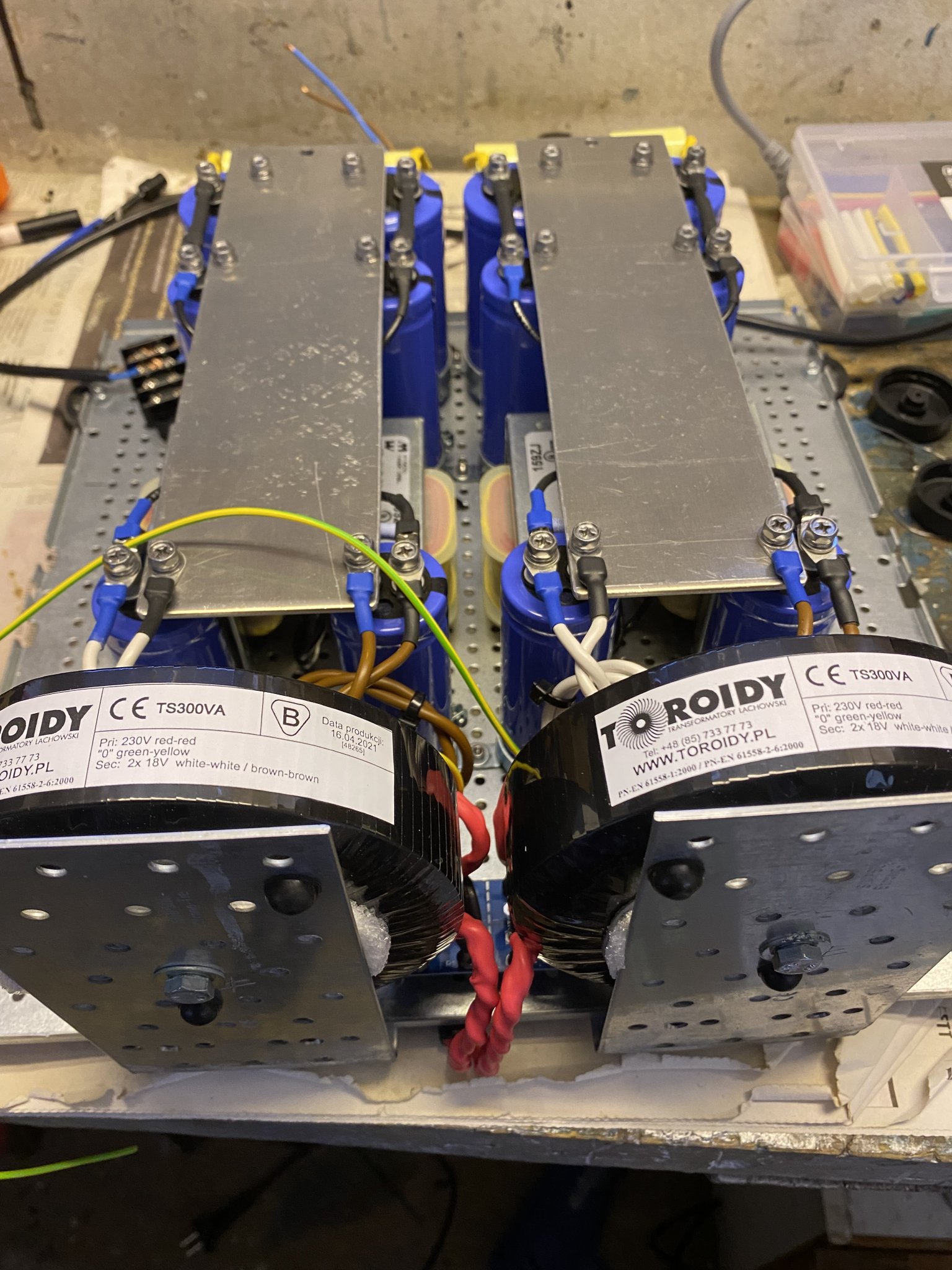

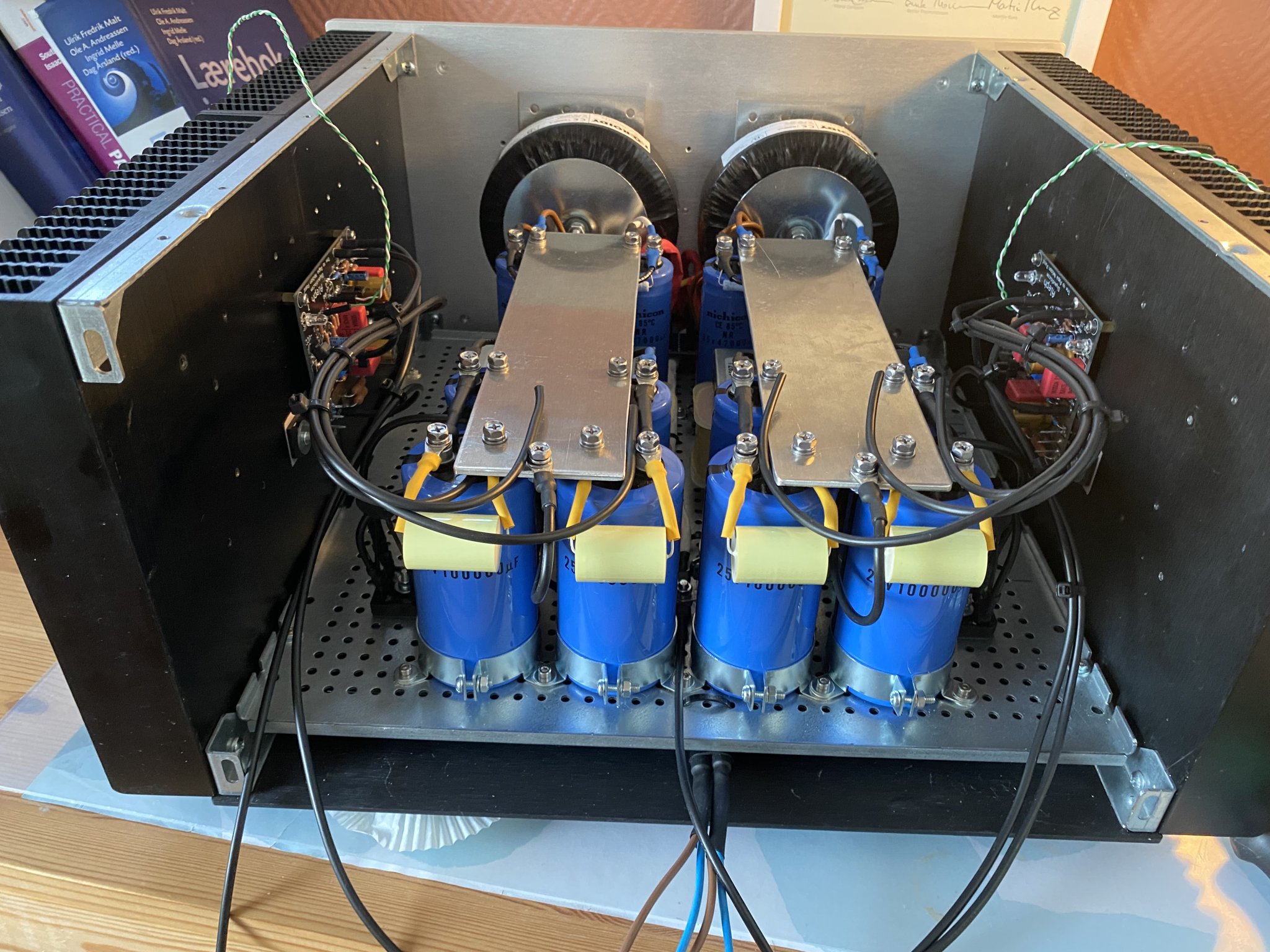

Very nice, Patrick! Will be following this. No biggie but I would perhaps but a rubber knob on the nut facing the chassis front plate, just in case the trannies sway into a short. But maybe your room isn’t dancing as much as mine :rofl: (I put some small rubber knobs on the bars for my vertically mounted trannies. See attached pics you have prolly seen before).
One thing to be aware of is the magnetic field from a conductor radiates concentrically from it, so in the case of your chokes, they project out from each side of the exposed coils. Generally, I orient my chokes so as to minimize the influence of the magnetic fields on other components.
In your case, placing the choke pairs at right angles to each other would take up more space, but I would consider placing them in a "V" formation. Without measurements, I don't know what difference it would actually make, but it is something to consider.
