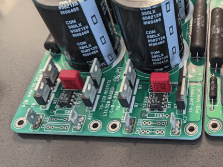

I considered it. I have several of Prasi's boards... both TH and SMD... but ... I think ... I'd have to double them up to get to my 50V target ... wouldn't I? Used them for the Singing Bush supply. I shamelessly copied Botte's work.
Edited to add - Prasi's boards also have provisions for snubbers... but I never know when they're needed or not... I assume, but I'm not sure... if you're saying that I don't have to worry about snubbers for the rectifiers vs. the transformer ringing?
Edited upon edited to add - If I need to double them... even though cost seems to be no object in this, I need to keep a bit of a rein on it... I think I'd need 8 boards / sets of devices. If that's the case, I don't have enough parts / boards... and unless there's a compelling reason, I'd avoid that extra cost over things I have on hand.
Still, I welcome thoughts around that concept.
I was just in the middle of typing about the AR solution. I switched over to the LT4320's for my amps ~1 year ago. No complaints yet. If I had to give a rough guess, I'm probably getting ~5% better efficiency with those. Went from legacy bridge / MOSFET cap multiplier to an AR / CLC and rails went from 22.7V to 28V, still very low noise....

^ Hmmmmmm.... Then I need to do more reading and understanding.... or check my specific parts and boards.
I had it stuck in my head when using them for the Singing Bush (single rail +63V, I think) that the reason I needed to use two in series along with the arrangement chosen was because of the voltage rating for the parts.
I completely misinterpreted and/or missed something... I also have 4 of them right in front of me...

Looks like we're going with those. I have the parts and boards, and they by all accounts seem to be 'better'.

  • LT4320 'ideal' rectification with Prasi's boards. They have placement for snubbers, but I am not sure how to best implement snubbers b/c I will be swapping transformers as needed. Thanks to the most recent advice, I'm heading this way.

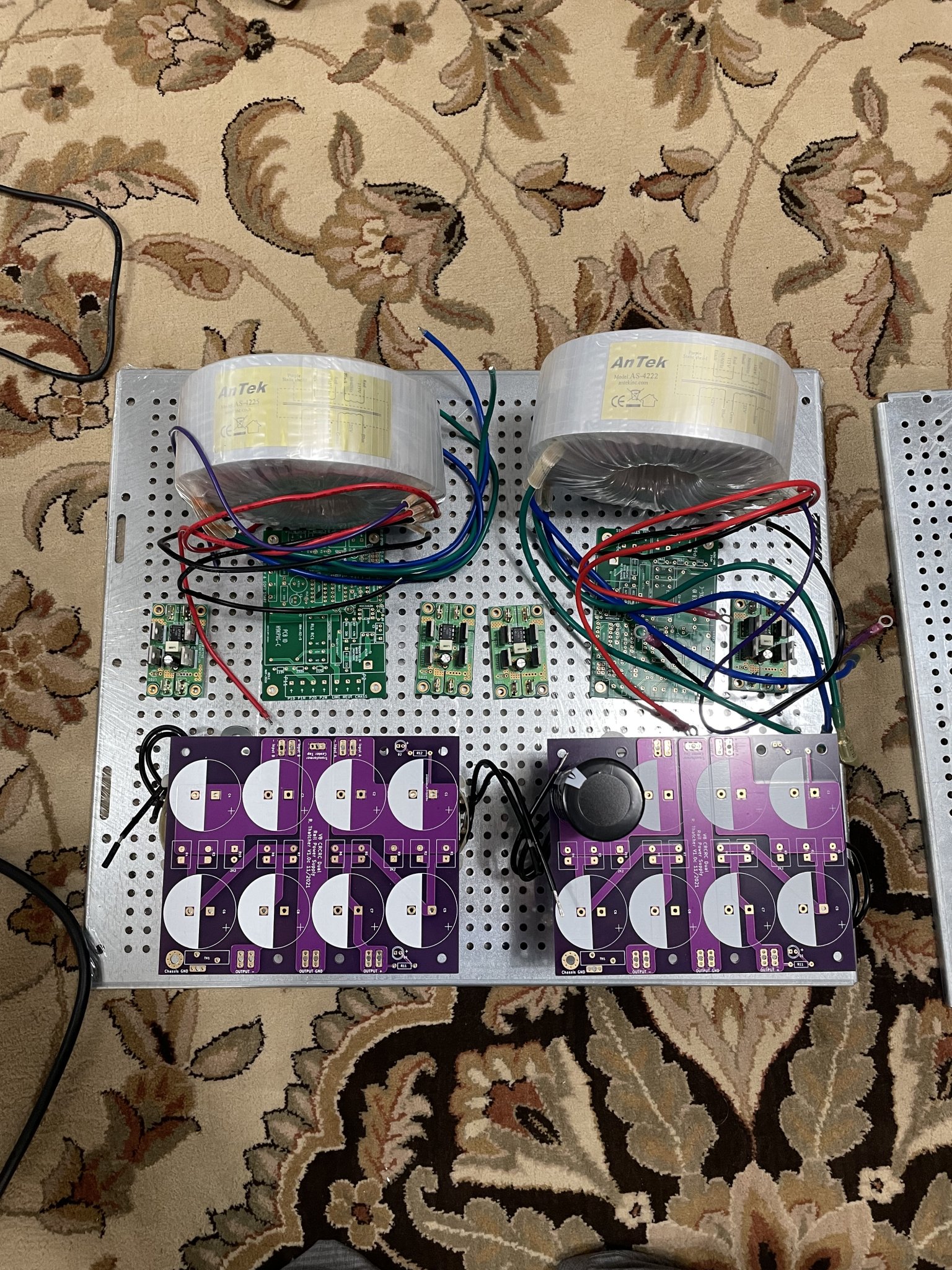

Just got my delivery from ModuShop... 🙂 So... this is roughly what it may be on the floor plan... I have a bit more room to work... the floor is bigger b/c of no heatsinks to take up width.

In just a "what I would do" comment... I would go CLC outboard, the DC umbilical wiring itself serves as an "R", then a final "C" at the destination inside the amp, at the load. So it's CLCrC. Sorry if something like that was already proposed somewhere, I didn't read the whole thread.
Reactions: Uunderhill
^ Everything is greatly appreciated, and it would be silly to think everyone could read everything... particularly my walls of text... I need to try typing with one finger, so I slow down...
What it will likely be is...
PSU Chassis - CCLCRC => Umbilical acting as R => Amp Chassis - Elecrolytic 33kuF + Motor Run 50uF.

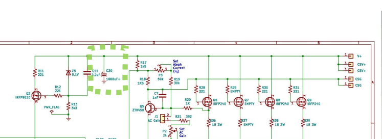

... I'm still getting my head around decoupling vs. just extra 'fast' energy storage close to where it's needed via low impedance.
Simple explanation for decoupling capacitors. They provide a low impedance path for AC in the power line to ground. Wires can pick up noise. Also, where a single power supply feeds multiples stages of an amplifier, they "decouple" the stages from each other by diverting any AC from each stage to ground, so the other stages are not affected.
For the decoupling capacitors to work best, they should be as close as possible to the active components of each stage. Otherwise, the connecting wires will pick up noise.

If I may use an example. I'm actually building this amplifier (the Aleph 60 schematic section below). I have the first version of boards w/o C20 included. That cap (and its partner on the negative rail) are exactly, I think, like what Ben's describing above in post #136. Some amps have it... some don't. Is that ... decoupling? When I look at the articles of how decoupling is incorporated into designs... it's exactly like that; a cap of some size between the rail and ground. Depending on the article, and whether there's a bypass also, the size of the cap varies.
If it is "decoupling", then where I get lost in the mire, is ... what AC? That's the DC supply. Are we filtering AC noise? Then wouldn't the value of the cap be very, very important? AND/OR are we a localized power storage to the rail to keep the rail voltage as stable as possible ...
I fully admit that I understand the words so clearly. Your explanation is perfect... I just lose that last little bit every time I try to apply it.
So, as an example... instead of the 1000uF cap on the board of this amplifier, I will have a 50uF motor-run film cap in parallel with a 33kuF electrolytic. At least I believe that is how I understood the voodoo of how to do this.
