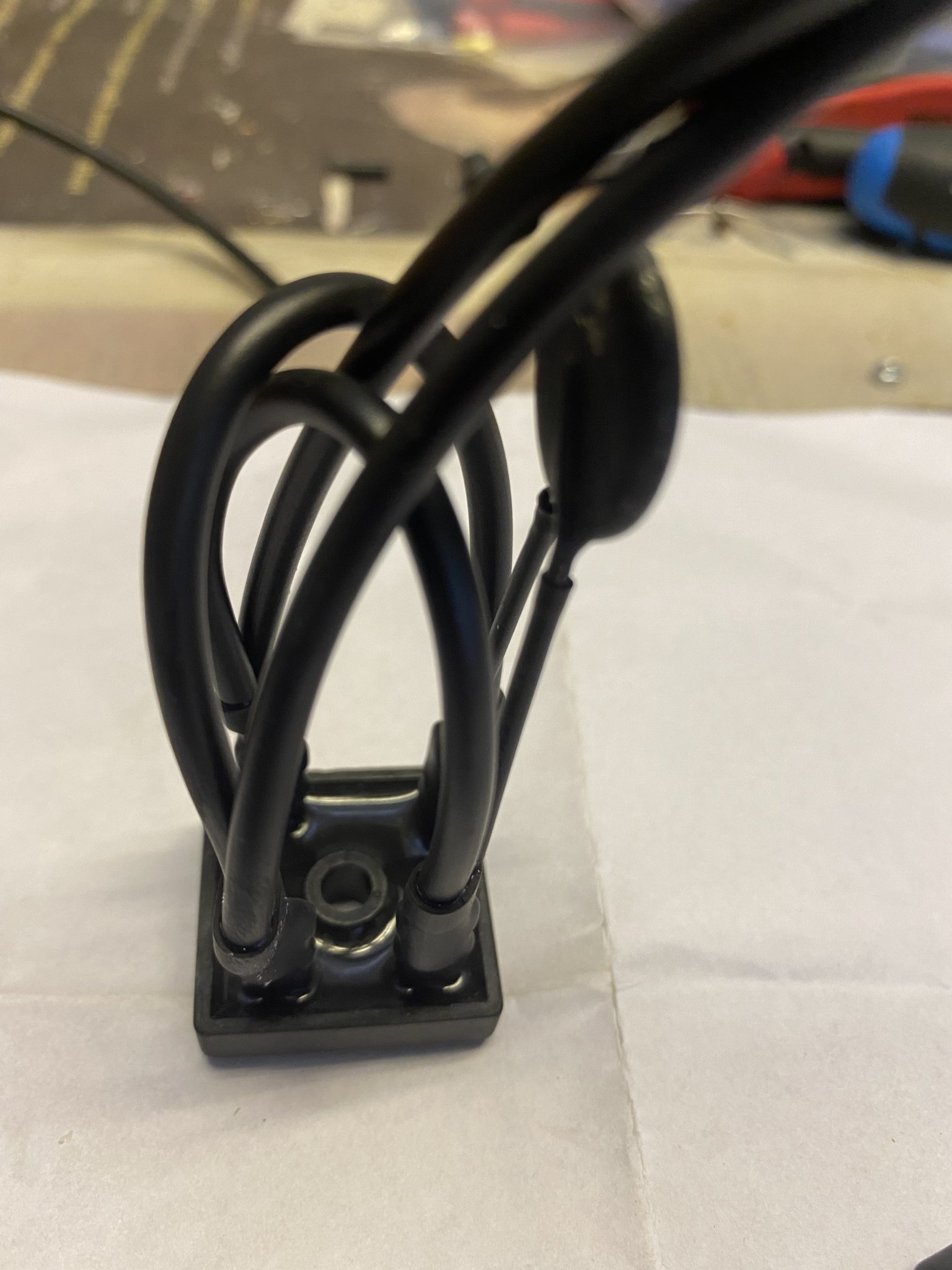

I am debating... taking the filter boards off ... desoldering the Fast-On type blades and direct soldering my lead wires. I'm also debating doing the same for the amp boards, but that is a royal PITA.
Most likely that will happen during the next "re-do" or maintenance.
So, the board attachments will still be the blade type going to the Powerpole (for now). Powerpole connections inside each respective chassis.
The pros / cons I've considered...
Chassis mount - Cons - Double the connections / connectors. Big, rectangular holes in whatever chassis or both it's used on. Pros. Clean look for easy connect and disconnect on either side w/o removing the top plate.
Pig tail with connectors outside the chassis on one side or both. Pros - Don't have to take the lid off to disconnect. Cons - Not quite as "clean" a look to me. 8 wires all connected outside the chassis. Not that I need to worry about it really at all, but it also presents the opportunity for little hands (or big dumb doofus hands) to disconnect them unintentionally, which could present a safety hazard b/c I would likely go off the rails (along with the amp).
Connections inside the chassis - Pros - Clean look. Small(ish) round holes that are easier to drill vs. chassis mount block. A bit safer. Cons - need to take the lids off whatever gear needs to be disconnected. Typically, I'd do this only once a month or so, and likely only on the amp side.
I still haven't decided on a strain relief mechanism. I'm looking for something kind of like ...
https://www.amazon.com/Electric-Pro...ower+cord+strain+relief&qid=1690799526&sr=8-8
It needs to clamp the umbilical, so accidental tugs on the umbilical from the exterior don't pull the connections inside the chassis. Also, it needs to provide protection against friction of the wiring against the edges of the chassis.
Those types are pretty common, but any other suggestions are welcome.

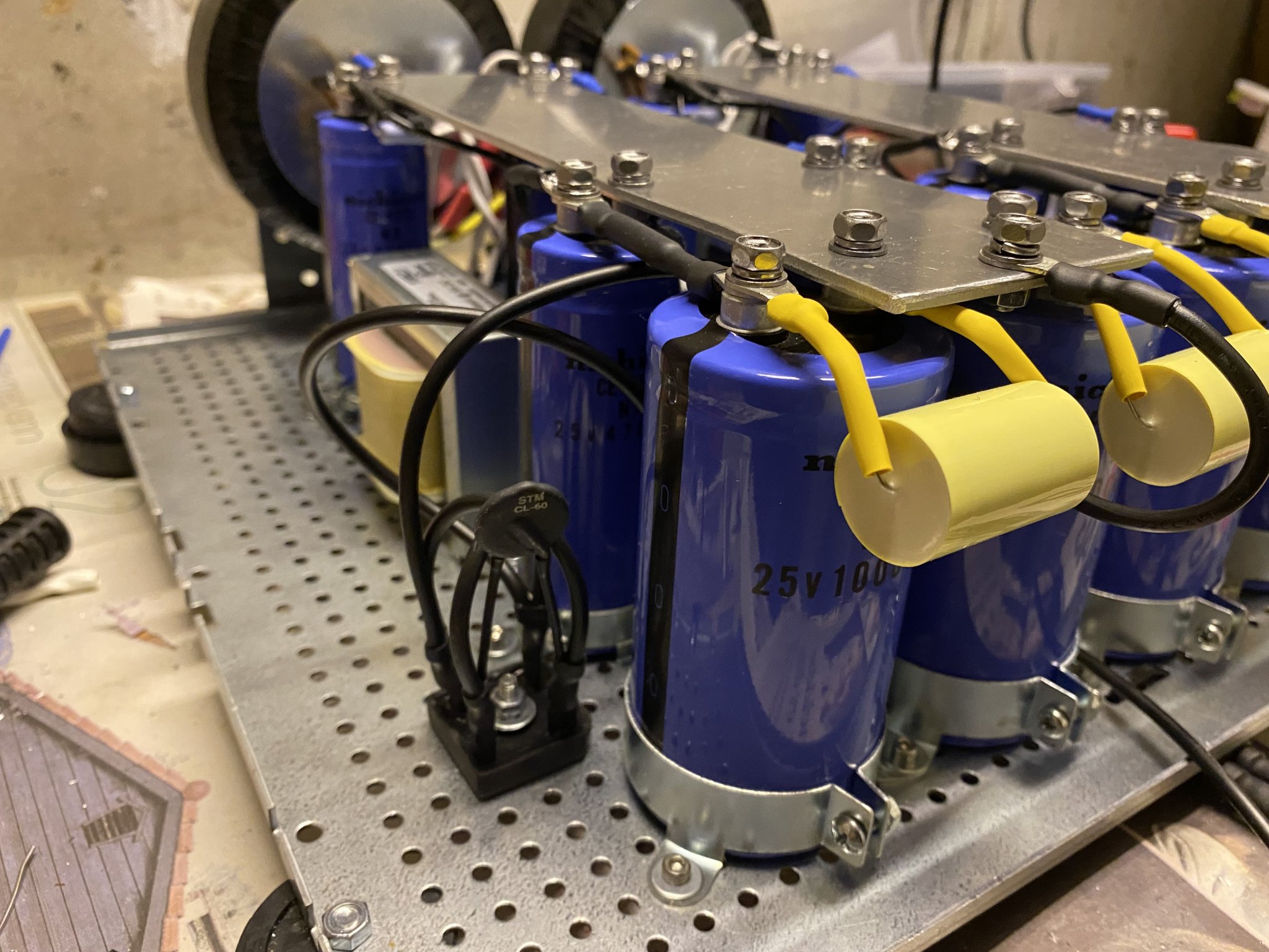

Got both amp boards mostly biased up... still tweaking. I haven't done the AC gain yet. I'm going to get things more permanently mounted / neater. I may put some tunes through it before getting it all fully inside the chassis for final tweaks.
#dodotip - It's wise to change out the weakling test fuses in the main IEC to something that will actually handle the full current before powering up both boards at full bias w/o a dim bulb or ramping up the power slowly. ~4A5 makes a 2A fuse go poooooooooooof. Follow me on social media for additional methods to cause frustration during amplifier builds.
