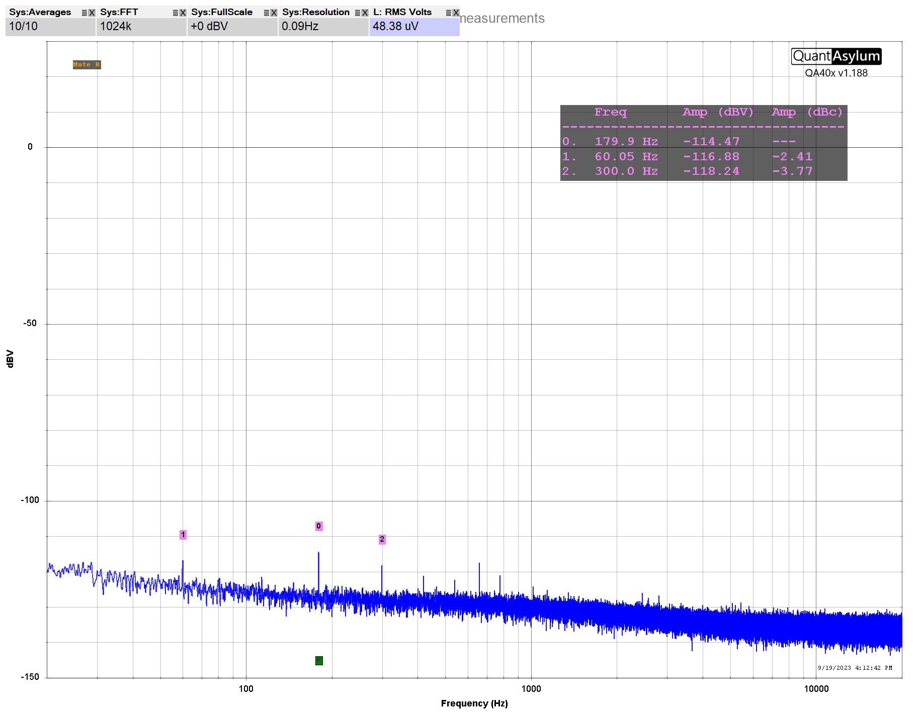

The measurement was done connected to the amp under power with no signal and an 8R dummy load. There is no noise at the speaker whatsoever.

Edited to add - this is the profile of my "typical" CRC. Ignore all the meaningless other measurements at the top. Was learning how to add measurements to my display and graphs... :rofl: Difference is that I needed to use a larger 1024 vs 128k FFT and 10 averages vs 4 to discern any of the 60 Hz peaks in the other PSU. When run like below, none of the peaks were evident. I'm not sure if that's the 'proper' way to do it or not... but... I'm learning.

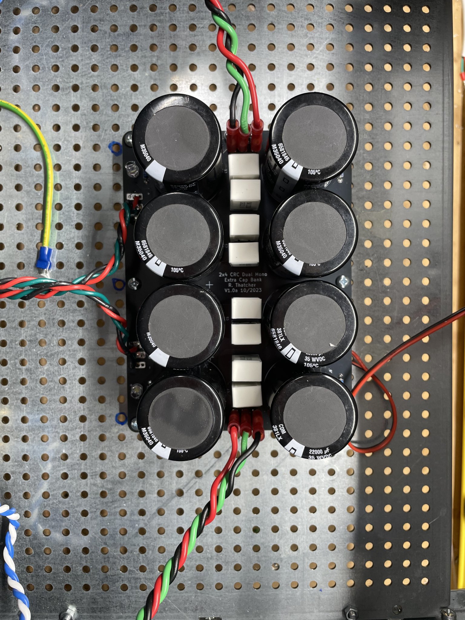

  1. It's not directly related to the "PSU"... However, I wish I had put all the additional caps in the amp chassis on a separate base plate. Why? B/C they're not inexpensive as a unit; it seems silly to replicate it in every amp; and it's a pain to move them. I want to try this PSU with my BA-3 next. If that works well, I know I want to try it with a few others. The goal was for it to be "universal". It would be nice when changing (or even when testing) amps to:
    1. separate the the cap bank from the umbilical using the PowerPole 'modules'.
    2. separate the cap bank from the amp boards using whatever method I've built onto the amp boards. Future builds will likely all be PowerPole. Now, they're mostly FastOn type.
    3. Unbolt the entire "local cap" bank and pick it up as an entire unit or two units vs. 12 individual caps and plonk it into the other amp chassis. Bolt it to the base of the new chassis.
    4. Reattach with the "foolproof" / color coded connections into the new amp. Reattach the umbilical. Done.

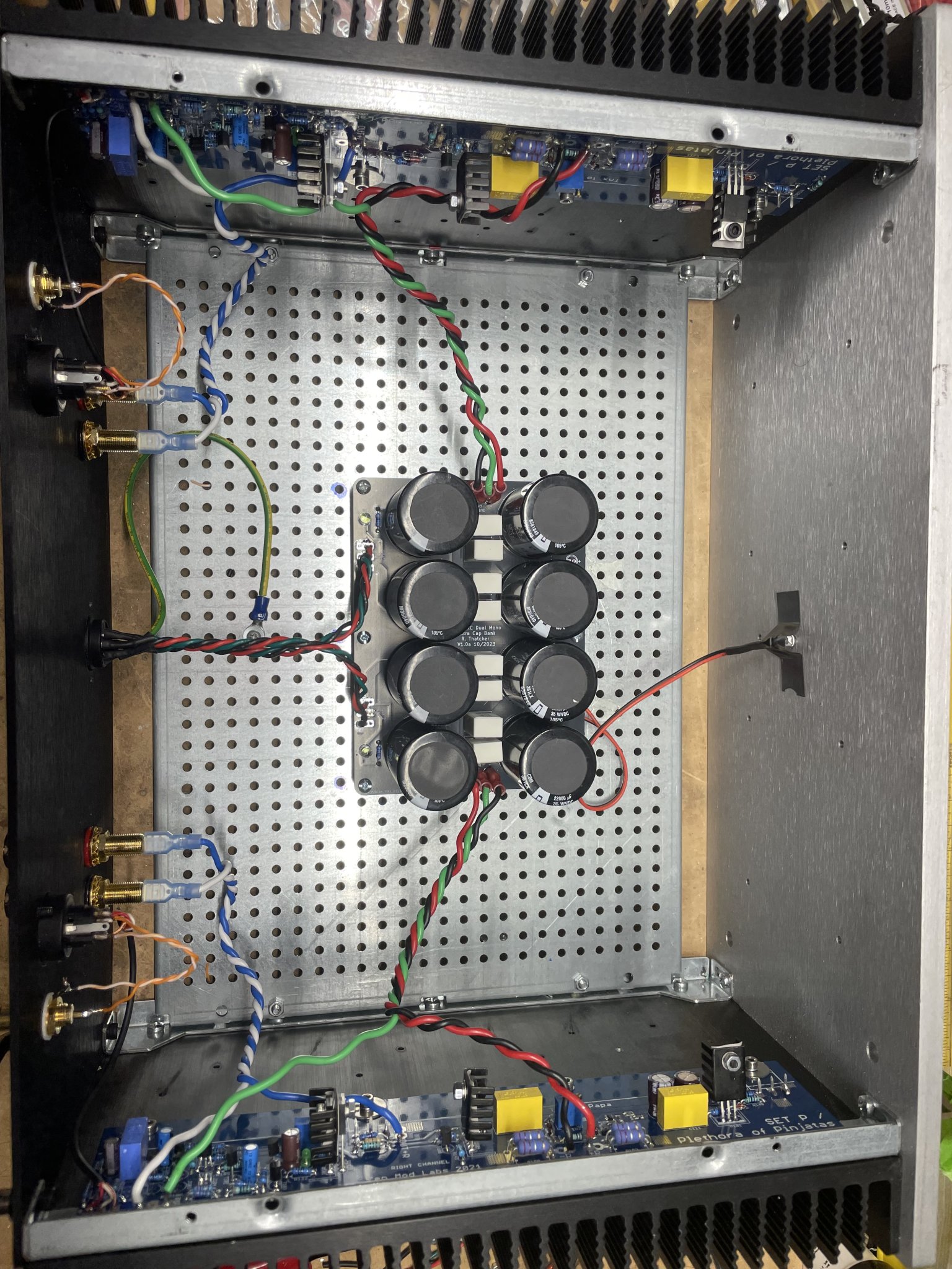

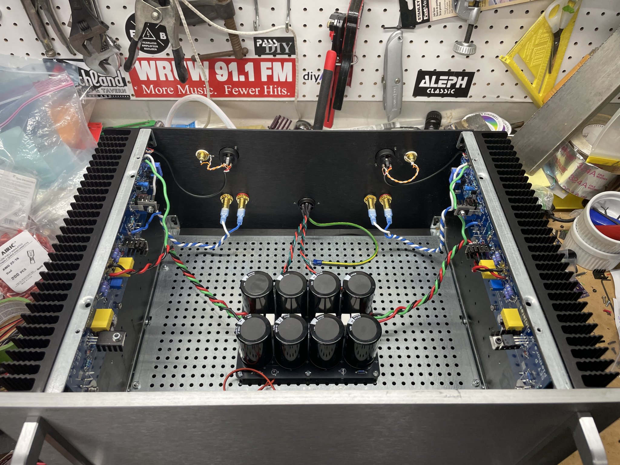

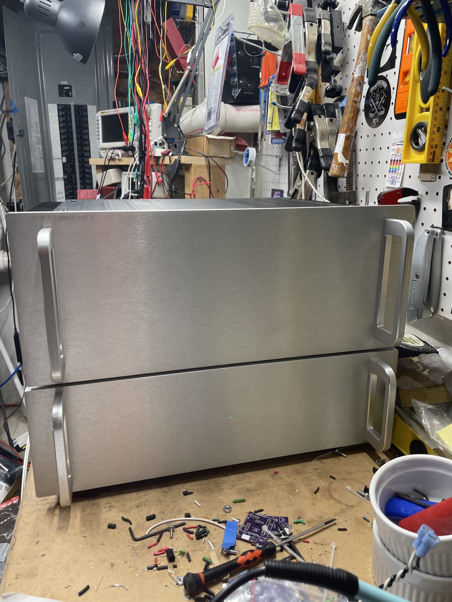

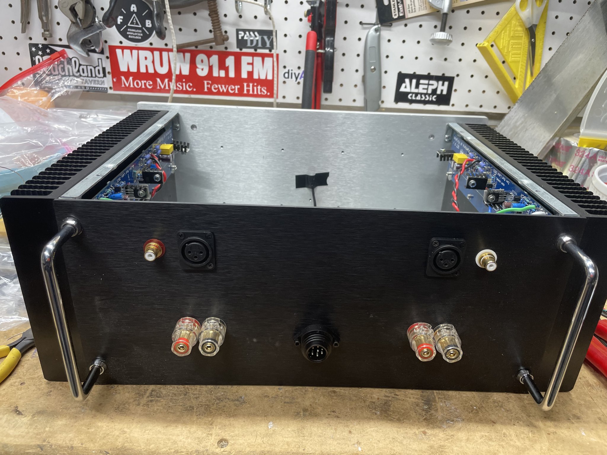

I started conversion of my 4U deluxe (300mm) Plethora of Pinjatas amp into a 2 box solution. Power supply will go into a 3U / 400 Pesante chassis. Setup will be dual 300va donuts, CLCRC “W12” dual mono PCB in PSU chassis to umbilical. I’m using a Hirschmann connector at the amp chassis. Amp chassis will have another dual mono CRC bank to amp boards. If I don’t like the voltage drop I can take the “2x4” CRC board to a simple a cap bank easy enough.
Eagle eyes may note the 2x4 board is not compatible with the 10x10 plate. Oops. I messed that up in KiCad. 3 drill holes and problem solved.
Thanks to @ItsAllInMyHead for some great inspiration!
I plan to convert my SissySIT chassis to use this external supply setup. Then I’ll have an extra donut and chokes for something else.

Gorgeous!
Just had to go one up with the W12, + 8 didn't ya! :rofl: I love the engine references... no replacement for displacement.
Now... I truly have not measured with or without them, and I still glaze over when I try to think of why we need "high frequency" bypass caps for a PSU... but... for not too much (relatively speaking) money ... you can put some film caps in the amp chassis. People seem to like "motor run", and I've seen some buzz lately re: "DC Link" capacitors. I can wrap my head around low output impedance for a PSU. However, for an amp that doesn't oscillate... or have feedback...I don't know what they do from a practical sense. I'd like to run some kind of test with or without to see the impact.
You likely know all that. Either way, when tapping trusted sources for building mine, there was almost universal agreement that some sort of film bypass cap was "better" even if not strictly necessary for all amplifiers.
FWIW, I don't think I've EVER gotten close to the rails with any amplifier with my speakers. So... A volt or less of drop for a prettier (even if inaudible) noise floor was a no-brainer for me. My goal was to kill the ripple, and then make real, real, real sure it was dead. Quiet enough for pre-amps if needed. Sill noodling on using 1/2 of mine for an amp and one for a pre-amp. I can measure channel separation now, and if I'm doing it properly... I'm not seeing anything meaningful with dual mono. Could be the way I'm measuring it though.
Last, but not least... thank you! again for creating the awesome boards and your thoughts around getting mine built.

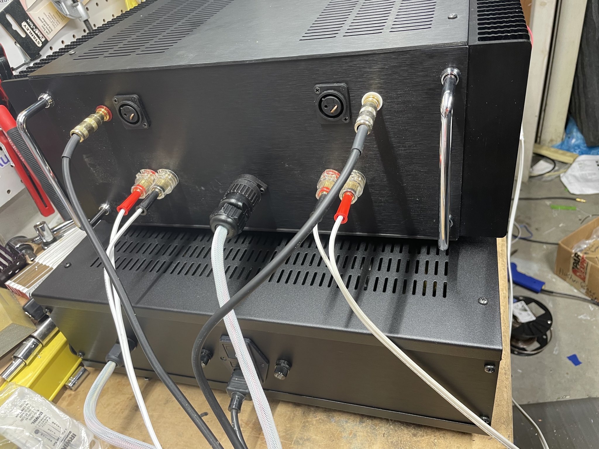

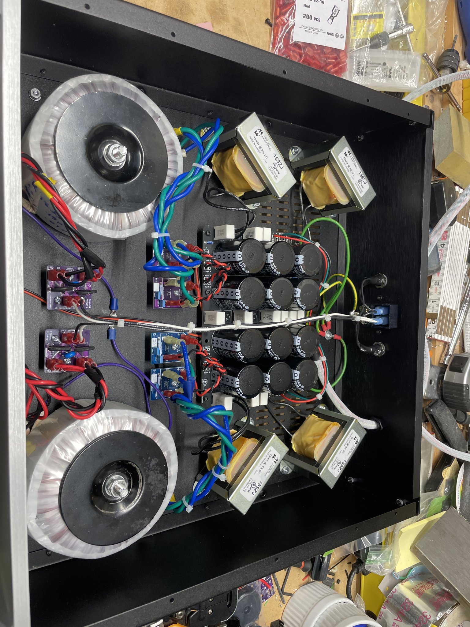

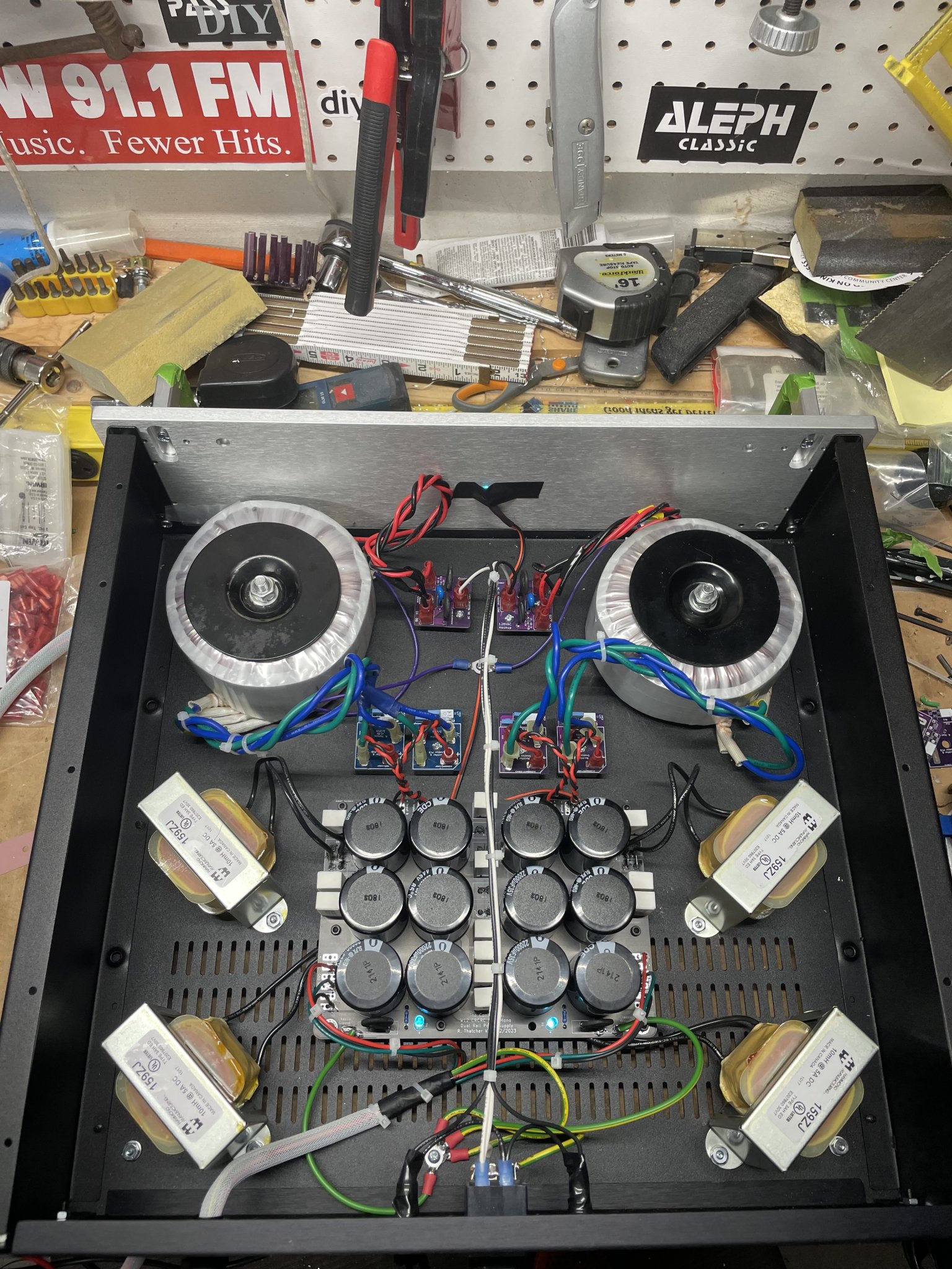

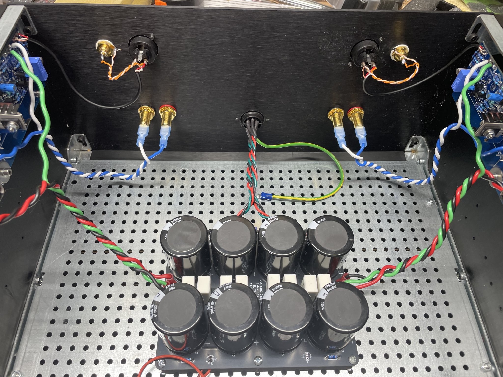

Project completed. 22.x volts at amp rails. Perfect. Dual mono CLCRC then CRC. Bench test sounds great. Now moving to my horns. One box at a time. This must be one of the heavier 18W amps. This is the Plethora or Pinjatas SET.
Sometime in the future I’ll rip the PSU out of a similar SissySIT chassis, retrofit the back plate, and put the local cap band bank board in.

Plott - My goal was lower noise on my horns. In this regard, the upgrade was a success. Before I could hear some hum from my seating position. Not anymore. It's a tough task because JBL 375 and Fostex T925A compression drivers are ~108dB eff. I was using a SissySIT with 11.5dB gain for several years. The Plethroa of Pinjatas is a 20dB gain amp so I needed to put some extra work into the power supply.
Values in this build are (same for all 4 rails):
CLCRC PSU:
22,000uF cap
Hammond 159ZJ - 10mH @5A / 0R16 DCR
22,000uF cap
2 parallel 0R22 5W = 0R11
22,000uF cap
Amp chassis cap bank:
22,000uF cap
22,000uF cap
The caps, donuts, and inductors were "free" with a little labor to remove them from other chassis/boards. I picked the resistors based on values I've used on other projects and with PSUII model software. I considered higher value resistors (0R33), but with the extra RC stages it's a tradeoff between lower rail voltage and ripple.
If I were starting over I'm sure I would look at bigger caps, because that is what we do when making crazy DIY project. 33,000uF? 47,000uF?

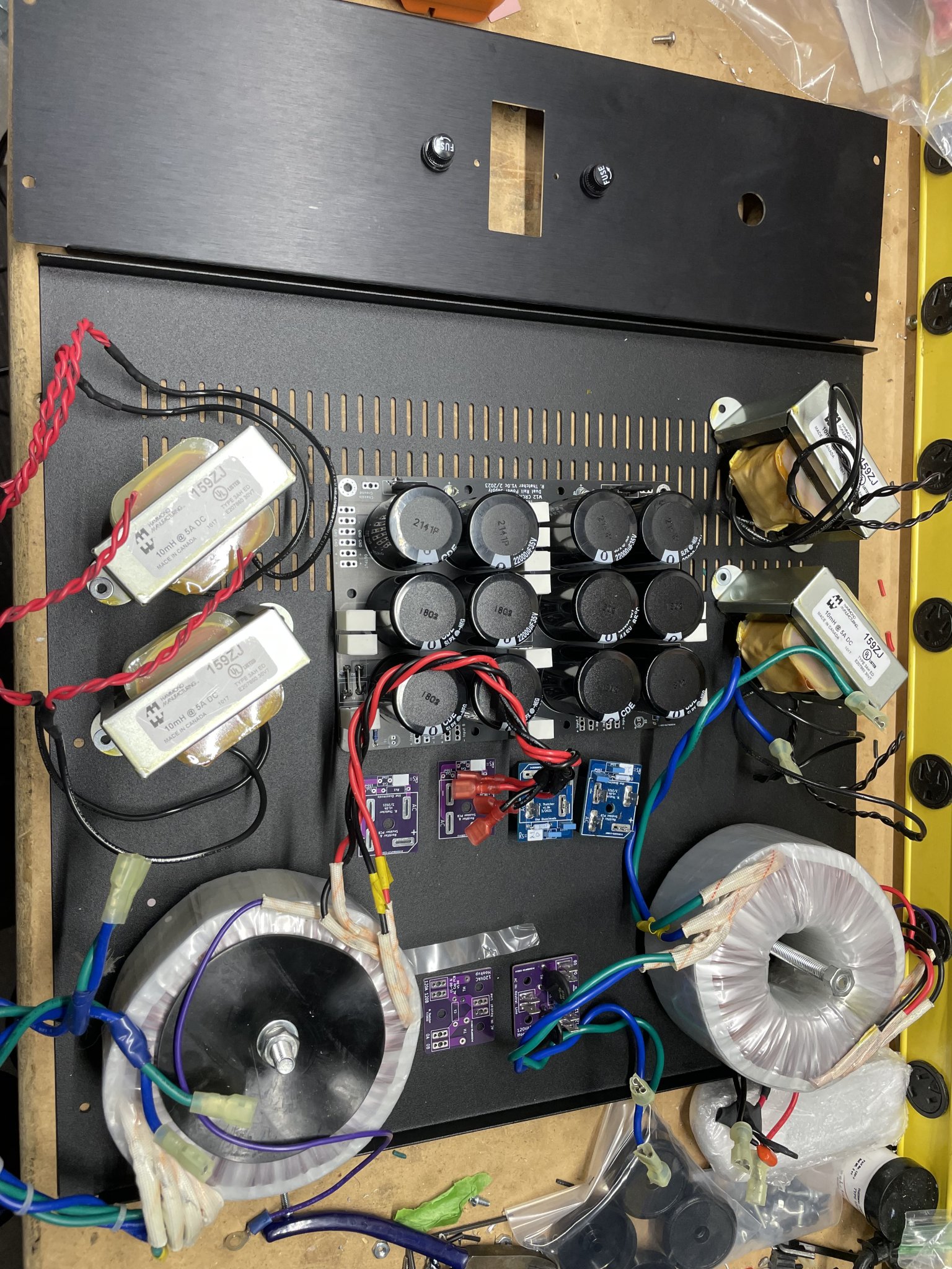

ItsAllInMyHead ,​
The 4 diode bridges are tie wrapped down to the chassis base .
Throwing out ideas here , consider cutting a piece of Baltic birch plywood . Then fasten the diode bridge boards to this plywood
using nylon spacers and stainless steel #4 - 40 machine screws .
For the major diameter ( outside of the threads ) of a #4 - 40 machine screw , I'm measuring 0.110 "
So if a hole was drilled 3/32 " ( 0.094" ) , then #4 - 40 machine screws should be able to self thread in to the plywood .
There are possibly better opinions for spacers , but I bought these .
https://www.mouser.ca/ProductDetail/Keystone-Electronics/878?qs=aNr0Yui8wHZFguvjmLmV1w==
Also , something to be aware of . I was prototyping an Amp with DIY CRC bench supply .
When I pushed the bias current up to 1.3 Amps the voltage drop across a 15" length of 16 or 18 awg piece of lamp cord was 10 mV .
You probably know this already , but be aware of the voltage drops across cables with these kind of currents .
I would say use 12 awg minimum .
Finally , as I've mentioned a few times , highly recommend adding a Fo Felix DIY EMI filter .
Considering the currents , a Bourns 8120 - RC could be considered for the common mode choke ... but it may need potting .
https://www.mouser.ca/datasheet/2/54/8100_series-777217.pdf

Moving in order -
  • Yeah... The tie wraps were a little embarrassing, but it got me going. :blush: The boards were sitting on hollow nylon standoffs that the tie-wraps went through. They're now mounted on 'swivel' PCB standoffs. They work wonderfully for boards that aren't spot on the spacing of the holes in the baseplate.
    https://www.amazon.com/STARVAST-Mot...pcontext&ref_=fplfs&psc=1&smid=A1TG4XOLBU72LN
    Next step, I have some purple PCBs that have the same mounting hole spacing as the base plate and have TH snubber components that I can easily change with the transformers. Just... because.
  • Great to know re: the voltage drop through the umbilical. I considered it, but never gave it too much thought. The wiring is currently 16AWG. I may measure the drop just to check it out. Currently lids are actually in place. I never do that. 🙂 So, I'll check it out later. I can easily swap to 12AWG.
    In practice... it's hooked back up to the Aleph 60 and playing now at ~ 2A5 Iq per channel => 2A5 per PSU. The wiring stays perfectly room temp. I'm not worried about the drop from a technical standpoint, only safety. Unless I should be worried about the actual drop??? I never come close to 'hitting the rails'. If I clip any amp, then I've done something really, really wrong. Still, it is something I should have probably given more thought. Appreciated!
