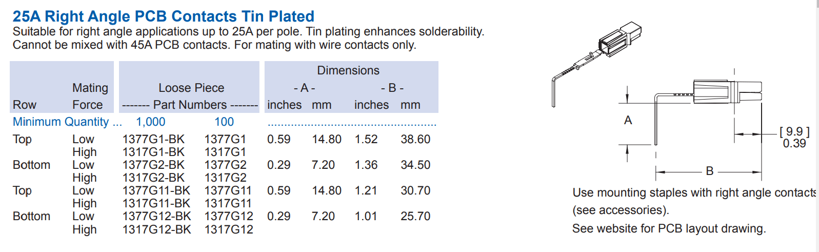

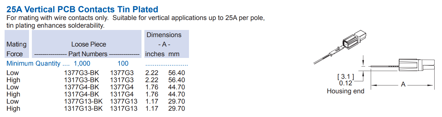

Looking at those, I guess the only thing that bothers me is the tin plating. I would much prefer a silver-on-silver contact point for high current connections that rely on spring pressure. I guess my own solution would look something like: solder everything inside and have industrial connectors on the back (1st choice), or solder everything inside and have powerCONs on the back (I think Pass Labs does that?), or solder everything inside and have a short pigtail with the Powerpoles hanging out the back.. with a strain relief / grommet / etc. on the chassis.
^ I'm still considering them, but ideally (for me) I want something that does not need to be soldered. Also, the XLRs have relatively small pins that for the wire gauge I'm considering make it tough to get a nice solder joint (for me). What I really, really like is that they're easy to mount in a standard hole, and that they're properly DC rated. All previously discussed.

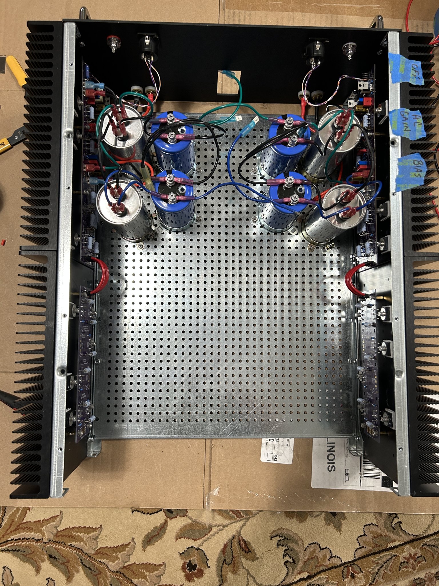

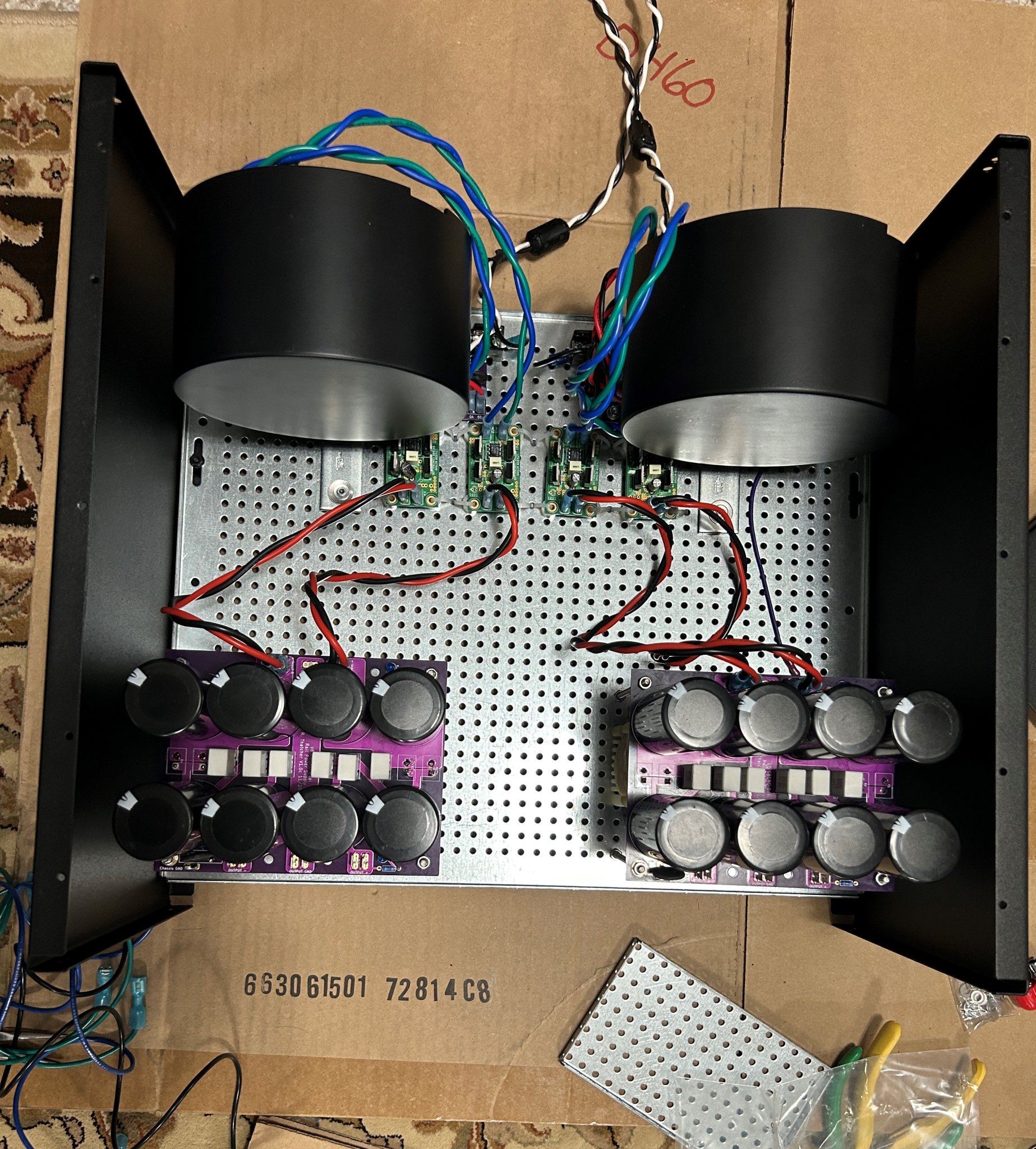

Edited to add - some fun pics for those that like pics. Not much visible progress, but a lot of nit-picky stuff done... Note... the rectifier boards will be changed to something more fun... and more usable for me in this particular supply later. Prasi is awesome!

I had originally planned to do the power in a separate enclosure, but decided on what I thought would be a cleaner approach. Power supply will be mounted on a baseplate which can be swapped out or changed depending on the amp board requirements.
I am going to use amass RC connectors for all the quick connect wiring between the power supply baseplate transformer primaries to the soft start and the DC dual rail to the amp board with different connectors. Also have connectors for the amp speaker outputs and the signal inputs. All the speaker protection, soft starts, and SE/XLR converter boards are mounted to the back panel. I intend to swap out heat sinks with amp boards attached with just a few quick connections. Faceplate label will be switchable to indicate which amp is playing.
