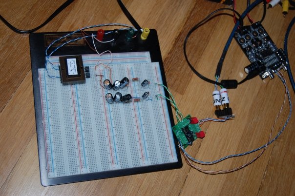

Is there any reason there should be a lot of hiss? With my laptop connected directly to my Sure TA2024 amp there is very little hiss, with the preamp connected there is a lot.
to cancerkazoo,
i think there are two reason caused the hiss.one is components itself,the other is the source.
look at your attached photo,i think you have not set up a volume pot for the preamp.the preamp gain setting is 10,it means 0.1V noise floor will get 1V noise output.you can disconnect the laptop watch if the hiss is gone.
i am always believe the laptop is not a good source for hi-fi.i think you'd better use a external sound card.and you'd better add dummy load(47ohm to 300ohm)for the card without line output.

what would be a good gain setting with this preamp? You say preamp has gain 10, I have a LM3668 with gain 33.. would it be ok, just design correctly my attenuator with resistances? or probably better change amp gain?

That would make sense, I was under the impression that this was a unity gain preamp. ( I thought I read that somewhere)
Is there a way to make this unity, or less? as my TV output is higher than what I want for my amp.

your chipamp can output a maximum ~22Vac to your speakers giving ~108dB SPL at maximum signal.
The maximum input signal to reach transient peak is 22/33 =660mVac.
Using a 10times gain pre-amp. the maximum signal required to give maximum output ~66mV.
Most, if not all modern, sources give way over this output voltage, some could be as high as 2500mVac.
Using excessive gain that has to be attenuated to a useable value has consequences that impacts on the overall performance of the system without any compensating gains in performance.
You probably don't need any pre-amp gain and I suspect all your sources need only an attenuator to drive your system into clipping.
You will need further attenuation just to make the system enjoyable for the majority of your normal listening time.

Well I perfectly agree, I definitely will need to attenuate my surces: if I'd connect my CD source directly to my LM3886-based power amp I'd sureli fire off my windows!! 😉
So I was wanting to build a pre-amp to a) select sources via switch pot, b) attenuate volume via attenuation pot and c) I tought that using this also LM based pre-amp would improove sound.
At the end you probably would like to suggest me to use some less gain pre-amp? or maybe to rething the current gain of my power amp maybe? or just bypass pre-amp?

It is very very low now, but I can still hear it with my ear up to the horn. (klipsch). It also increases when the interconnect is removed from the source.
But I have a feeling it will be a little better when in an enclosure and a chassis ground (and resistor?) is used.
I need to track down the mains power issue (6v between neutral-ground and 30v between hot-ground)and there is no ground behind the wall plate there.

i think you need not change the gain.you can adjust the levels with attenuator.the preamp with gain 10 is a average value.
for low gain setting,you have to apply deep feedback to the opamp that is no good.
the UCP preamp was designed for work under tough applications.it is not only for driving chip based power amp but also for driving solid & tube based power amp.some power amp have an low or nonlinear input impedance so that usual sources can not drive the input perfect.the preamp allows use of such devices without worry about impedance issue.

yes,the preamp with gain 10.
you can modify the gian via adjust R5,R7,R6,R8.the preamp is a two stage device,voltage gain + buffer stage.for make this unity gain,set R7,R8 as 0ohm is a simple way.
