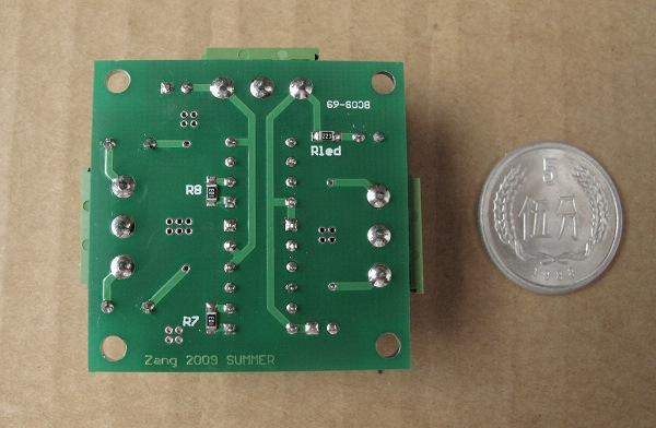

I think you can improve the printed board layout by putting ground to separate the opamp between 1234, 5678.
eliminate traces running across 1234,5678. Underneath the opamp.

I have got the samplers last weekend.the first round shipment will be post in a couple of days🙂
I have assembled one unit,look at the attached photos.

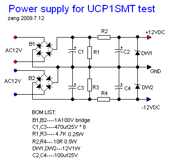

thanks for your suggestions about the "universal" preamp PSU.I use a bipolar +/- 12VDC voltage-regulator diode based PSU.I prefer the things going to simple.I will draw a sch file for you review.

On the abowe PSU con you give some more info on those DW diodes?

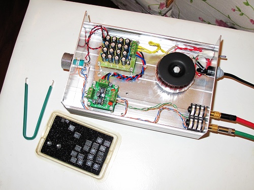

the test preamp is completed.
because it is designed for universal,i do a overall test with some opamps.opa2134,opa2604,ad8620,ad8397,ad823,lm6172,ne5532(big S),sa5532,ne5532(ti),opa2227,opa2111,ad827,lm4562.
i prefer detail & nature sound,i think lm4562 and opa2227 is better.

the DW diodes is 1n5242.the 500mW power dissipation is ok for ucp module load.

I use single copper cable for sginal route.
the volume pot is before the ucp module.

For the diode, since I only have a very big toroid trafo (250VA) available at the moment I was thinking to put a very big diode bridge (something like 35Amps so I do not blow them with inrush current..), do you think this could influence sonic performance?
And I looked at you picture up there: really nice! But what is that PSU you have there? Lot of caps.. and why is there only a couple of cables coming from the trafo to the psu? (yellow ones)

for the diodes,i have not experience to use such power🙂i think 1n4007 is all right for this project.
the transformer in my test only have single secondary coil,AC 10V 1A.i use half wave rectifier.
i have lots of 470uf/25v caps in stock.it is industry degree and i like its size.i connected them in parallel 8*470uf+8*470uf for the psu.

besides that I completed the PSU now.. using some 16 of those 470uF elettrolyths, connecting a 12V toroid, what I get on the output is 14.2V DC.. isn't this too much? isn't this going to damage the LM4562?
