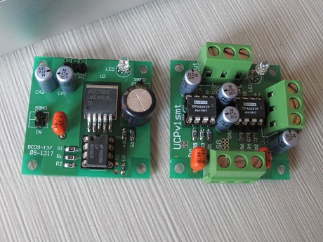

i have a rough test with the new ucp2 module.i use LF411 drive LME49610.the 49610 was working very good under the feedback or open loop.i prefer running the buffer under open loop like ucp1 do.

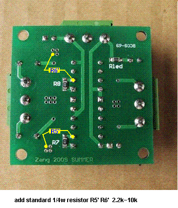

Forgive the noob question, but what would be the best way to slightly increase the gain of the UCP? I have been listening extensively for the past month or so with a couple different chips. The gain on my Aikido seems most appropriate for my setup...ideally I'd like to match it - the input tubes I'm running (6DJ8) give me a gain of 14.
Which combination of R5,R7,R6,R8 would achieve this. I am running a clean +/-13.2VDC on the UCP.

what would be the best way to slightly increase the gain of the UCP?Which combination of R5,R7,R6,R8 would achieve this.
the actually schematic was in post 5.the voltage gain of UCPv1smt is (R7+1)/R5 or (R8+1)/R6.the basic gain was 11(approx 20dB).
I think the best way is decrease R5,R6.you can add resistors in parallel with R5,R6.you need not remove the origional smt resistors.showing below.
zang
So, if my math is correct, paralleling a 3k resistor in series with R5, R6 would yield about 750R...1/(1/1000)+(1/3000)=751.9
(10+1)/.7519 = 14.6

........yes, 3k or 3,3k paralleling should give you a gain around 14.

All I had was some 1.5K resistors on hand so I put those in as digi had suggested on the bottom of the board.
So far so good...the gain has picked up considerably.
Thanks for the help!

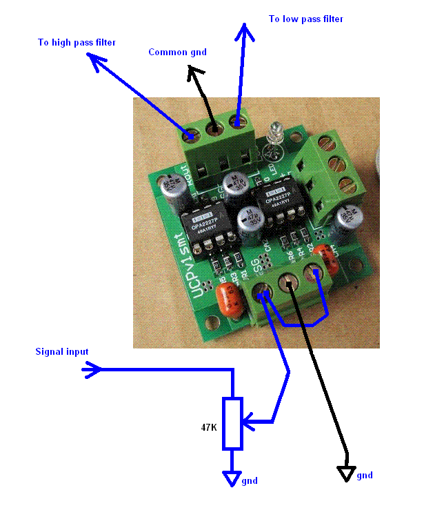

I have populated one of the UCP V1 boards for simple stereo and am awaiting appropriate transformer Can I use non-polarized electrolytic caps for the 1-47uf caps? It's all I have for now but I have more polarized caps coming in an order I placed for various things at Digikey.

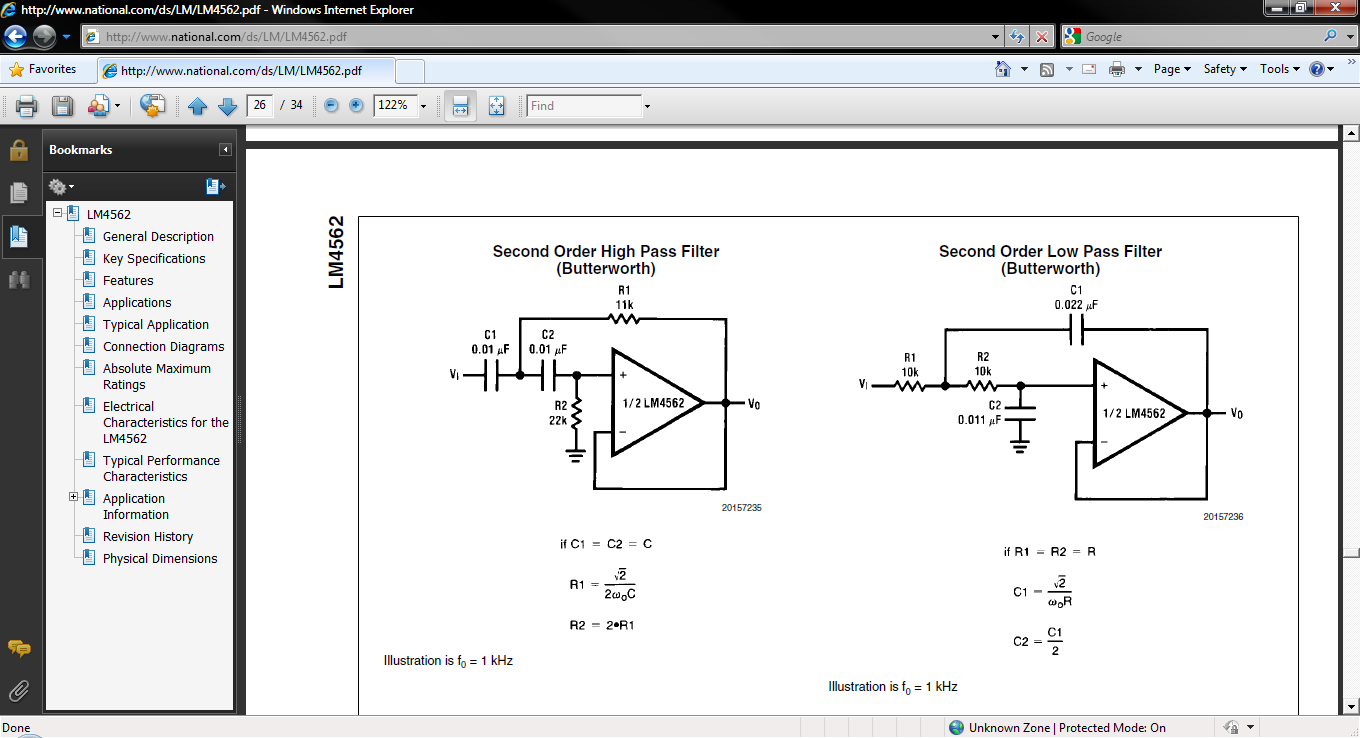

I was also wondering, after reading app notes of LM4562, which I'm using on pre-amp board, about how to implement an LM4562 active crossover either pre or post gain of pre-amp board, for bi-amp situations. I'd love to get rid of the passive crossover of my 2-way speakers. Since I have a pair of the pre-amp boards, would each pre-amp board be used in a bi-amp setup? 4-gang volume contol into seperate crossover board in front of each pre-amp out to seperate power amps of choice? Tube, discrete or chip with resistor adjusted gain in pre-amp as appropriate?
Can this be done with a 2-gang stereo pot and one pre-amp board?
Or would such an active crossover go after the pre-amp and associated gain?
I'm just trying to get an idea of the simplest way of doing this and maintaining universality of the design.
Are other variations possible? LR intead of Butterworth?

go to the ESP site and do some reading.
What a great site from Rod! Project 09 was a most stimulating read. I'll have to read and re-read that and other crossover and opamp stuff.
i like bi-amp concept but i have not working on it.
i think a 2-gang pot is ok.the active crossover go after the pre-amp.you can set up the UCP like a distribution amplifier,the below photo show one channel connection:
