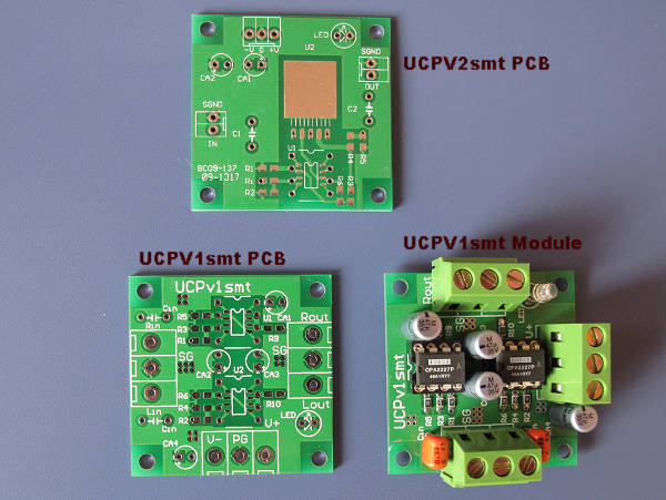

hi,
nice making!thanks for the review.
P.S.
the UCPV2smt test board was in my hand.I will do a test in a couple of days.the updated of UCPV2smt:
1,mono design,single opamp with lme496**
2,pcb size 39mm x 39mm,as same as UCPV1smt
3,multi feedback loop available

i am interested.i think it caused by the opamp drive ability and the power amp input network.The chipamps(TA2022 and LM3886) seem to hide something...the tube amp really shines with this preamp. Although I'm not convinced it sounds better than the Aikido...

the R9,R10 value should be modified for headphone load.47ohm for low-Z headphones,200ohm for high-Z.the new smt resistors can be solder on the original R9,R10(connected in parallel).the opamps should choose be able to deliver high current values and to drive low impedance loads.and you will use a switched stereo jack to route the output sginal between jack&RCA.
the UCPv2smt use LME49600 buffer as output,it is powerful handle all kinds of loads🙂zang
