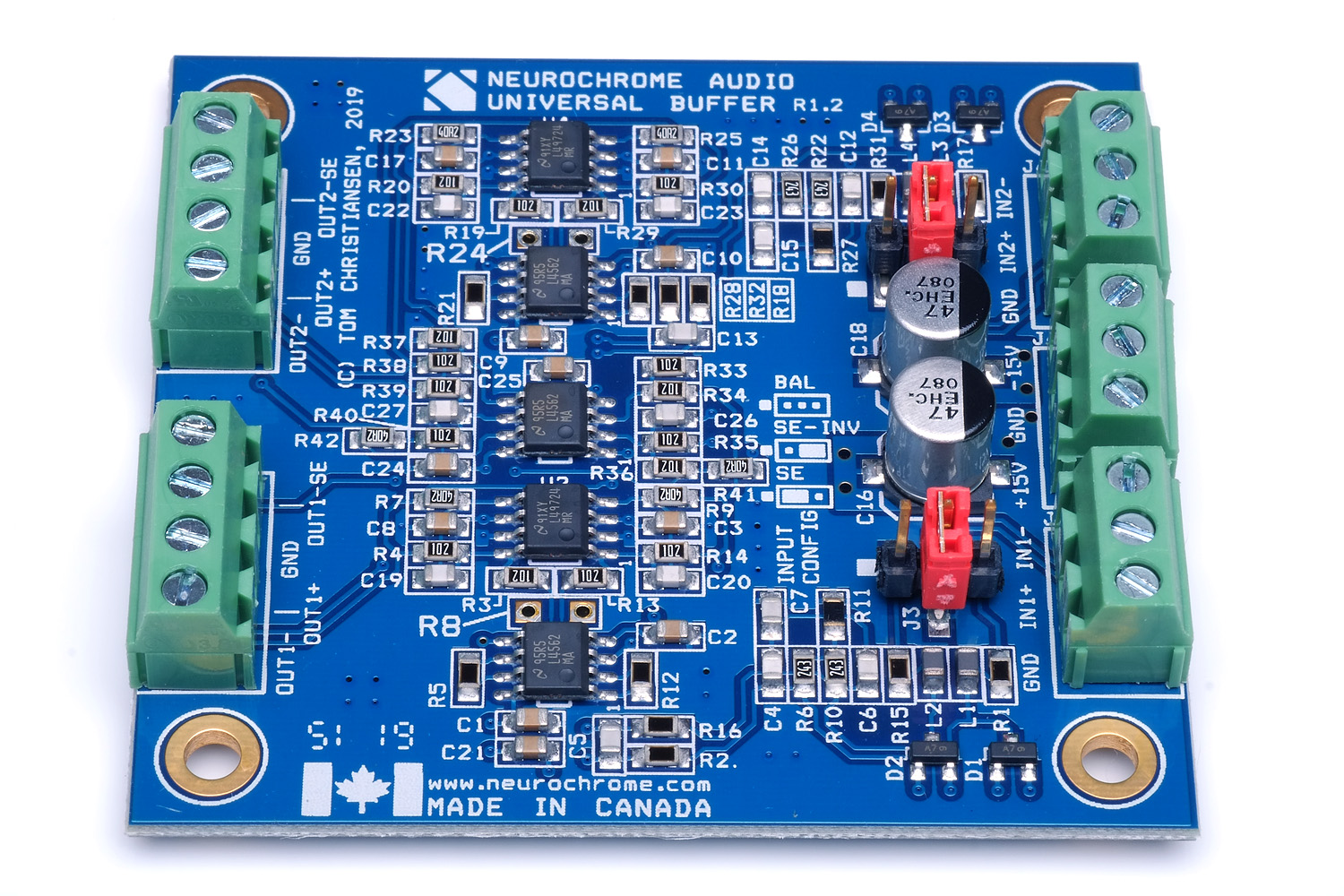

All of them have 200 mV p-to-p ripple, only the physical footprints and price are different as far as I can see. Those two variables aside, what is the minimum model of the 4 based upon output current would you select for building a Universal buffer; 1 pair balanced in/1 pair balanced out, 6dB of gain and a small front panel mounted LED. No other inputs, volume control, etc.
If you run the Universal Buffer to clipping, you should expect about 100 mA current draw per board. For powering just one board, a 3W or 5W switcher would be fine. So IRM-03-15 or IRM-05-15. I don't have a strong preference between the two.

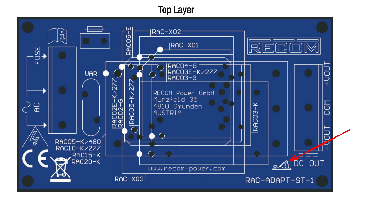

Yes, the Recom look very nice. And check out this universal adapter board they have to mount most of their modules. $14 on Mouser.
Nice!
These Recom ac/dc converters and mounting pcb will make for a super easy and convenient psu to have in any Diy’ers toolbox. Thanks fellas 🙂
Neat. And a good price too. I'd add a few features, such as output filtering, power-on LED, and low-voltage power on/off control.
I wonder what the plane signifies.
Tom
Trim?
I was going to say ground plane, but I doubt it. I will let you know about the quality of the board and supply, ordered from Mouser this morning. I went with 10W version, +/-340 mA (RAC10-15DK/277).

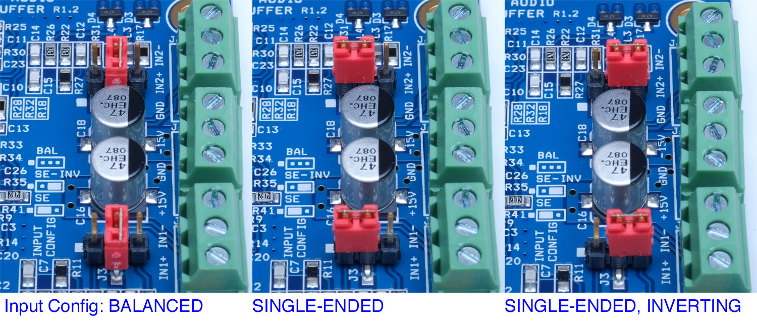

A couple of figures from the design documentation. Hopefully they'll help shed some light on the various options for input configuration and gain resistors.

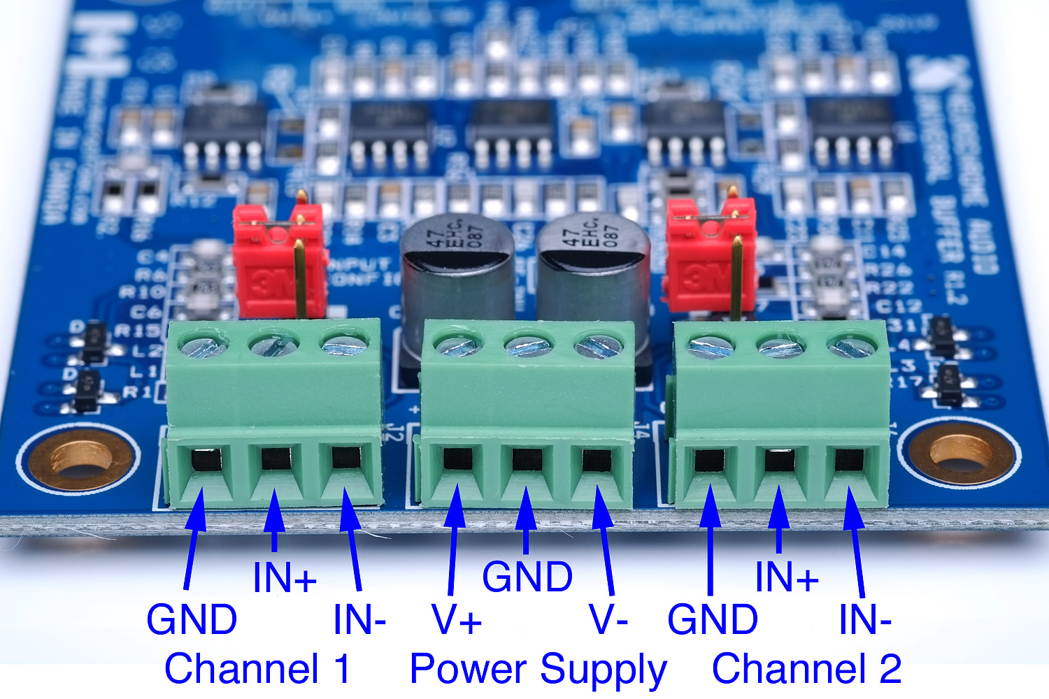

I'm planning to use the buffer as a laboratory buffer/pre-amp for various measurements, including PSU noise. For the latter I will need to AC couple the inputs. I see in the specs that the input impedance is 48k so I was thinking that a series 1uF cap could do the job (fc = 3.3Hz). Do you have any advise in this respect?
