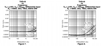

You can just say that the real reason for those test conditions is because you wanted the sensationalized headlines ( Universal Buffer achieving -140 dBc (0.00001 %) THD) and that most potential buyers would never question the measured results anyways. That honest answer would have worked. Considering there was 108 posts before mine and nobody else questioned this, your strategy had some merit.
And your strategy of spreading fear, uncertainty, and doubt has its merits as well.
You can read the data sheets for the LME49724, LME49720/LM4562 as easily as I can. I fully expect that my measurements will confirm those in the LME49724 data sheet. I've included the data sheet figures below. Note that the figures show the THD+N and not the raw THD. The THD will be lower (no +N).
A 47-50 kΩ input impedance is very, very common in the audio world. Some go higher (upwards of 100 kΩ is not unheard of). Take the Focusrite Scarlett 18i20, for example. It has a 60 kΩ input impedance on its line inputs.
As you pointed to earlier the difference between 47 kΩ and 100 kΩ is academic, so clearly my data for 100 kΩ input impedance are in fact quite representative of Real World applications.
That's not to say that 100 kΩ is representative of all applications. For example, your Purifi amps have 2.2 kΩ input impedance. Given your rather aggressive posturing here (and elsewhere), I wonder if you have a competing product to sell and are, thus, trying to discredit my work due to its mention as a possible buffer candidate for the Purifi amps. Just wondering...

Requesting industry standard data for this board is considered trolling? Anyone who has a use case that requires driving 2v into a 100k load already has this ability from their source gear. Making this board redundant. And sorry I have no interest in making such a board, or buying one either. I only discovered it from the Purifi thread. Where people were discussing using it for an input buffer. And when I read the test conditions, it was clear they don’t accurately represent the performance they will achieve in this application. This is why standup, salt of the earth manufacturers provide 600R load data by default.

"Industry Standard"??? 10V (rms?) into 600 Ohms _might_ be used in the professional world. Even there, 600 Ohm matched-impedance balanced lines are a vestige of the old analog telephone world. 10V (rms?) will drive most any power amplifier well beyond clipping. I'm not sure how that can be considered a useful spec. Also, 10Vrms is 14.14V pk (28.28V pk-pk) which pushes to or beyond the maximum swing for op-amp driven from +/-15V rails

It’s industry standard that this data is provided with such a product. Maybe not the impedance most will drive with it. But it’s a good indicator of performance under load. Which is why it’s standard in most opamp datasheets.

600 Ω is not standard in "most opamp datasheets". 10 kΩ is standard. 2 kΩ and 600 Ω were added within the last decade or so as opamp designs were improved to provide low THD under heavy load. Many opamps are still specified only for 10 kΩ load.
