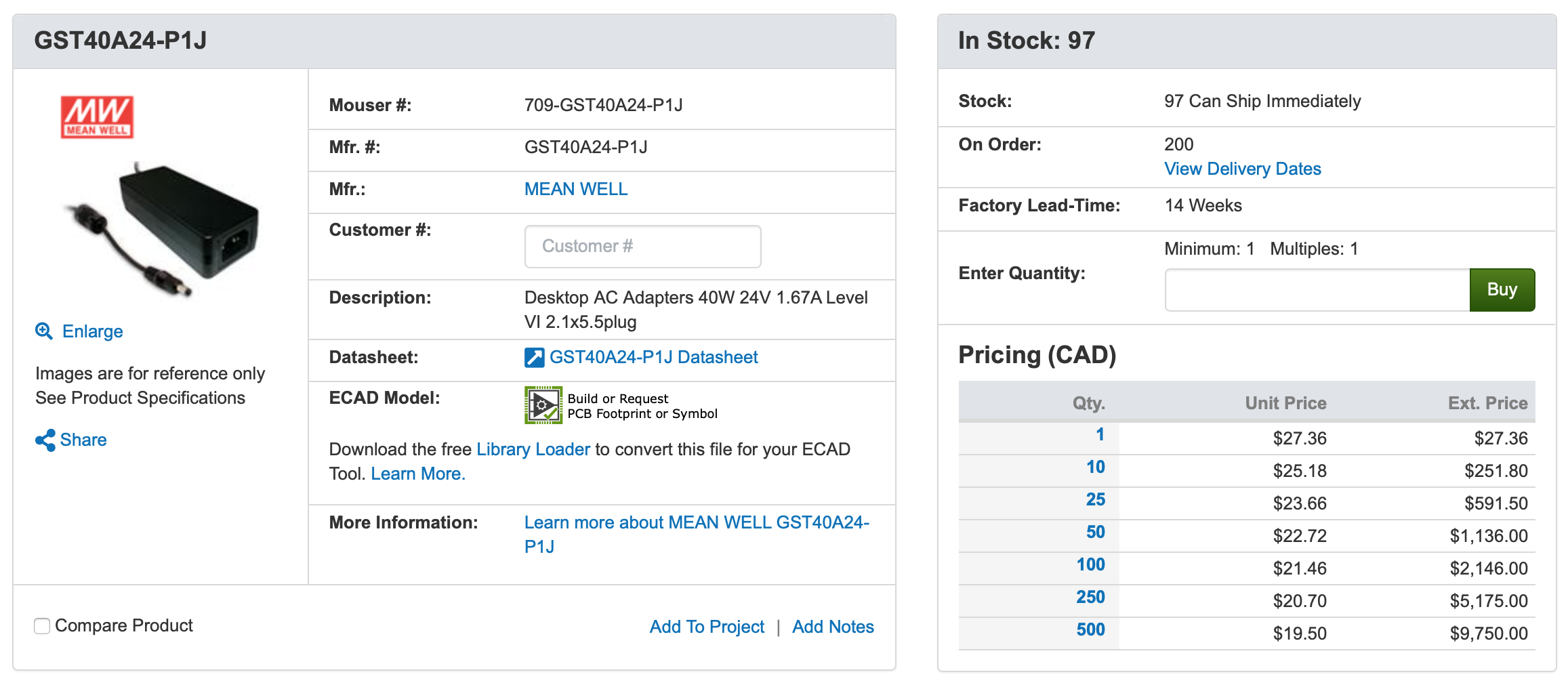

That's possible. Last I looked was in September. The one you list is $40 (CAD). You need a wall wart to operate it. That's getting pretty expensive. Are you willing to pay that much to avoid having to solder an IEC inlet?

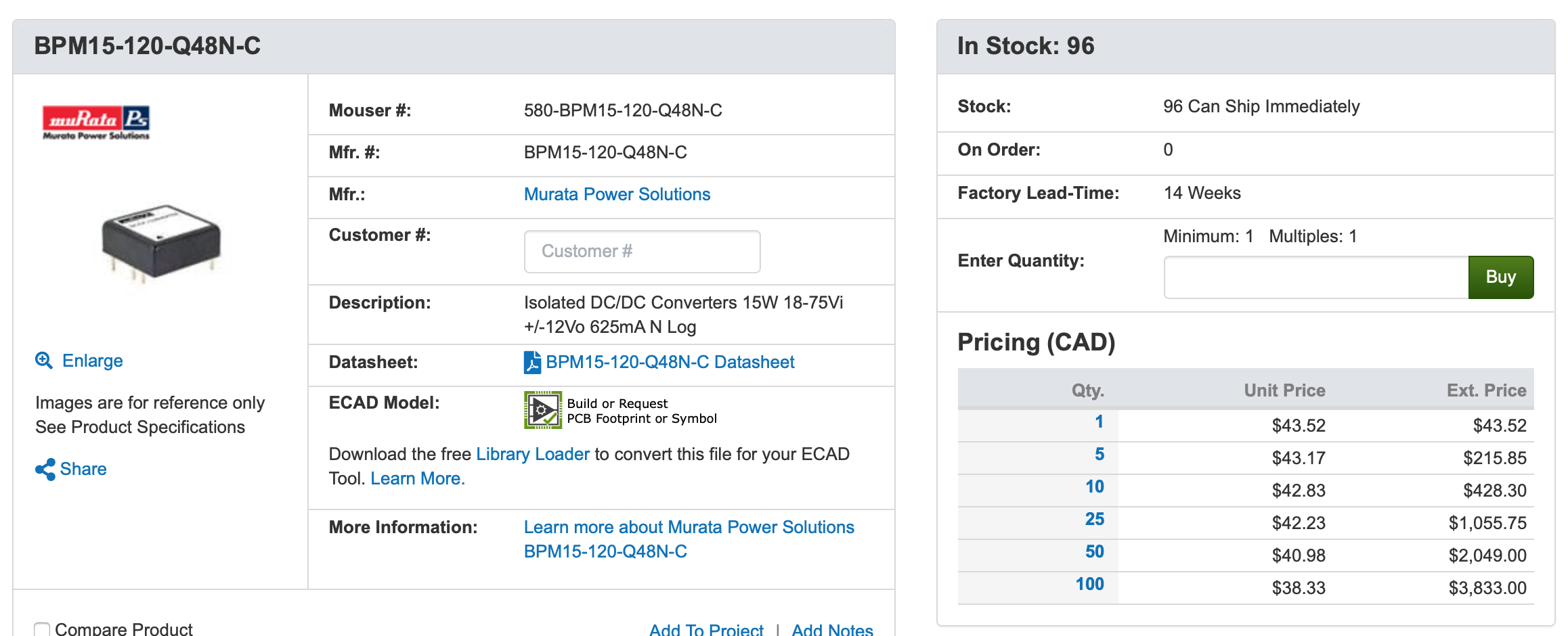

Also, it's not necessarily $40, a quick search returns REC15E-2412DZ and BPM15-120-Q48N-C for $30
You may be talking in USD vs the CAD I see on Mouser.
Here's a rough estimate for the total solution cost with the DC/DC converter you mention:
DC/DC Converter: $43.52
AC/DC switching supply: $27.36
TOTAL: $70.88

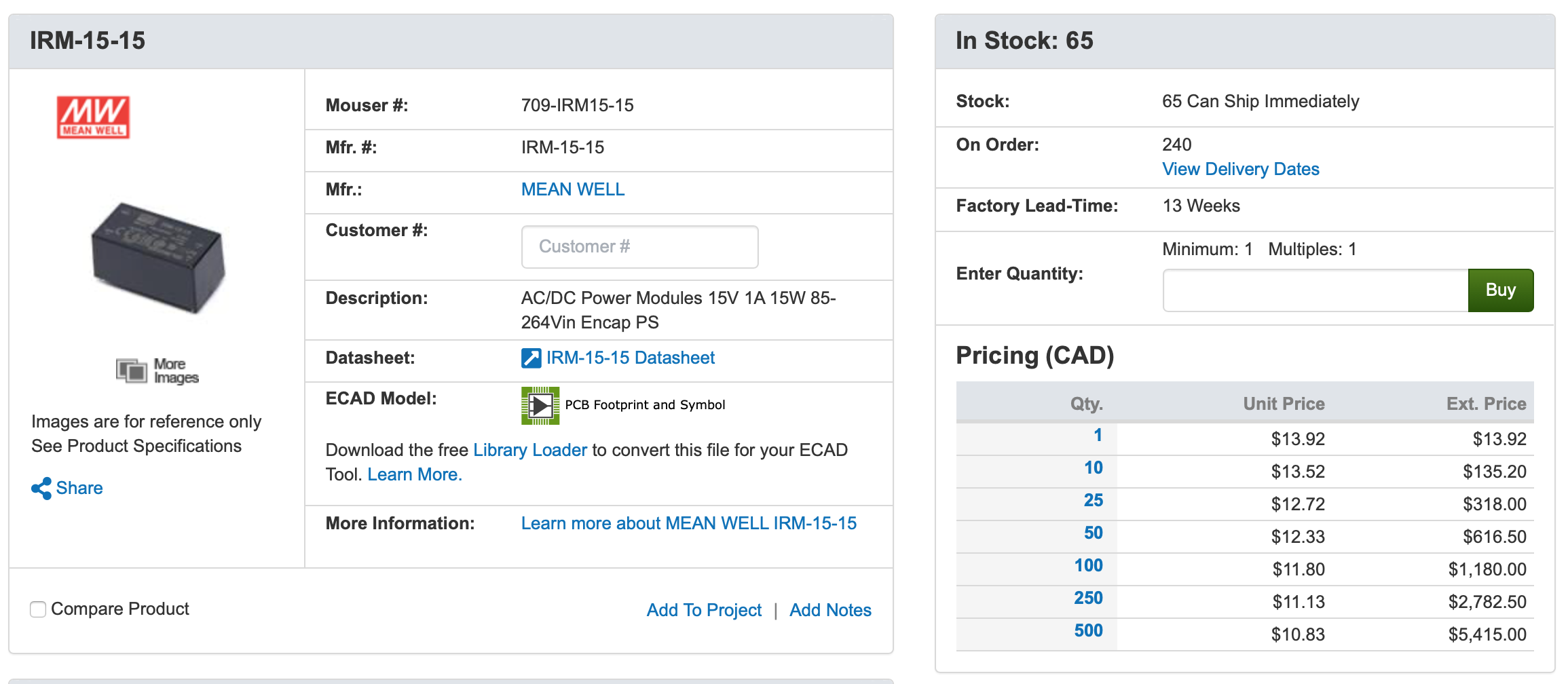

Here's the estimate for a solution based on the IRM-15-15 (mains input, 15 V output):
IRM-15-15: $13.92/each. Two are needed.
TOTAL: $27.84
So basically, you're willing to pay $43 CAD (= $33 USD) to avoid having to solder an IEC mains connector. I wonder how many would be willing to do that.

You'd get the same isolation with the IRM switching bricks.
Not trying to have an argument, (at all, I love your products, from which I own some), just putting more options on the table. You liked the SilentSwitcher options as well, and it's even more expensive than what i'm proposing.
I'm not trying to start an argument either. I'm sorry if I didn't "like" your solution to the same extent as the use of Jan's SilentSwitchers. There's a difference between "I'm going to use this other product" and "I think you should offer a product based on this...". In the former case, I look at whether the chosen solution is likely to break performance. In case of the SilentSwitcher, that's incredibly doubtful. In the latter case, I have to look at cost, market needs, etc.
I really do value your input. Thank you. It just so turns out that I've already looked at the solution you propose and decided against it due to cost.
Now there are other considerations in play here. Size is another one. The IRMs are pretty big. Add IEC inlet, output regulation, etc. and you're quickly at a 100x160 mm board size. That's definitely "large and in charge" for a preamp.
