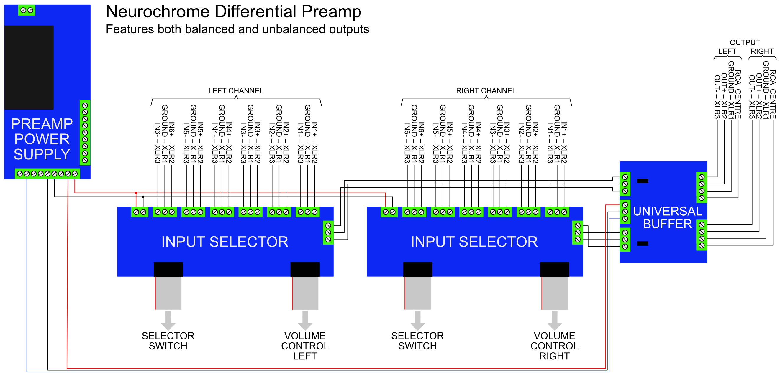

Hi Tom,
Am I correct in supposing that, if we don't want a volume control before the UB, we can use the setup below with appropriate shorting links placed in the pads for the left and right volume controls?
If I am correct, would it be possible for you to produce a graph of the CMRR vs. frequency for such a setup? Compared to the graph of CMRR vs. frequency which you provide on your site for the UB, this would show the effect (if any) of the source selector on the CMRR of the UB. It would be great if it turned out there's little or no effect (as I suspect).

You are correct that you can just connect the appropriate pins on the connector for the volume control to bypass it. Without a volume control, the CMRR of the differential preamp will be that of the Universal Buffer itself. The resistance in the input path is negligible and whatever resistance is there is balanced in the layout.
I shipped the two fully assembled input selector boards I had yesterday (that shipment was way overdue, but the power supply didn't' come in until yesterday). So I don't have a board handy to test. If you buy a fully assembled board I'm happy to check for you. I'll get you a good deal on the assembly... 😉

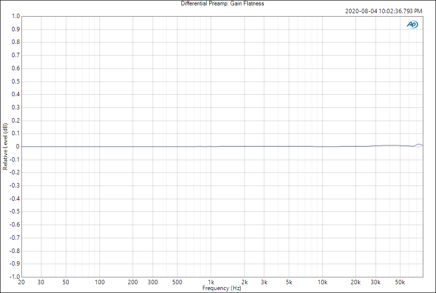

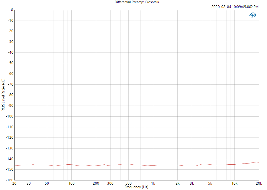

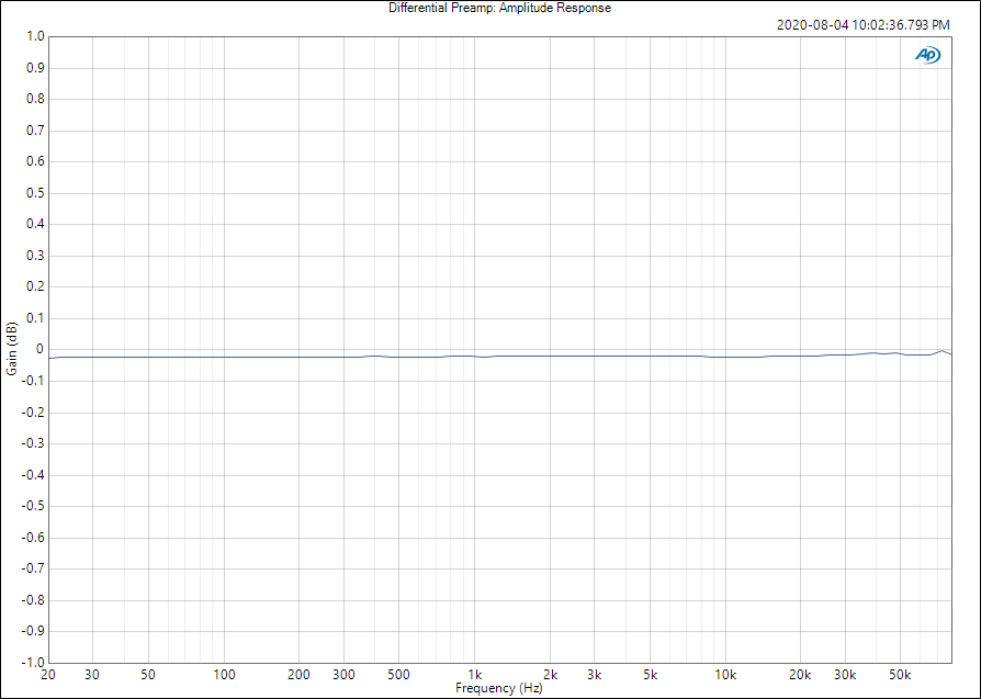

I did grab the same four graphs of the differential setup as I did for the single-ended. See attached.
Tom

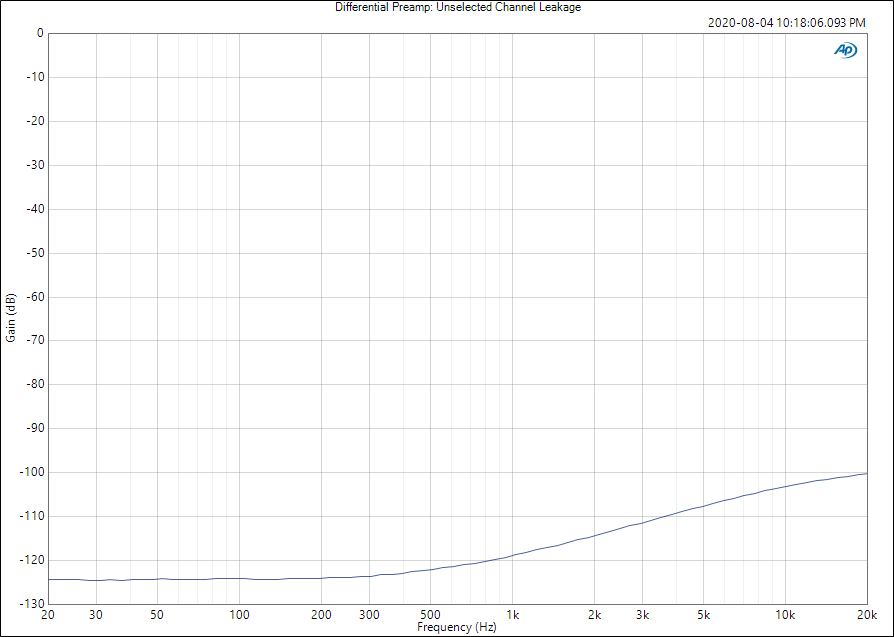

I'd be grateful if you'd share whether, in the test setup for "Unselected Channel Leakage", the "selected channel" is terminated with some particular value of source impedance, or it is only terminated by the input impedance of the "Differential Preamp".

In the "unselected channel leakage" I drive an unselected channel with the AP (Zout = 30 Ω if I recall correctly). The unused channel is connected to the other channel of the AP (same Zout). I then measure the output of the preamp with the volume turned fully up.
Doug Self refers to this as the "offness" of the input selector. He has the better part of a chapter in his Small Signal book dedicated to this.

Thanks for sharing the "selected channel" source impedance for the "unselected channel leakage" test. It makes the graph much more valuable.
