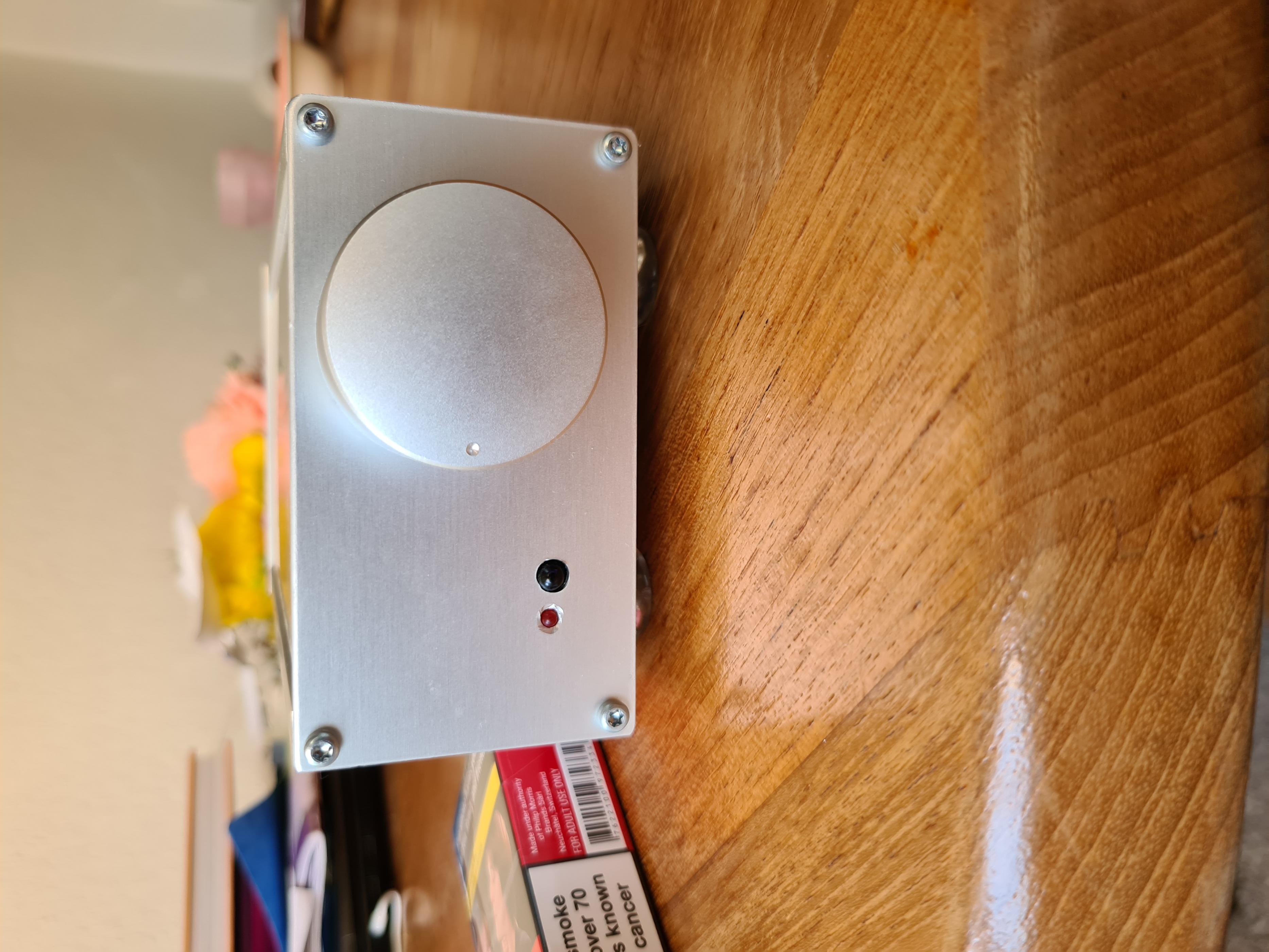

What a way to find out my source wasn't happy driving a 10k potentiometer!
Just finished my new preamp. Universal buffer - 10k potentiometer - That driver.

I am totally happy with this one, didn't think this would happen at all.

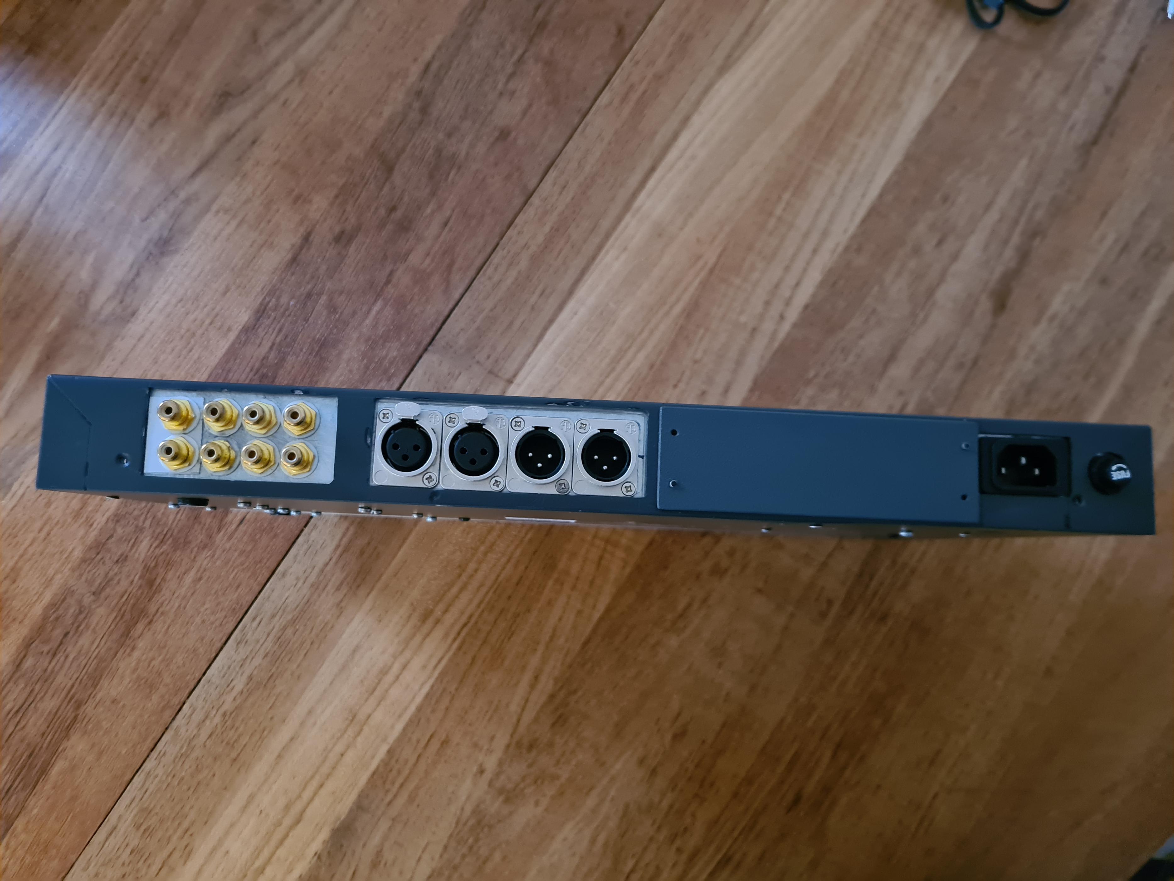

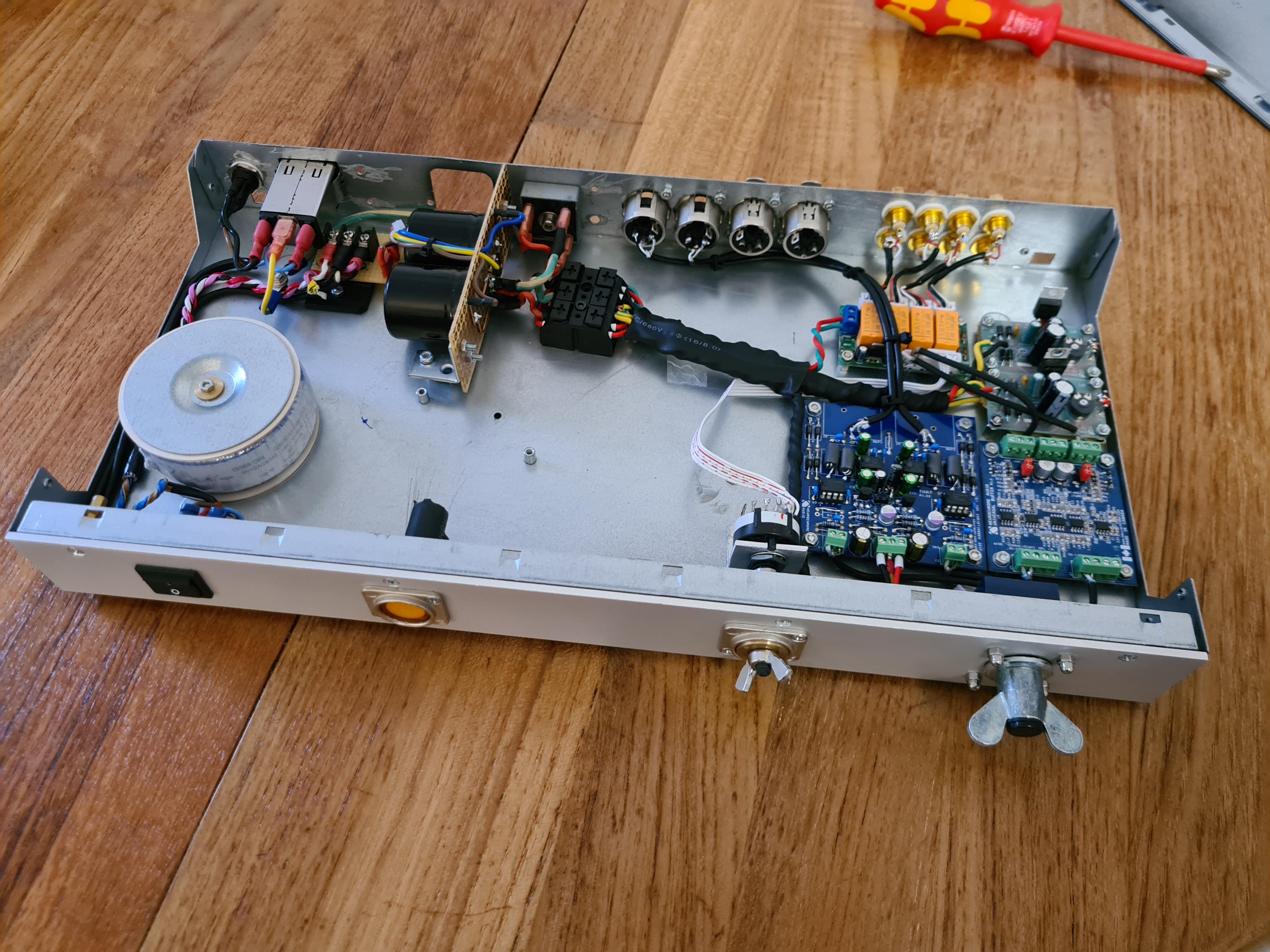

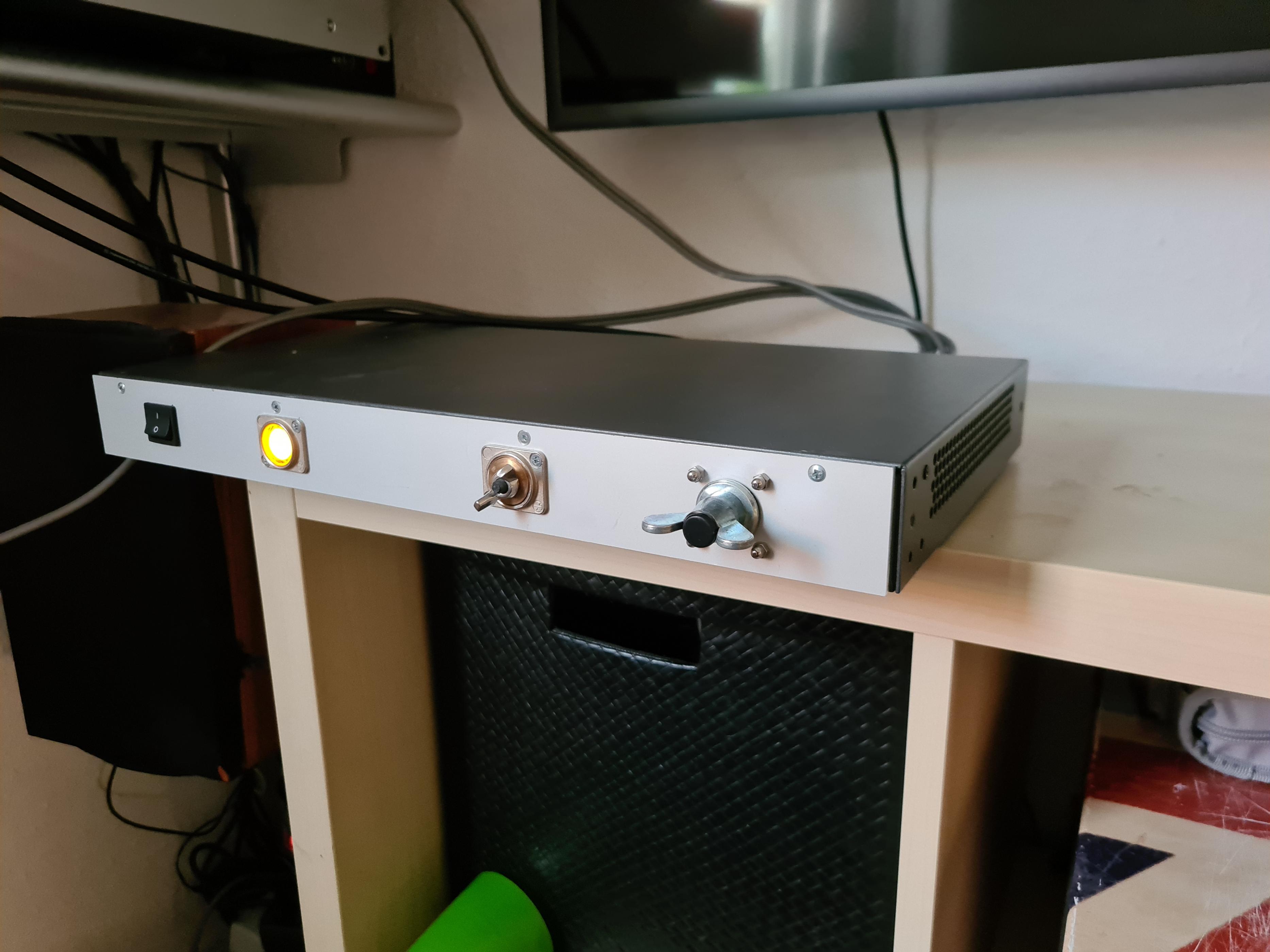

The case used to be a dlink switch. I have a lot of those cases around since I gut them for the PCB which we use in our multi link gateway device.The front plate was found in a pile of ruble at work. It was predrilled which you might see. Pictures of the innards will follow.

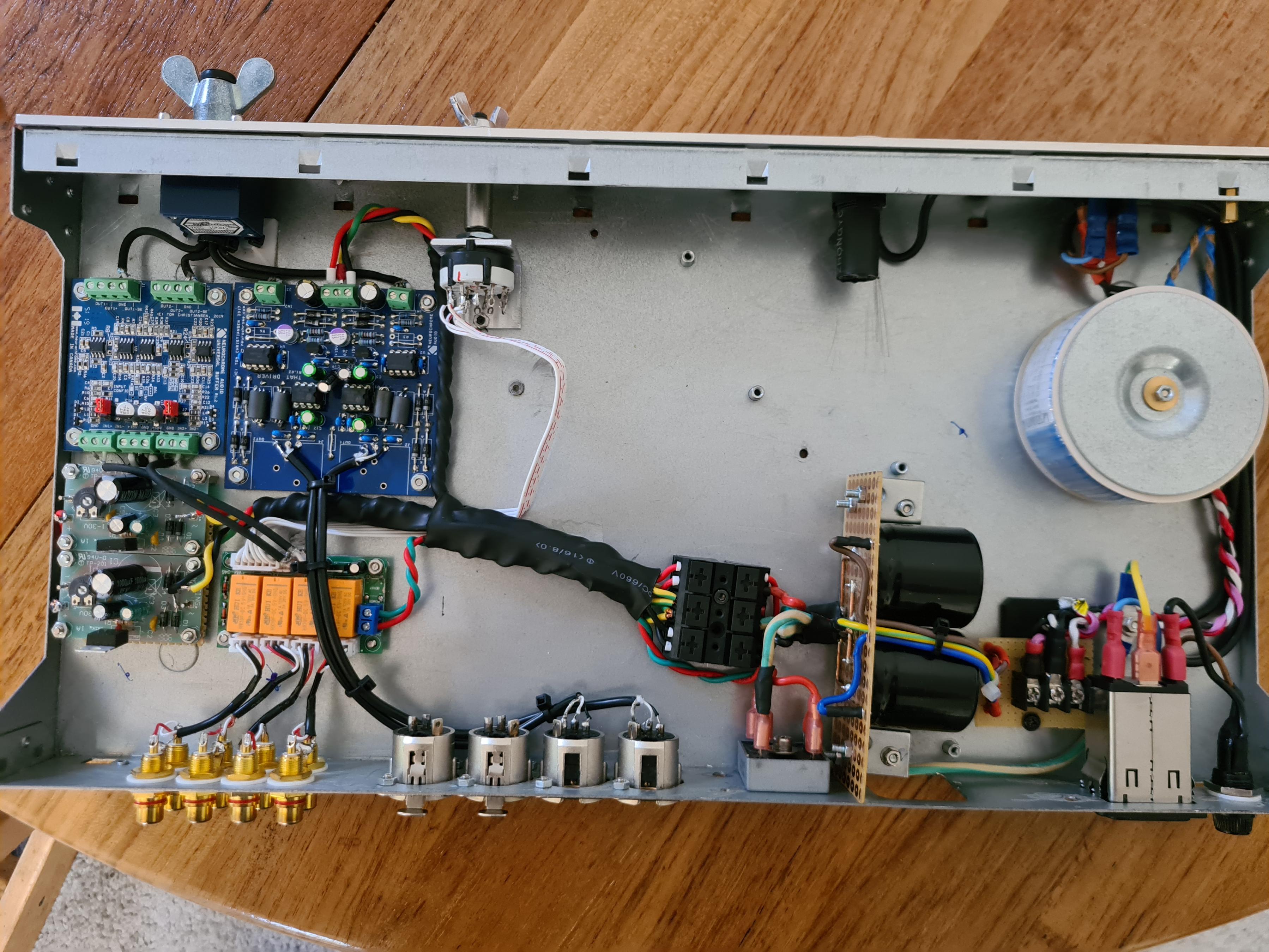

Relay input pcb from Amazon. LM317/337 from Conrad. Various stuff, overkill power supply. Will tidy up the wiring a bit. Lost patience yesterday when doing the signal wiring ;-)
Nice toroid transformer.
I'm not sure I like the control approach for the pot and sector switch; what was your aesthetic concept for them?
😊 Thank you!
The concept was, Corona home office without straight edge and much other than files and a power drill.

One of the things you might consider when using an 'over-sized' transformer is to add some 'dummy-load' to increase the current consumption - I know it sounds a bit weird but sometimes this helps the whole power supply and active system to function better - it's simple to add a 'soaker resistor' (of the appropriate power rating) to check this out for yourself - it's one of the reasons why shunt regs work so well with light loads.
😊 Thank you!
It looks a bit steam-punk-ish and it goes well with your nickname 🙂
Thank you, I will try that before I swap out the psu for a Silent switcher which currently resides in my other preamp (Tom's That driver sans Universal buffer)!One of the things you might consider when using an 'over-sized' transformer is to add some 'dummy-load' to increase the current consumption - I know it sounds a bit weird but sometimes this helps the whole power supply and active system to function better - it's simple to add a 'soaker resistor' (of the appropriate power rating) to check this out for yourself - it's one of the reasons why shunt regs work so well with light loads.
I really don't like the thought of killing my previous creation, that case and construction is the best I can manage at this point. I'll post pics after work.

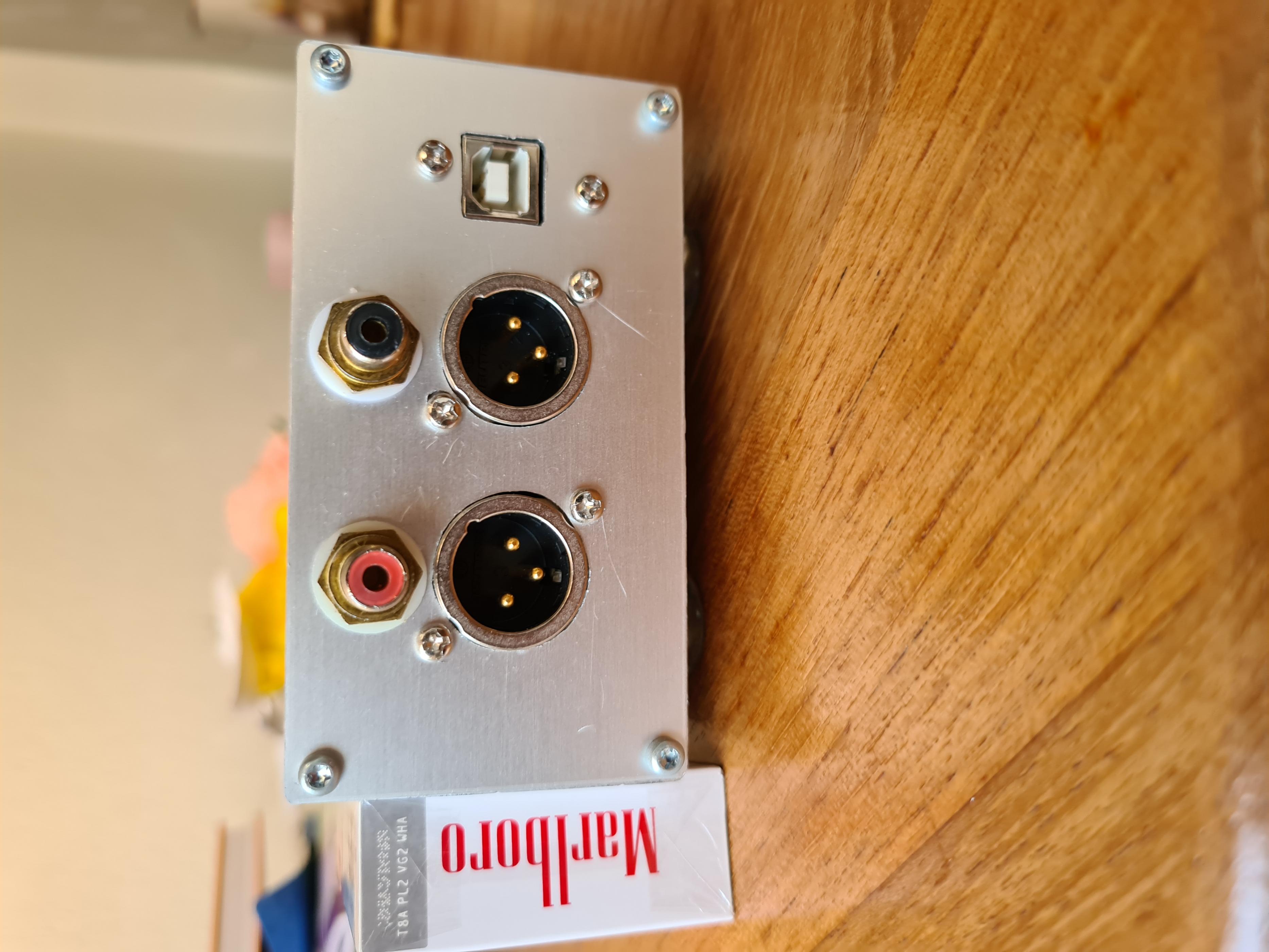

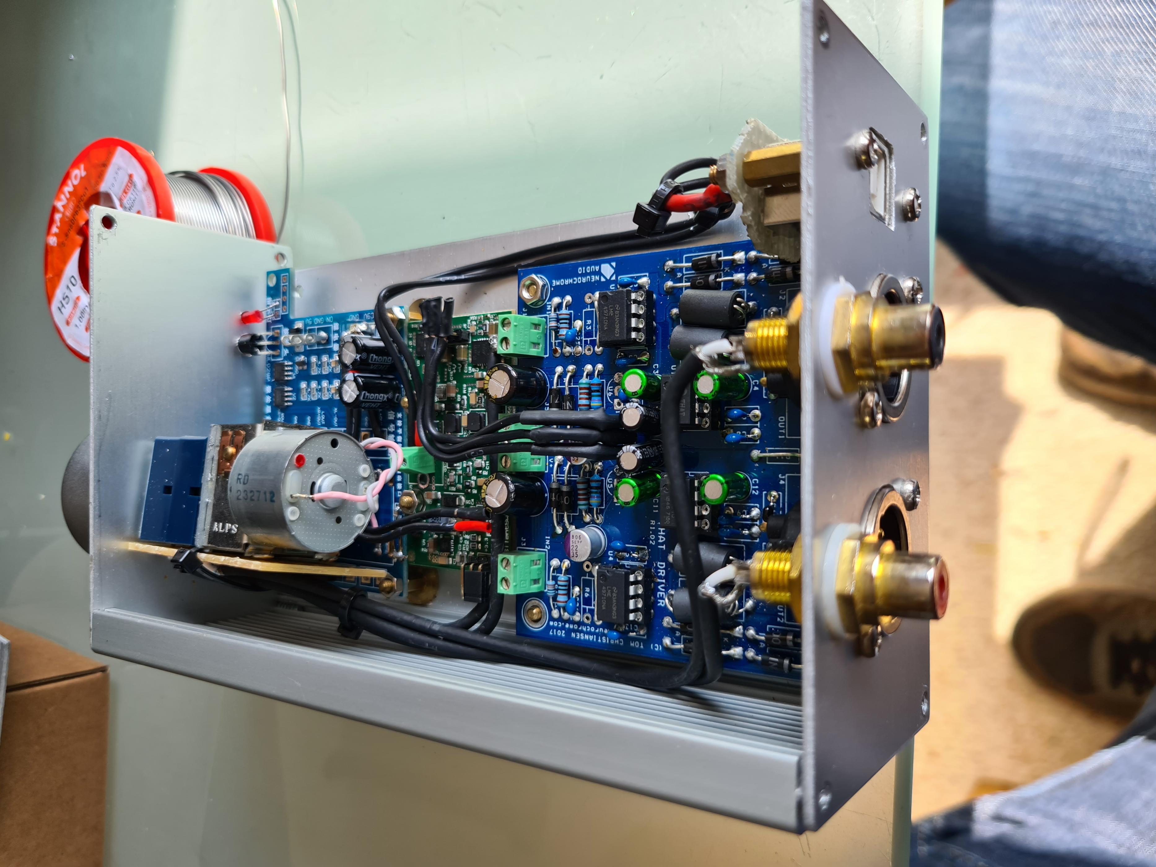

There is a That driver board in there along with a rk27 motor potentiometer and remote control pcb. And a silent switcher. If I could fit the universal buffer in there tas well, I would. A couple of extra inputs would also be nice.. I don't know. Two preamps I can't put to use.
I am very happy with this compact build. Perhaps it would be better to stack the universal buffer on top of the That driver board using angles and standoffs.
I could put a second pair of phono inputs on the back and use a toggle switch for source selection.. I can't decide right now it seems.
To qualify my previous statement of great bass, the difference can only be heard when playing vinyl. My network player sounds the same with or without universal buffer. Works as it should, one could say. I suspected that my phono preamp could not drive the 10k potentiometer. That's fixed now.
Forgot the picture. The pics look like they do because of me posting with a cellphone

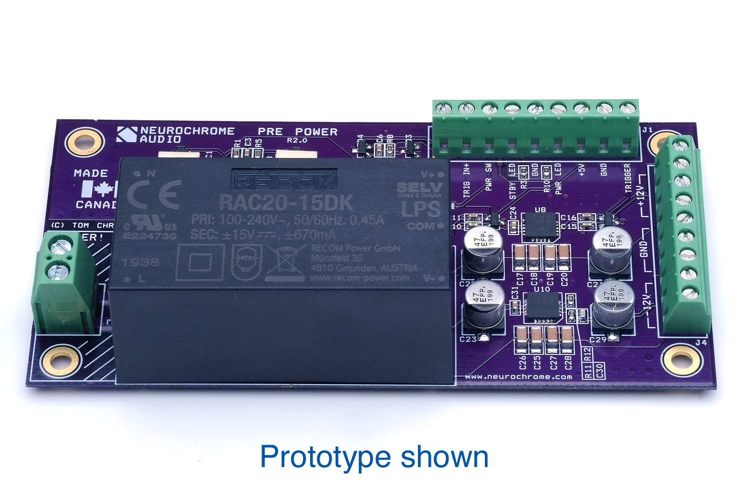

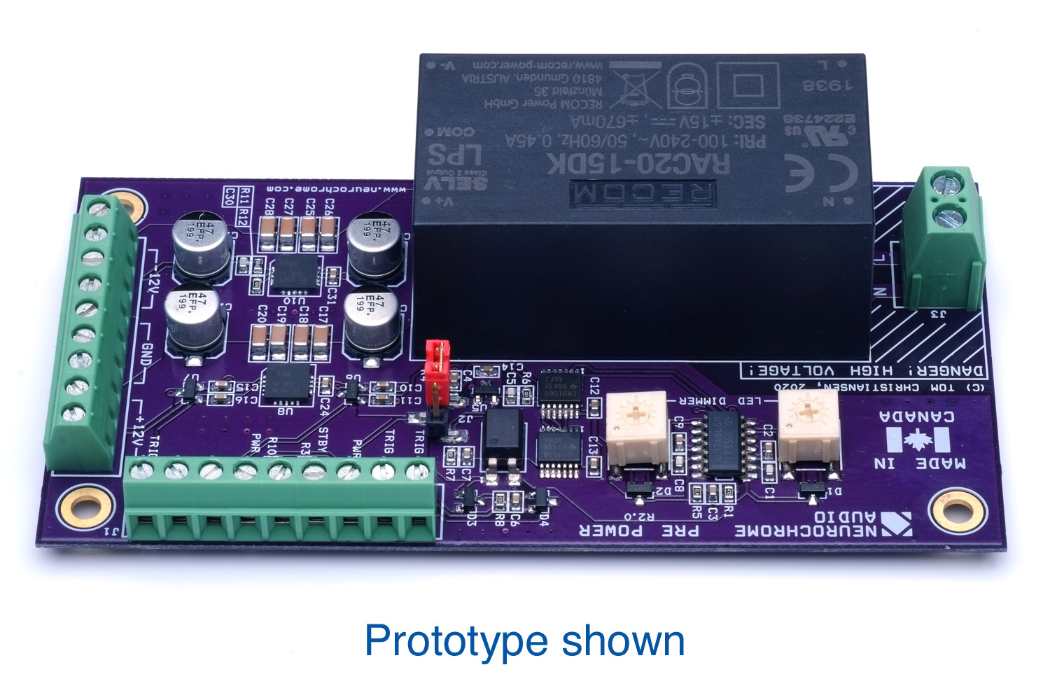

For those planning to use the Universal Buffer as part of a high-end preamp, I now offer this low-noise power supply: Preamp Power Supply – Neurochrome
I have started a separate thread for the Preamp Power Supply: https://www.diyaudio.com/forums/ven...reamp-power-supply-12-650-ma.html#post6259992
The power supply is currently on intro sale at $139. The sale will end, and the price increase to $159, once I receive the first batch of supplies from my assembly house.
Tom
