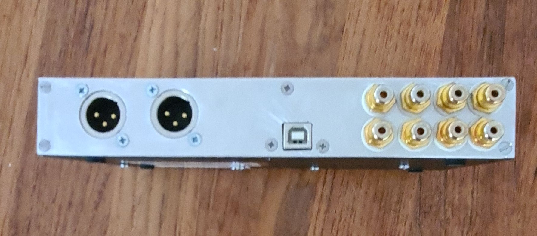

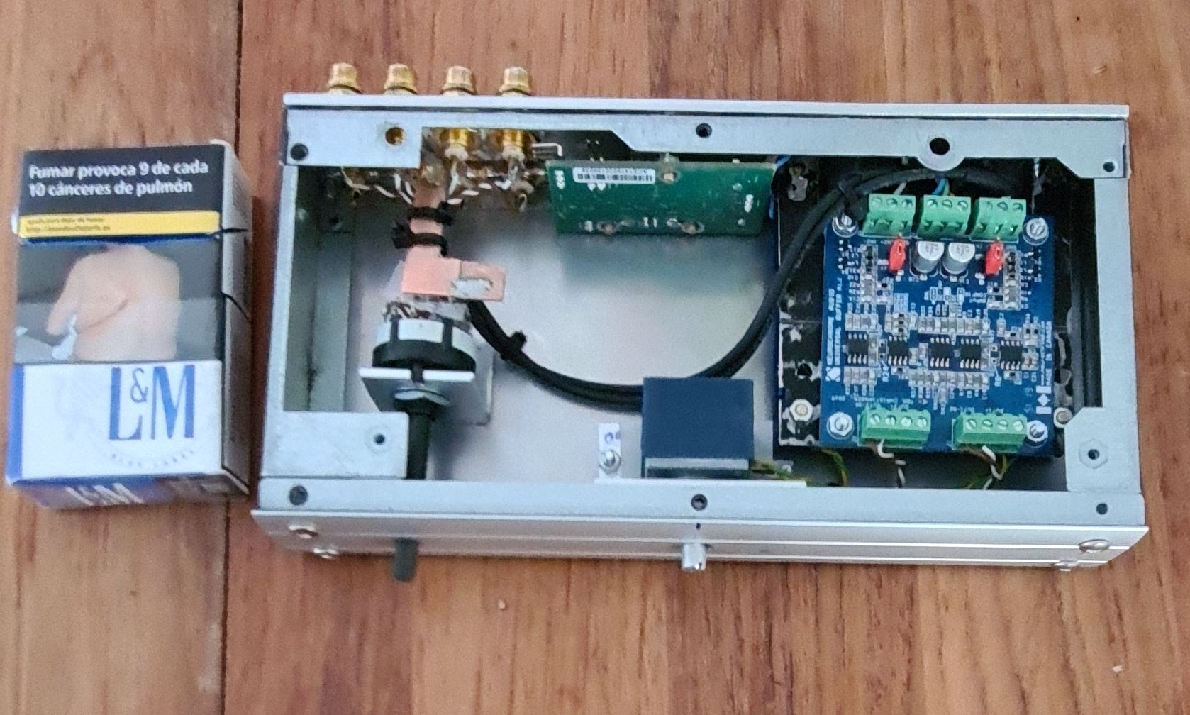

Progress, change of case and PSU. There used to be a firewall in there. PSU is the SilentSwitcher of Jan Didden.

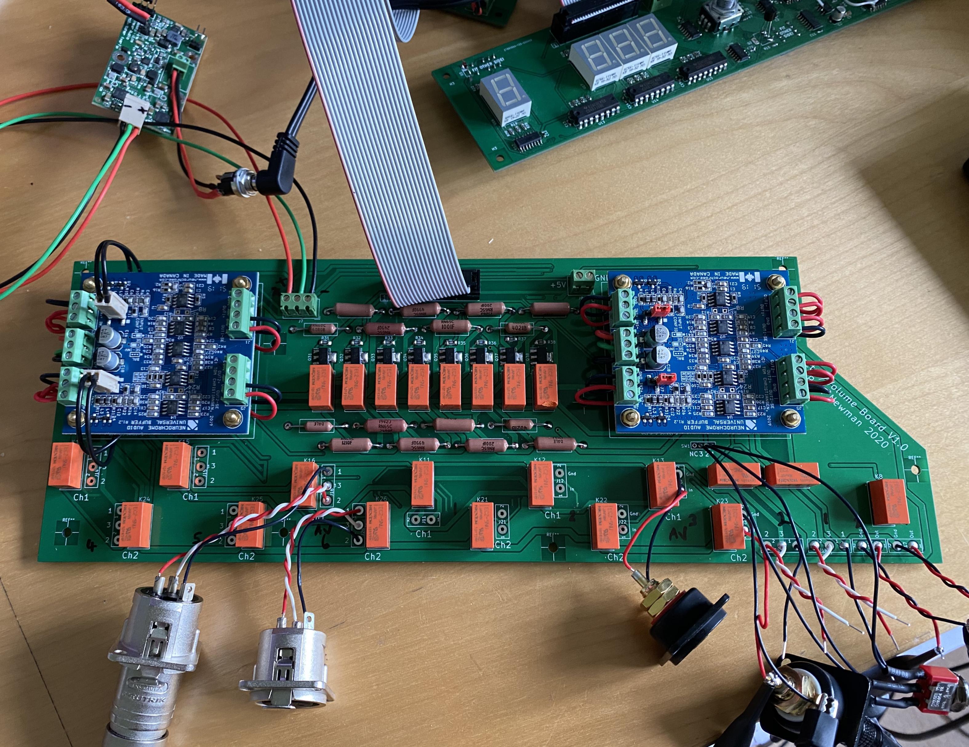

Here’s mine in testing.
The basic setup is UB1 is used as the input buffer, six inputs with switching of the UB between balanced and SE depending on the input. UB1 drives the relay controlled volume circuit (in SE mode) before UB2 acts as the output buffer proving both SE and balanced outputs.

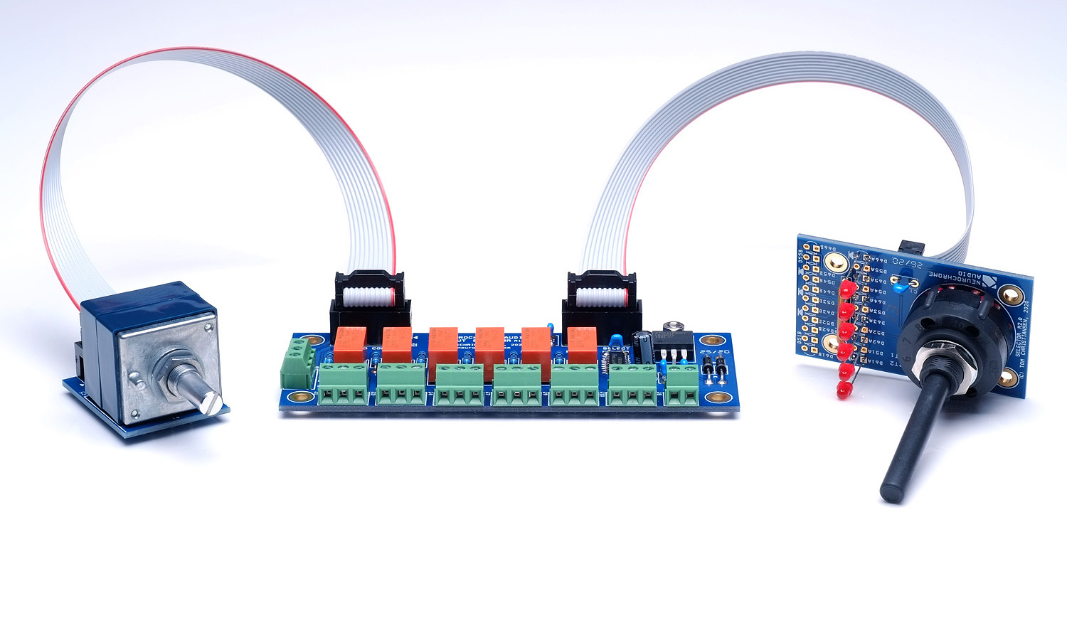

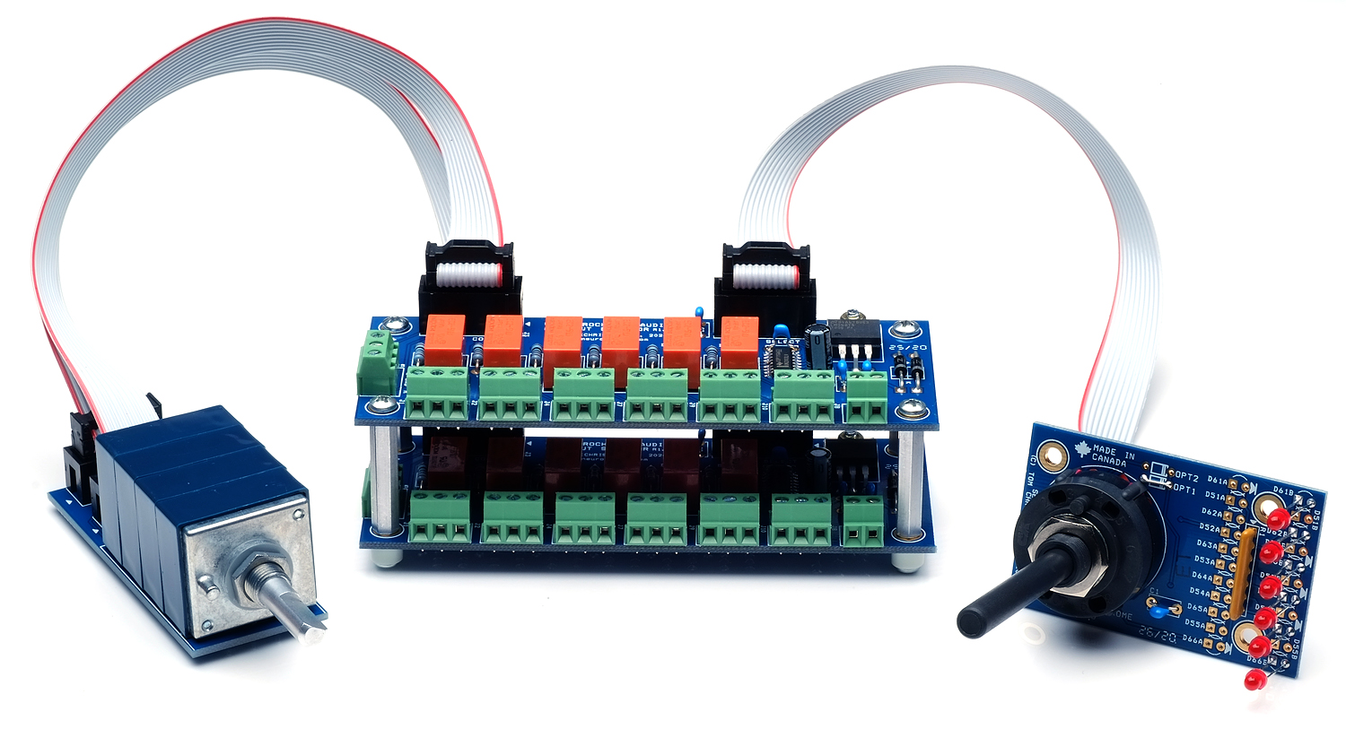

Very cool! Thank you for sharing. Meanwhile I'm working on this li'l project. I'll spin it into a fully differential preamp as well. I'll start a separate thread for that once the differential volume control is ready.
Meanwhile, you can find the input selector here: Input Selector – Neurochrome
and the rotary switch and volume control here: Selector Switch & Volume Control – Neurochrome
Tom

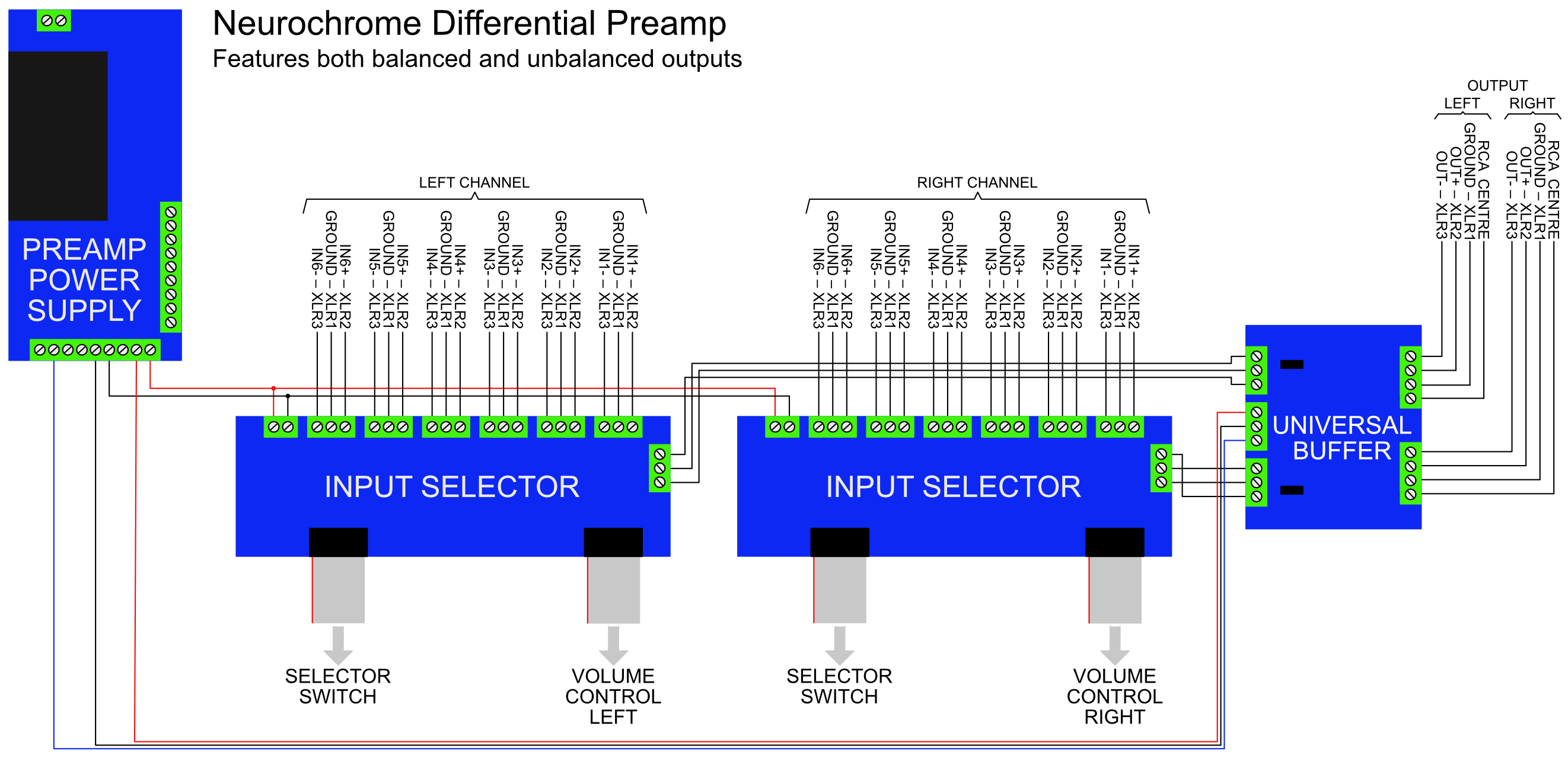

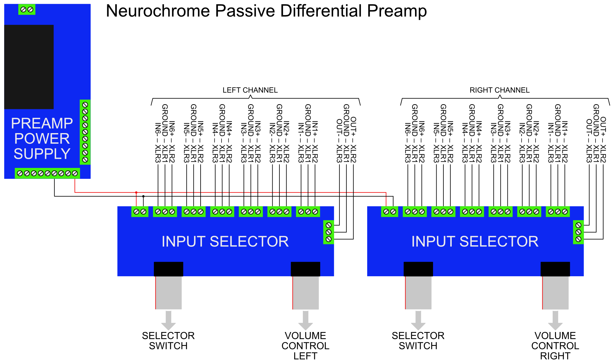

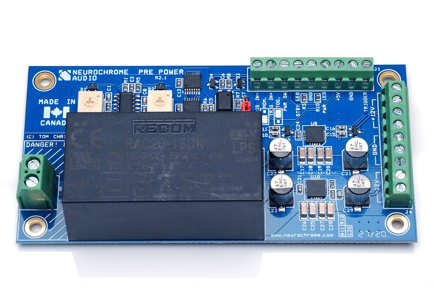

I added a Differential Volume Control board to my portfolio. It supports the 4-gang Alps "Blue Velvet" (RK271-series) volume pot. When combined with two Input Selector boards and one Selector Switch, you get a fully differential passive preamp. The two Input Selector boards are daisy chained in their connections to the Selector Switch.
You can add a Universal Buffer if you'd like a buffered output. You then get both a differential and a single-ended output. You can use both at the same time if you wish.
I've shown my Preamp Power Supply in the wiring diagram for the passive balanced preamp. It may be a bit overkill in that application. After all, the only things that require power in the passive pre are relays and LEDs, so the power supply could be a 12 V wall wart. I would argue that a good power supply is needed if you wish to make the preamp buffered as shown in the second wiring diagram. The Preamp Power Supply is appropriate here.

Tom,
Can you power the input selector boards with 5V and then not populate your regulator and PS stuff on the board?
I was going to put the input selector in my DAC. Turntable is on the other side of the room. So I was putting a THAT driver board in the phono pre and running XLR to my DAC. The DAC is single ended so I was going to run the DAC through a THAT driver board, then connect it and the phono to a pair of input selector boards. I need two XLR outputs. Can I parallel the one outlet XLR connection to get two?
Sure.
If you want two XLR outputs, you have two options:
  1. Use one UB and connect the balanced output to two XLR connectors.
  2. Use two UBs.
The drawback of option 1) is that whatever is connected on one XLR output can affect the performance of the other output. Let's say, for example, that you have XLR out 1 connected to a power amp and XLR out 2 to a headphone amp. Turn the power amp off and its input impedance can get a bit wonky. This can affect the performance you'll have through the headphone amp (and vice versa).
The drawback of option 2) is cost, though it does get you closer to my bulk discount thresholds... 😉
Tom
