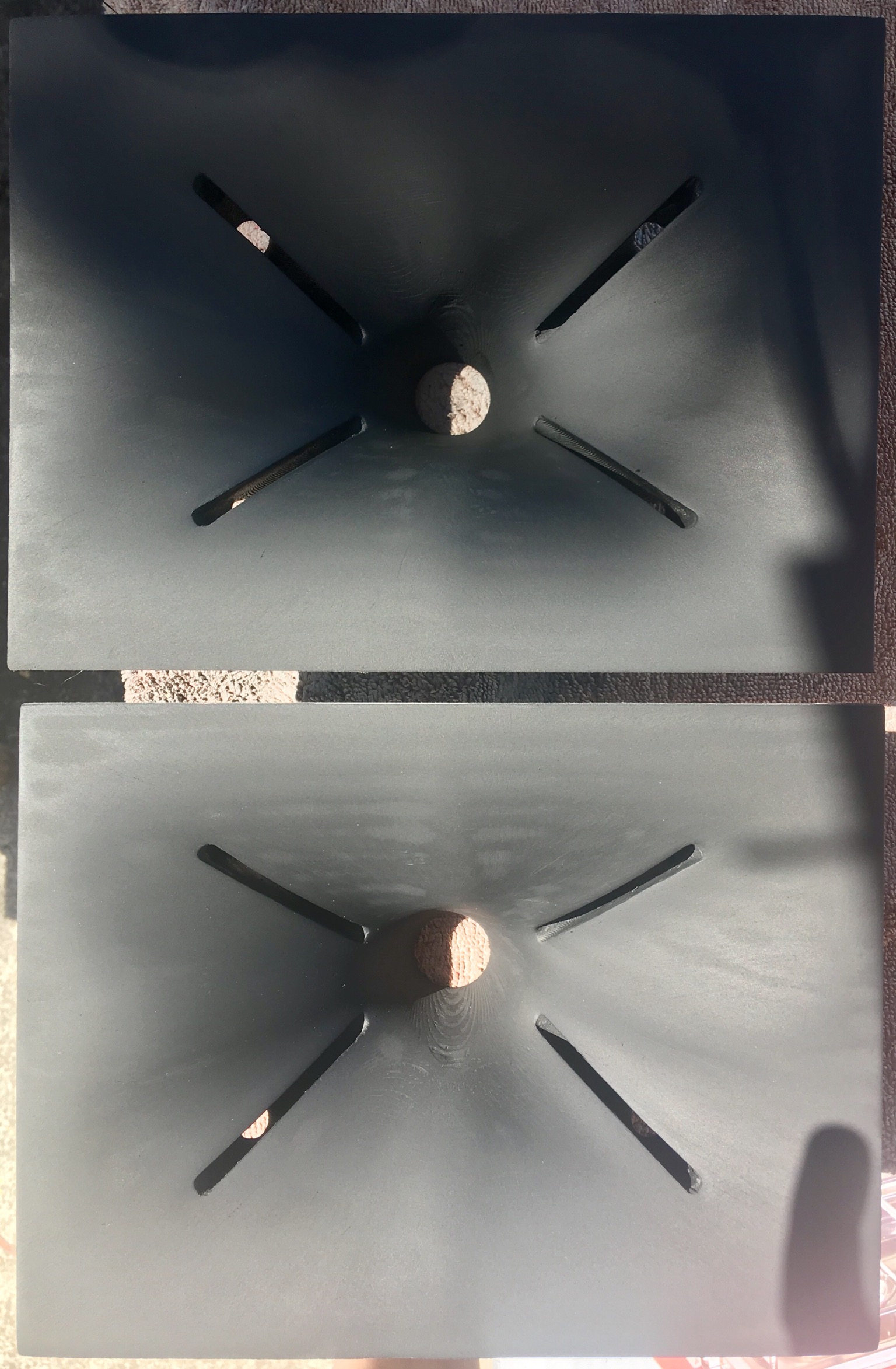

Look for "Filler" as a spray can to easily fill up small bumps. Depending on how glossy you want to go in the end, this might even be enough to apply some texture paint.
Many materials don´t stick well to most plastics - so you might want to check if your coatings are not coming of again... Going for 2K Paints/Fillers might help then. Having a rough surface on the plastic helps the paint to stick bestter to the Horn.
Thanks guys, I appreciate the advice.

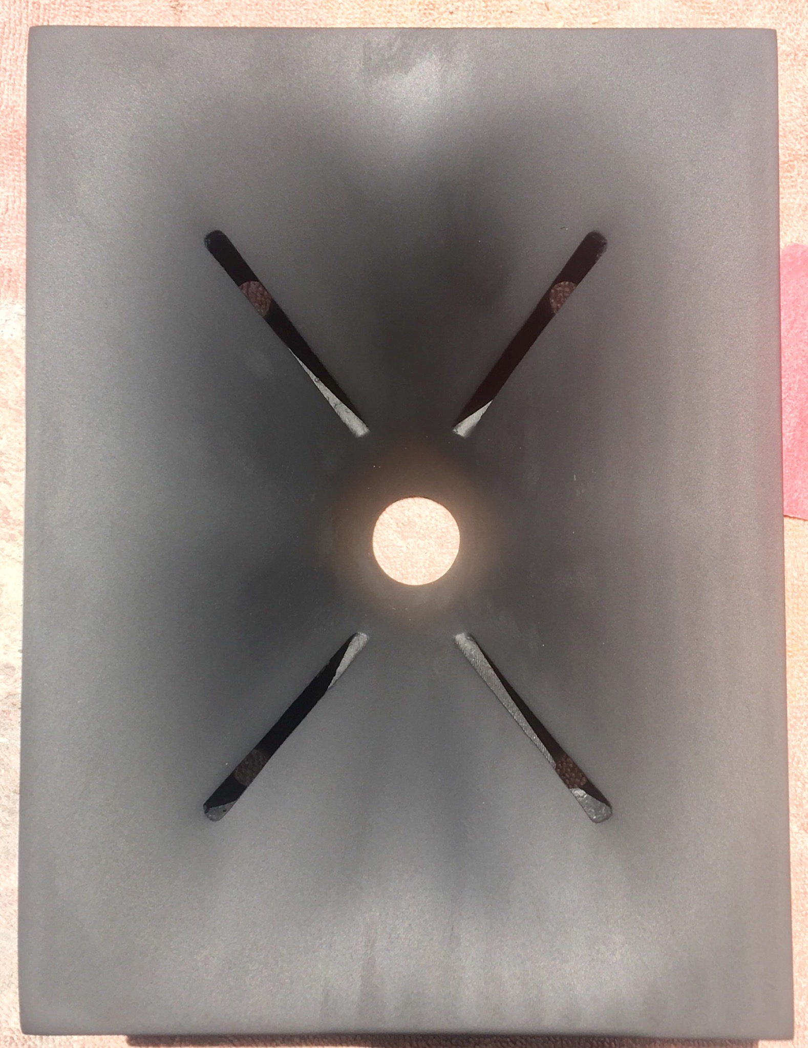

So after re-applying and sanding down a second coat of woodfiller (150 grit), I resprayed a coat of primer. With the exception of the throat, I am more or less done with filling and can proceed with smoothing with 220 grit. I may get to that today, before applying what *should* be my final coat of primer. I probably won’t go any finer than 220 grit, as the gloss topcoat needs something to bite into.

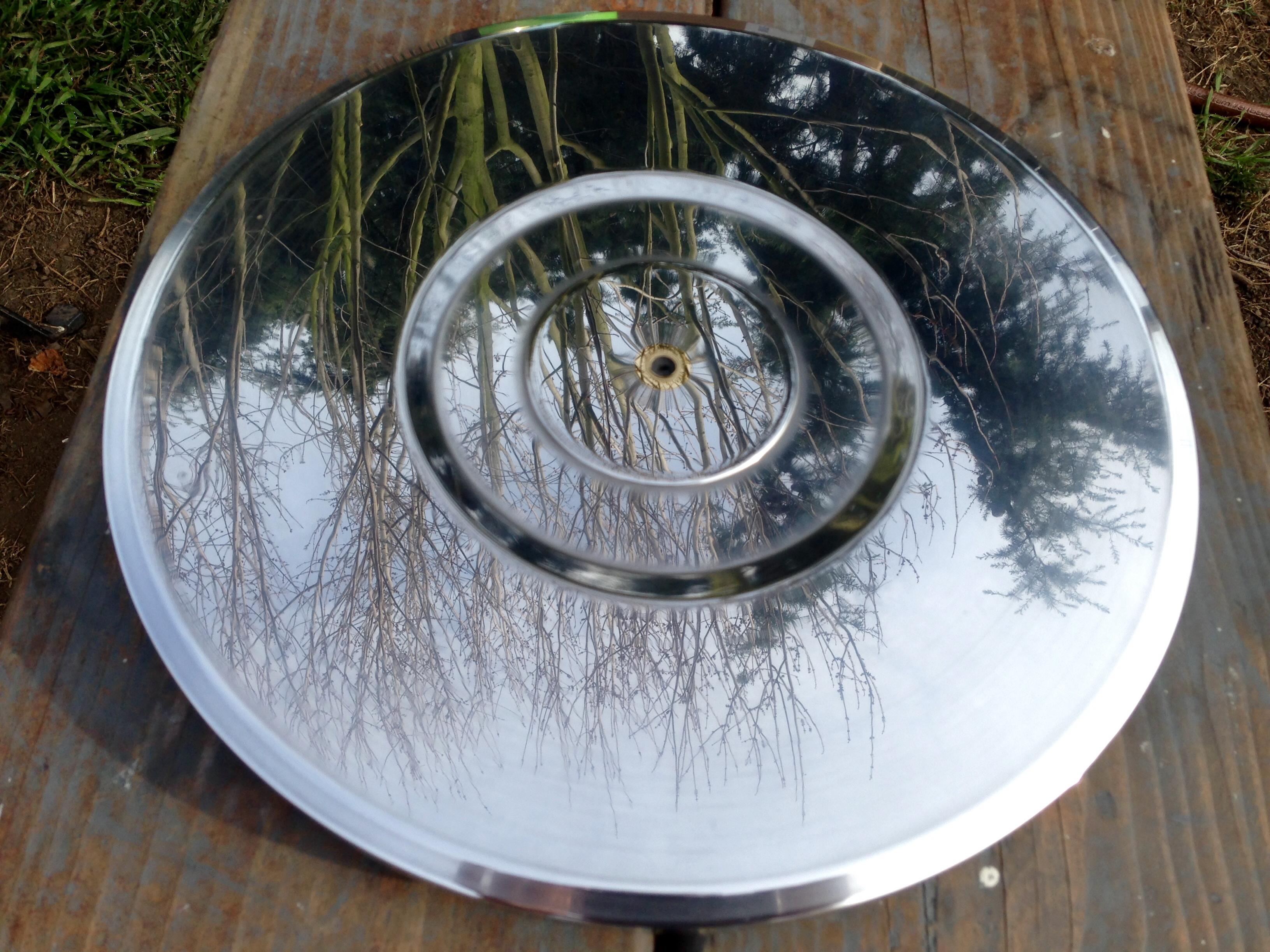

Also attached is a picture of the glossy shine I was able achieve on a turntable platter, using good old elbo grease & soapy water, followed by some polishing compounds. These stock Lenco platters are make of potmetal and are a dull grey color.

Plastics can be problematic, but with the right knowledge and using the correct materials, paint finishes can last.
With regards to sanding, each successive step needs to be just coarse enough to remove the sand scratches from the previous step.
With automotive materials including polyester filler: P80>P180, backsand into the p180 sand scratch with P400, then prime with a quality primer surfacer.
Spray can materials do not have the same film build as a quality 2 component primer surfacer or 2K topcoat sprayed from a paint gun, there is not enough pressure in the spray can to achieve good atomization, so the material must be thinner in viscosity.
If you are spraying these with a spray can solid color high gloss finish, use P400 grit dry / P500 grit wet. Metallic colors will need one step finer, otherwise the metallic can highlight the sand scratch. P500 dry / P600 wet.
If you prime over too coarse a sand scratch, it will come back to haunt you once 100% of the solvents have evaporated through the film, and you have topcoated the project.
Paints with too 'hot' a solvent can be problematic on some plastic, causing crazing and/or substrate degredation. Paint manufacturers have specific recommendations for each different plastic or blend of plastic.
In this instance, the finished product only has to look as good as my veneering does. I have little experience veneering but I’m improving. I also received some QC training at my last job (loudspeaker assembler at one of Danley’s competitors) and I tend to rely on those standards when I’m aiming for “good enough.”
I think it’s good enough where it’s at. More sanding and another coat of primer perhaps. After Monday, I’ll be in Germany for the better part of two weeks and won’t get back to any of that until I return.

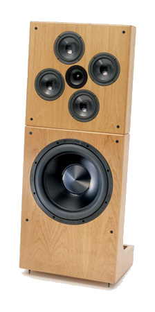

For my next project, I have been thinking about doing something similar to the JBL Synthesis 1400.
I don't want to bother making a waveguide if there is no interest, but if there IS interest, I'm kinda itching to have an excuse to buy a larger 3D printer and take a crack at this. (The reason the waveguide in the current project is 8.5" x 6.5" is because my 3D printer has a build volume of 8" x 8" x 7".)
The reason that I find the JBL 1400 interesting is because it offers directivity control, but the speaker is relatively svelte. For instance, my current waveguide loses vertical directivity control at about 2khz; if I doubled the height that would drop down to 1000Hz.
Naturally, many will say that horizontal pattern control is paramount. And I *do* think it's very important. But I personally prefer the sound of speakers with a wide beamwidth, and I am not alone; a recent blind test came to the same conclusion. (1, 2)
So my thought process here, is to create a waveguide that has the widest horizontal beamwidth that I can get away with, while also offering a relatively narrow vertical beamwidth.
If I went that route, I'd end up with something that looks a lot like the JBL 1400.

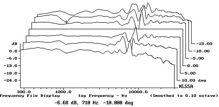

Here are the horizontal and vertical polars of the JBL. The discontinuity at 8khz is caused by the use of a supertweeter. I can do better than this because Unity horns don't suffer from this issue, due to their concentric geometry.
Here is the average of *twenty* measurements in a room, from the Stereophile review. You can see that the consistency of the JBL response is just freakish, which is why waveguides are so awesome. I think I could achieve something comparable (possibly superior) using a comparably sized Unity waveguide.

John, I know it’s a cone-and-dome design but you might consider the Meyer Sound HD-1 as a design reference for the unitized waveguide project. The HD-1 is a well-regarded powered monitor with an active crossover and an 8” woofer. You mentioned that an active crossover could correct the of the woofer placement issue of a few posts back and a two-way monitor using the unitized waveguide would have have a similar footprint to the HD-1. In fact, Meyer Sound released a sort-of successor to the HD-1 called the Amie, a major difference between the two being that the Amie has a horn-loaded dome for pattern control. Having heard the HD-1 I can say it has a very clear but relaxed sound. There’s also a lot of tricks employed to get the Hd-1 to sound that way, not least of which being the treated dome and very specific woofer.
