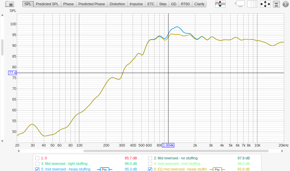

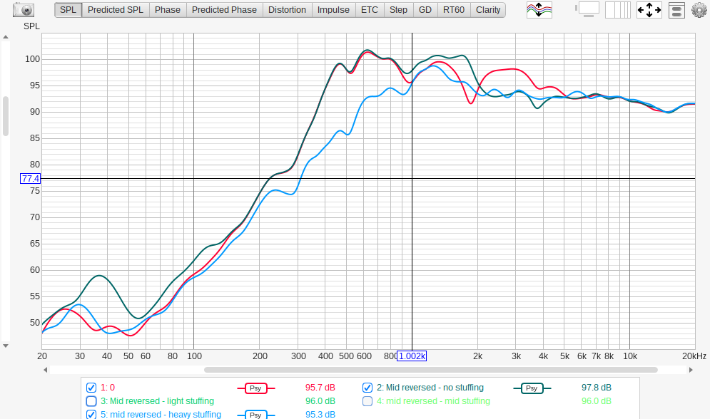

Got a Behringer UMC1280 to do some multichannel DSP, so revisitng this project. I concur in earlier posts that the mids on the speakers seem to be reverse polarity. So double checked, not sure if I switched in wiring or not, but measurements confirm mine seemed to be reversed in MY setup (yours may be different). I used REW to measure the waveguides, and here are some of the results:
First shows the frequency responses. (Red) according to schematic, (Dark Green) mids reversed. There is a dip at 1.8khz vs with mid reversed, so I assume that confirms its 180 out of phase. Then progressive levels of stuffing, it drops the frequency repsonse on low end, so a peak filter at 1.2khz can take care of that.

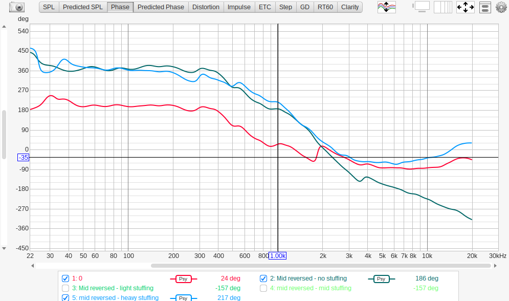

This shows unwrapped phase. Something odd going on with red, vs. green which is smooth (mids reversed). So I think this is the way it should be and are leaving the mids reversed from what I had.

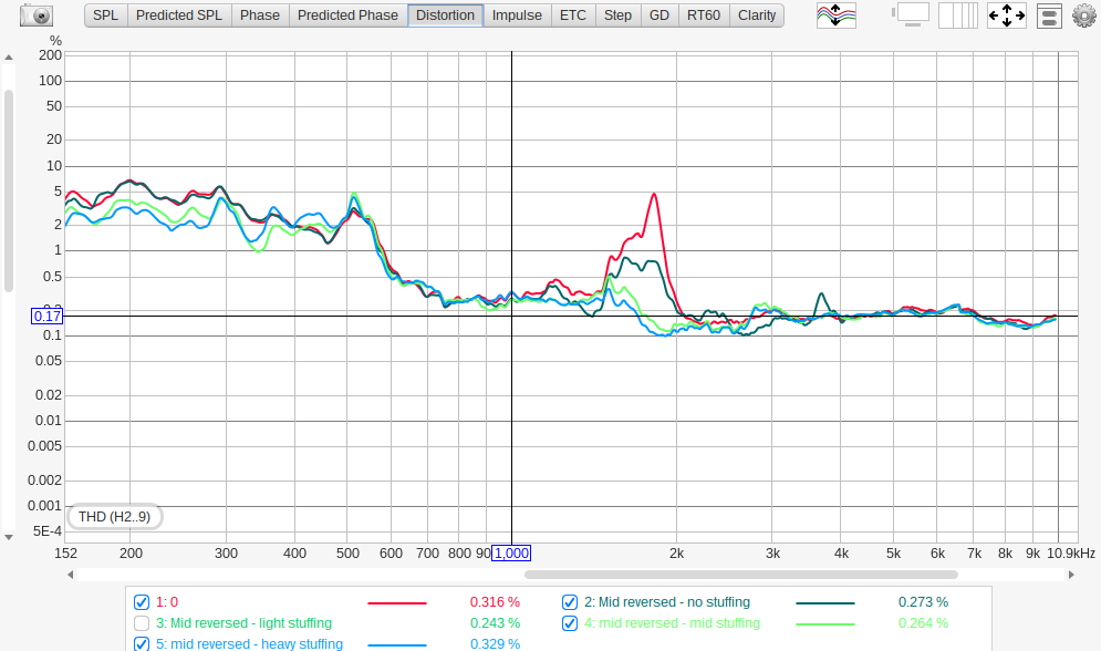

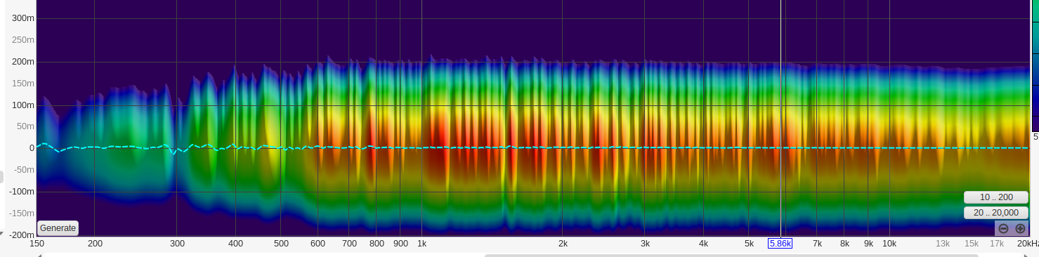

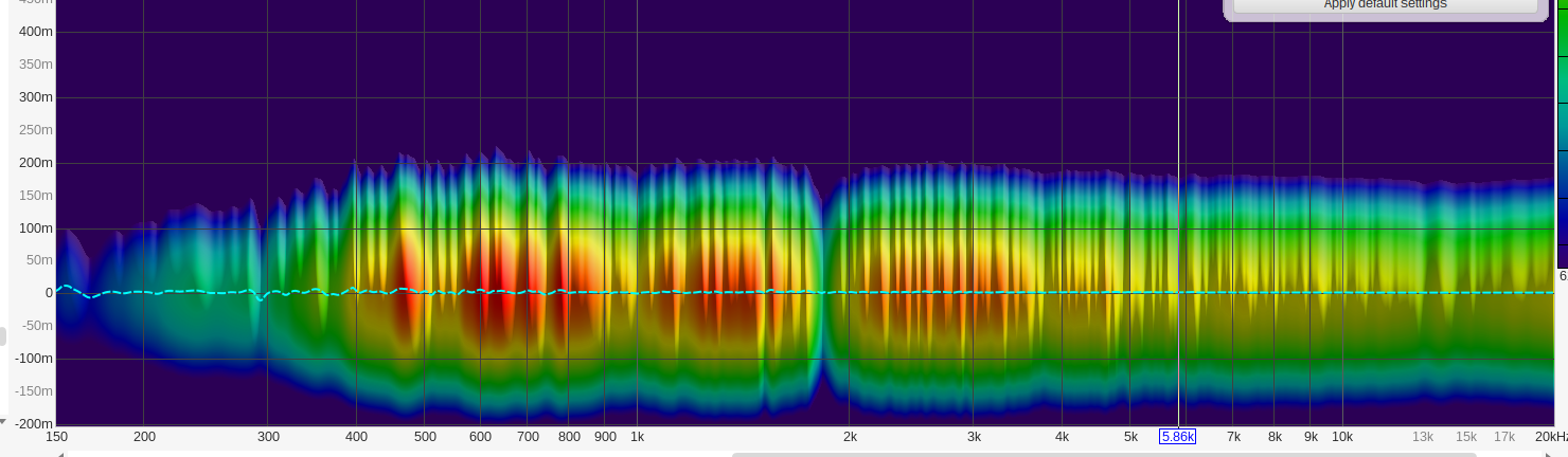

Here's the harmonic distortion. With the original, there is a spike, mids reversed (green) it goes down. You can see the effects of tuning with stuffing. Ideally, I would get this right, then tune each one individually using the DATS V3 and looking at the impedance graph. So despite the lower frequency drop, the overall distortion is at its lowest.
At this point, REW suggests a 1.2khz -4db filter.

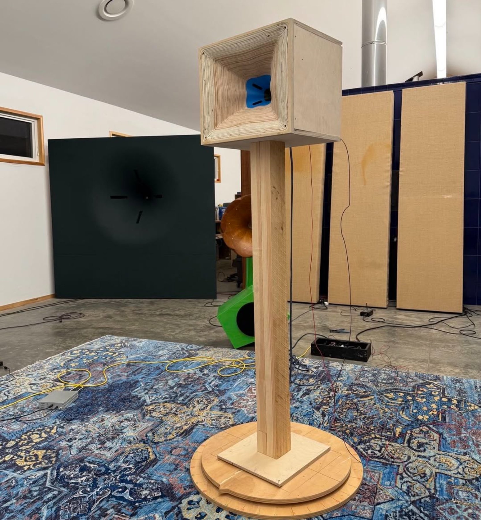

So this is where I started orginally:
And this is where I ended (flipped mids and adding 1.2khz, -4db crossover):
I think I did it right. Quick directivity plot around 0 - 45 degrees.

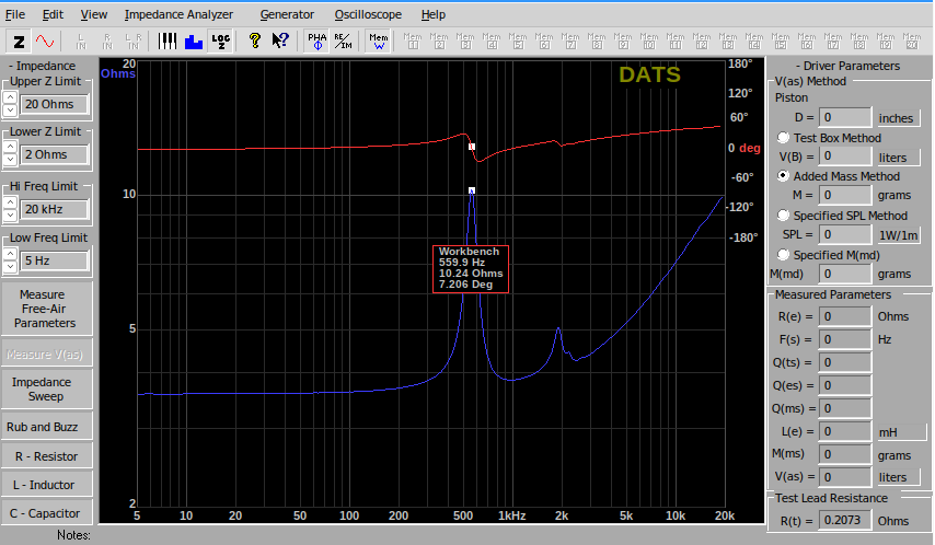

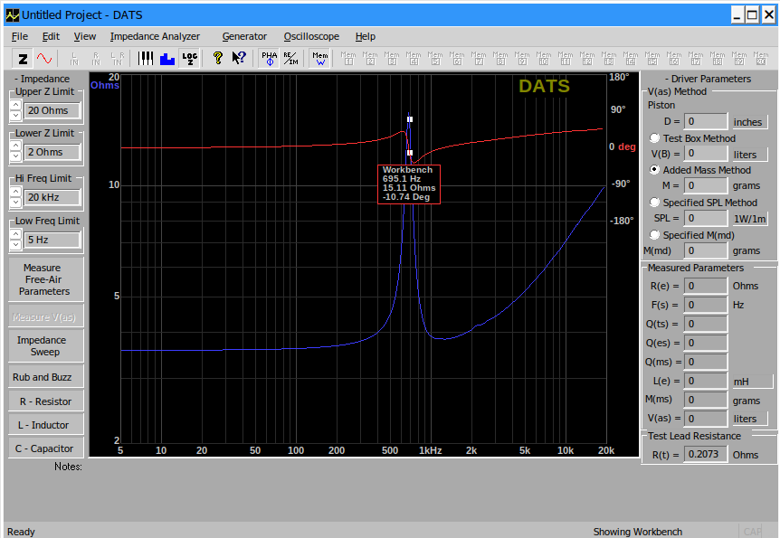

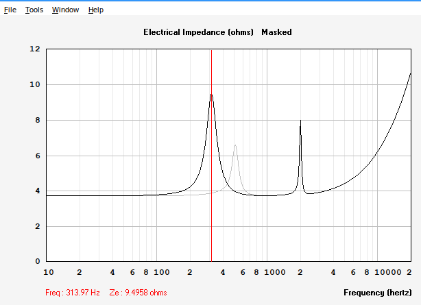

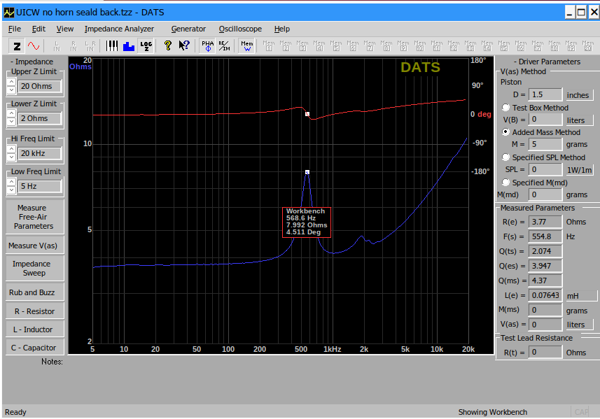

Below is DATSV3 data:
Gento driver (driver only), I use this measurement for HornResp driver data :

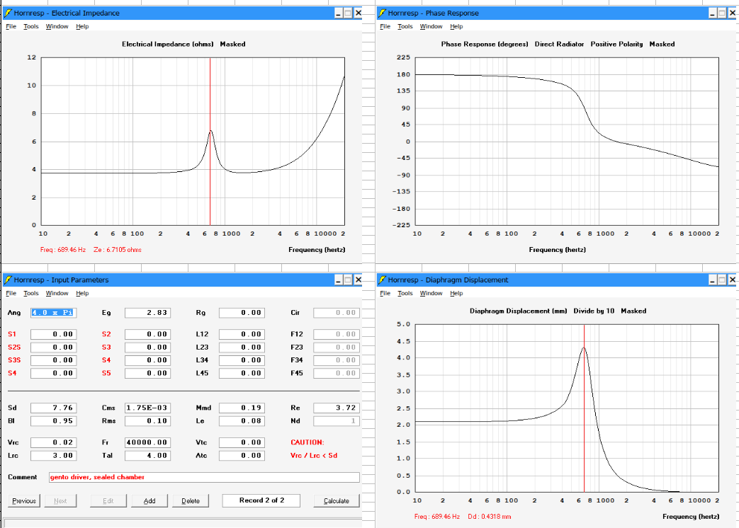

Test with Sealed back (no horn):
Modelled sealed enclosure only:
(Modelling this is close, HornResp shows about VRC 0.02L modelled give 689hz vs 695hz measured, so close enough for finding actual VRC)

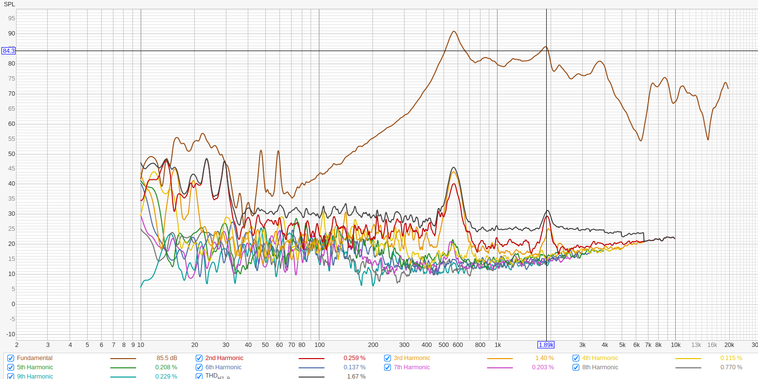

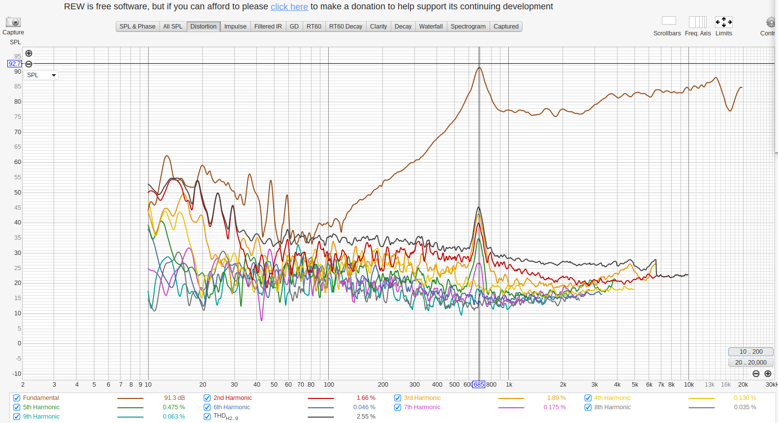

Use REW to measure the frequency response and harmonics:
(In this case, the diaphragm excursion matches the simulation, notice the spike in harmonics corresponds to the peak excursion)

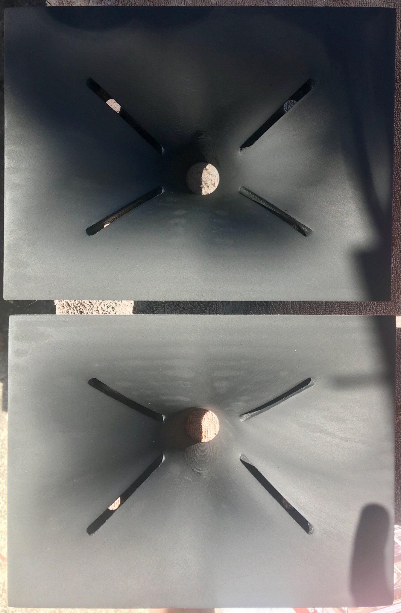

Now to measure sealed enclosure mounted to the horn (no stuffing). In PB's design, its a hole with a wide flare that entered the horn corner. In this case, the low end impedance peak lowers to 559hz and as a smaller peak now at 1.9khz, I presume this means more resoance contribution from the sealed chamber than the front:
REW measurement of a single driver in the horn (sealed back), no stuffing:
(Notice same peaks as what was measured with DATS - peaks have increase in distortion)

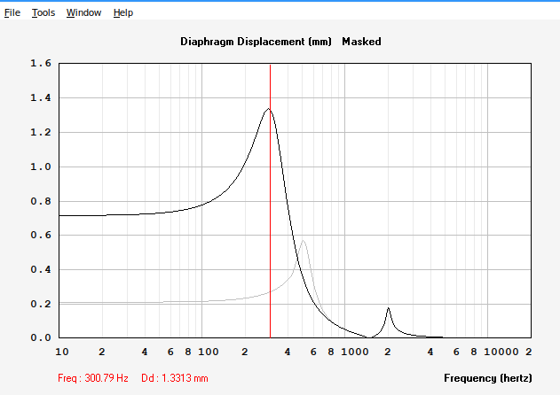

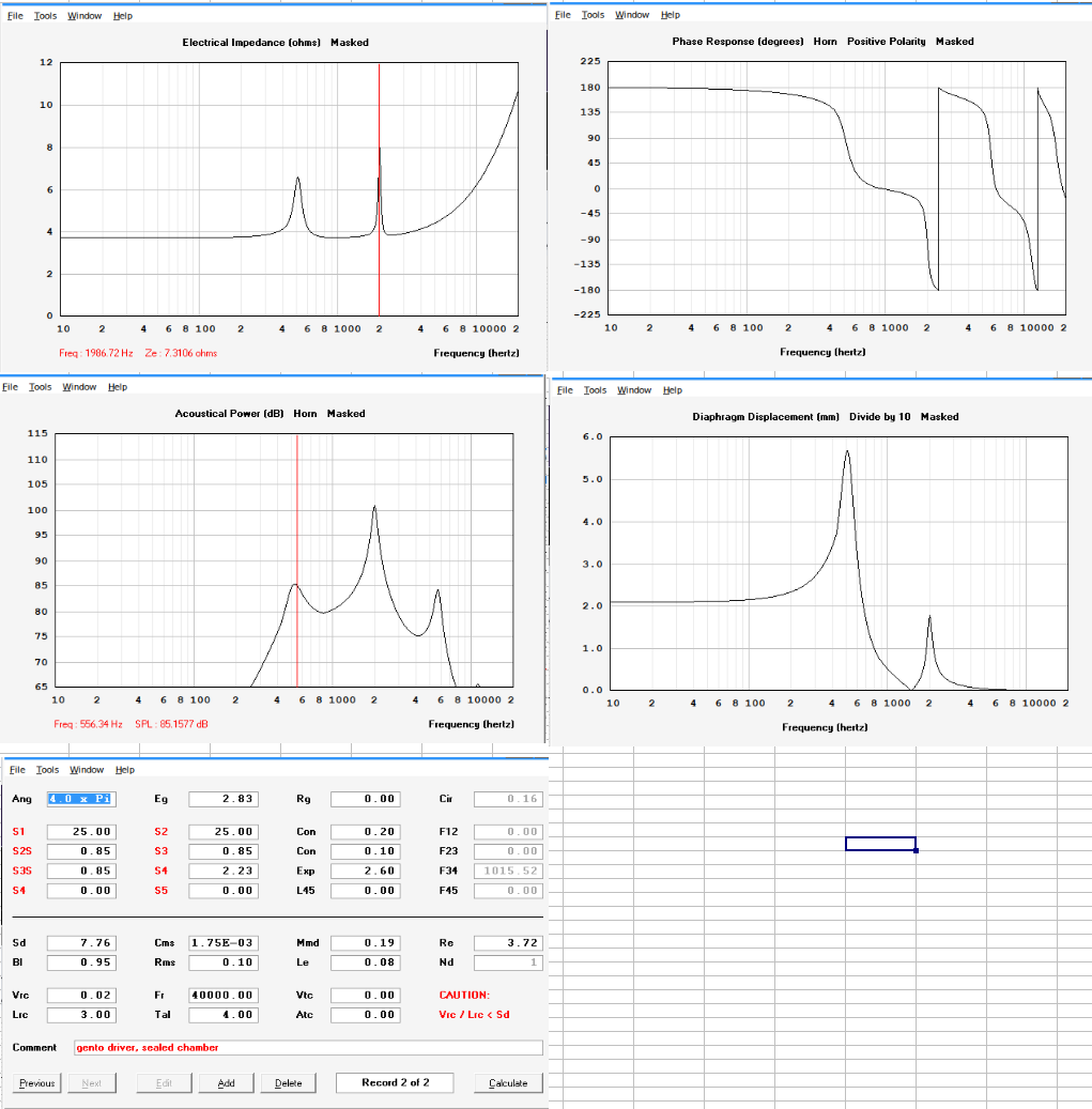

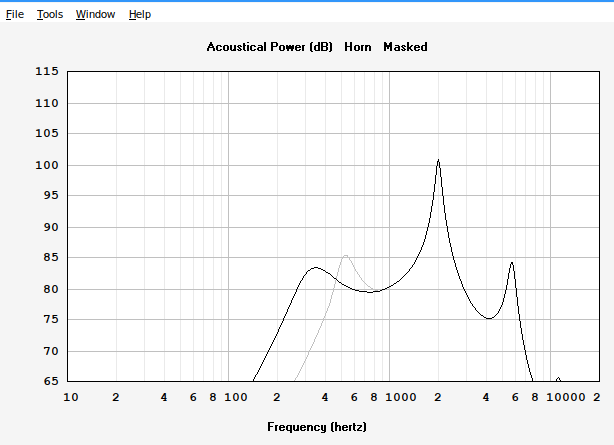

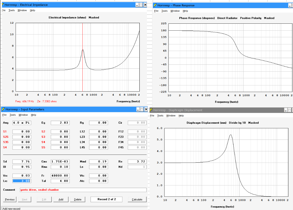

OK - time to model this in HornResp:
OK - so this is promising! You can see that the peaks match what I have measured. The magnitude is different.

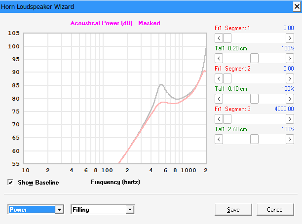

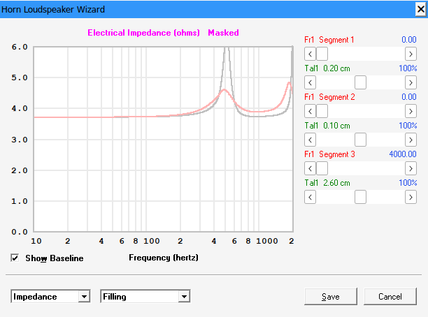

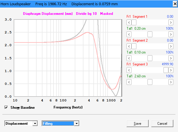

Now, let's simulate it with some stuffing on the front:
So this shows why stuffing works in the port, it reduces that 1.9khz excursion, at the expense of low frequency extension.
OK - so what's next? I believe I need to solve the impedance peaks. We know stuffing the ports works, but at the expense of low end extension.
I could:
A. Modify the entrance ports, but I don't want to redesign a new horn.....yet.
B. Modify the rear chamber. Making the rear chamber larger, from 0.2Lto 0.1L, lowers the resonance frequency, but increases the peak excursion:
However, the horn will be operated between the peaks, but will need a step filter for the highs. I am going to investigate taming the peaks with a metamaterial rear chamber. That is why I wanted to investigate enlarging the rear enclosure, to see if I could actually add this in the design, which I could definitely fit an extra .7L work of metamaterial to accomplish that. Anyway, that's it for now!
