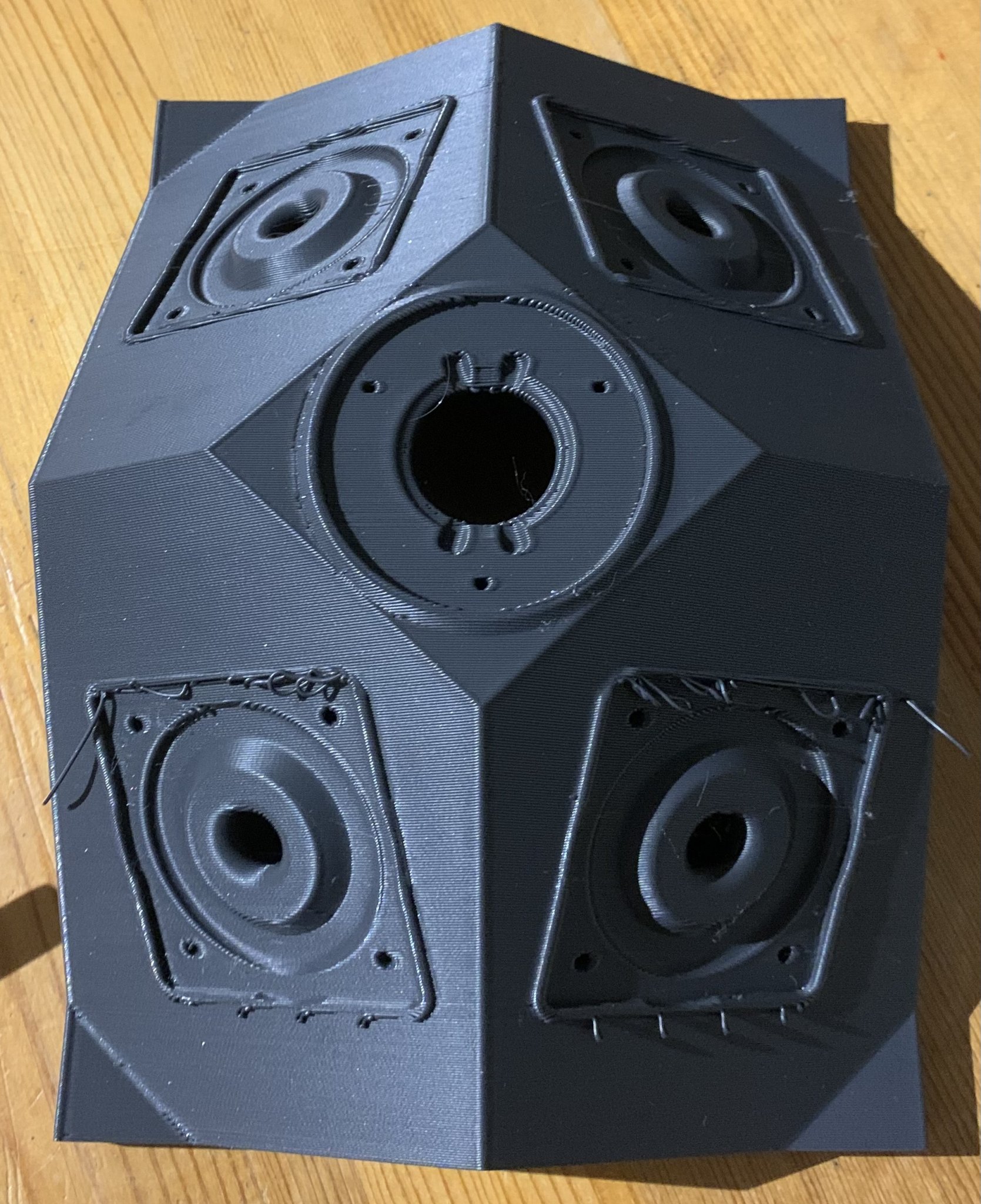

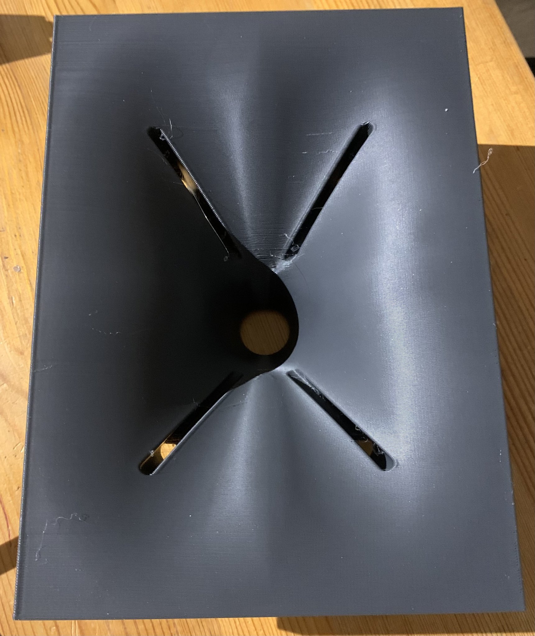

I modified the UICW for Guglielmo by merging the adapter to the waveguide, both generously provided by Patrick Bateman as source 123d files. I also modified it so that it could be printed on my printer upright (FLSUN SR) and only with minor flaws when printed without supports.
It could be modified to be without the lips around the midranges and tweeter and then it would be perfect even when printing without supports.
If @Patrick Bateman allows, I will share the STL and STEP file here if anyone is interested. It takes around 600 g of PLA and 15 hours of printing with 0.6 mm nozzle, 0.4 mm layer and 20% infill with three perimeters. The block structure makes it rock solid and acoustically dead.
The only drawback is that it is missing the mounting lip the original had - it was removed for printing without supports.
The print shows some little overshoots on the edges, that is just how my printer does it. A Prusa print would most probably look a bit better, but I have learned to live with this and it can be quite easily removed if necessary.
I must really appreciate the original waveguide design, it is really cool.

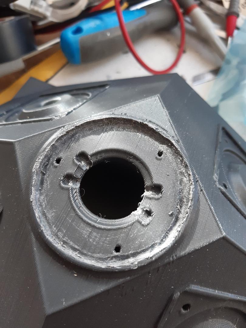

Hello,
right now I have very little time, I hope in February to do more testing.

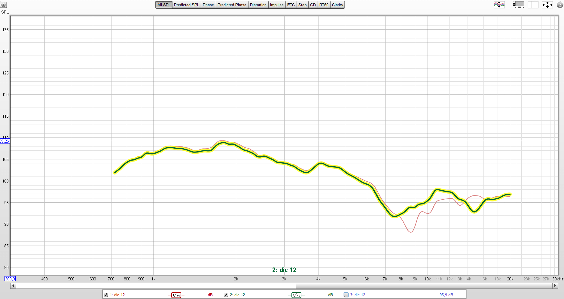

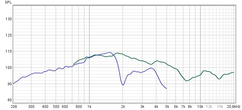

I installed the speakers without difficulty, only the tweeter needed a little Dremel work.
I made some measurements of the frequency response which I attach.
I noticed that the tweeter's response is better with a plastic-on-plastic assembly rather than with the interposition of putty.

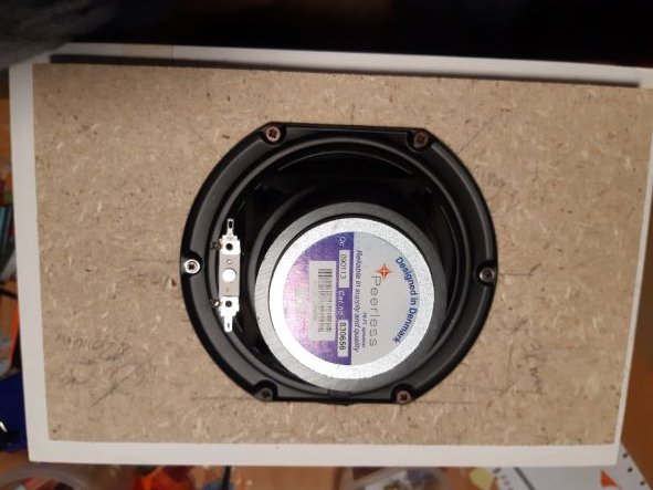

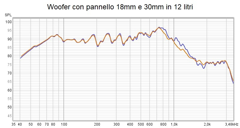

I plan to match inexpensive PEERLESS SDS-P830656 5-1/4" woofers and did some response tests through a cavity with 18mm and 30mm thickness.
The result seems satisfactory to me.
I am now preparing a test box with 4 woofers placed on the vertices from the horn.
Stay tuned.

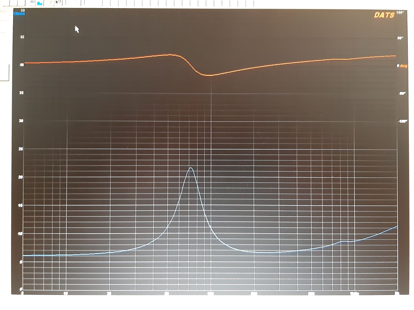

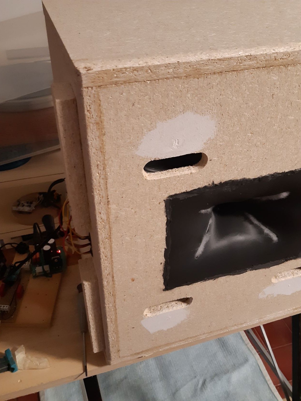

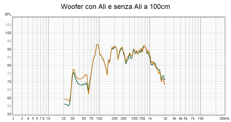

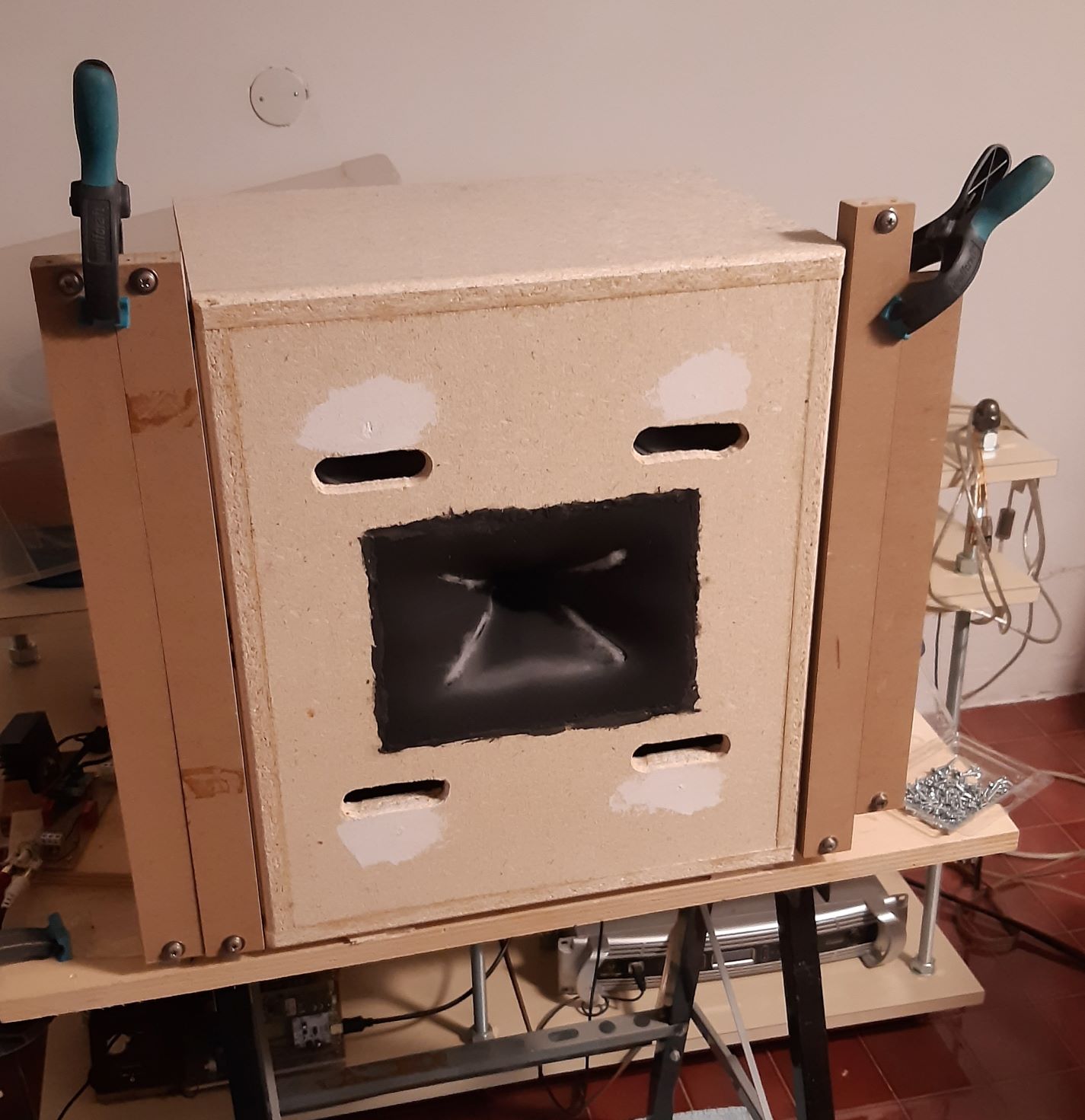

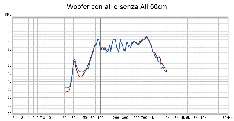

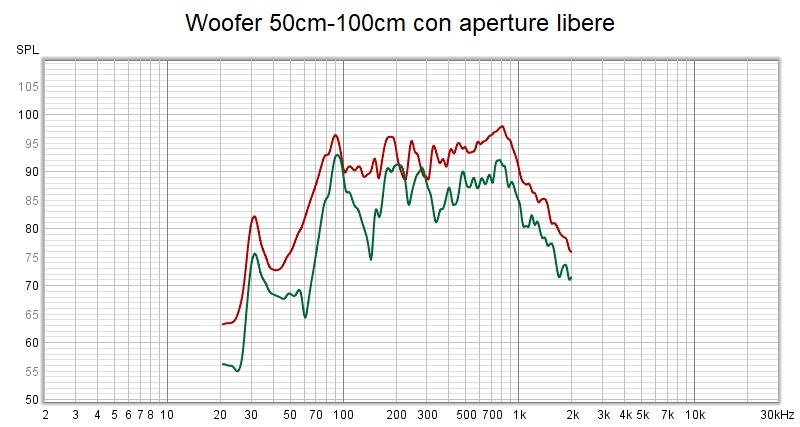

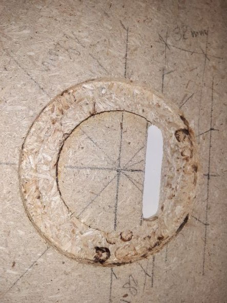

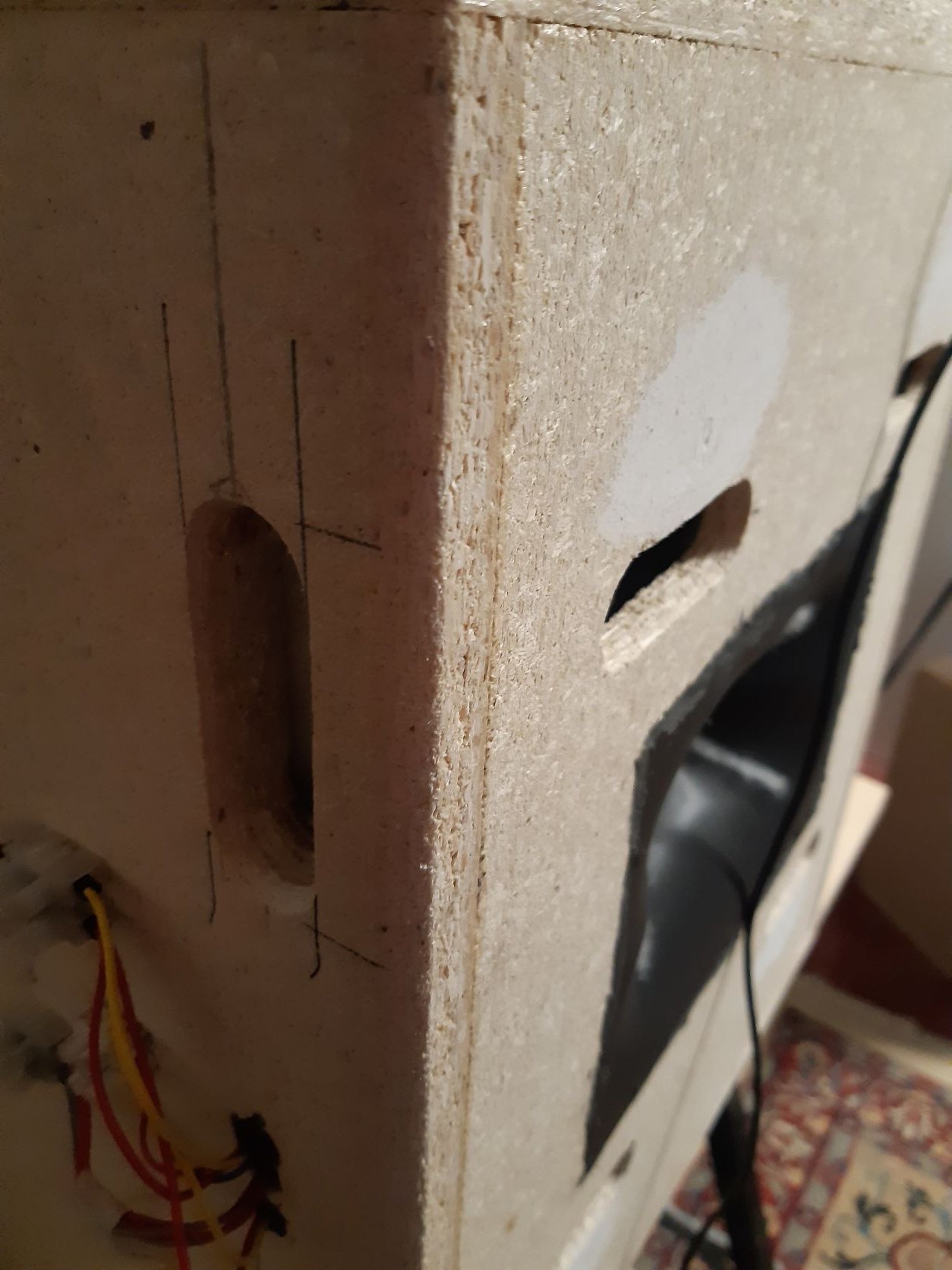

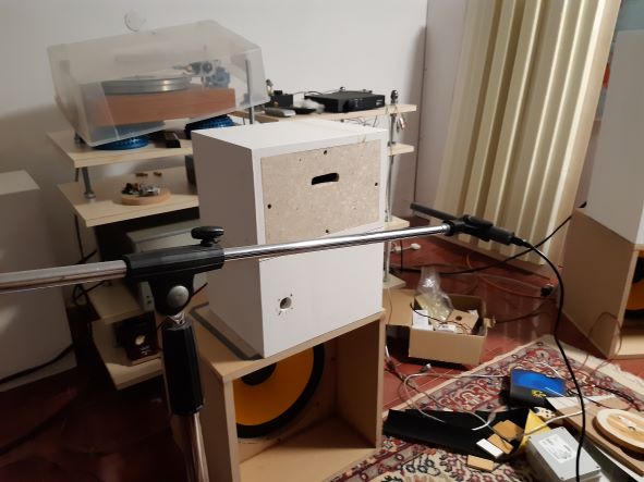

Hello,
sorry but I am very slow, and not having much expertise on speakers I am trying to understand what I am doing.
1. I have used foam between the tweeter and the horn, the shape needs to be done carefully (I can do better) but it works better than all the previous plastic vs foam pairings (highlighted)
2. I made a test box with 4 woofers placed on the vertices of the horn, the box has openings on the sides at the woofers of the same size as the front throat.
3. I measured the impedance and Qtc =0.61 Fs =86Hz I attach the impedance graph
4 I measured the on-axis response at 50cm and at 100cm (much depends on my room).
5. I then added 2 side wings of 8cm each side to see if the frequency response changed but I didn't see much difference

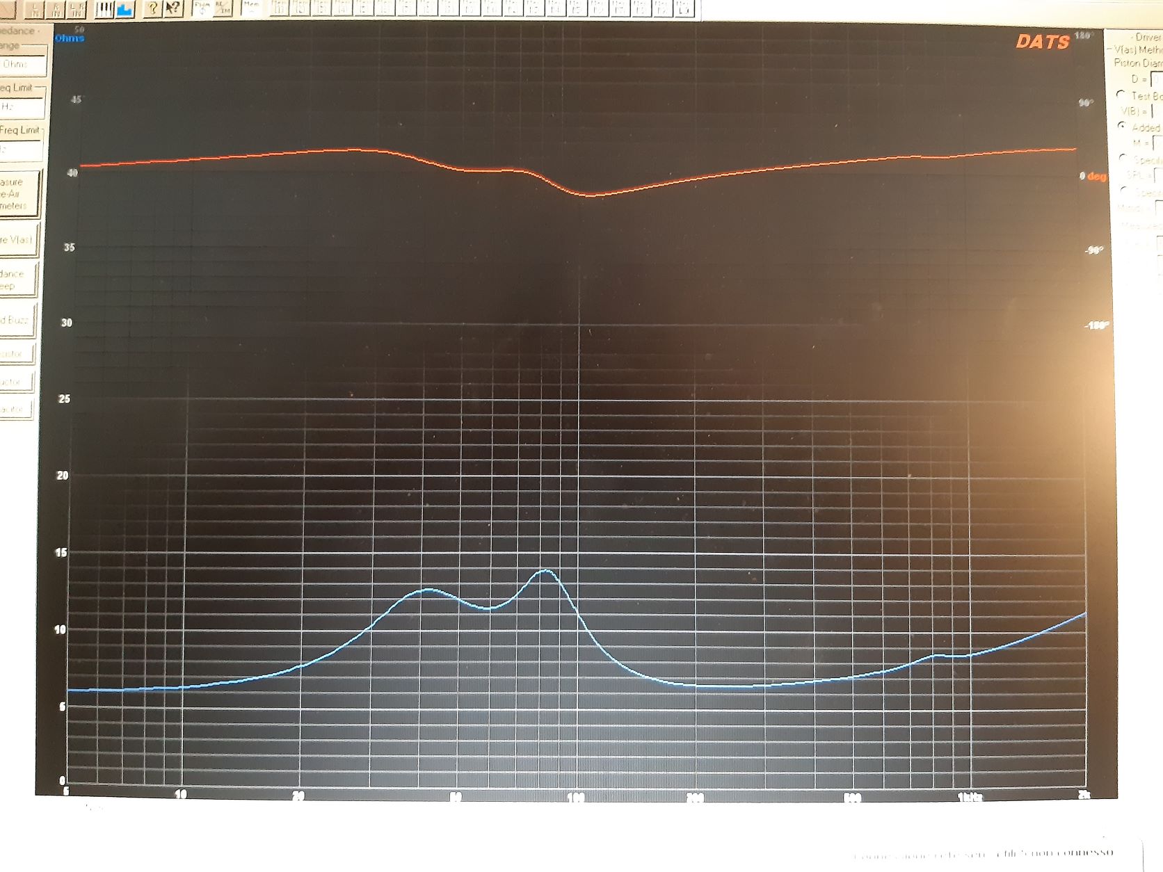

6. I closed the side holes and measured the impedance and Qtc =0.82 Fs =72Hz I attach the impedance graph in closed box
7.I measured the on-axis response at 50cm and at 100cm (much depends on my room.
8. I made comparisons between closed and open box measurements.
In your opinion, since I will then use a sub, is it better to use the closed or open box?
Can the openings on the sides help the control of low frequencies in the listening room?
Sorry about my poor English, I used DeepL.
Best regards
Guglielmo
