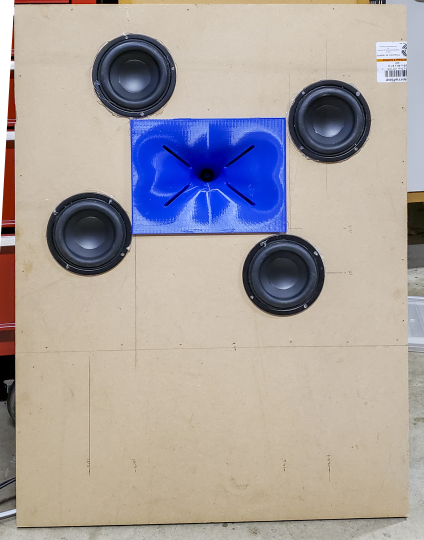

It's starting to look like a speaker now
This gives an idea of the size, compared to the Cosynes
I laser cut the trim rings for the midbasses. Basically the wood turns the foam into a constrained layer damping composite. I can upload the SVG file for the trim ring if anyone wants it.

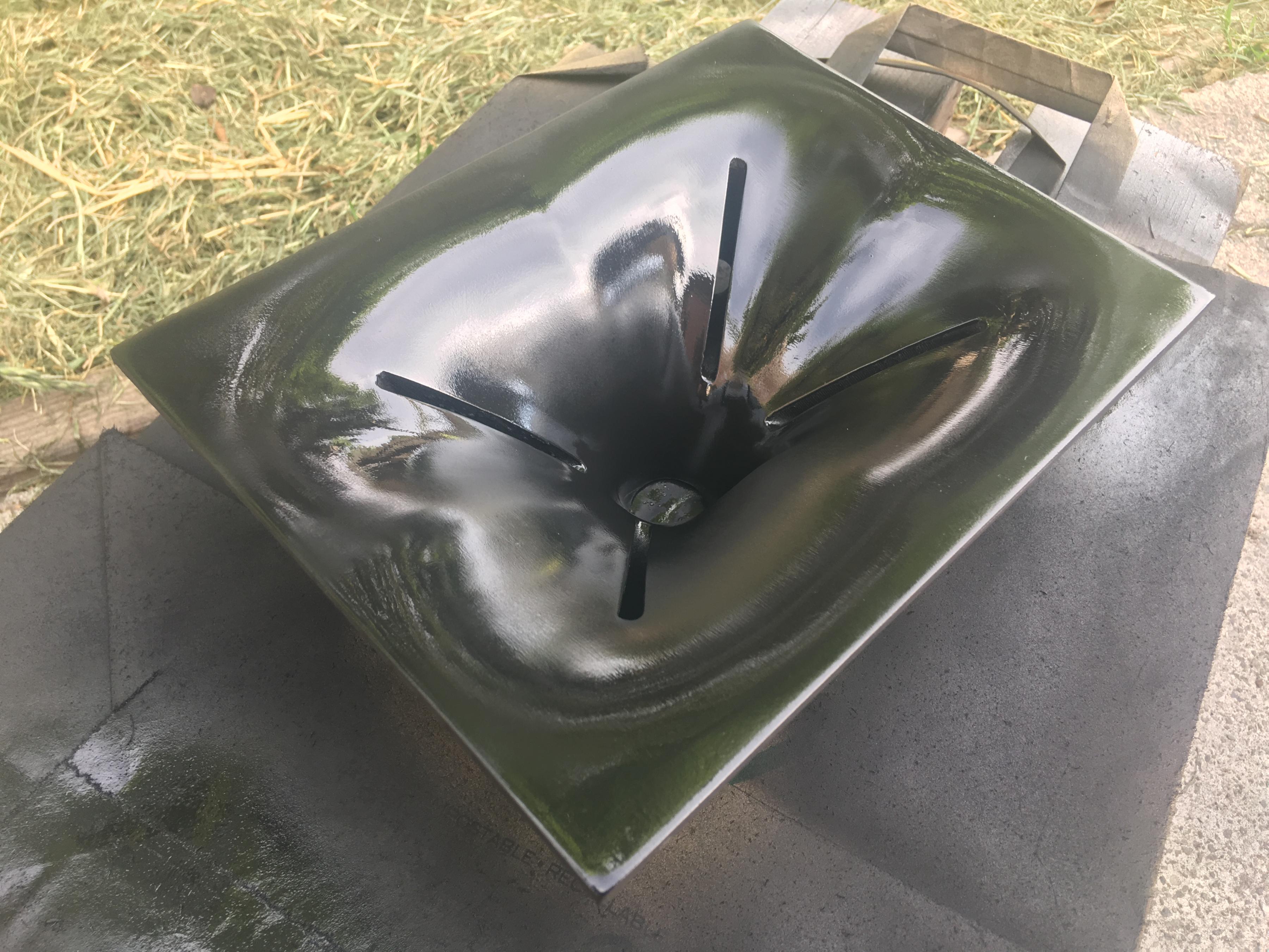

First coat of paint after priming. This is pretty damn close to the finish one gets from a DIYSG SEOS waveguide.

Thank you! In my opinion, folks are a little too eager to go straight to bondo and HVLP without considering what can be accomplished with a bit of woodfiller and a some patience but then again, who am I to keep people from their toys?

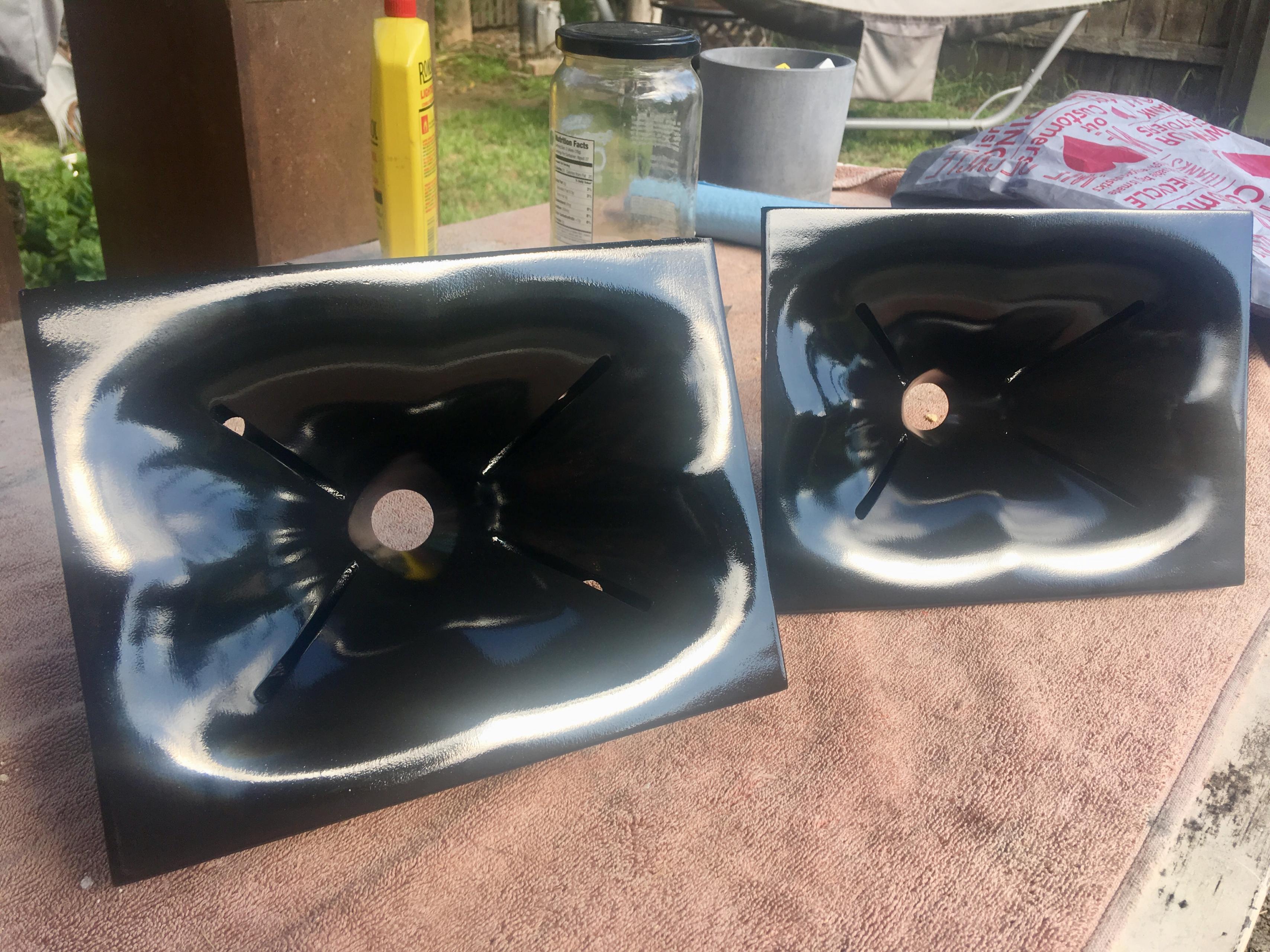

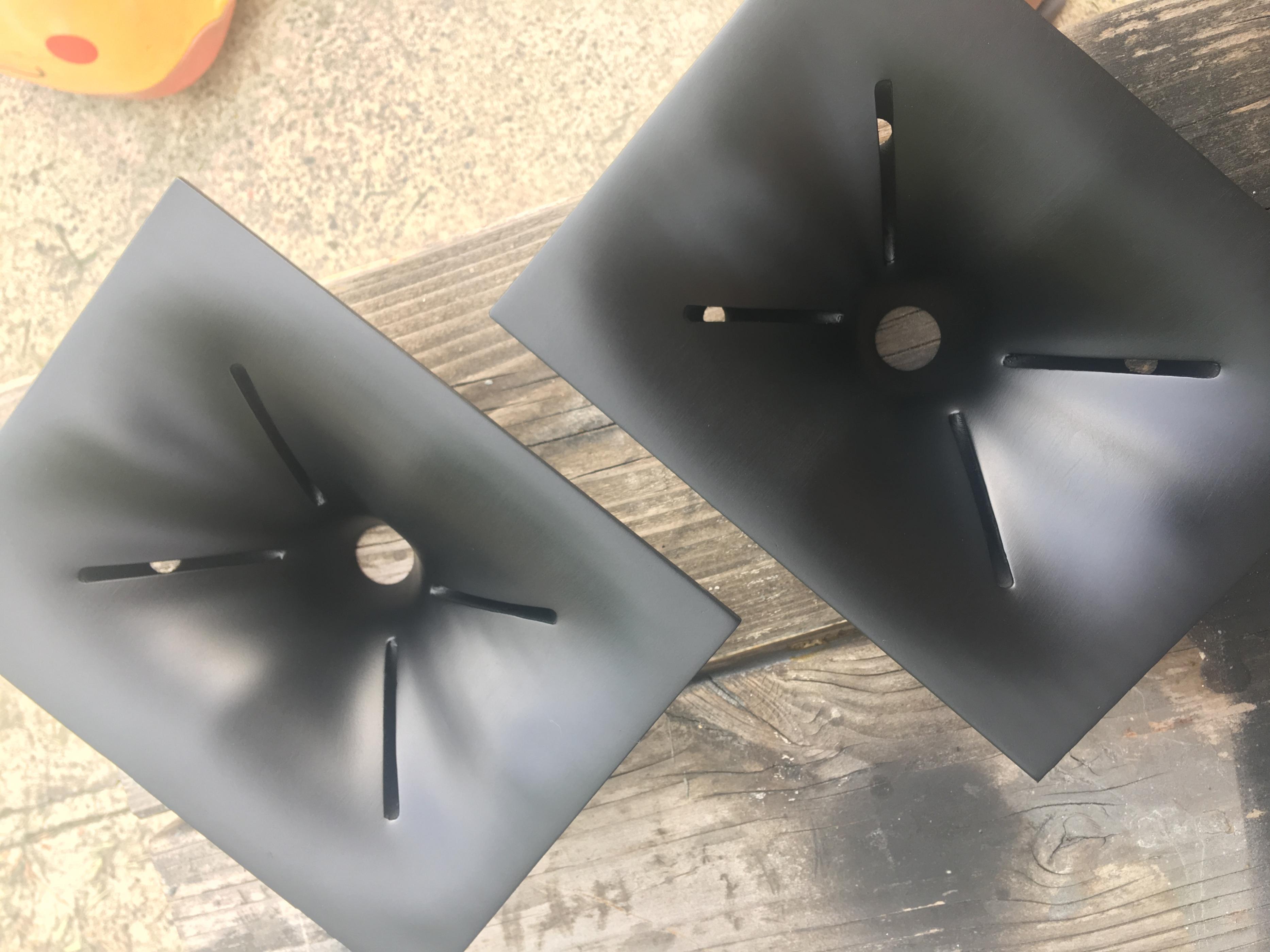

Okay, finished painting the waveguides. This is after several light coats of nitrocellulose lacquer but before I get around to wet sanding this to level out the gloss:

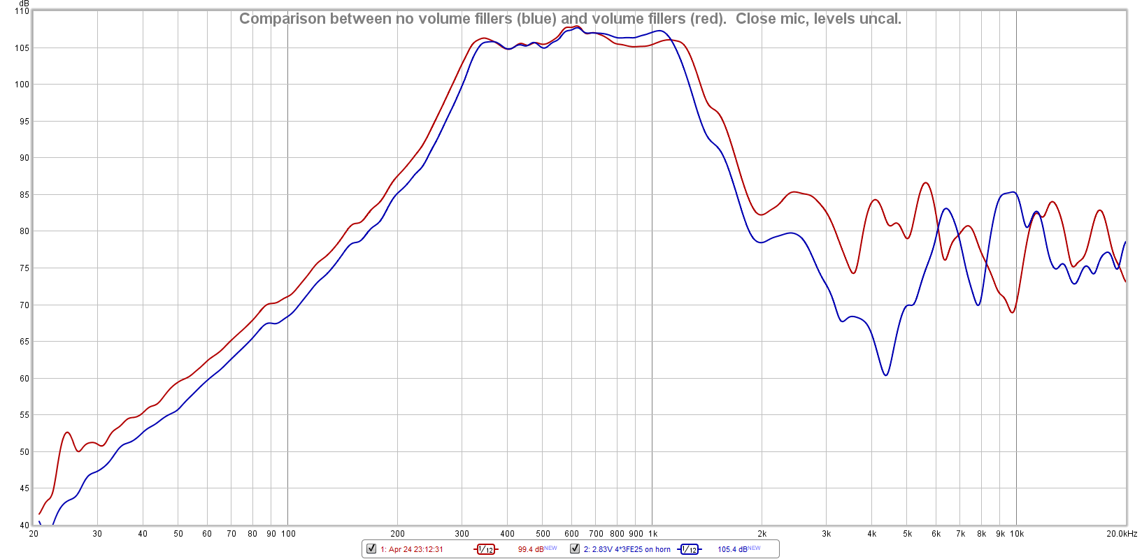

Here's why the polyester fiberfill is a very very important part of the speaker. The midranges in the speaker have a nice and well behaved rolloff... Until you hit 7khz. Above 7khz, these midranges really start to "sing" and that creates a whopper of a peak out-of-band. And that's *exactly* why @metzb1 is seeing a peak in his measurement. The polyfill needs to be there.
Note that the midrange crossover has literally zero components in series; the only thing that's taming that high frequency peak is the polyfill.
Now, the obvious solution to the peak would be an electrical or electronic lowpass filter. I personally found that an acoustic filter (the polyfill) worked much better. It didn't just tame the peak better, it also improved the response of the tweeter and it lowered distortion.
So it's a small piece of the design, and easy to overlook, but VERY important.
The reason that the polyfill works so well is because electronic and electrical crossovers don't reduce harmonic distortion. IE, if your midrange is playing a fundamental note at 2000Hz, there will be 2nd harmonic distortion at 4000Hz and 4th order at 8000Hz. The crossover can't reduce it, because it's a product of the woofer, not the original signal.
But the polyfill CAN reduce it, because the polyfill is an *acoustic* filter.
It's a neat little trick that can be used in Unity horns.
Here is the compact Unity waveguide WITHOUT polyfill
Here is the compact Unity waveguide WITH polyfill

cool idea on the polyfill I also have the same out of band peaks on my mids, they are 20dB below the in band response whereas yours are only 14dB above the peak in band response (I'm presuming the image you posted is before the fibre fill?). Do you have an after fibre fill response plot you can share? also have you any measurements at the horn mouth?
