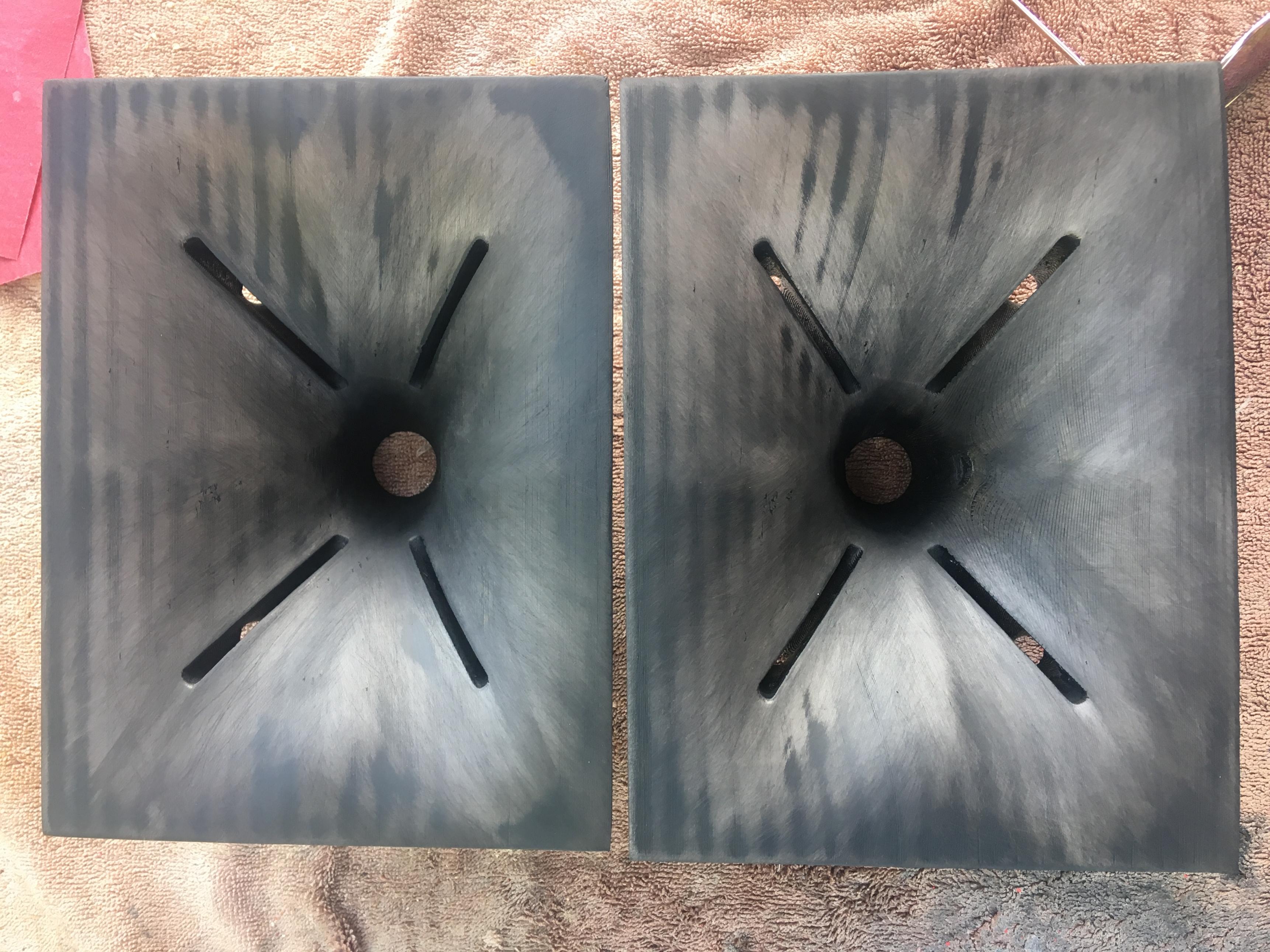

Here's a comparison of how the tiers look these days. Tier 3 on the left, Tier One on the right.
Here's a new filament that I like a lot. It's called "ABS+."
I like plain ol' ABS a lot, but it is by far the most difficult to work with. It warps badly and it cracks. The reason that I continue experimenting with ABS is that the surface looks really good, it is strong, and most importantly it doesn't jam. ABS has a tough time sticking to anything, which is why it cracks, but it also doesn't stick to the nozzle, which is really nice! I am so sick of PETG prints that jam.
The ABS+ seems to make a dramatic reduction in cracking and shrinking. It is noticeably heavier, so I'm guessing it's denser somehow?
The only bad thing about ABS+, from what I can see, is availability. For instance, this off-white ABS+ filament is unobtanium now.
One thing that's promising about this ABS+ print is that I think this might be one of my first prints that's (almost) exceeding the quality you get from injection molding. It's a REALLY nice print. Note how the top and bottom are almost perfectly flat, and how the surface is really well behaved.

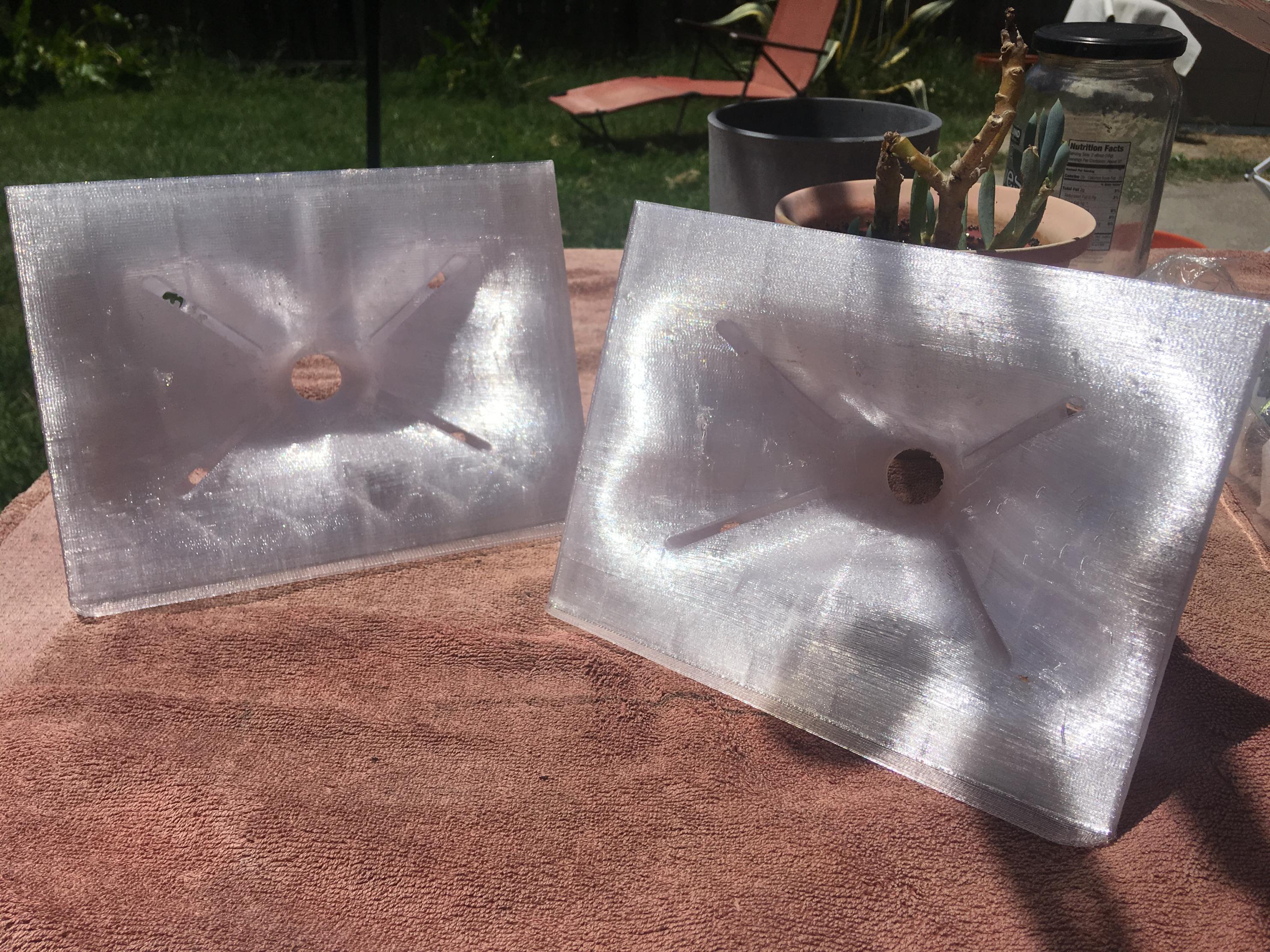

Here's a "Tier Three" PETG waveguide. I had to glue this one together because the print died when the print head gummed up, due to the stickness of PETG.
Excellent! That's my best PETG print. I have one running as we speak, in grey, we'll see how it turns out later today.

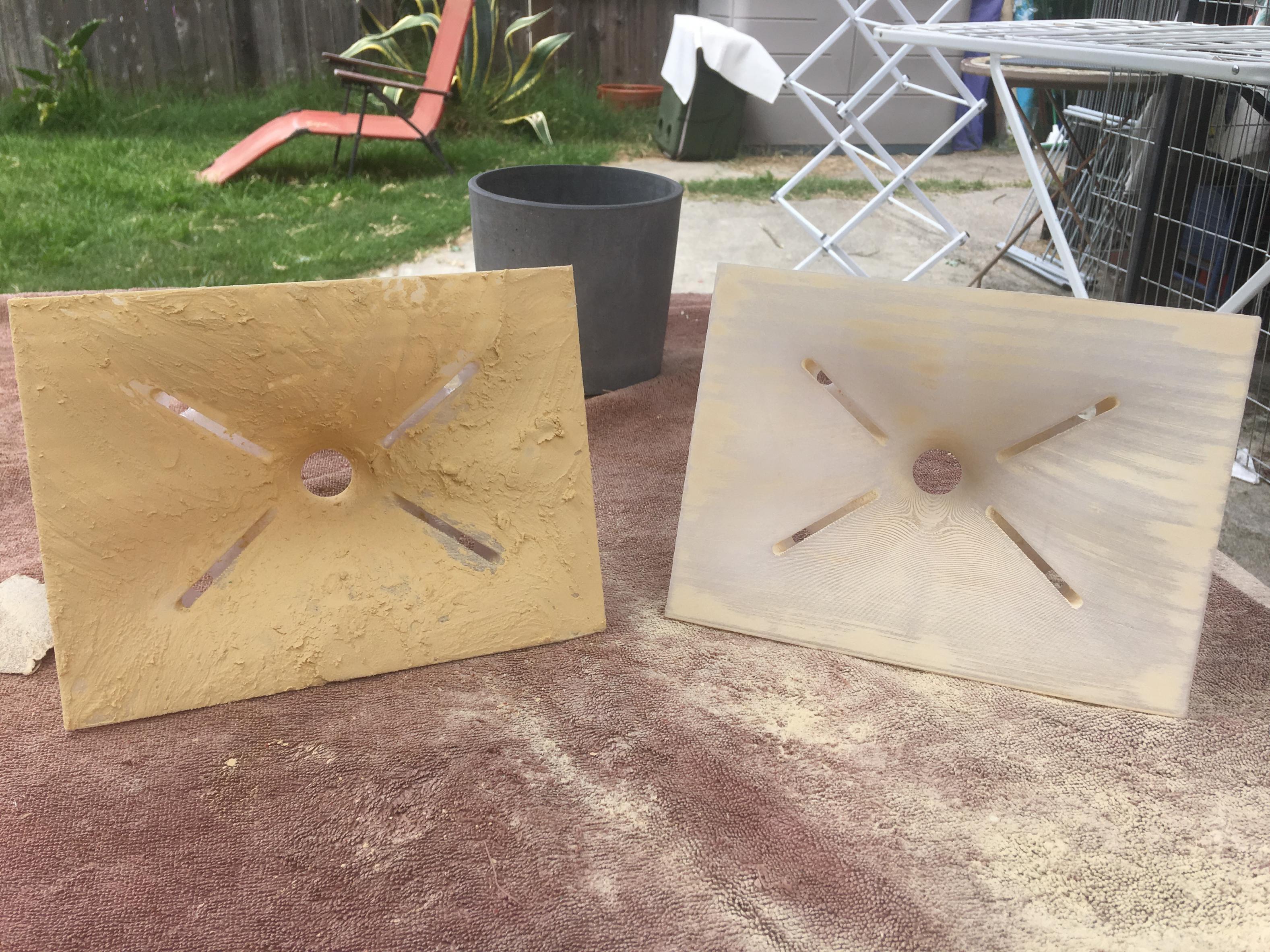

As I understand it, PETG isn't as easy to sand as ABS, but it *is* sandable. The pic above is from ESUN, showing a PETG print, then sanded, then painted.

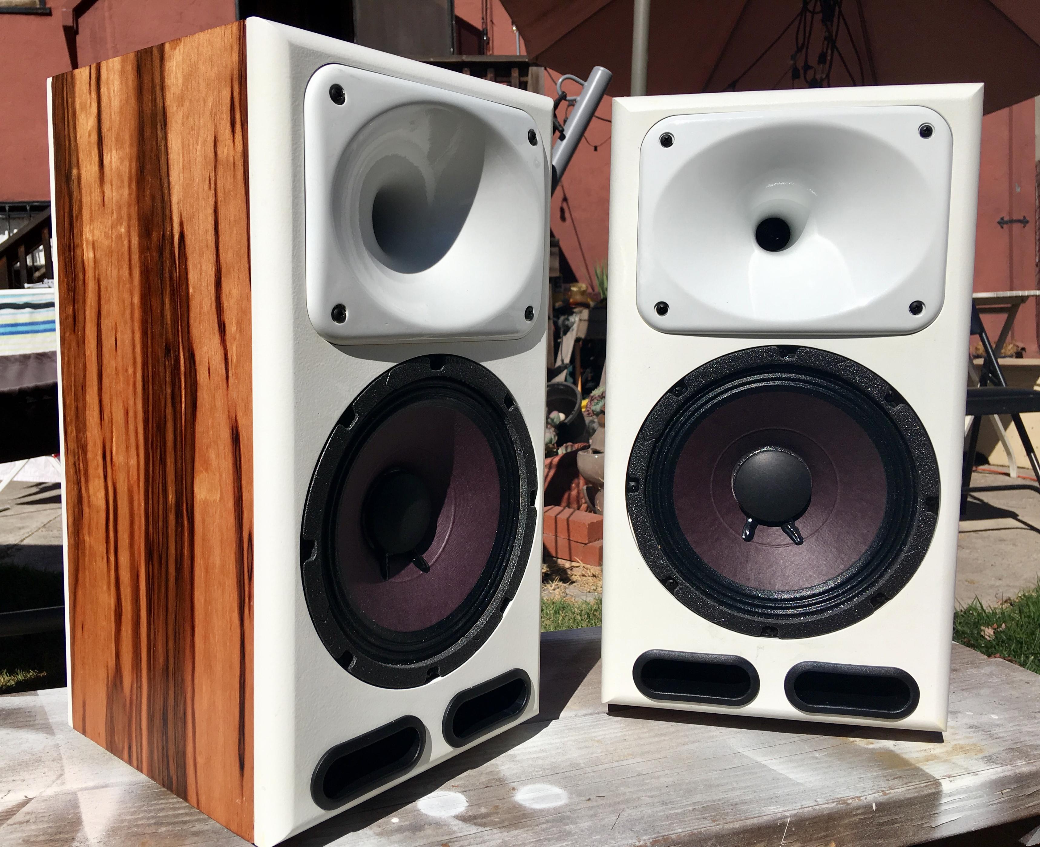

My Gedlee Summas were bright blue when I purchased them, and I painted them black. Pictured above. To get them black, I simply used black plastidip from Home Depot. I went this route because it can be peeled off if you don't like how it looks.
Here's how my Summas looked before I painted them.
As I understand it, the blue color of the Summas was actually vinyl paint! Which is kind of shocking, considering that it looks like an oil based paint.
Since your waveguides are plastic and the Summas are plastic*, painting them should be similar.
If you really wanted to go all-out, I think the ideal finish would be to sand them, cover them in bondo, sand that, and then go to an automotive supply store and purchase paint intended for automobiles. I used to do that for my car audio projects back in the day. It is a LOT of work, but it comes out looking about as good as an automotive finish.
If you want something quick and dirty, just spray paint them.
* My Summas had a carbon fiber skin which was bonded to a foam core using epoxy. Very much like surfboard construction.

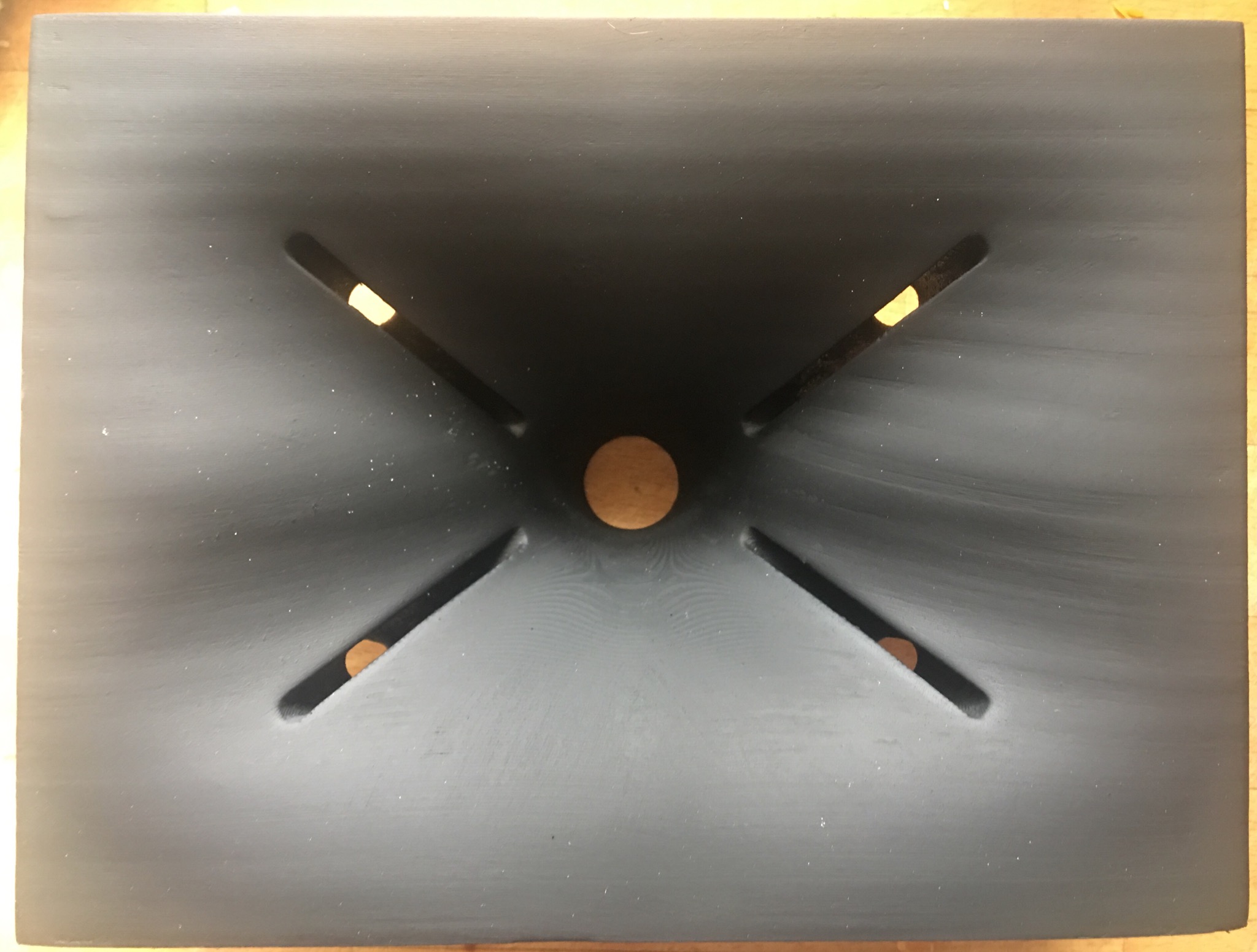

Progress
After giving the waveguides a couple quick passes with a propane torch, I deburred both with 80 grit sand paper. After rinsing them off, I covered both waveguide interiors with Elmer’s wood filler (I am familiar with it and like the sandability) and am in the process of removing the excess filler with 100 grit sandpaper.
I’m leaving around lunch to spend the holiday weekend in the mountains and do a little repair work at the in-laws cabin so I won’t get to priming and painting until next week.

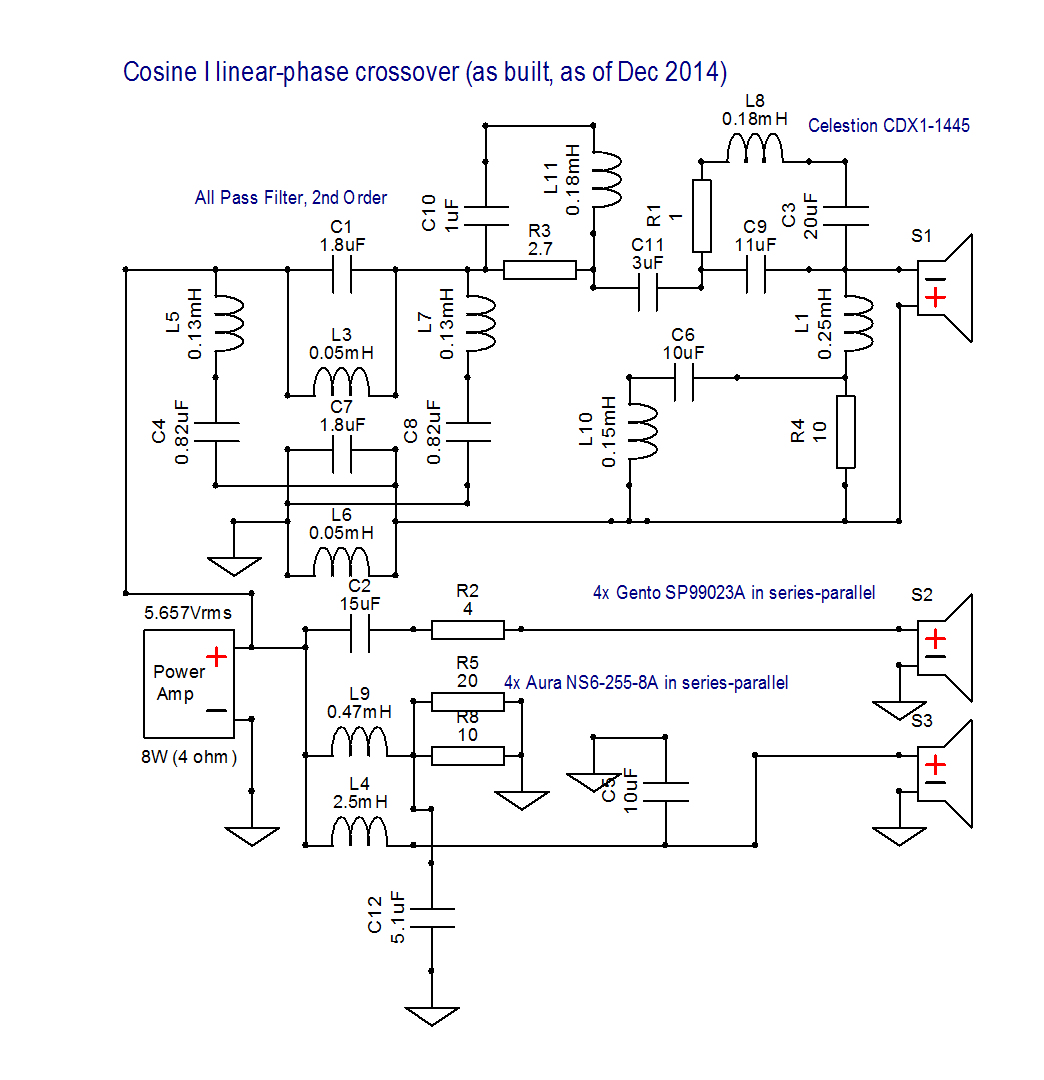

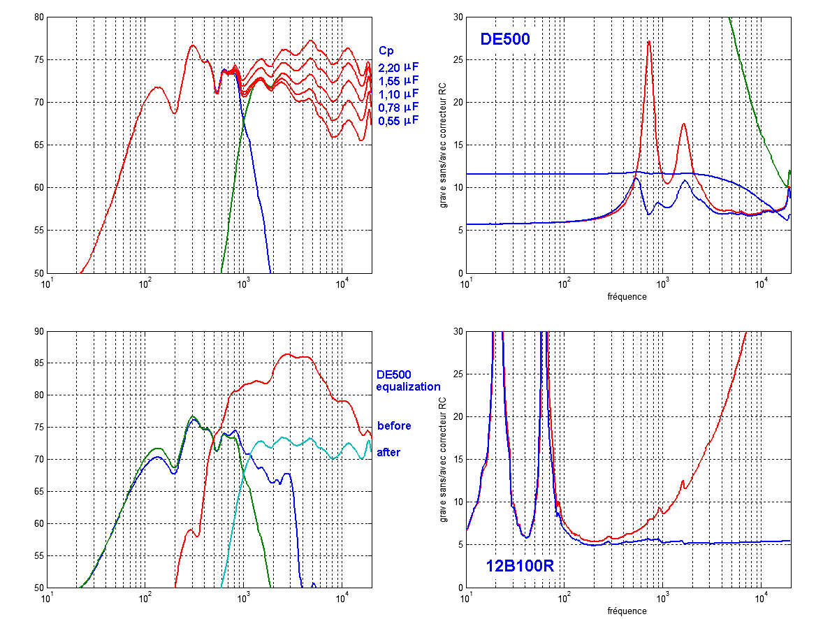

Hmmm, just ran into an unexpected problem.
In order to achieve these beautiful polars, I used the LeCleach crossover described here : Car Audio | DiyMobileAudio.com | Car Stereo Forum - View Single Post - Crossovers, a Step Further
The way that this crossover works is fairly straightforward. It uses third order Butterworth filters. A 3rd order filter introduces approximately 270 degrees of phase shift. (90 degrees for each order.)
So the LeCleach filter fixes the phase response with two steps:
1) it moves the midranges *closer* by a bit less than one quarter of a wavelength (90 degrees)
2) and then LeCleach flips the phase on the tweeter, to compensate for the other 180 degrees of phase shift.
So here's the dilemna:
When I add the 12" woofer into the mix, it needs to be quite a bit forward of the waveguide. About eight inches.
Now the obvious solutions would be to use DSP delay from the MiniDSP to simply put the two wavefronts into phase. A brute force approach.
But personally, I really like the nebulous depth of my Waslo Cosynes:
The Cosynes *also* place the woofers forward of the midranges, like LeCleach does. I have no idea what type of xover is in the Cosynes, but it's purely passive, so there must be some type of compensation for phase if it's producing a wavefront that's in-phase.
BTW, here is the current crossover:

Anyways, long story short, if I want to maintain good phase behavior below 1000Hz, I will likely need to do one of three things:
1) Bring the woofer forward of the waveguide by about 8". That would be ideal I think, it helps achieve that nebulous depth which is so neat about Unity horns.
2) Fix the phase via DSP. Boring but workable solution.
3) Use a shallower slope. For instance, I think that if I used a 2nd order filter I might be OK, and a 1st order filter would definitely be no problem.
That diagram is from this post from a few weeks ago:
Am I correct in that the 4 midrange drivers are wired in series-parallel to result in a nominal 8 ohm load to the amplifier?
PB -- for reference, this is the final crossover (or very nearly what it is anyway) for the Cosynes:
All that craziness on the tweeter is an all-pass filter to get to linear phase. DSP is a whole lot easier and more sensible, except that the "filters" are spread around in different components rather than just in a speaker.
L9, C12, R5, R8 are to level the impedance curve if used with a tube amp (I think there was a wire link in by the terminals that could be used to detach those parts).

Below is one of the waveguides from a page back after a sanding of 150 grit and a primer “tattletale” coat. This coat exposes how much my hands lie to me and tells me I need to go back to about 100 grit and do more smoothing. I might even try bondo, despite pain it will cause my shoulder to manually sand it off. My goal is a glossy black finish.

So starting over on the sanding didn’t have the intended result; restarting at 50 grit and continuing on with a 80 grit wet sanding followed by a 150 grit wet sanding still left unsatisfactory results after a primer coat. So I dry-sanded the primer coat back with 150 grit and wiped it down with naptha. It’s overall smoothness *has* improved but a fresh container of Elmer’s wood filler applied with a shop towel should fill in most of the remaining crevices. I’ll sand that back down with 150 grit, respray primer and decide from there whether to go back a step or smooth with 220 grit before topcoating with flat black.
- "Unitized" Image Control Waveguide
