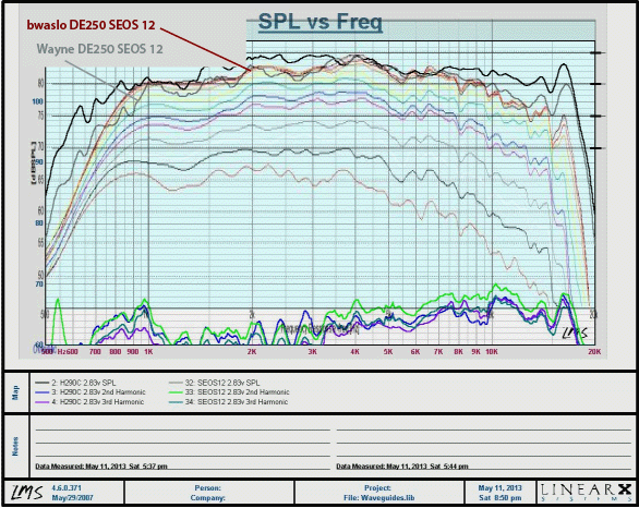

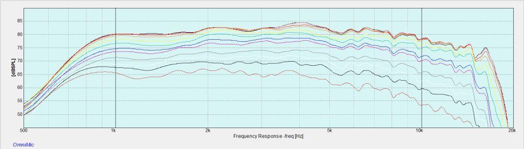

Here is the most commonly published SEOS12 chart, which I think was made by Bill Waslo:

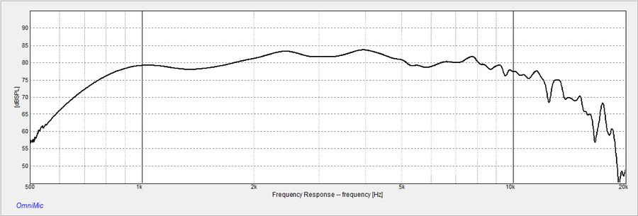

A chart made by Erich:
Another chart made by Bill Waslo:
This is the chart I made of an SEOS12 waveguide, mounted on a baffle, measured outdoors:
These all appear to reasonably agree. Of course, they were taken in different environments, under different conditions with different measurement systems and perhaps some using different compression drivers. But the general trend is evident.

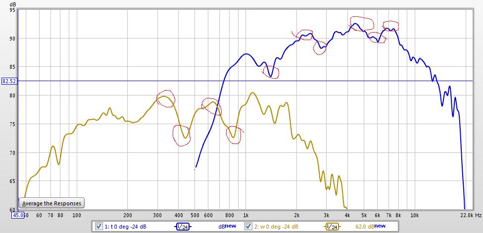

I think tuxedocivic objected to one of Bill's charts above, and also to the one below. Seems like he said the chart was inaccurate.
It is definitely scaled differently than most others.
(from this post: SEOS-12 / DNA-360 / JBL 2226(J) build)

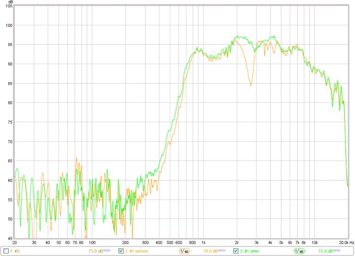

The same person made this chart, and posted it later in the same thread.
In this second chart, I can see the deep notch around 2.7kHz, which really IS anomalous for the SEOS12 device. But the green curve has the same basic signature as the blue curve in the link above. The green "fixed" curve looks quite similar to the blue curve above that tuxedocivic marked up with his red circles. To be quite honest, except for the scaling difference, it appears to be basically the same curve as all the others we've been discussing here.

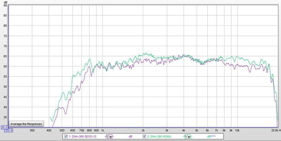

Here's the SEOS12 overlayed with the H290C, same compression driver, same 1M baffle, same measurement system, drive signal and 1M microphone distance. Measured outdoors.

I dunno guys. Except for scaling differences, these all seem to be in reasonable agreement to me. I think the trend is clear and we can be reasonably confident that we are seeing valid data for both the H290C and SEOS12 waveguides.

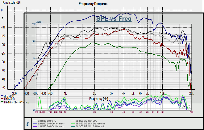

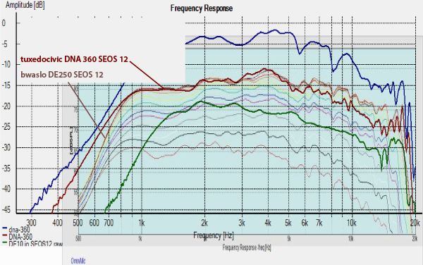

Here's another for your comparison
spaced for clarity. Red is the DNA-360 which is apparently very similar to the DE250. Green is the DNA-205 which is apparently very similar to the DE10. Blue is the DNA-350 which is big powerful tough and not as fine and I don't know what it's based off of. I managed to get it into shape, but those little 5.5 and 8.5khz didn't go away. Not audible, but if going for hifi, the 360 obviously performs better.
Looking at the red curve you can see the low end knee is beautiful. Combined with directivity down to 1200hz or even lower, this is one heck of a waveguide. The peak at 4khz gets knocked out quite easily with a single notch and stays consistent off axis, so go right ahead and eq it out.

Hey dump truck. Thanks for overlaying. The high frequency roll of I got there is quite likely the little Dayton t amp I've been using lately. I've heard it has a soft top end. And I've noticed a few of my measurements have a bit of top end roll off lately. I haven't had a chance to look at it closely, but that is more pronounced than I've noticed, so who knows.
Sorry if I come across as bickering. It's the Brad Measurement that I've asked Wayne to stop using over and over because its wrong. I wanted to show that measurement to be false. Brad had a suspect CD and was inexperienced. The results were not reliable. I feel responsible for these measurements cause I was helping Brad at the time. Wayne is aware they shouldn't be used but I keep getting it thrown in my face. So, there's my measurement for him to use. I just did it quick tonight, when I find more time to put it on my measurement amp, I can share it with him if he cares.
Thanks again for the comparison.
How do you do that dump truck? I wonder how mine would compare to Bill's measurement. My eyeball comparison doesn't show such a high roll off. I was also using the DNA-360, I wonder if it has more roll off than the 250, but I wouldn't know.

There was a different chart that showed a deep notch that Brad corrected - the one plotted in yellow. That much I can see in the yellow line in one of Brad's charts. And the 2226J response was modified by internal standing waves in the cabinet, or at least we can infer that from the fact that Brad said the addition of damping material reduced the peaks in the woofer range:

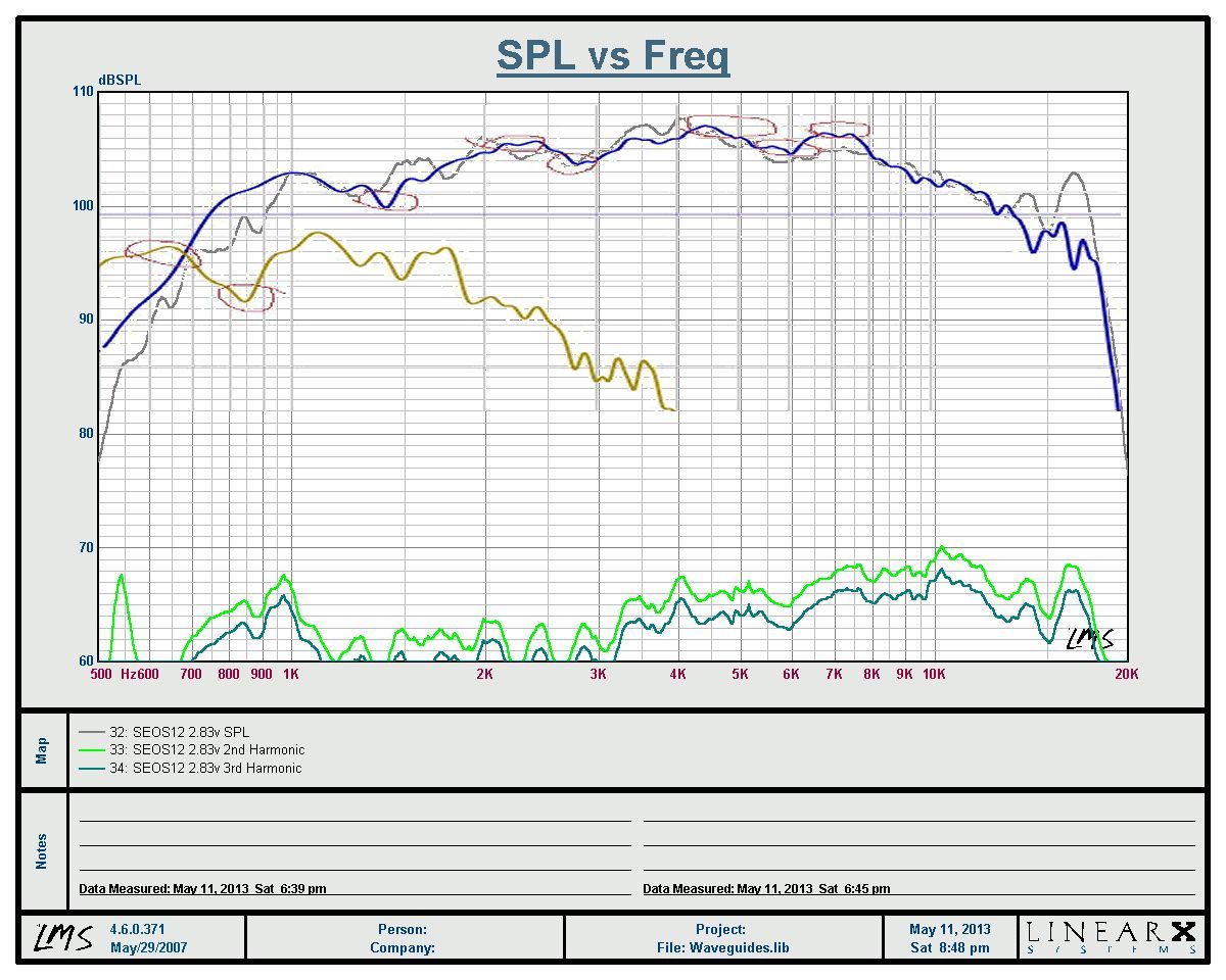

But as for the waveguide charts shown above, they all appear to match pretty well, seems to me. The insulation in the cabinet wouldn't affect waveguide response.

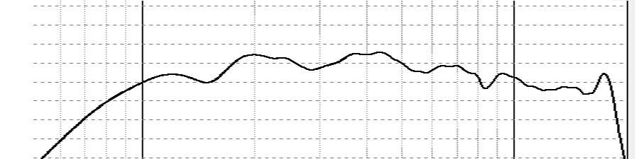

Here is a crude overlay, stretched to approximate the same scale as the SEOS measurement I made:

I ask you to not use that measurement. You agree to not while justifying it. I say thank you for not. Then you continue to use it.
I'm aware of scale. I'm aware of standing waves in boxes. In your pm you said it may have been the nearfield technique. Brad didnt use nearfield.
I don't care if its close to your measurement. I still believe it is not reliable. Stop using it please.
Illustrator and Photoshop. It only takes a moment to do it quick & dirty like this, but then I do work with this software all day for a living. Here's those two, and another two:
