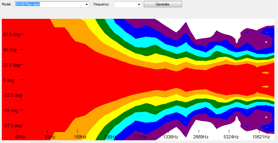

As Bill mentioned, the Synergy horn design is a way to avoid all the interactions from multiple sources. It is a way to drive a horn and radiate ‘as if” there was only one impossible broadband driver even though there may be a large number. One common thing to all of them is that you can walk up and even put your head into the horn and you never hear any more than one sound source floating in front of you.
While for commercial sound the products at work must have a full 3d radiation model (data taken by an independent lab, every 5 degrees over a full sphere in a reflection free area) the format doesn’t plot out the spectrogram style map popular in hifi.
I did ask Sebastian our software guy to take the CLF data and plot a Horizontal map for an SH-50, one of our oldest Synergy horns (I use them at home, a 7 driver, 3 way horn system). Larger than a hifi speaker with pattern control to a lower frequency as a result.
Note this is a full bandwidth plot, 3dB per color, front 180 degrees, extracted from the CLF data, the left frequency boundary is 30Hz not 200Hz.
Wayne, I hope you weren’t too close to the tornadoes, my heart goes out to those who lost and were harmed.
Tom
