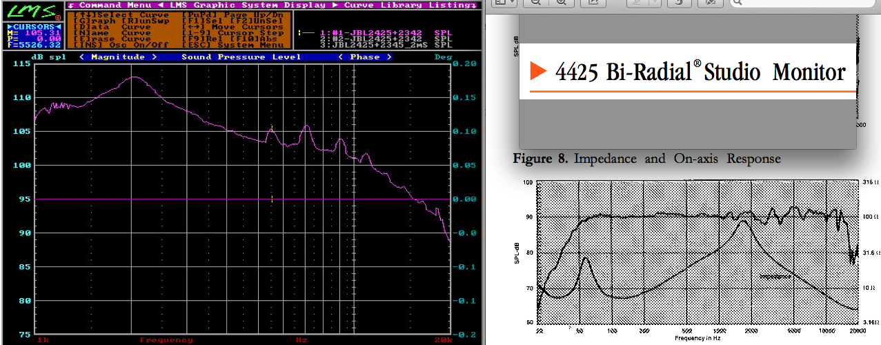

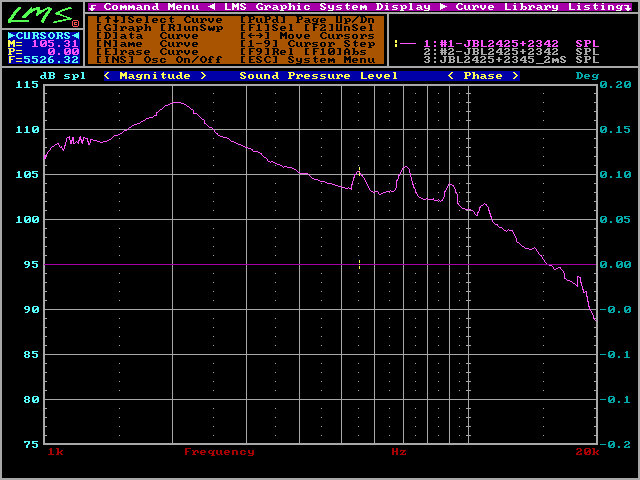

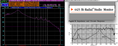

Hello Wayne
Below is a LMS sweep of my JBL2342 Bi-Radial Horn with a JBL2425. Plot is raw, no smoothing applied. No crossover.
Are those peaks from 5.5kHz upwards the ripples/internal reflections you're referring to?
About the JBL horn, I don't recall the HF peaks being that strong, but they could be, I suppose. Look for corresponding blips in the impedance curve. Discontinuities will show up there, as will standing wave modes (down low) and diaphragm breakup (up high).

Your sweep looks like the ripple is less than JBL's measurement (the 4425 monitor uses the 2342) with crossover, about 3 dB peaks compared to +/- 3 dB.Below is a LMS sweep of my JBL2342 Bi-Radial Horn with a JBL2425. Plot is raw, no smoothing applied. No crossover.

Yes, you're probably right. I used the JBL 2370 for a while, a couple decades ago. So I'm more familar with it. It had 3-5dB ripple from various causes, both lower and higher modes.
Higher modes at 5kHz, 6.5kHz and 8kHz appear in the impedance curve as well as in the response curve. They show up as little blips in the impedance curve that match the ripple in the response curve - A dead giveaway that it is the result of a discontinuity, the diffraction slot in the throat.
The lower modes are around 500Hz and 1kHz, with a third appearing around 2.2kHz. Those are mouth reflections, typical standing wave modes that all horns have down low to some degree or another.
And of course, there's usually a little blip or two way up high, above 10kHz. That's diaphragm breakup.
