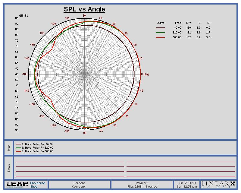

We all know at low frequencies the radiation pattern for a system is for all intent and purposes onmidirectional, here is a 12" driver plotted in free space as an example from 80-500hz.
I don't see any advantage over a conventional box system as far as control of room modes. There is no directivity control below the Schroeder frequency like in any other system. You are still going to have to address room modes from corner placement like any other system.
