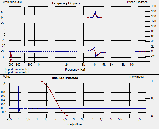

Here is my take on it: I generated using rephase the impulse of a minimum-phase constant Q +6dB PEQ at 4kHz, Q=40.
There are of course no reflexion in this impulse and it can be compared to a purely anechoic measurement.
Loaded into HOLM, blue is raw, red is gated at 500Hz (3 octaves lower).
I also did the same test with zeroing "by hand" and obtain similar results.

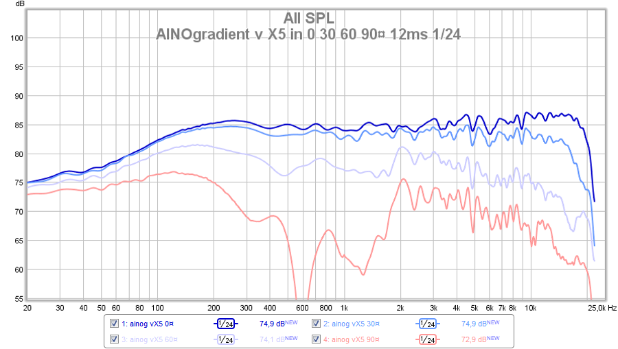

I am poor at mathematics, and I use mainly REW. However with it I can easily play with different gating and gate type. So, I am not concerned about FFT mathematics, but the end result.
There was discussion about loosing resolution with high Fq with long gate. I can't see this, only the effect of various reflections and room modes.
With a 12ms gating you are down to a 83Hz resolution (1/0.012), but on the other hand you are also using 1/24 octave smoothing on both of your measurements, which gives a factor of 1.029 between two points (2^(1/24)).
With this smoothing you have a maximum 2.9Hz resolution at 100Hz, 29Hz at 1kHz, and 290Hz at 10kHz...
83Hz resolution is obtained at approx 2844Hz
( 1/0.012 / (2^(1/24) -1) )
So the fact that no difference is apparent in the HF is simply due to your octave smoothing giving a lower resolution than the 12ms gating above ~2844Hz.
You can clearly see that with a Q of 40 the impulse is still ringing out beyond the gate. This is truncation and the cause of your "smoothing".
