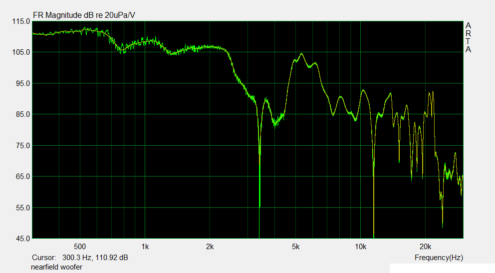

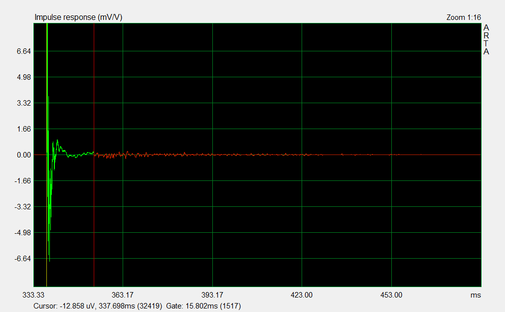

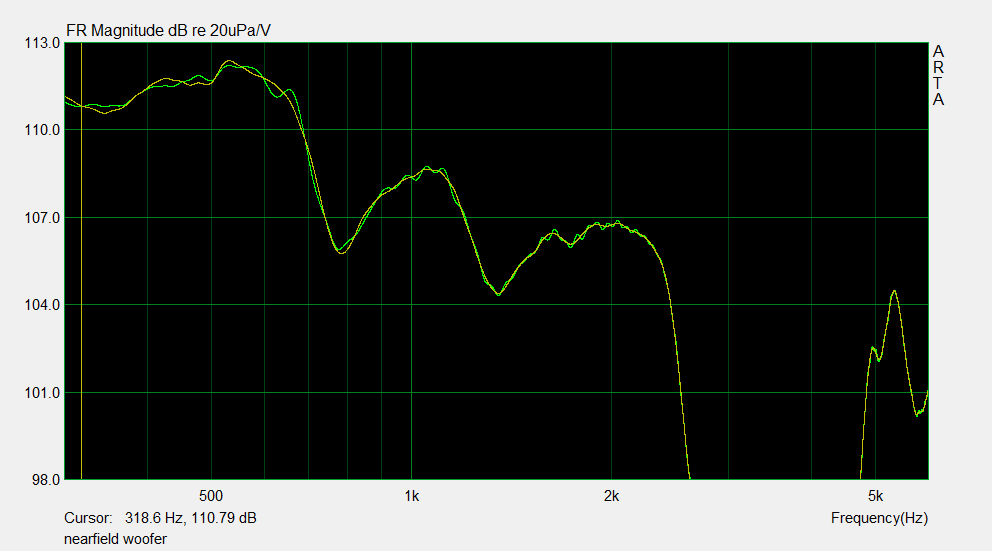

How about all you smart guys explain an example? 😉 Here is a nearfield measurement I just took. One graph compares response for windows of about 6.8ms and 15.5ms. The other compares to maximum window (344 ms) in a larger range.
Yes, nearfield data is to a large degree free of room effects. The problem is that the near field response changes significantly with distance hence the near field data doesn't represent a speaker's real behavior.

Then I don't understand what you're trying to show with those graphs.
I wasn't trying to show anything, I was just trying to provide something to talk about, so that someone could say "but if you do this, then you will see ____", and then I could do that, and we could see. Apparently my interface will only let me do 44.1, 48, and 96, though, so I can't sample at 16k or anything.
