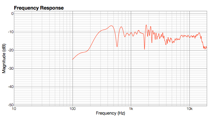

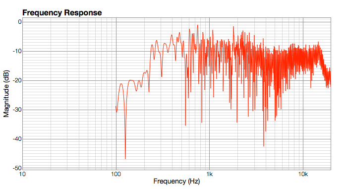

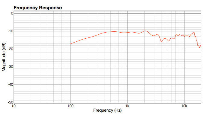

Well windowing is just like smoothing - how much depends on the gate length...
No its not. There is no smoothing with a window above its "cutoff" frequency. Below there is, but that's at 200 Hz in my data.
Earl is right on that one, why would a simple windowing function smooth a response curve? It only makes it possible to remove the room response from the analysis.
5ms, 10ms, 50ms window - same measurement:

Markus - it would be helpful if you explained your plots above. Isn't the difference between them just how many reflections are included? Taking those out isn't smoothing in the sense being talked about here though is it? If your point though is that we listen to speakers in real rooms with a response like the third, then it must be right that one should remember that - but how does it move this debate on? I.e., what do we do about the response in the third graph? It's certainly interesting!
Yes and no. The longer the window, the more reflections are included. The shorter the window, the coarser the frequency resolution becomes. But, more important is the question how we relate measurements to perception.
