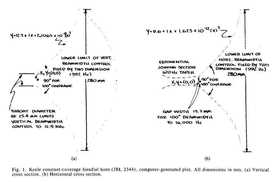

The departure angle in the 2360 (that is, the angle of the "cheeks" relative to the diffraction slot) seems milder in the 2360 than in the 2344- is that the case? I'd think this would help mitigate the harshness from the diffraction slot. When I heard 4430s, I noticed some glare/harshness, particularly at high levels, though I don't know if that's from trying to get 20k out of the titanium 2425h, or from the slot. I'm assuming a bit of both.
The current array horn is pretty much just a variant on the same theme, though it does away with the scale of the "cheeks" and the angle is fairly shallow. Why they don't bother to terminate it properly in the horizontal (the arrays use the horn rotated 90 degrees from typical 90x40 horn installs) is beyond me.
The departure angle from the diffraction slot is always the desired angle for the horizontal beamwidth. (Actually it is a hair less) The 2344 with a 100 degree horizontal beamwidth is 90 degrees between those surfaces. 2360 would be 80 degrees or so to hit the target 90 degrees.
I can't comment on the cause of 4430 glare/hardness. It isn't a perfect system but I wouldn't conclude it had to be the diffraction slot. Could be incompetant network design.😛
Their current trend is to forego the diffraction slot and simply do a blend of fairly straight side walls and end flaring. As mentioned a few posts back, this will give less perfect polars but better frequency response. They are quite far from classic exponential so I would like to see some raw horn curves to see what the low end looks like.

Is it? I wasn't clear on this- the "cheeks" being curved the way they are I assumed the nominal coverage angle was somewhere a little past the slot. I guess the throats are long enough for the first little bit of the post-slot flare defines coverage down to XO freq, with the rest of the flare just keeping the stopband smooth.
As I recall, you were one of the designers of the 4430- was the network your contribution? Certainly they're not "bad" by any stretch, but relative to my own waveguides, that are an OS approximation and used, at that time, 2426h, there was definitely some additional harshness. Now, I couldn't have gotten the top octave at 97dB in a constant directivity horn anyway, with the 2426h, it had to be rolled off in the context of my system design which, at the time, was using JBL 2226h and the 2426h with a passive filter (and no B.S.C). With the lower sensitivity required to match the 2235h, the 4430 could try to get that top octave out and that may be what I was picking up on.
I would love to try loading some of the "buttcheek" horns with foam a la geddes, just from the phase plug to slightly past the diffraction slot. I suspect that the parallel surfaces in the throat have HOMs that would be significantly attenuated by this (as well as any axial/semi-axial standing waves)
The horizontal and vertical cross sections are identical, especially on the 100 x 100 horns. They start as straight sides and then flare away following a simple equation found to give good polars near cut off. Remember the vertical cross section expands from the throat entrance while the horizontal cross section begins at the diffraction slot.
