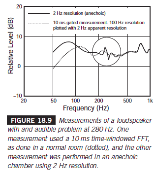

You guys agree that the FFT is periodic over 200 Hz if it's a 5 ms gate right? Regardless of what the impulse looks like, you are not going to capture a high Q resonance at 300 Hz with a 5 ms gate. If you pad it with zeros it's going to look smooth.
I think the assumption you are making is that there is nothing abnormal between 200 Hz and 400 Hz or 2000 Hz and 2200 Hz and so we can pad it with zeros. The impulse tail after the gate has nothing to do with it.
The bottom line is that one needs to insure that there is enough decay of the impulse response such that the window does not adversely affect the data.
Exactly my point.
This is not that hard to do, but one does have to be careful.
And how can you be careful if measurements aren't anechoic and one has to guess which effect is caused by the room and which one by the speaker?
Here's the example from Toole (Sound reproduction, page 382):
attachment.php
Another example would be the spider resonance in one of your speakers that doesn't show up in your graphs.
Floyds example is exactly the issue that I was talking about where the impulse response does not decay sufficiently to allow. This is not a common occurrence but can occur.

"By limiting the time window of a measurement, you also limit its frequency resolution. The relationship is a simple one: if you apply a time window of 6 milliseconds (0.006s—not unusual for measurements conducted in a typical domestic room), then the frequency resolution of the measurement will be limited to 1/0.006 = 167Hz.
This does not mean, as is sometimes inferred, that the measurement becomes unreliable below 167Hz—the problems begin much higher in frequency than that. What it does mean is that the frequency range is divided up into slices 167Hz wide, and any features of the loudspeaker's response that occur within one slice will be agglomerated in the measurement. That's of little consequence at a frequency of, say, 10kHz. But below 1kHz, this resolution amounts to a mere six frequency slices—obviously not enough to reveal useful detail."

Marcus - I do not accept Howard's explanation here either. There "can be" an effect of a window, I've said that all along and Toole and Howard show the worst cases, but this is due to truncation and not a lower resolution as stated. It is simply NOT that simple. If the impulse has sufficiently decayed within the window then the resolution IS that of the data set. What is being missed here is the physical guarantee that the impulse response MUST decay to zero and NOT grow again (beyond a few ms. ) So there is no danger of truncating the impulse at an apparent low and then it rises up again - that's not possible. Any effect like that would be due o multipath, which is why we window in the first place.
After reading all of this I do see a need to show the impulse response to those who doubt everything (MARKUS!) because the truncation errors that everyone is showing would then be obvious. But if the impulse has decayed to zero and then a window is applied, there is no error and the resolution IS that of the data set.
Yes but it is never the case.
The higher the Q of an EQ (or any amplitude alteration) the longer the ringing, but even a low Q alteration does have an infinite ringing that will be truncated by any gating. This is what FIR is all about: how long is long enough for the task at hand (resolution).
