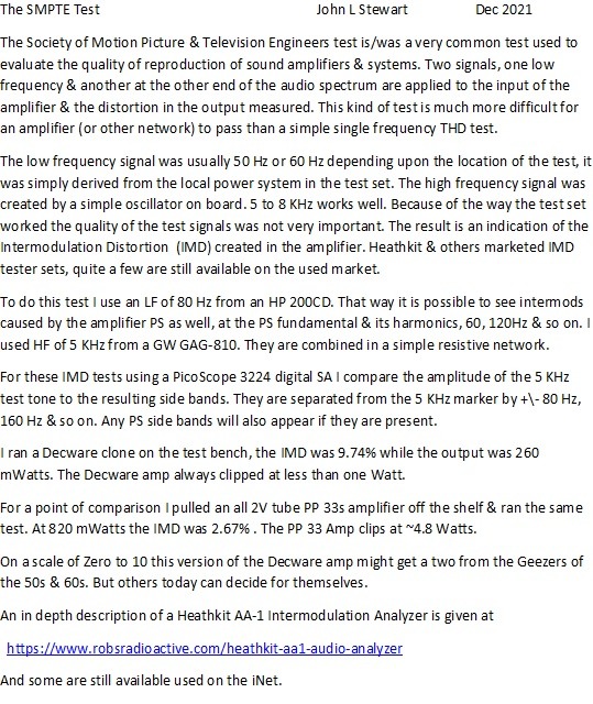

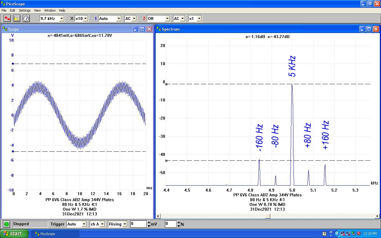

NTL, here is a typical test done by the SMPTE standard, along with a description of how the test is done for those unfamiliar. In this report the test was done by using a Pico Technology 3224 with 12-bit resolution. So the dynamic range is 72 db, sufficient for most ordinary audio testing. The LF at 80 Hz is 12 db higher than the 5 KHz test tone but not visible on this trace.
Since the LF I used was 80 Hz any PS ripple would appear as side bands on the trace, something measurable by this method but not possible with the HK & other low cost IMD testers of the past. The HK could not separate a PS problem from ordinary IMD at 50 / 60 Hz Etc.

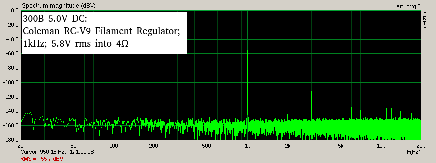

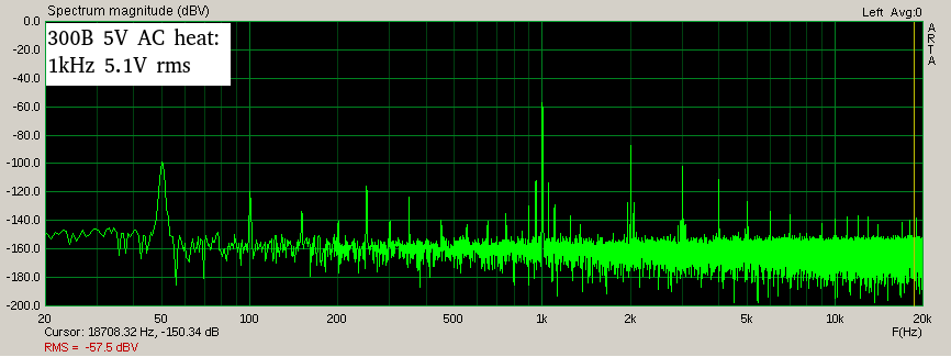

Alright, Ian, you shall have it! Happy to publish what I have on the effect of AC-heat vs. DC heat, implemented ith my regulators.
To address your previous criticism, I took fresh measurements to use the same amplifier, same EML 300B DHTs - with no changes other than the filament supply:
- AC heat, with 2x 33Ω resistors forming the usual centre-tap; Toroidal 30VA PT, mounted >1m from the amplifier, and away from any other PTs or chokes.
- DC heat, same amplifier, same EML 300B valves heated with the latest RC-V9 regulator.
The marker in the DC spectrum shows no spur at 950Hz above a noise floor 110dB down from the 1kHz signal 50Hz mains supply).
Intermodulation at mains frequency (50 Hz) is -50dB, whereas intermodulation at double the mains frequency (100 Hz) is -65 dB. Shouldn't it be the other way around? Dominant 1x mains frequency intermodulation is consistent with circuit picking up hum from AC filament supply, which intermodulates with the 1000 Hz signal.
The same thing appears in my own measurements. Locating the transformer far from the amplifier (>1m) made no notable difference. If it is a case of general pickup, I see no reason why the DC solution would not be susceptible too, since that would be a common-mode effect.
OTOH, coupling from the AC-heating current in the filament directly into the grid would explain it perfectly. I believe @6A3sUMMER mentioned this earlier.
My EML have high quality build compared to many other 300Bs; but I could try Western Electric 300B as an alternative, if I get a moment.
I have measured AC vs DC (my RC-V9 regulator) in the same amplifier, using the same tools, at the same time.
The AC-heated measurement is close to Bela's (Euro21) spectrum, especially given the differences in the amplifiers.

Rod - now this is the right way to do the comparison: AC vs. DC heating the only variable. As you interpret your data, the source of intermodulation is AC across the filament leaking into amplifiers input. Does it mean that the theory of 2x mains frequency IM is wrong? Would be easy to test - feed filament with clean filtered AC and see what happens with spurs at mains multiples.

When I look at Rod's spectral display, even my old eyes see multiple sidebands on both the 1kHz tone (-100, -50, +50, + 100Hz),
and the 2kHz tone (-100, -50, +50, + 100Hz).
Even the sidebands around the 3kHz tone looks pretty dense to me.
Some Power Mains IM is at 1X and some Power Mains IM is at 2X.
Note: On the 2kHz tone, the 100Hz sidebands are stronger than the 50Hz sidebands.
Just saying

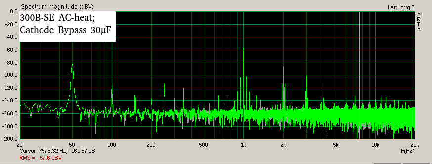

The only other measurement I could get to alter the spectrum was by decreasing the value of the cathode bypass capacitor all the way down to 30µF (was 270µF). This caused the 50Hz spur and the 50Hz sidebands to increase, while the 100Hz and its sidebands were largely unchanged.

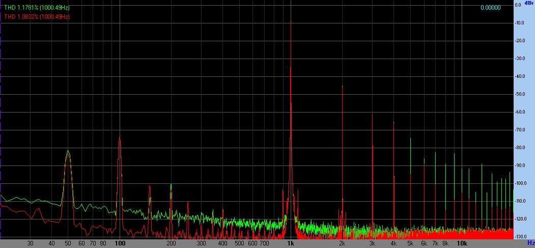

The sidebands also visible, if the filament DC not enough clean.
This sample is the 300B SE (6W, 8R). Filament heating is DC, but only use graetz and 2x10000uF smoothing capacitor.
The output tubes EH300B, but the "green" is the standard, the "red" is gold grid.

Simple straight-forward orientation. Thanks for posting it.
PS. In the test description where it says , "combined in a simple resistive network" , is that a Wye summing network ? (For example as described by Rane here?)
Ranes solutions are all relatively low impedance, less than 1K.
With SGs, care needs to be taken that one SG does not cause the other to become unstable.
In my case, both SGs are nominally 600 Ohms. So the resistive network is a couple of 10K resisters in a 'Y'.
One SG, the HP 200CD is capable of a much larger output voltage than the other SS SG.
The HP SG provides the 80 Hz at 12 db higher than the SS SG at 5 KHz. 👍
