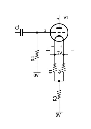

Think of Barkhausen's curves when the filament is operated on DC.
There is no change over time.
Now, think real hard about Barkhausen's curves when the filament is operated on AC.
That is a dynamic situation, constantly changing over time, according to the AC waveform.
Doubt that? Then look at this . . .
Part of the time, the voltage differential along the filament is Zero Volts (0, 180, 360 degrees)
Part of the time, the voltage differential along the filament is at 1/2 of Peak Volts (30, 150, 210, 330 degrees)
Part of the time, the voltage differential along the filament is Peak Volts (90, 270 degrees)
Perhaps with the above dynamic differential voltage along the filament from the AC, there might be sidebands occuring on musical notes and harmonics.

I wasn't sure if in your original comaprison you were switching the cathode to ground connection together with the filament supply or not.The Utracer is . . . .

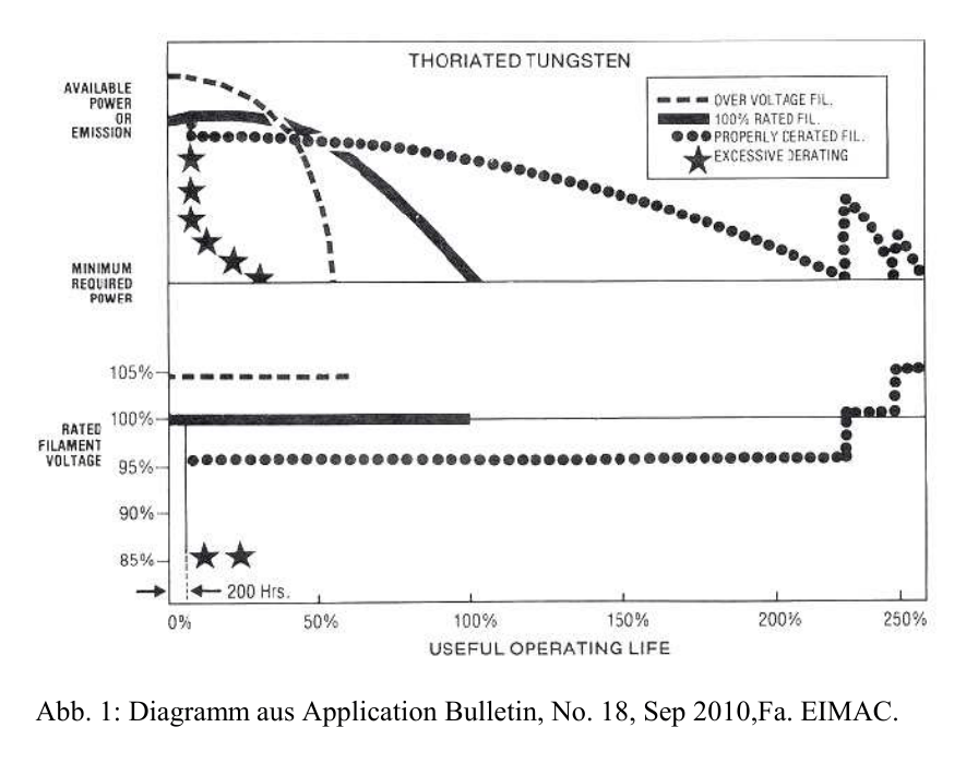

Agree absolutely that the greatest care should be taken to avoid overtemperature of thoriated tungsten filaments.
But if you have an adjustable DC filament supply, you can follow the advice of Transmitting Tube manufacturer EIMAC, and run the filament at -5% from nominal voltage over the majority of the filament lifetime; and then near the end-of-life, adjust upward in steps to get the maximum possible running life.
The timing of the upward adjustment is best determined by observing gm; with audio output valve, the sound is likely to tell the tale.
Extract of EIMAC AB18 illustrates graphically the huge potential for increased life of the valve, if this regime is folllowed: 250% of nominal lifetime, or 500% compared to running 5% too high. This appears far too good to ignore, I believe.
