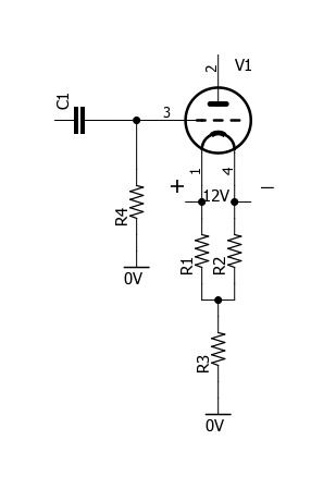

Cathode is prematurely worn (stripped) if current rating is exceeded. If a tube is operated at, or close to, maximum steady current rating (about 70 mA for Type 45), then the positive side of filament will be in excess of current rating, and will wear faster than negative side. In a typical Class A1 SET, the typical idle current is about 40 mA, well below the limit, so uneven filament wear shouldn't be a problem.
Do you have some tube literature to demonstrate this positive side of the filament story ?
If the filament voltage is adding and substracting from bias voltage like a voltage source in series with the cathode , how the tube could work using AC filament without massive hum ?
For a 12V filament the bias would be so skewed on one side that the effect would be very big and obvious . Then only a small portion of G1 would be used and plate too ... the tube must have different loadlines
Depanatoru,
1. How can a type 45 DHT work with an AC powered filament and have very little hum?
Easy . . .
Let's connect one end of the 2.5V filament to a 25 Ohm resistor, and from there to the self bias resistor.
Let's connect the other end of the 2.5V filament to another 25 Ohm resistor, and from there to the self bias resistor.
(virtual center of the filament effectively connects to the self bias resistor). The other end of the self bias resistor goes to ground.
Now, connect 2.5VAC across the ends of the filament.
2.5VAC = 3.536V peak
3.536/2 = 1.768V peak
1.768/2 = 0.884V
At 0 degrees, 180 degrees, and 360 degrees, both ends of the filament are at zero volts, and the filament center is also at zero volts.
The effective bias voltage from the filament to the grid is steady and even all along the filament.
At 90 degrees and 270 degrees, one end of the filament will be at + 1,768V; the center of the filament will be at zero volts; and the other end of the filament will be at - 1.768V.
At 30 degrees, 150 degrees, 210 degrees, and 330 degrees, one end of the filament will be at + 0.884V; the center of the filament will be at zero volts; and the other end of the filament will be at - 0.884V.
Do you see how this is reasonably well balanced from one end to the other end, along the length of the filament wire?
That is a well working practical circuit.
2. At a finer level, there is another effect, the Intermodulation sudebabds of 2 X the power mains frequency on each musical note, and musical harmonic.
That is because the Transconductance is not constant at all bias voltages. So, the transconductance is not the same at one end of the filament that is at the positive peak, versus the other end of the filament that is at the negative peak, of the AC filament power.
And, the transconductance along the filament is higher at the more negative filament end, and lower at the more positive filament end (but constant at the center of the filament wire, because the center is Always at zero volts).
We have to look further down to see this secondary effect, sometimes 60dBc, 80dBc, or 100dBc, but the effect IS there.
Welcome to one of the inner layers of the onion.
Now you know why DC DHT filaments are used, not just to reduce hum, but to eliminate the 2X power mains frequency upper and lower sidebands on each and every musical note and musical harmonic.
