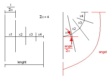

I like very much your special kind of Backloadedhorn style and would like to ask for some infos how to build such a nice horn like yours.
My main question is : how to calculate the horn bend/curve geometry? How can I calculate, draw and bend a straight exponential horn contour into ca. 270 grade bend?
Greets:
Tyimo
Hi Timo,
sorry for the late reply.
the calculation of the bending is quite easy if you know the length and the opening area at these points.
Next step is the angel for the complete horn.
Hope you can understand the picture.
regards Till
