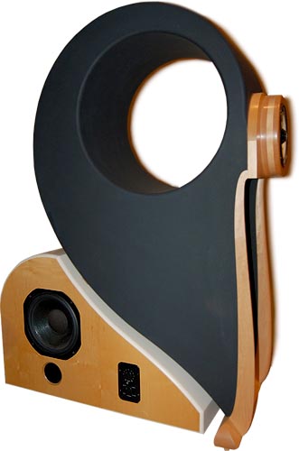

Hi Alain,
I've had never the chance to hear that driver but I have a good feeling.
My first 5 min try looks like that.
length : 0,9 m
mouth area : 80cm²
opening area : 55*35 cm
driver volume : 20-25 liters (just a guess)
should be good for small rooms
best regards Till

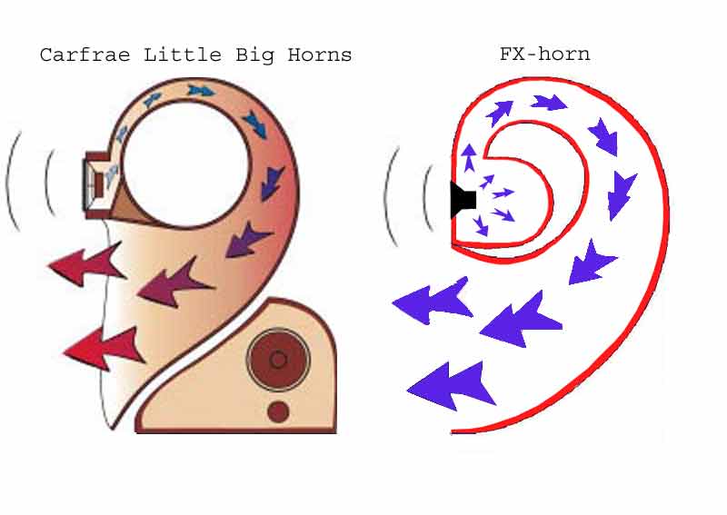

Hi
sure at the first view the FX-horn and the carfrae-horn look the same. But there are some important details different
1) the FX-horn opens 3-dimensional over the complete horn. Widthways linear and over the depth exponetial
2) the FX-horn has a big camber volume
3) the FX-horn doesn't need an extra subwoofer
But all over the carfrae is a gorgeous horn design and I would like to have the chance to listen to it.
best regards Till

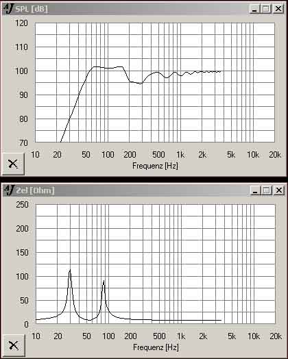

Hi Giovanni,
a try could be to build an expon. back loaded horn with these parameters:
camber: 15liter
length: 0,8m
throad: 45cm²
opening area: 1500cm²
best regards Till

Hi Till !
The Carfrae uses a Lowther DX4. What do you think of using that element in the FX horn?
I've just been reading the whole thread, and found it most interesting.
Why I ask? I have a pair of Lowthers, and was planning to make myself a pair of Carfrae's, but accidently came over this thread. I'm a CNC operator and this design of yours made me thinking of maybe use that design instead.
Hope you read this!
Thanks for your answer in advance!
Regards
Lars
