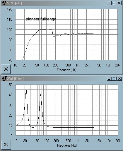

For us in the US, I'm wondering if a cheap driver suitable for this enclosure might be the pioneer B20 8" (though it will probably need a tweeter about 8 - 9 Khz, not necessarily a bad thing since the pioneer covers the bass and critical midrange region)
on an unrelated topic, i'm hoping a coat of damar or puzzle coat can smoothen up the breakup modes in the response of this driver.
http://www.partsexpress.com/pe/showdetl.cfm?&DID=7&Partnumber=290-045
Actually Measured T/S on the web (as opposed to manufacturer specs):
Fs 39 Hz
Re 6.25
Qms 2.9
Qes 0.51
Qts 0.44
Vas 0.066853 cubic metres
What kind of rear chambervolume and horn flare would I use to employ this driver?
Thanks very much

@ zobsky
looks quite good
enclosed a sim. Please note that we do not calculate the rear chamber volume. We build first big cabinets and make the smaller and LISTEN in which volume the driver sounds best with perfect deep stereo image.
I would suggest about 45-55 Liters rear chamber volume. Could also be more or less.

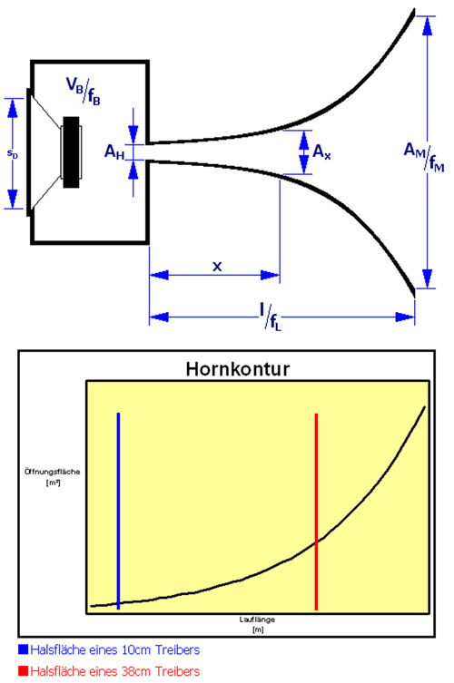

Hi Martin and all interested users,
In the following lines I will try to explain how Raffi and I are building our BL-horn speakers.
The first consideration to BL-horns is that we have got vented enclosure. The driver plays in a rear camber that is vented with a port like a bass-reflex. We calculate the BL-horn after we have found out what the frequency of the driver in the enclosure is.
The hardest way is to find out which volume the driver needs. In the last years we have found out that there is a possibility beside the usual way. We call it the resonance-theory. To explain it hopefully in easy words: we take a driver and put it in a volume and listen to what and how the driver plays. If the volume is too big the sound is very “slow”, kind of “boring”. It sounds if the singer has no ambitions to perform.
If the volume is too small it is the exact opposite. The sound is “aggressive”, “hard” kind of “over dynamic”.
We change the volume until the sound is complete three-dimensional. It takes a little practice but it is an easy way when you have got it once. We cant make a good speaker out of a bad with the “resonance theory” but we get the best solution without any electronic adjustment.
The best way would be to show you how this works but we are too far away from you. But maybe we find a speaker we both got and you try a volume I suggest and you play with the volume to see what happens.
A vented box needs in the most cases the double volume of a closed on. So when we have the closed volume we try the same experiment in a vented box to find out how the speaker gets along with it.
For the first steps to develop a BL-horn with our way we need following frequencies:
fb = frequency of the driver in the enclosure
fl = frequency of the length
fm = frequency of opening area
fb can be found out with fb=fs*square root[(vas/vb)+1]
fs is the free air resonance frequency of the driver
vas is the volume gotten out of Thiele & Small
The calculation is not exact but it is exact enough for the further way we are going.
A BL-horn need 15-20% more volume than the BR.
Ok lets go further with the BL-horn. As soon as we got the “right” volume we can set the parameters for the horn.
For example a driver has a frequency of 80Hz in the vented box the we use this frequency for our calculations.
The horn opening Am can be calculated with:
Am = [9470/(fm^2*4)]/8
fm should not be deeper than the resonance-frequency of the driver. So in most cases we set fm = fs
To find out how the function of the horn is we need the following formula:
Ax=Ah*e^(x*k)
Ax is the opening area at the length x (from the horn-throat)
Ah is the horn-throat
e is the Eulersche number (2,71828…)
x is the length from Ah
k is the constant
k=(4*fl*PI)/344
fl is the frequency of the length and is between the fb and fm
fb > fl > fm
When you build a horn with this way your impedance curve (???) will loke like a BR- curve. Just take a look at our simulations.
Actually I can reduce the length of the horn if I reduce Am and Ah. That has to happen in exact proportions. That is the reason why I have the bold statement that a BR is nothing else than a very short BL-horn.
Hope I could help you with that.
We will describe the whole procedure with parameters and simulations and build horns (with plans for the private use) soon on our website (http://www.hornlautsprecher.de)
Best regards Till

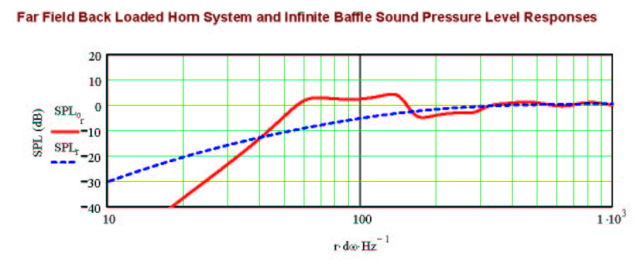

Hello Raffi and Till,
Thank you for the detailed write-up describing your method for designing the Replikon horn. I found it very interesting and you are definitely approaching the problem in a different manner then I have seen before.
When you build a horn with this way your impedance curve (???) will look like a BR- curve. Just take a look at our simulations.
This is what struck me immediately when I saw the impedance curves you were posting. They looked like BR curves. So I started doing some simulations with my own MathCad worksheets using the T/S parameters from a few different Lowther drivers. The results I was gettign looked a lot like yours so I continued to play with the modesl to see what I could learn. I found a couple of interesting things I thought I would offer for your consideration.
First I used my simplified BLH model which treats the driver and horn mouth as coincident and radiates into half, quarter, or on eight space. Here is a picture of my results.
