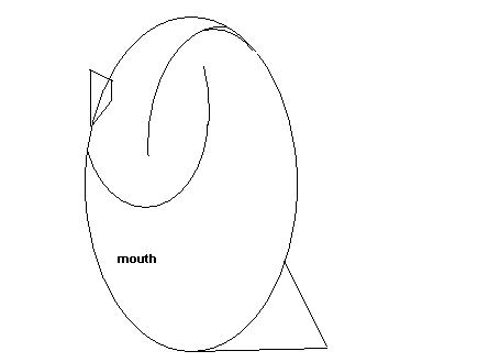

Horns sitting on the floor have an acoustic mouth area with double the actual area due to the mirror image projected on the floor. The acoustic length of a pipe, etc., is somewhat longer than the actual length. Through much impirical evidence, it's been determined that this so called end correction varies with the terminus's radius and what, if any boundaries it's near.
If these were the only issues, it could be easily calc'd with a fair degree of accuracy, but alas, the flare's 'M' factor complicates it, so unless you're prepared to wade through all the math like MJK and a few others have, you build a prototype and measure it. In general though, if a BLH's mouth terminates at the floor and has at least an 1/8 size mouth (including the mirror image) area of Fc, then it can be ~an octave shorter and will still perform acceptably, hence a ~71Hz length for a ~35Hz Fc.
I guess what you're failing to account for when using rules-of-thumb engineering on a fullranger BLH design is that you don't want the horn's gain to 'be all it can be' or it will completely overpower the mids/HF, hence the need (or lack thereof) for a long horn with a big mouth WRT Fc.

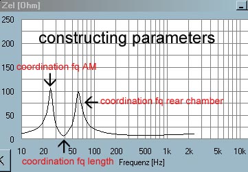

first of all I think it is well known that backloaded horns work as expo tml below 100 Hz.
So what makes the horn sound like characteristic as a horn. You are right with your suggestion that a horn with a small chamber loads a horn stronger than horns with big rear chambers. I suggest that it is the load of the frequencies between 100 Hz and the cut off frequency lets say 700 Hz which is required by the small rear chambers.
But especially these frequencies interfere with the direct radiation of the driver. Our aim was to reduce these interference, so that the horn only loads the fq range below the QTB of the driver in the chamber. We have then only a load of the lower frequencies.
So in the praxis we have a lower SPL of the air load than conventional horns, but do not forget that in the praxis of conventional horns there is a need of damping materials to eliminate the peaks in the upper bass. So with the damping you actually kill most of the high load efficiency.
Nevertheless we have to admit that our horns sound therefore different without that what might be characteristic for a conventional horn. But at the other hand you have a very smooth reproduction of the frequencies below 100 Hz wihich is also not comparable with tml or br sound. Because of the lack of interference in combination with big rear chambers you are able to listen frequencies down to 30 Hz -3db like in my listening room.
The big rear chamber in combination with a horn neck AH 0f 2/3 of SD we reduce the distortion factor in addition.
The result is a distortion free sound reproduction of the horn loaded frequencies. Due to the fact that we also use normaly 2/3 of SD the sound is very near to oncken enclosures but in additional to the air load of the horn the bass sounds very very open with clear 3D image down to the lowest frequencies.
The construction:
My Partner Till has worked out the mathematical basis of this kind of construction:
Our formulas wil be presented in June 05 at http://www.hornlautsprecher.de
Just one idea to that:
We have 3 basic formulas in constructing our horn enclosures:
At first we have the co-orrdination frequency of the rear chamber
Second we have the coordination fq of AM
Third is the coordination fq of the length
enclosed you find the impedanz curve. As you see it is like a bass reflex enclosure. Nevertheless it does not sound like a br.
It is a totally different approach to the material horn enclosures and maybe the definition horn is not suitable, in fact our horns follow the exponential function.

Hi mgoedecke,
the interesting thing of this metod is, that in fact the impedance curve looks like bassreflex it does not sound like bassreflex. But why is it so ? Comparing to BR enclosures the LF gain has more volume, a wider and deeper stereo image. It sounds very open . You have not a break in the stereo image, where you have a sharp stereo image of the direct radiated sound, but a lack of stereo image in the lower frequencies. Due to the fact that the horn makes a good adaptation of the air molecules to the room response (Anpassung des Strahlungswiderstandes an den Raum) this is resonsiblble for this open bass response.
Now we have tried several times to construct the horn smaller by (shorten length, but at the same time shorten AH and AM !!!!!!!) The smaller you build the horn, the more it sounds like Bassreflex, in fact the impedance curve is the same as for example the big horn. That leads uns to the knowledge that the bigger AM is and in relation to that also the length, the bass sounds more open with a brider and opener stereo image.
Now to your question. It is more analogous to Bassreflex. The Replikon for example has a length of 1,4meters. We have made the experiance that a length bigger than 1,6 meter can acoustically be identified as delayed bass, will say you can heear the timing problem. Only very good ears are aible to listen time delays of 1.4 meters ore less. So this is a further advantage. I have no more timing problems.
The weakness of the driver by FS is a problem you are right. Therefore we do not coordinate tuning frequency below FS of the driver.
Now this as also a reason why we use likely drivers with QTS more than 0,4, because in addition with big rear chambers you can reach a high gain by low frequencies. Nevertheless the Replikon is loaded by the Fostex FE 208 Sigma and it functions very well.
There is also a technique of using drivers with QTS 0,2. To enhance deep bass you can make the horn neck AH bigger than simulated and calculated. So you have also the chance to variable between these three parameters of construction till you adjust the driver to the horn.
If you ask me directly what the main advantage of this kind of constructing is, I will answer you first: Very open and low bass response with a very deep 3D stereo image down below to lowest frequencies.
The disadvantage is with no doubt the lack of high gain in the upper bass which is characteristic for conventional horns and in consequence the lower SPL.

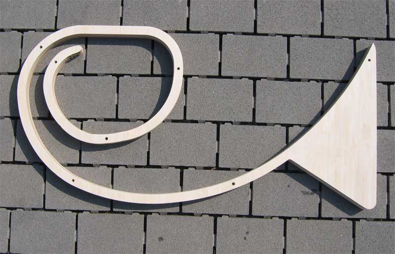

That is one of the things that also passed thru my head when i looked at the elegance of the shape... then i started thinking of less wasteful ways of fabricating (or how to take advantage of the scraps
just use the rest of the wood for other projects. All our "speaker stripes" are cut out with a CNC-machine and it is not a big problem to program the machine with different projects on one time.
Hope I will get more time to explain the horn-theory to u. My suggestion would be to design the horn for the Fostex FP203 (or an other driver some one would borrow me for the time) from the beginning here in the forum. I would share the cost for the project with the person who would borrow me the driver.
All pictures and simulations and plans could be used for the private use. Maybe we could get some more light in the darkness than.
